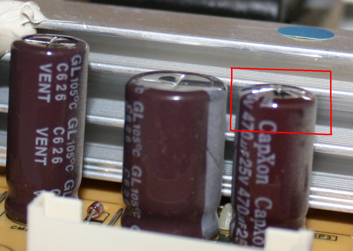

    I'm selling a power supply board on E-Bay that was working fine and taken out of a TV with a cracked screen. Upon inspection I did notice 1 slightly bulging cap (pic related) that has not yet affected its performance.
    Should I replace the cap? The TV is already taken apart and some parts are in the trash bin, so I wont have a way to test it to make sure its working if I do replace the cap, and I have not replaced a cap before.

    Replace all the electrolytic capacitors, so the end customer will get a reliable replacement part which will require no re-capping.
    Even if you replace the bulged one, the other capacitors are likely the same brand - 'CapXon',0 which is a VERY CRAPPY brand - and they will likely bulge in the future.
