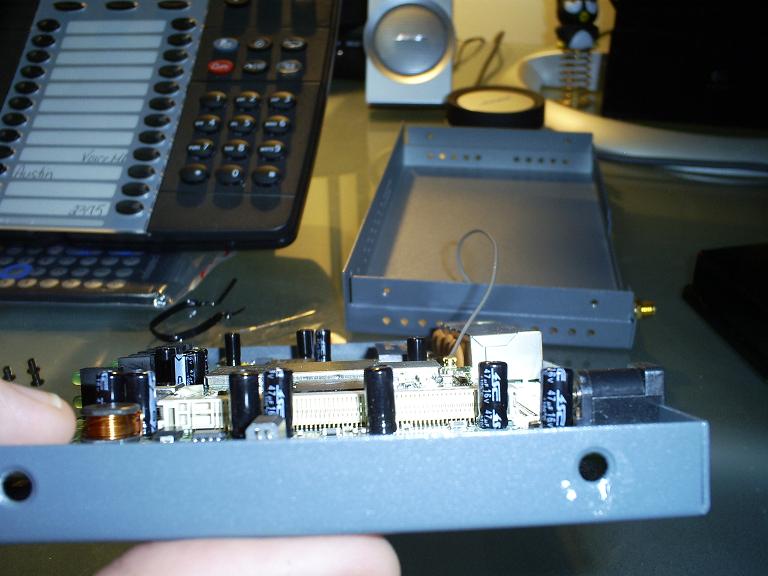

    Anyone ever seen these caps?
    I've got an older Asante FR1104G router cracked open as it's out of its warranty period. It was always flakey, even the ones sent back as in-warranty replacements. There are 16 identical 47uF 16v caps with a strange branding. They are black with white lettering and the brand logo is a lightening bolt with a stylized "SC" next to it. I've got some Nichicon HE's left for this project, but I was curious if anyone has come across this specific brand of capacitor before.

      Re: Anyone ever seen these caps?
      Alright, here it is. I scaled the photo size down but you should still be able to see it. I can't determine whether these caps are a known bad brand or not. The router works, but it will periodically lock up and stop routing packets.

          I think I have a positive ID on these. I ran across these caps today at work:
          Emerald green wrapper
          Logo – Single zigzag lightening bolt followed by a stylized “SC”
          “330uF 16V”
          “105C Vent”
          Gold polarity stripe with inset arrow and “-“ symbols
          “PW”
          “L.E.S.R.”
          No fate code or factory code
          Bung has two concentric rings with slight clearance for cleaning around the leads; the wrapper, not the bung will be in contact with the PCB.
          “X” vent on can top.
          The wrapper color is different from Kacerdias's description but the logo sounds the same. Who are they? The source is Surge Components, who sells Lelon here in the US. So these are rebranded Lelon caps. Notice the use of a Nichicon series name, "PW". Also note the lack of any date code or factory code info. When I unwrapped a sample, I found (through a rudimentary test) that, despite the me-too use of a Nichicon non-aqueous series name, the electrolyte is aqueous. This was not the first time I'd found Lelon fudging or failing to control the electrolyte type.
            Well, that seals it. I'm recapping this router. Thanks for the replies!
