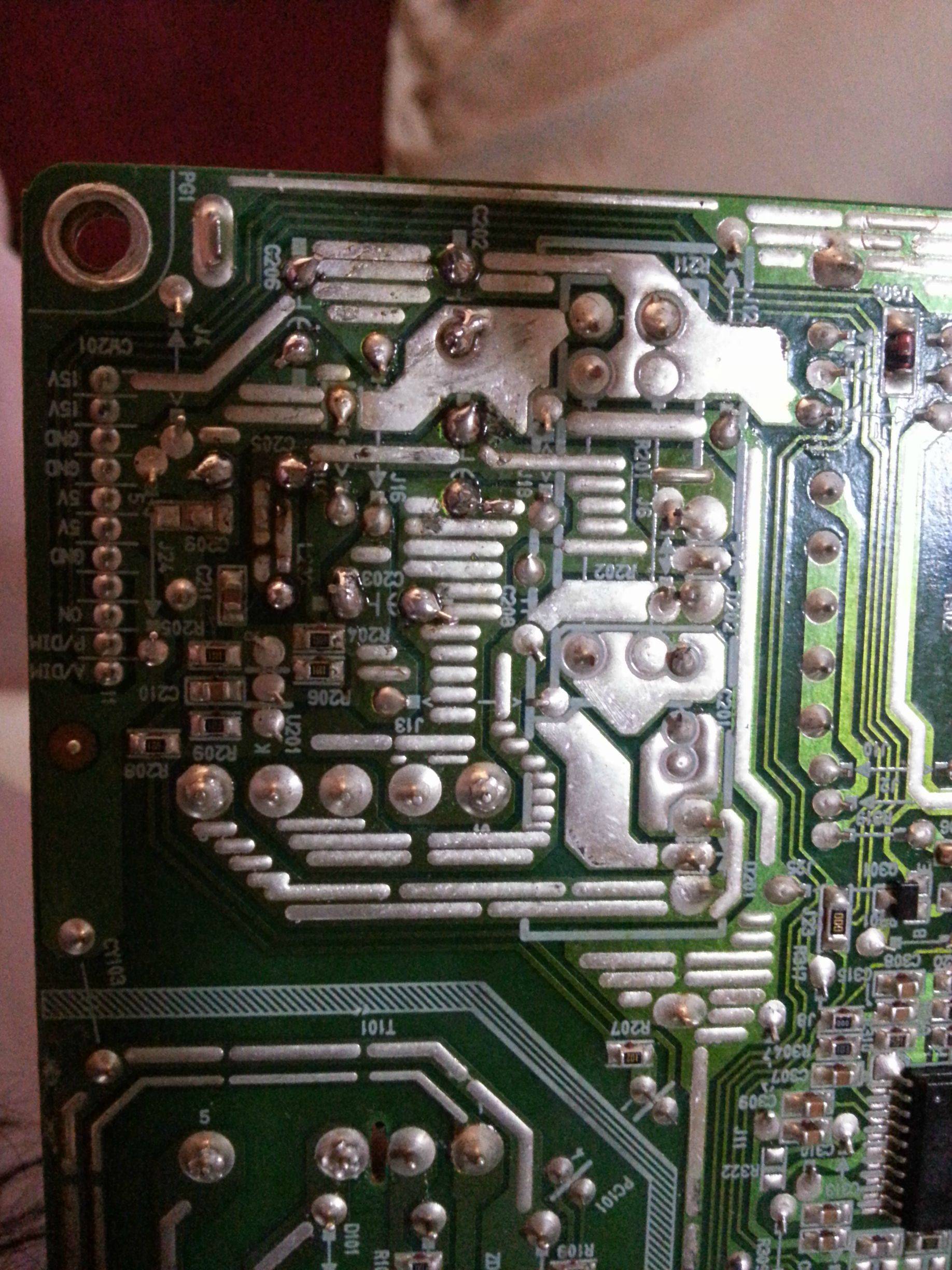

                          There are 2 monitors I'm unable to repair:
                          LG L226WTQ-PF:
                          capacitors replaced
                          bad soldering work, pictures to come soon. waiting for camera
                          light tubes go on and off normally when monitor is on/off, however, no picture can be seen
                          Samsung 931BW:
                          nothing's changed.
                          capacitors not even bulging, looks good.
                          picture displays a split second then disappears. selecting source causes it to display for a second then disappears again.
                          found someone else with this issue. this does not look like easy work:

                            LG L226WTQ-PF (MY BAD SOLDER WORK):
                            Backlight is on but no display.
                            Pressing on menu button doesn't show anything. Actually none of the buttons do a thing -- zoom, source, menu, etc etc.
                            Turning on and off does show the LG logo middle of the screen. Very clear.
                            Also displays source at top right corner. Very clear.

                              LG L226WTQ-PF more pics and vid:

                                • mariushm
                                  • May 2011
                                  • 3799
                                  Re: Please help me decide replacement capacitor
                                  The LG looks fine.
                                  If it shows those "no signal" messages and the backlight stays on that long, everything's good.
                                  Since the monitor has both vga and dvi, make sure it's switched to the proper source (that may be the cause for the no signal message).
                                  If you're using a dvi to vga adapter, make sure the video card's dvi connector outputs analogue signal - some video cards have two dvi ports but only one outputs vga.
                                  If you're sure the monitor is supposed to get a signal (you can test this by checking with another monitor), then something between the vga or dvi connector and that large chip could be damaged. Possibly due to ESD or a short circuit etc.
                                  The board otherwise looks fine to me.
                                  If you have a multimeter, put it in DC voltage measurement and measure the voltage on IC702 and IC703 ... Black probe on center pin, red on the first, last and the tab (that large part soldered to pcb like a heatsink)
                                  It's unlikely one of those 2 voltage regulators is bad but it doesn't hurt to try.
                                  The Samsung monitor, it could use some cleaning.. get some cloth and remove the dust.
                                  The brown stuff could be flux left from the wave soldering process, it's not something that would cause problems.
                                  However, there are some solder joints that look like they could be cracked or cold solder joints (from vibrations, heat-cold cycles etc).. the ones at the top and the one by R76 and C9 don't seem so good to me.
                                  It wouldn't hurt to at least reheat that solder with your iron tip (ideally remove the solder and put new solder).
                                  Clean up the board and post pictures of the whole board and pictures with different sections more zoomed in like in the lg pictures
