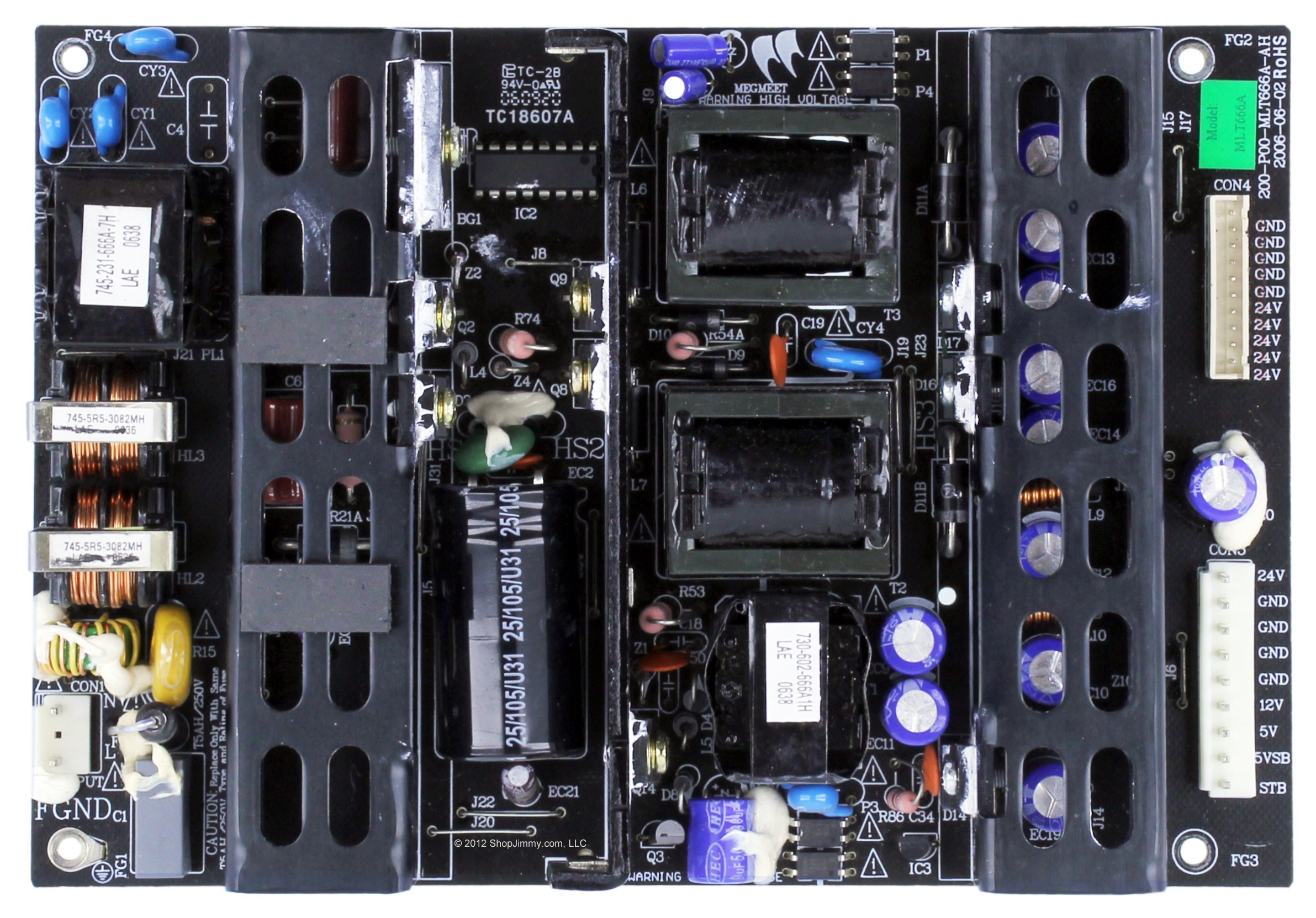

    I have a power supply from a Polaroid LCD that has a missing EC. I didn't remove it as the TV was given to me. The screen was busted so I salvaged the boards for other projects. Now it turns out I need to fix this one. Hopefully I can sell it and make a few bucks to repair another TV. The power supply is a Polaroid MLT666AMH and the missing cap is ID EC 20 located between connectors 4 and 5. Has anyone out there got one of these boards or repaired one that might know the value of the missing cap? I think I will need a 1000uf 35v therre but I am not sure. Thanks in advance for your generous assistance.

    If you go to Google Images and search for MLT666A you'll find plenty of pictures of the board.
    For example, this one looks good:
    http://futuregatetech.com/Websites/f...610786651e.JPG
    If you look carefully, you see there 470uF and 35v on the capacitor.
    That sounds right, it has to be 35v or more because it's on the 24v output. And 470uF is a common value, typical for that diameter and height of capacitor.
    On this page : http://tvpartsfixit.co.uk/?search=t2...&Search=MLT666
    The first page has a picture of your board.. if you zoom in you also see a 4 right at the top, so that capacitor is also 470... it's too small to be 4700uF and too large to be 47uF.

      Dang you guys rock on the board. I spent the larger portion of this day screening different pictures of this board in hopes of finding exactly what you found in almost no time. I didn't want to make the post but sometimes you have to stop being stubborn and ask for help.
      I thank you sincerely for the assistance. Now I will go dig up a 470uf 35v cap and solder in on.
