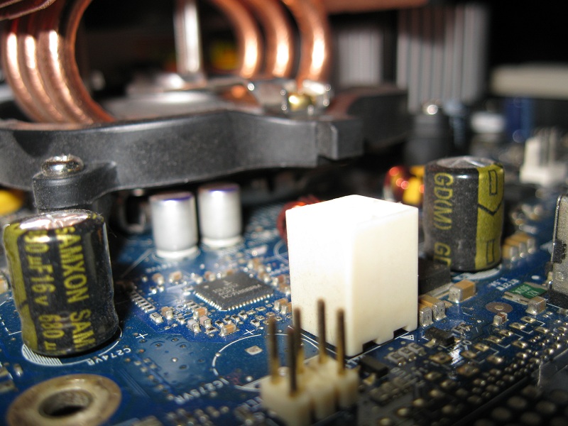

    Hi guys,
    Thought I'd better de-lurk and ask for an opinion before something blows up.
    This motherboard has 2 Samxon GD(M) 680uF 16v 10x12.5 caps around the VRM area and only one is bulging so I gather it or both will need replacing soon, the board is working fine ATM.
    What would be the recommended replacement caps?
    Thanks.

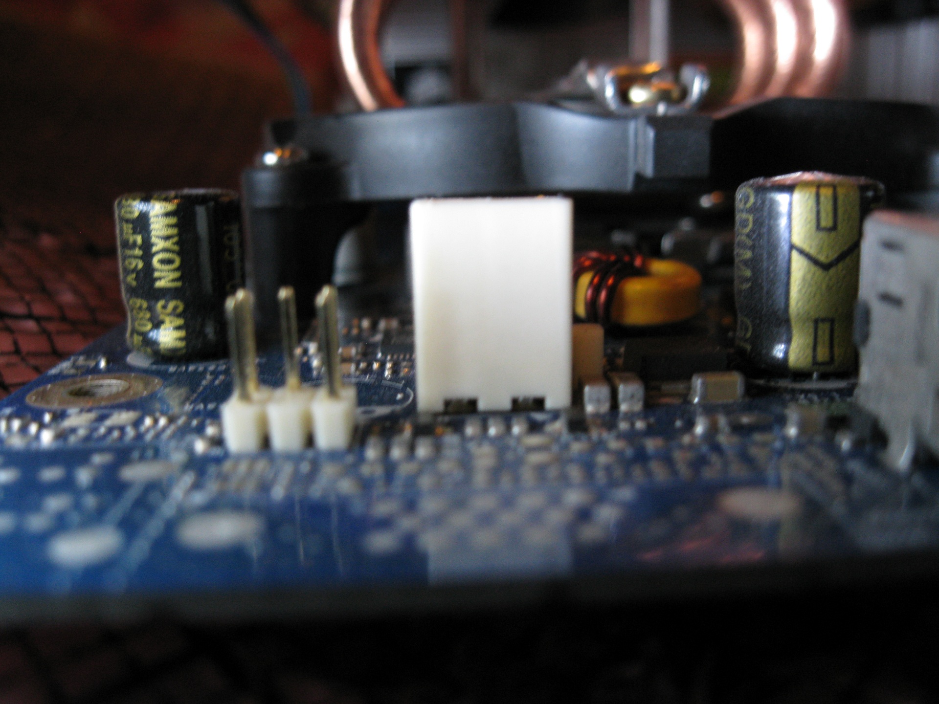

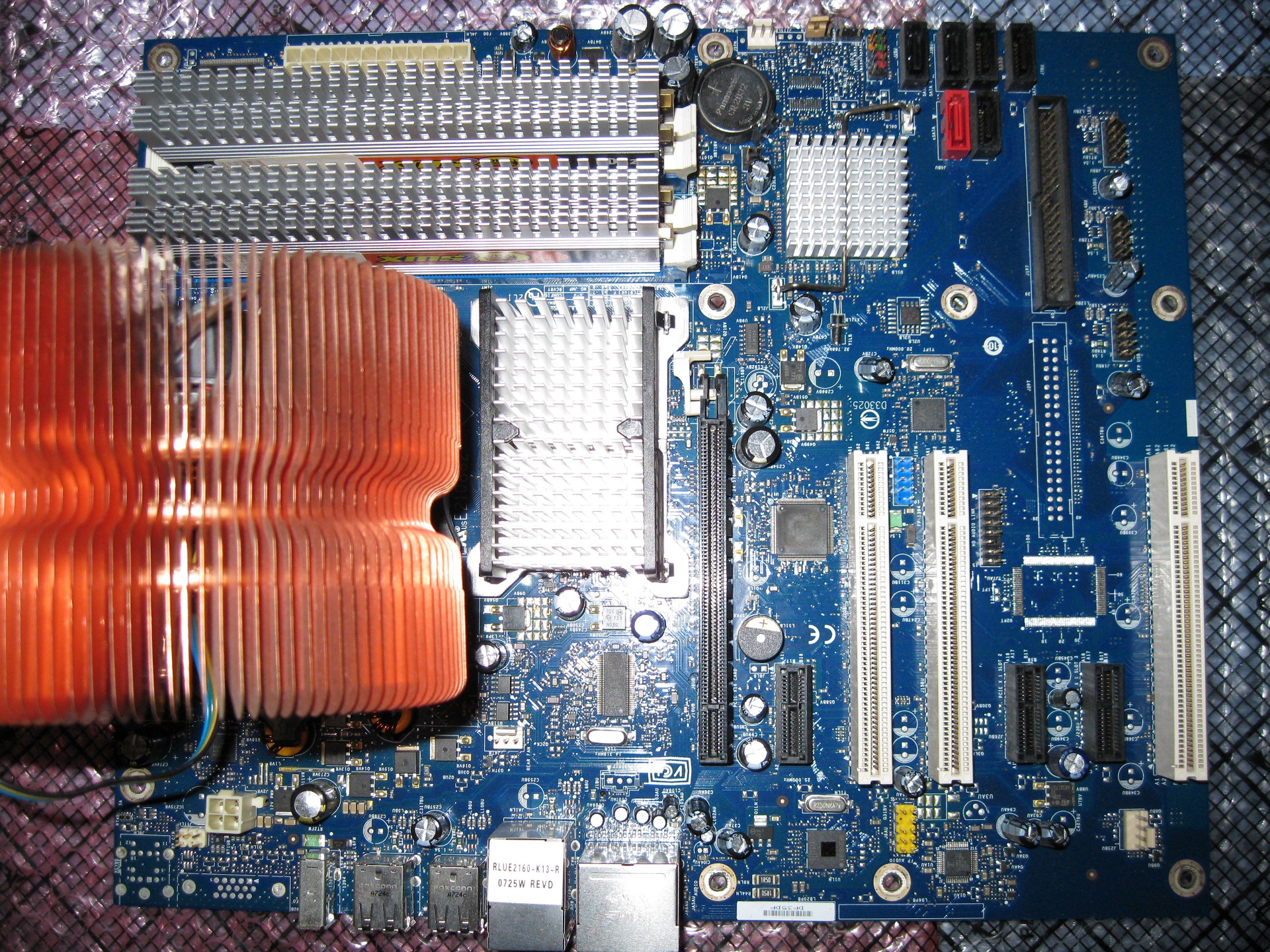

    https://www.badcaps.net/store/produc...products_id=50 measure what ya got to confirm size, but ones above will work for ya! an by pic the both look bulged! take a clear over head shot of whole board an post it please.

      Re: Bulging Samxon GD(M)
      Samxon GD is a reliable series... They bulged around your VRM in, so I suggest you take a good look at your power supply which must have caused them to bulge. Also, what t.j. referenced might not be a good match. I didn't check the specs, but I know that ZL is not equivalent to GD.
      These are a better match:
      https://www.badcaps.net/store/produc...roducts_id=178

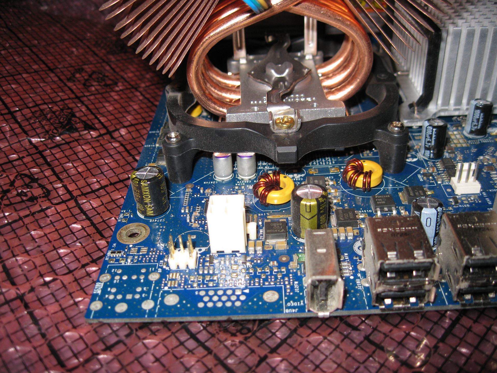

            Thanks for the recommendation.
            I've added some more pics, hope they are clearer.
              16V 680uF 10mm wide:
              Samxon GD: 1540 0.026
              Panasonic FR: 1290 0.043
              Panasonic FK: 900 0.063
              Rubycon ZLH: 1330 0.039
              The ESR is too high and the ripple too low.
              Nichicon HZ: 2280 0.012
              I see a UCC KZJ series cap near the PCIe x16 slot. You should replace that too while you're at it.
                Somehow I figured it would be only you guys that are able to recognise caps from the vent design.
                You are correct it is a KZJ 10x12.5 10v 1000uF but shows no signs of visible fatigue, so again what would be the recommended replacement?
                The rest of the caps are Rubycon, Sanyo, Nichicon and no idea what the polymer caps are atm for those that are wondering.
                Looks like I'll be importing caps then if I can't find them locally.
                • mockingbird
                  • Dec 2008
                  • 5484
                  The polymers look like SEPC. Good stuff.
                  KZG/KZJ oftens how no signs so replace it to be safe. This is a perfect replacement:
                  https://www.badcaps.net/store/produc...products_id=47
