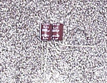

    Chemicon KZG wannabe (counterfeit).
    I'm not sure if Chemicon has TMZ series in their line up.
    The one in the left is TMZ, brown (ugly) color, with vent like mercedes but the line feel like those taiwan caps (look @ willawake's Asus TUSL2-C for better explanation).
    The one on right is the real one, chemicon KZG 6.3v 1000uF with brown shiny color and flat top.
    My digital camera sucks. My sony analog hi8 handycam is better for macro mode, unfortunately it's not on my hand right now..

      Could be a Samyoung, which is supposed to be a Chemicon technology licensee. They tend to have equivalents of the common Chemicon series - however, the logo is a distinctive circle with three small arcs sticking out.

        Re: Chemicon KZG wannabe (counterfeit).
        it could be. but there are no dot in the logo. i have seen some samyoung lxv caps that look like chemicon. even that samyoung is shinny, this one looks like there are a hair behind the jackets..
          Actually, Samyoung is an ally of Nippon Chemi-Con.

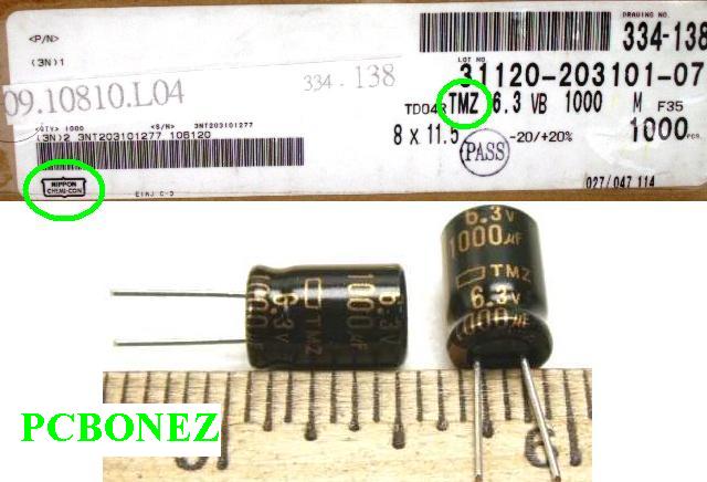

              Then on the other hand look what I just found in an ad.
              Apparently both CC and Samsung have a TMZ series.
              Giveaway is the CC Logo/Shield on the caps shown.

                Ah! That black TMZ is not hard to find here in indonesian market.. Thx alot for the pic Bonez So from the pic it seems that TMZ are indeed NCC's series.. BTW is the pic yours?

                            TMZ is likely real. I've seen them on older Intel boards. I'll see if I have one in the parts bin that I can pull off and measure its ESR to get an idea where it falls as far as specs go.
                            • yyonline
                              • Jul 2009
                              • 692
                              So I measured the TMZ. I had an 8x11 TMZ, so I compared it to other 8x11 caps.
                              It is lower ESR than 8x11 ZL/KZE/WX/HD
                              It is higher ESR than 8x11 MBZ/KZG/WG/HM
                              It read the same ESR as 8x11 Panasonic FM as far as my ESR meter could read (2 decimal places).
                              So...spec-wise it appears to be better than KZE, worse than KZG. Reliability wise...I haven't seen any fail personally, but I've hardly seen enough of them to say one way or the other.
                              It certainly appears to be a genuine UCC cap. The sleeve, vent, bottom all look exactly like any other UCC cap.
                              Hope this info is useful for the next time somebody runs into it on a board.
                                  Thank you!
                                  And yes, TMZ is a valid UCC series.

                                        I've never seen a failed one.
                                        - But I have seen recappers changing them because they didn't know they are.
                                        I should have measured some when I had them here but I didn't think of it.
                                        - Thanks again yyonline!
                                        - TMZ is an FM equivalent. - Good to know!
