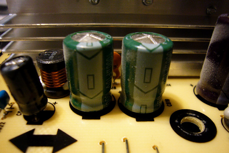

    are these bad caps?
    hi all
    i know its not the best pic but could someone let me know if these look like bad caps or not please ? the card is a nvidia gts 240
    thanks

    From the information given and the picture it is impossible to tell.

        Re: are these bad caps?
        If it's the caps in the pic I wouldn't worry.
          They are most likely polys, and they are usually good.
              i contacted the seller about the capacitors above and they said that they have the letters ULR printed on them
              would these be ok?
                It looks like these are Samxon capacitors:
                http://www.asianmicro.de/en/man-yue-...itors/ulr.html
                I don't know much about this particular line of capacitors, but Samxon in general tend to go bad. Samsung often use Samxon in their monitors which have a habit of developing problems.
                The datasheet says that they are polymer capacitors, so maybe it's worth a try.
                  ^^totally wrong. ULR are polymers made by X-CON, who are a division of Samxon. Samxon are known reliable caps.
                  QUOTE"Samxon in general tend to go bad. Samsung often use Samxon in their monitors which have a habit of developing problems."QUOTE Nope, samxon are perfectly good caps with no problems. Samsung do not use samxon caps, you are getting confused with samwha.
                  samwha caps are know to go bad. samxon are good.
                    NOT totally wrong the Samxon GF and GL series are known to cause problems in some applications and just lately the GK series have started to wobble.
                    Use Search above for samxon threads and you will see.
                                    if any board has bad design, caps can bloat no matter how good quality they are
