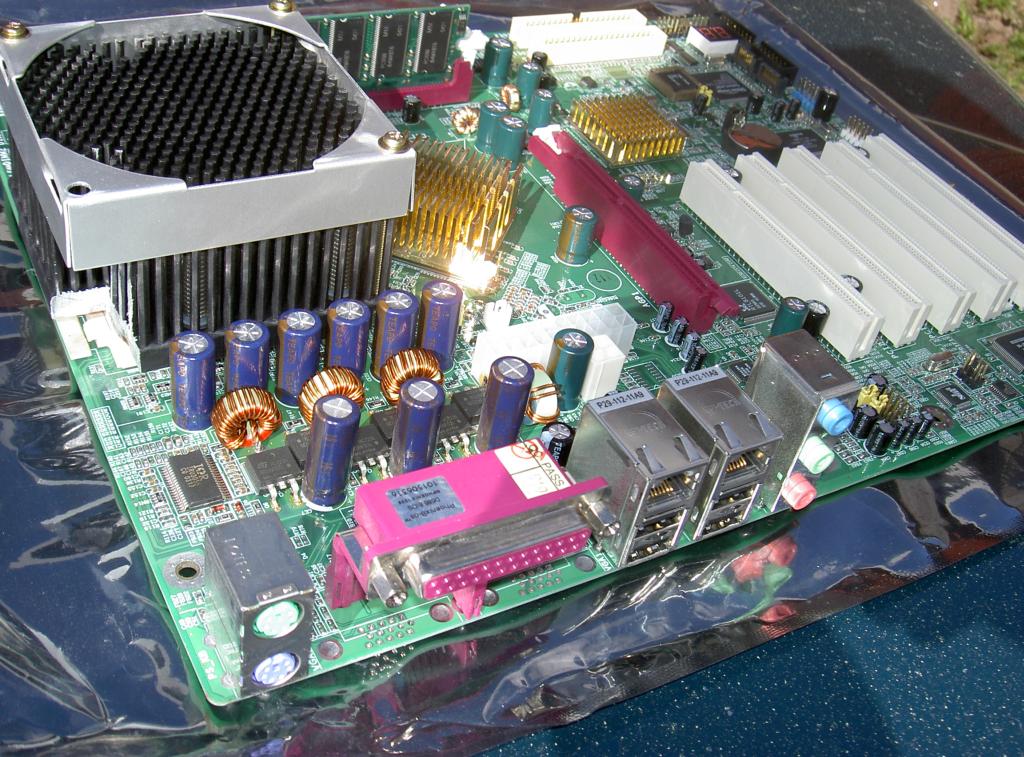

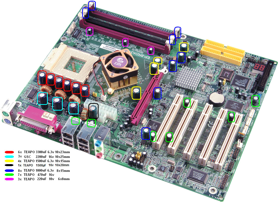

        Another Swede; hi there and welcome to Badcaps
        I've owned a Epox 8RDA3+ rev2.0 for a long time, it also has Teapo caps, it did not fail before I took it out of service, and I ran it highly overclocked all this time 24/7 with poor cooling...
        This is in no way to say that you are wrong, just to say that the difference of how poor Teapo caps really are does differ, i.e. they can work for only a few months or several years...
        But there is also a design issue with the 8RDA3+ rev 2.0 and below, the row of capacitors right next to the CPU hinders any airflow that otherwise would cool the voltage regulators...
        If you take a look at this picture of my board the first 3 capacitors are actually GSC and it is nothing short of amazing they have not failed. These are the 12v input capacitors. Next comes the 6 VRM Mosfets for the 3-phase voltage supply to the CPU. And last is the row of Teapo caps which as you can clearly see hinders airflow... This was fixed in rev 3.x of this board...
        So what I want you to do is monitor the temp of these voltage regulators (Mosfets) But please be careful, because they will handle upto 100°C without malfunctioning!
        My thinking is that yours are well above 100°C...
        And the reason they become so extremley hot is that the capacitors have silently dried out (without visibly bulging which is very common for Teapo caps)
        That will make the Mosfets have to work much much harder...
        So yes, I think a recap is what your mainboard needs...
