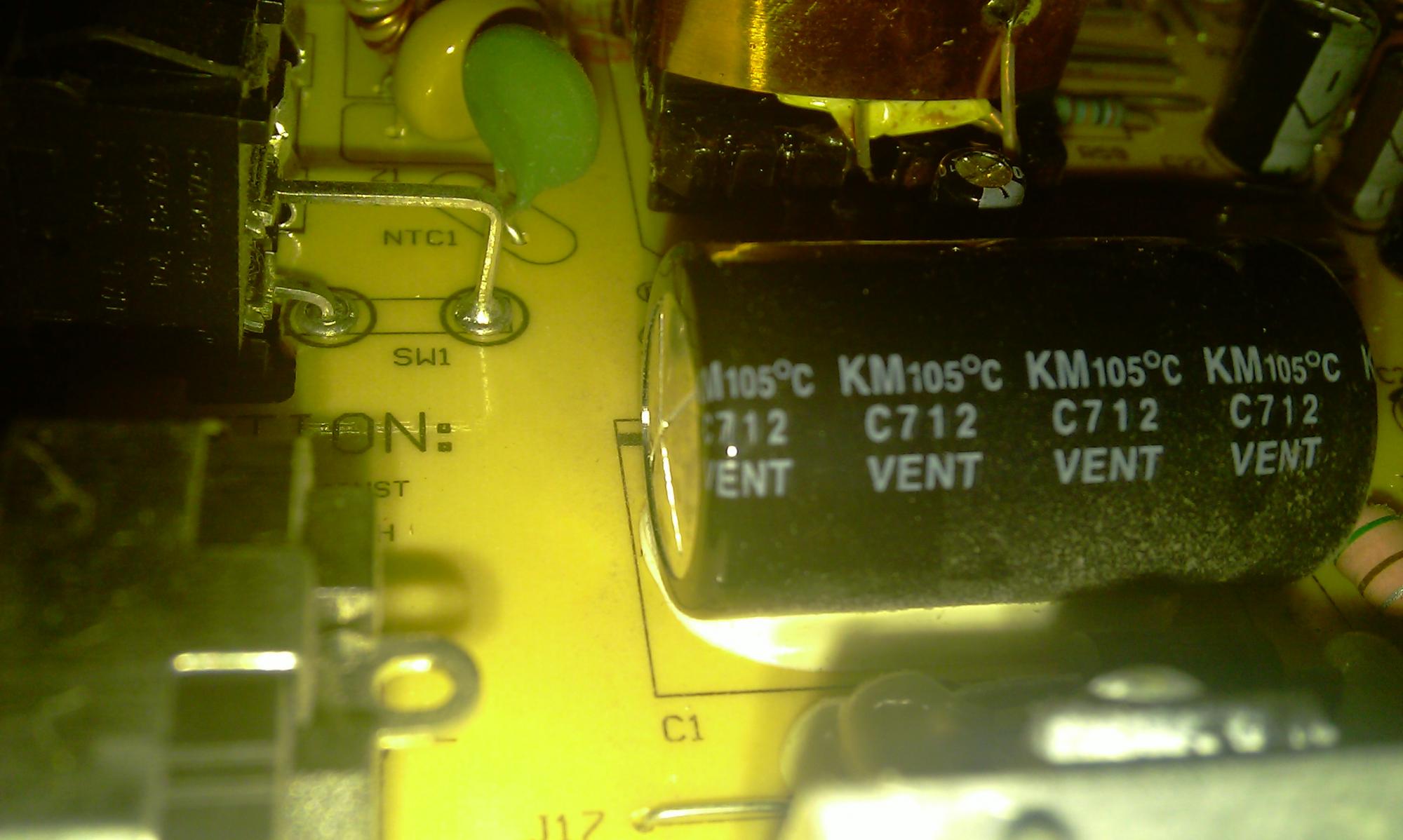

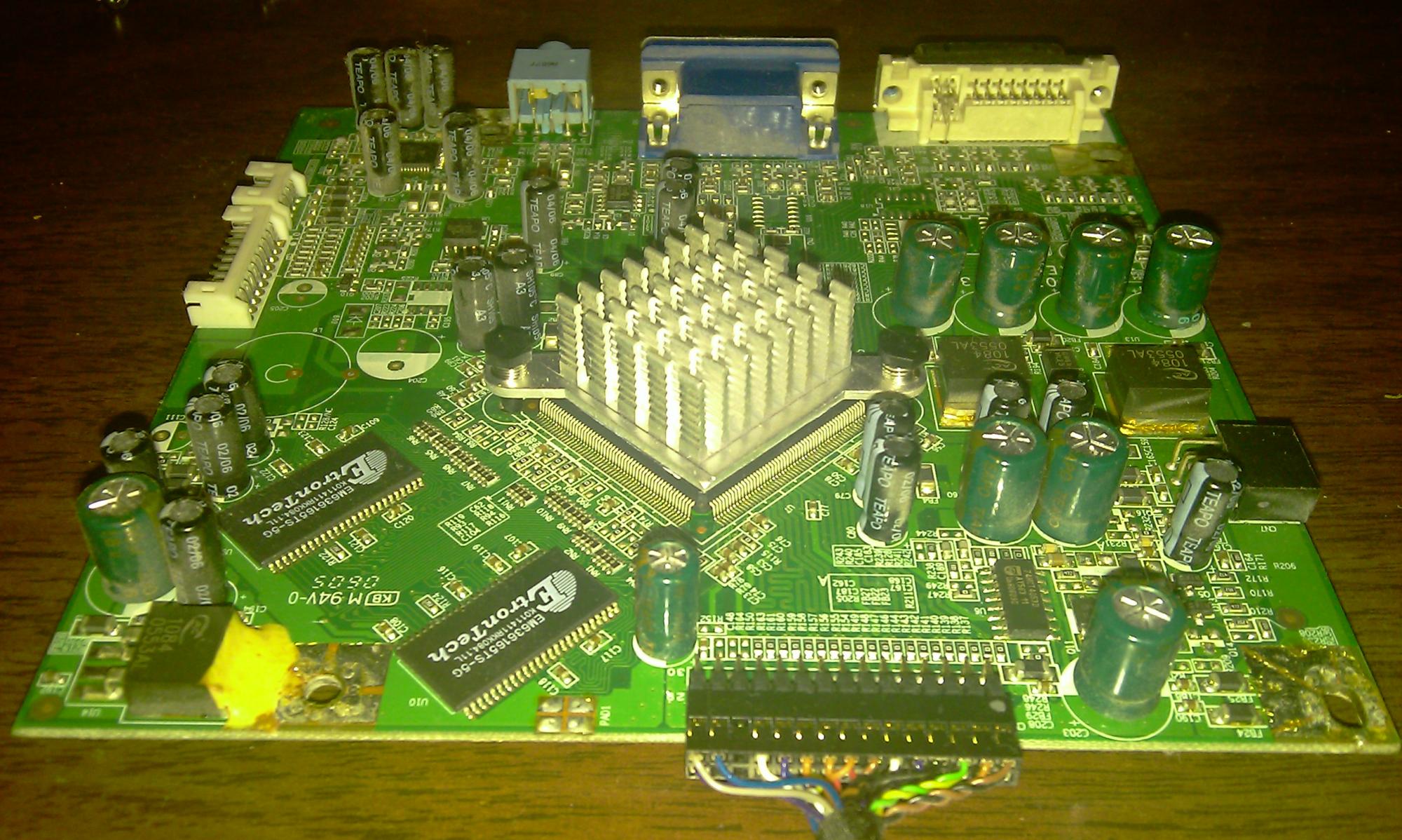

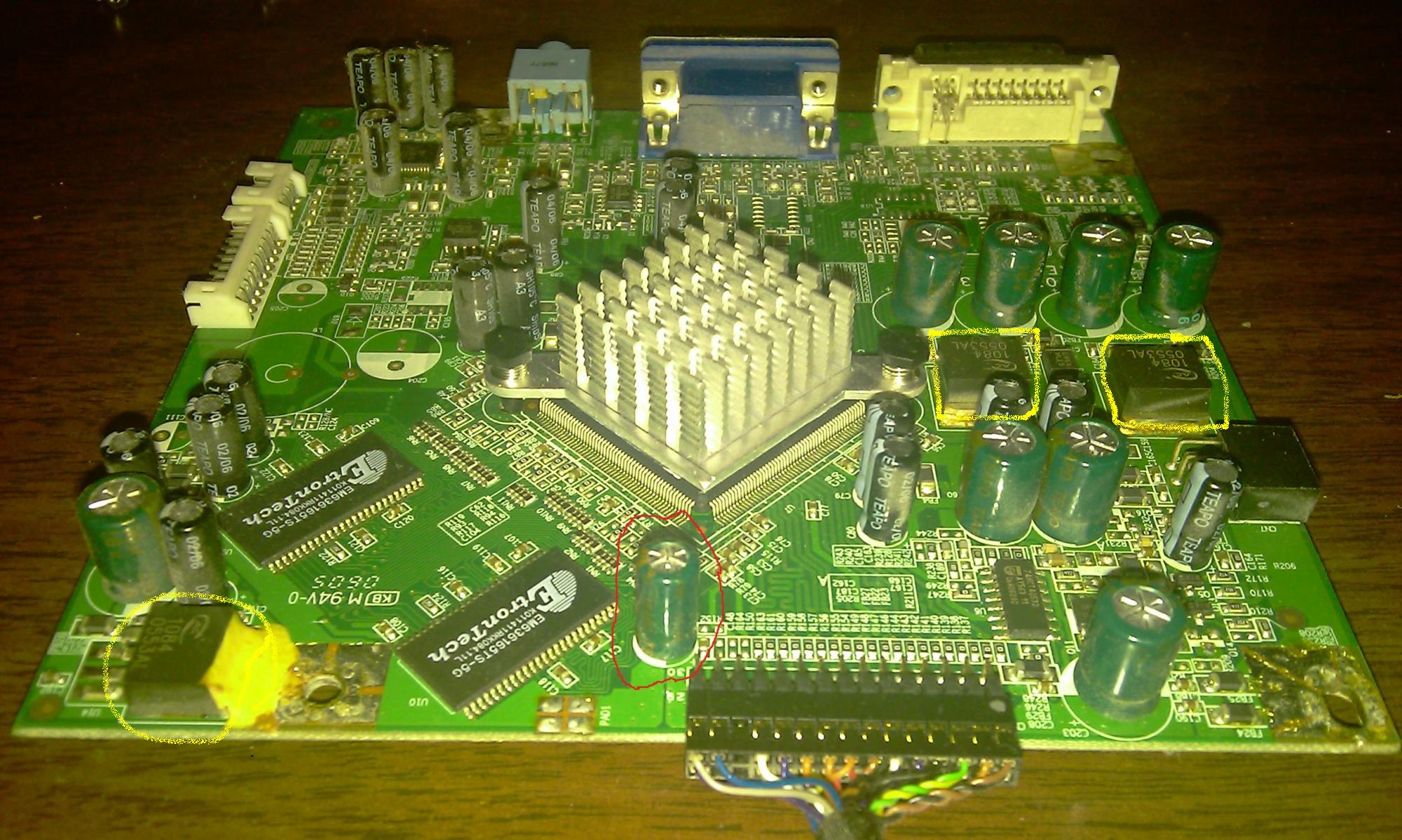

    So a few days ago i was using my monitor and i went to the kitchen for whatever reason. When i came back the monitor was black and the power button was green which means the monitor is getting a signal from the computer. I made sure all of the connections were tight and turned both the monitor and computer on and off. when the computer was off the monitors light switched to orange (standby) and when the computer was turned on it went back to green (responding) the only thing is that the screen stays black through all of this.
    Right now im running on an older monitor which i plugged in and it worked fine. So that rules out the computer/video card and all. about a year and a half ago i ran into a very similar problem with this monitor where i would get a no signal message in the middle of the screen even though the monitor was displaying fine. Then it got to a point where the monitor had to "heat up" for as much as 10 minutes before it would start working. then it eventually quit all together. So i a bought kit from this site and the problem was fixed.
    I changed out those capacitors which iznt all of them, just most. Now i wonder if other ones have gone bad but i opened the monitor back up and i dont see any obvious bad caps.
    Only 2 caps seem bulged a little. The one big one on the power supply board and one small cap on the video board.
    So let me know what you guys think based on the symptoms/pictures.

    What about the other side of the boards?
    Have you checked the output voltages?

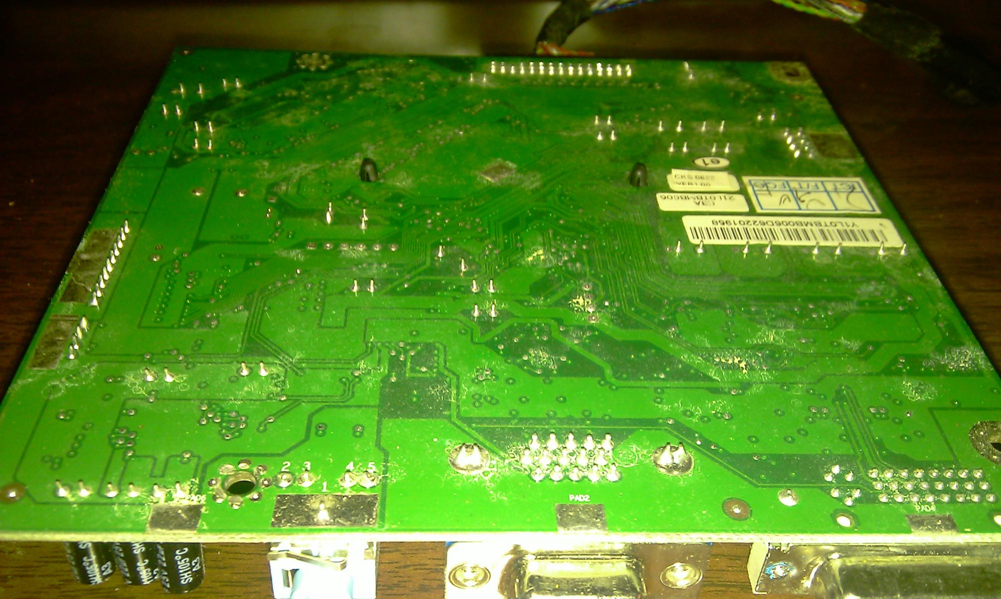

        Please, upload pictures of the other side of each board in order to give you a more accurate answer.
        Report your reading on each pin and number them. You'll probably see written on the board what's the output voltage.

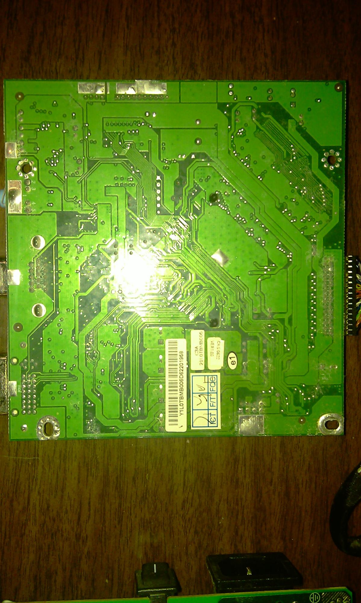

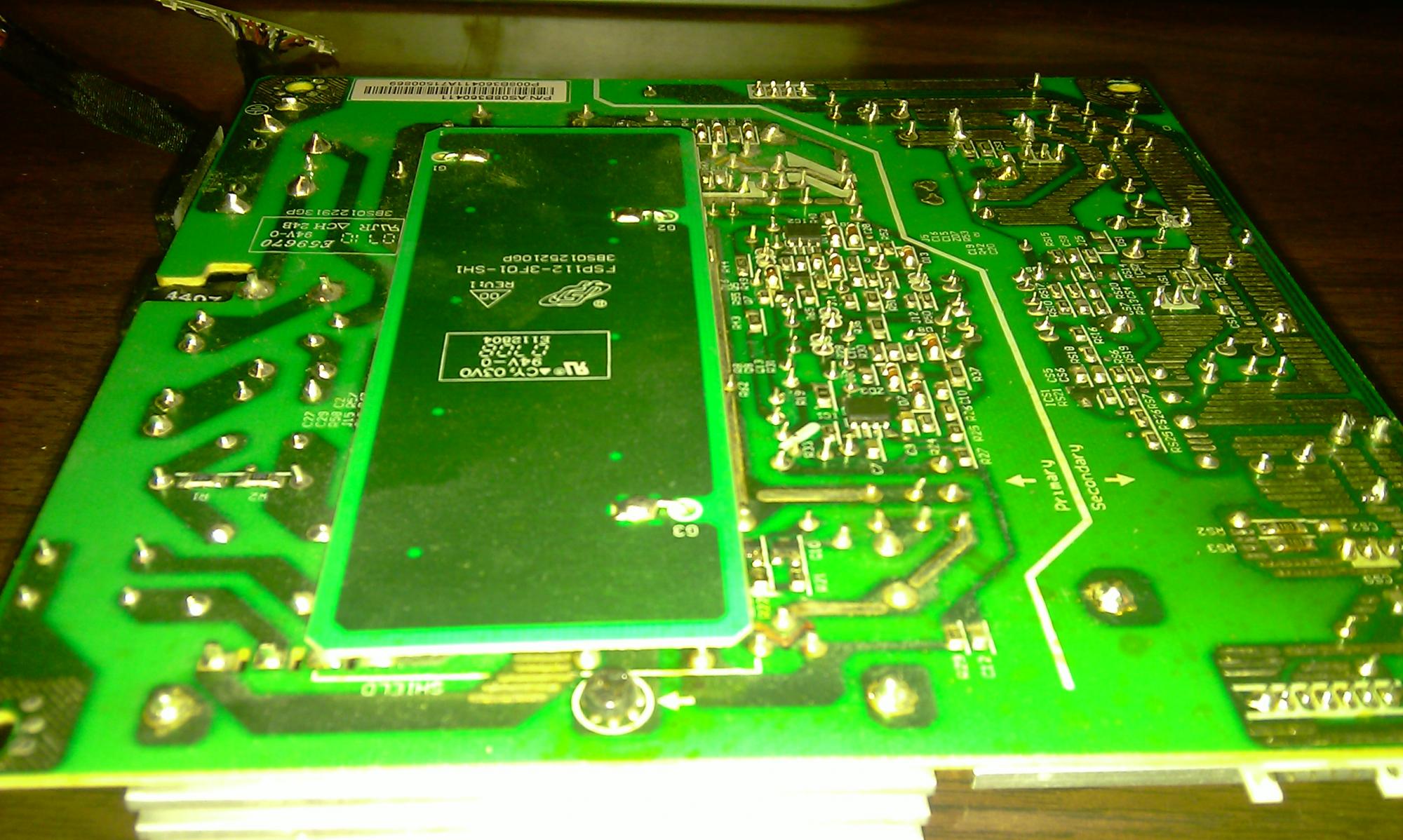

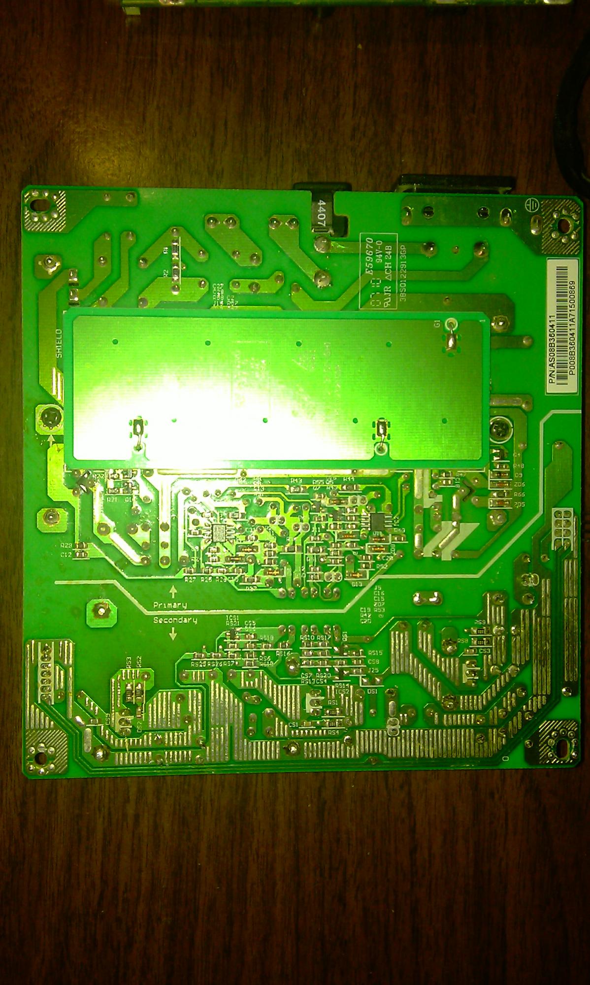

          Here are the board's backs. I have to have the monitor assembled and running to check the voltages right?

            Hi - On the whole pictures are fairly poor - you need good natural light and take them looking straight on.
            They should be as clear as this one:
            https://www.badcaps.net/forum/attach...1&d=1290283049
            Yes you need to put boards together to test - some parts at high voltage so care is needed -do not touch parts other than instructed. Heat sinks always look friendly enough but can carry a voltage which will give you a nasty jolt.
            Make sure boards dont touch and that they are not on anything conductive.

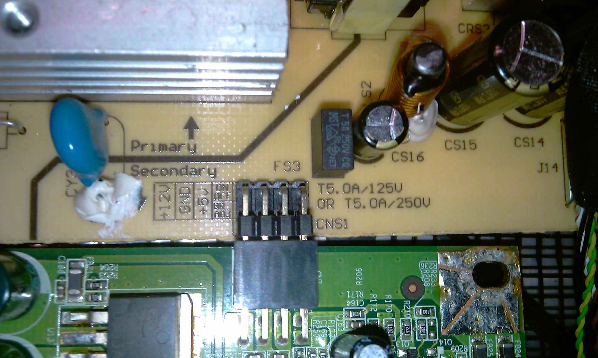

                  Well i just tested the CNS1 connectors with the monitor on standby (not connected to computer).
                  12v = 0v
                  Ground = 0v
                  5v = 5v
                  on/off = 0v
                  I'll test more soon and update but to test the capacitors i need someone to hold the board on its side while i test because of how short the wires are and how everything is laid out.
                  Edit: I checked the red fuse next to connector CNS2 and it has no resistance so its fine.

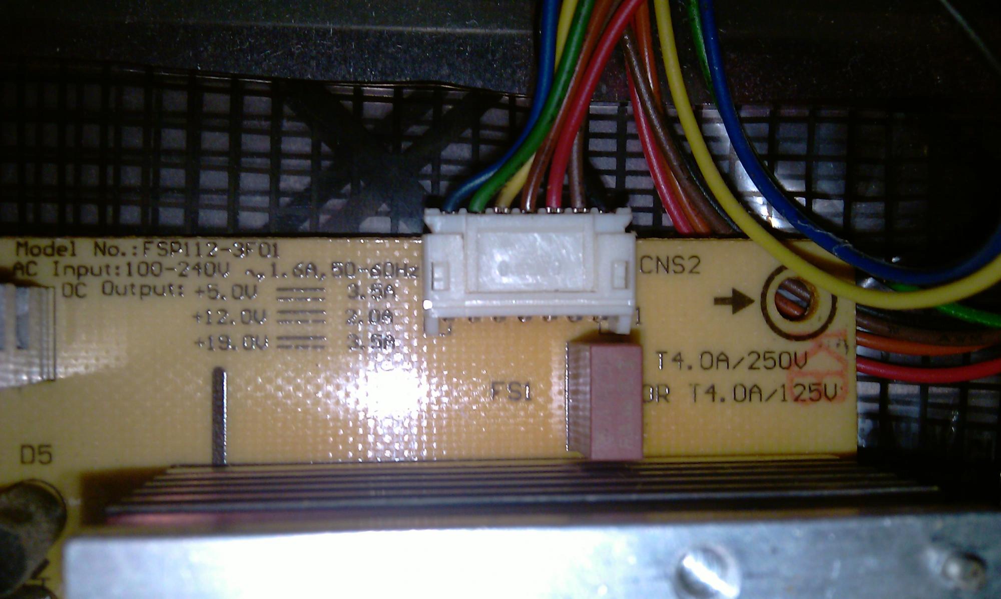

                    What about testing CNS2
                    • rockweld
                      • Apr 2012
                      • 16
                      • United states
                      Re: acer al2423w no picture
                      I didn't know how to label the wires for CNS2. It doesn't have a corresponding reference chart like CNS1. Do you just want me to label them left to right and report the voltages?

                        Hi - established way is- You see the 1 at the right hand side of the connector that is
                        to notify Pin 1 is at that end. So start at that end as pin 1 -i.e. work right to left.
                        Capacitor voltage checking is of value but comes further down the list of checks - (dont often get that far.) other than perhaps checking the BIG cap but that is a high voltage job
                        -best not to do it unless you are asked to.
                        Also back on the on/off pin can you do that again with it off and with the probes in place switch it on - -yes you need 3 pairs of hands

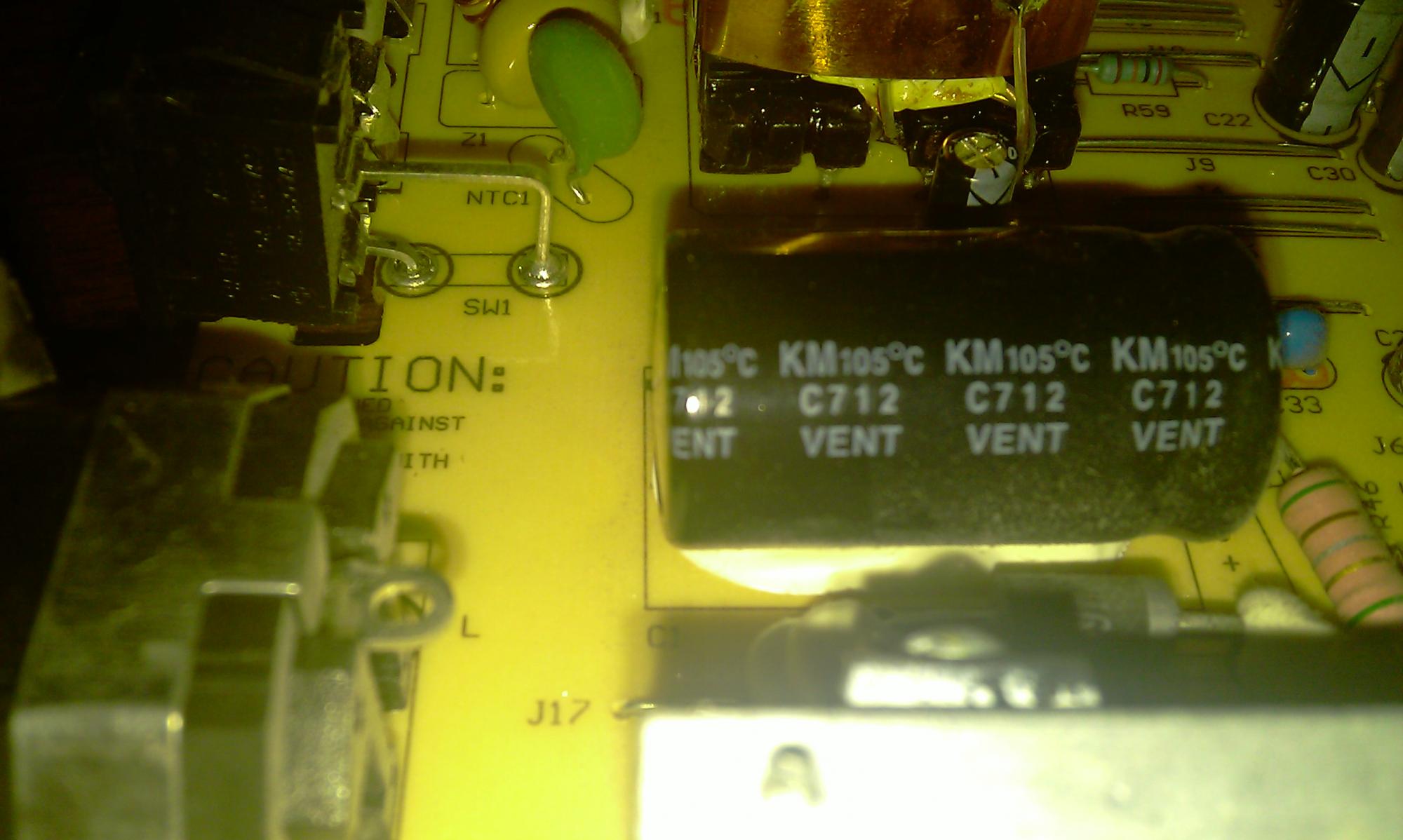

                        In Post 1 you mention a small cap bulging on the video board - which one
                        • rockweld
                          • Apr 2012
                          • 16
                          • United states
                          This one. I pushed on it a bit to see if anything was coming out and how flimsy it felt so it was up a little more then it looks now. Maybe i should just replace all of these Teapo caps since you said they commonly fail without external symptoms.

                              CNS2 out looks like this, from right to left.
                              1. 3v
                              2. 230mv
                              3. .6v
                              4. .5v
                              5. 230mv
                              6. 30mv
                              7. 30mv
                                    12v = 0v
                                    Ground = 0v
                                    5v = 5v
                                    on/off = 0v
                                    1) Hookup the lcd monitor to a working computer so it has a signal.
                                    2) If the power LED is not green and you are getting 5V at CNS1, this suggests the logic board is not working properly. The logic board signals to the power board (via on/off) to turn on all the other voltages like 12V.
                                    3) Top down view pictures give us way more information that slanted angles.
                                    4) Due to the above, I cannot tell if you have more voltage regulators on the logic board, but I circled 3 in yellow.
                                    5) Put your black probe on a logic board ground screw.
                                    6) Put your red probe on each voltage regulator pin. There are 3 pins (ignore the fat tab).
                                    7) Report your readings like so
                                    U14
                                    part number 1084 0553AL
                                    pin 1 = 0.0V
                                    pin 2 = 3.3V
                                    pin 3 = 5.0V

                                      The primary capacitor looks like it is bulging.
                                      • Per Hansson
                                        • Jul 2005
                                        • 5895
                                        • Sweden
                                        Yes I agree, the primary capacitor looks like it is bulging.
                                        You could try replacing that and see how that works out...
