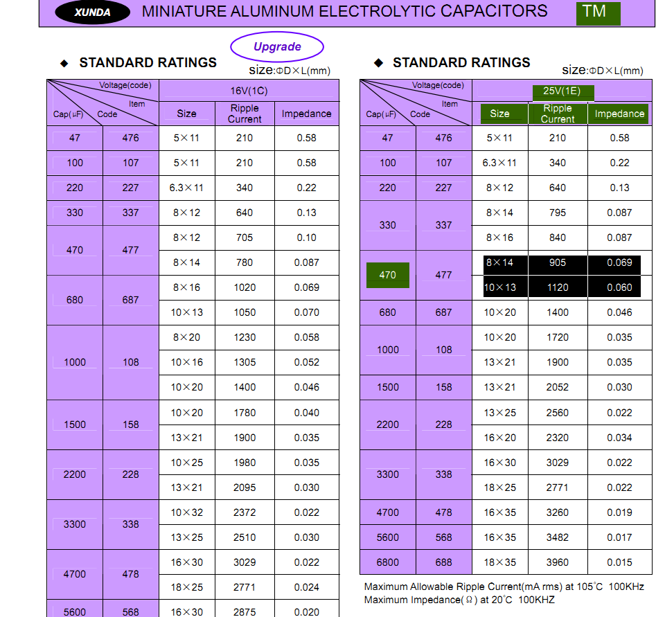

                Unfortunately, SD263 doesn't tell me anything... it might be a code for a series of chinese capacitors made by various companies there. So the technical specifications might vary from manufacturer to manufacturer.
                Further, you say the new ones are 8mm in diameter... 8mm is usually used for capacitors rated for lower voltage or for less capacity. So this makes me concerned about how much voltage those capacitors would actually be able to stand or how reliable they'd be in time.
                With all this in mind, I'd suggest not to use the capacitors you bought.
                Xunda is also not so popular Chinese manufacturer, but at least they have a website here: http://www.chinese-xunda.com/cn/product.asp
                You can find there the TM series datasheet, which tells you it's a "low impedance" , "high ripple" series of capacitors.
                Further down in the datasheet you find the 470uF 25v in two sizes:
                8x14 905mA ripple, 0.069 ohm impedance
                10x13 1120mA ripple 0.060 ohm impedance
                As you say the new ones are smaller, this means you probably have the second option installed, the 10x13 capacitor.
                So now you can go in various stores and pick capacitors which have :
                - equal or higher ripple value
                - equal or lower impedance value
                - equal or higher voltage rating
                - same capacity
                - that fits into the area you have on the board
                As you don't say where you live, I can't tell you where to buy from, but I'm going to default to US and suggest you to go here:
                http://search.digikey.com/us/en/cat/...luminum/131081
                There, you can pick 470uF, 25v, then sort by ripple value and look up the manufacturer and series of each capacitor that has higher ripple, lower impedance and would fit on your board.
                If you're not in US, you can then look up those series on eBay or local stores.

                                    • mariushm
                                      • May 2011
                                      • 3799
                                      Re: my capacitors are different sizes (help)
                                      You said the capacitors on the board have the markings XUNDA and TM.
                                      Xunda is the maker, TM is the series.
                                      In one of the first posts, I gave you link to the list of products Xunda sells, which has a PDF there linked, with the title TM - that's the specifications for that capacitor. Here's a copy of that pdf, as the chinese site is slow:
                                      Your capacitor is defined by the capacitance and voltage rating - 470uF and 25v. You go down in the datasheet and you find there the section where the voltage rating is 25v.
                                      You than go down to 470uF and you have there two sections :
                                      See the series on the top right?
                                      See the voltage on top of chart ?
                                      See the capacitance on the left of the chart?
                                      You have two sizes for this capacity, each with its own ripple and impedance (ESR) values.
                                      Your current capacitors are one of the two sizes.
