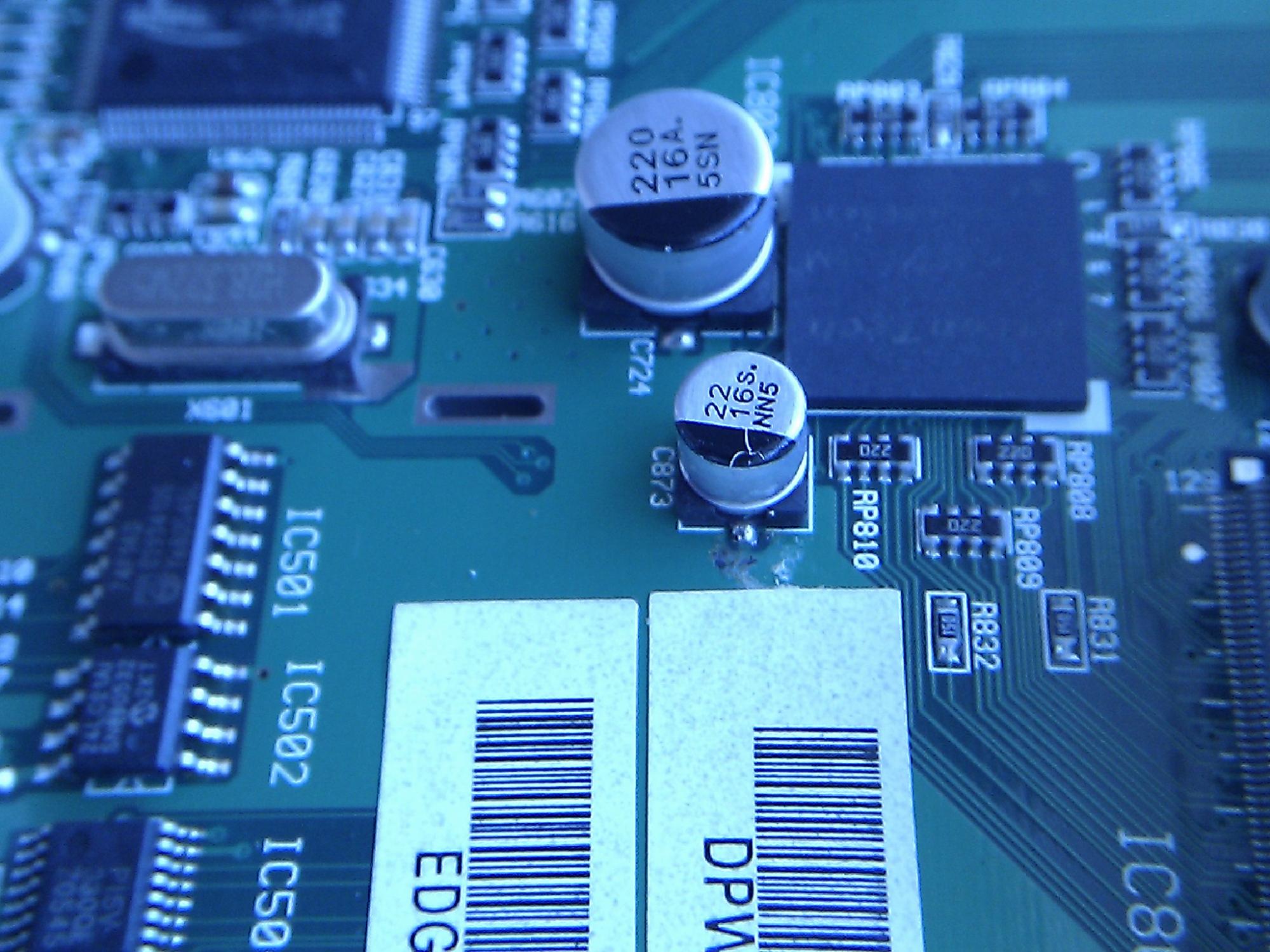

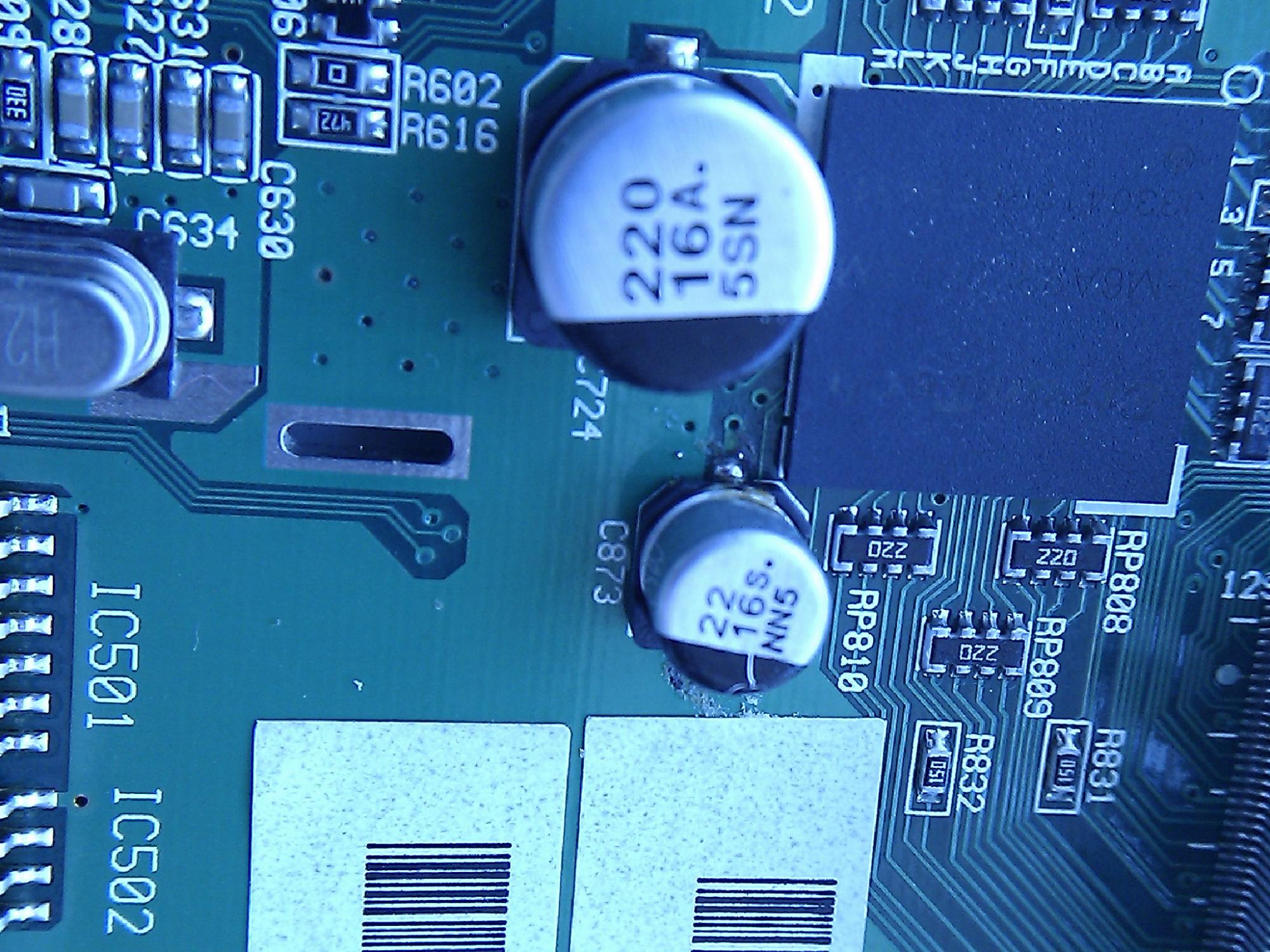

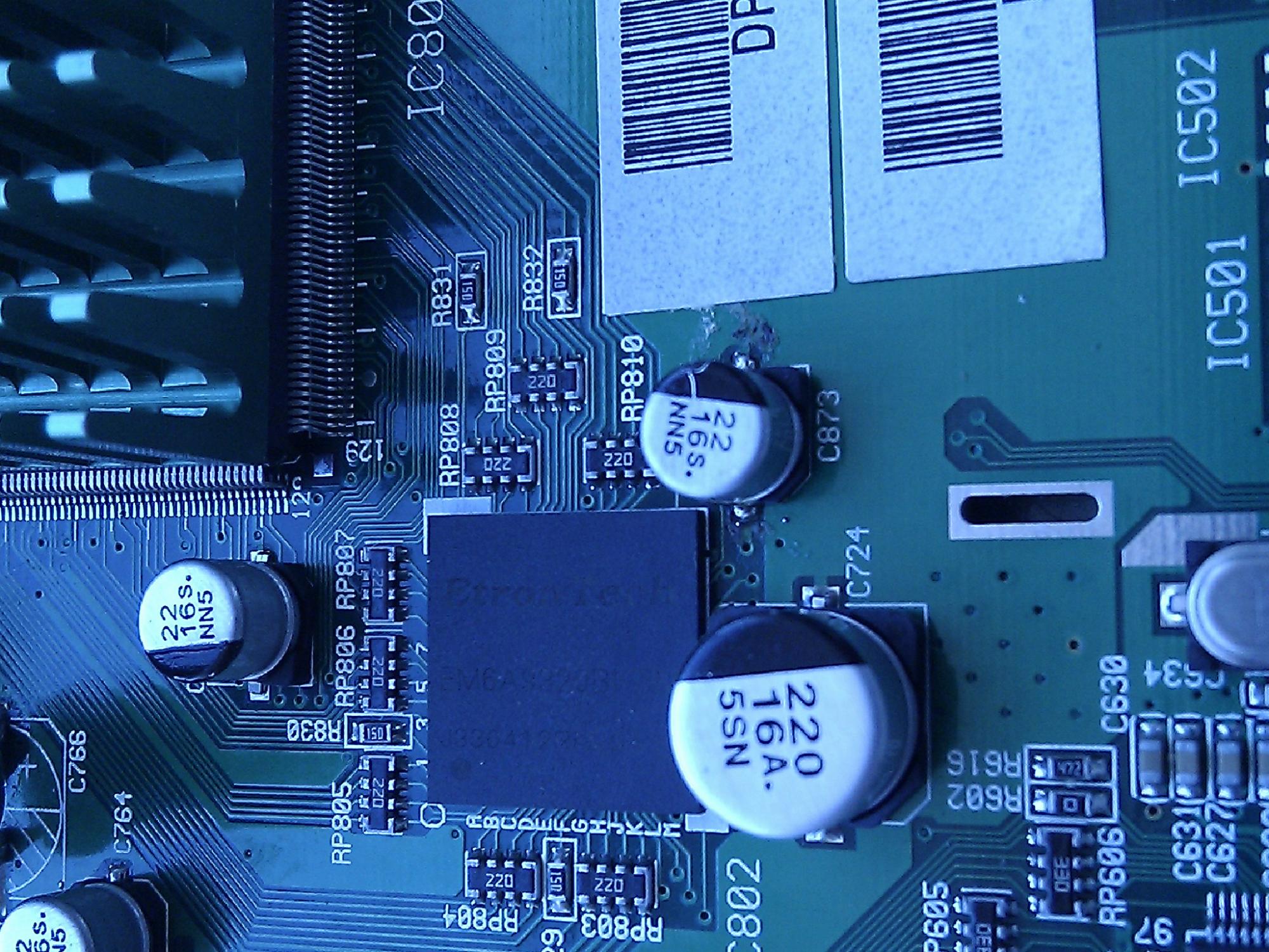

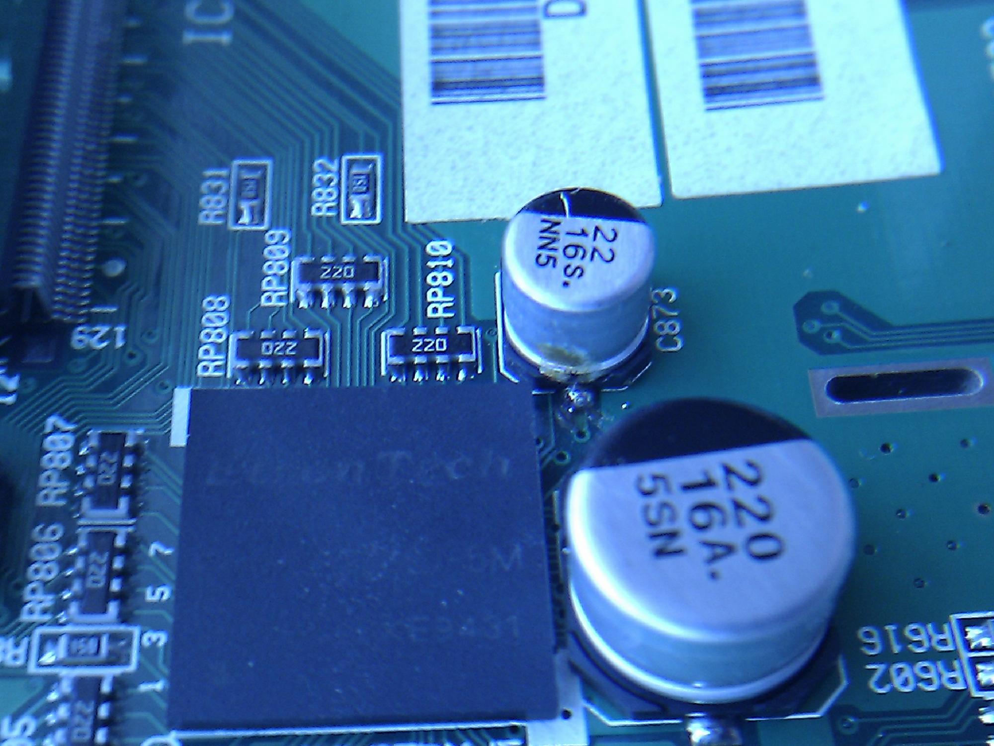

    First off please excuse my noobishness, and spare me the spankings. I have a Maxent 50x3 I am attempting to repair without destroying. It has some crazy vertical lines in front of the image that come and go but seem to be worse as the board warms up. Pressing on the main board definitely affects the picture. As does spraying duster in the vicinity of this cap. Based on the appearance of this cap would you all suspect it as being bad or does this look like flux either from manufacturing or an attempted repair? Also the paint is cracked a little do you think this is from expansion? Thanks

    Also forgot to include that I have replaced the usual suspect that other threads have suggested with no affect. Just so I don't get references to that thread.

      Someone tried fixing that, horrible soldering. Its not machine made

        Ya looks pretty shoddy, but several other joints look cold like that but without any flux residue so I'm a little confused. Do these type of caps leak? There is crusty residue on the board that could be either flux or cap crap.
