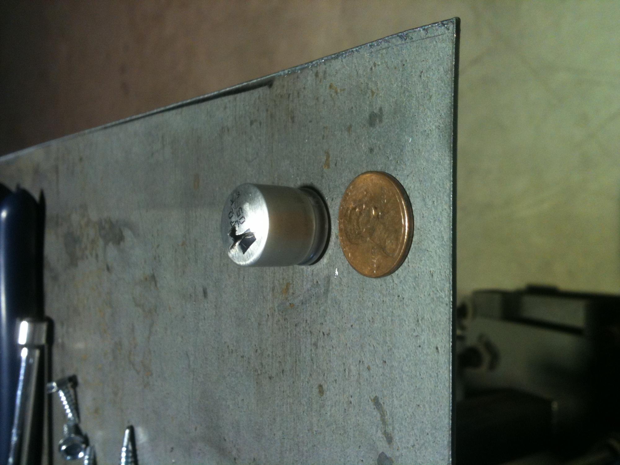

    Hello. I am in desperate need of help. I am looking for a Panasonic SMD capacitor.
    The one I am looking for has distinct marking on the top of the cap: a 470 at the top, J FK in the middle, and 05PW at the bottom of the cap with a black square to the left of these markings.
    This board came out of a Hyster electric forklift. A coworker plugged it into the wrong voltage and fried two of these caps. I have attached two pictures, but they are low quality pictures. I am attempting to take higher quality pictures.
    I have found similar caps but nothing identical to the markings of the ones we have. If anyone can provide the OEM part number or the specs it would be greatly appreciated!

    Re: Need help identifying a bad cap on forklift board

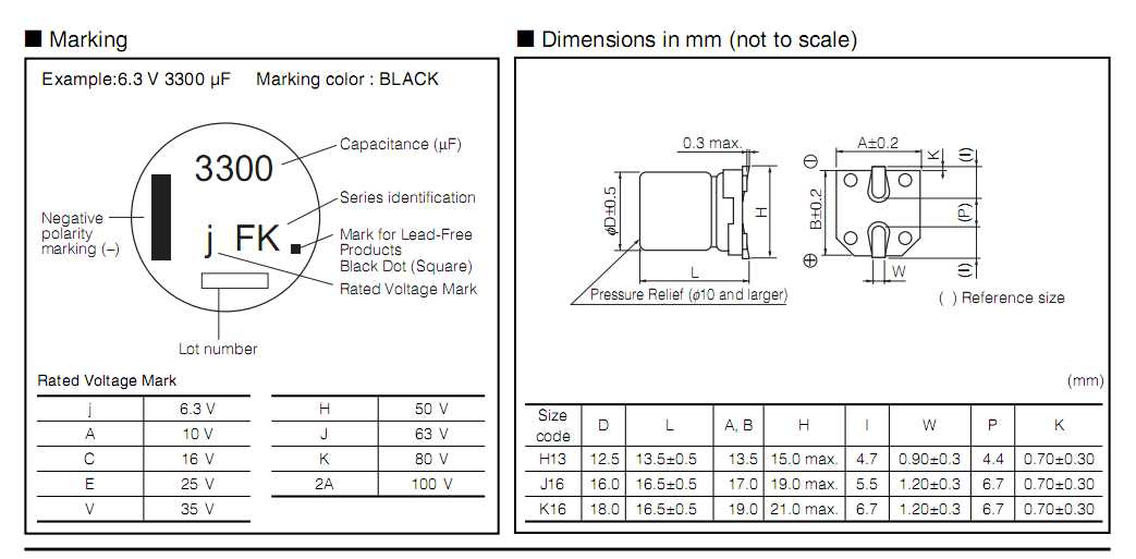

    Panasonic capacitors have that small NEGATIVE line:
    http://capacitor.web.fc2.com/solidca...#zzz_panasonic
    There is a FK series of capacitors from Panasonic.
    Here's the inventory: http://industrial.panasonic.com/www-...BA0000_WW.html
    Here's the FK series page: http://industrial.panasonic.com/www-...+ABA0088+4++WW
    And here's the datasheet:
    J = 63v , so it's: 470uF 63v smd capacitor (not polymer, just electrolytic looking like a polymer cap)
    470 16x16.5 J16 1410mA ripple 0.082 ohm impedance EEEFK1J471AM
    There's plenty of polimer or regular smd electrolytic caps that can do more than 1410mA ripple and less than 0.082 ohm impedance.
    If you need suggestions say so and we'll help. Replace all three in that area while you're at it.

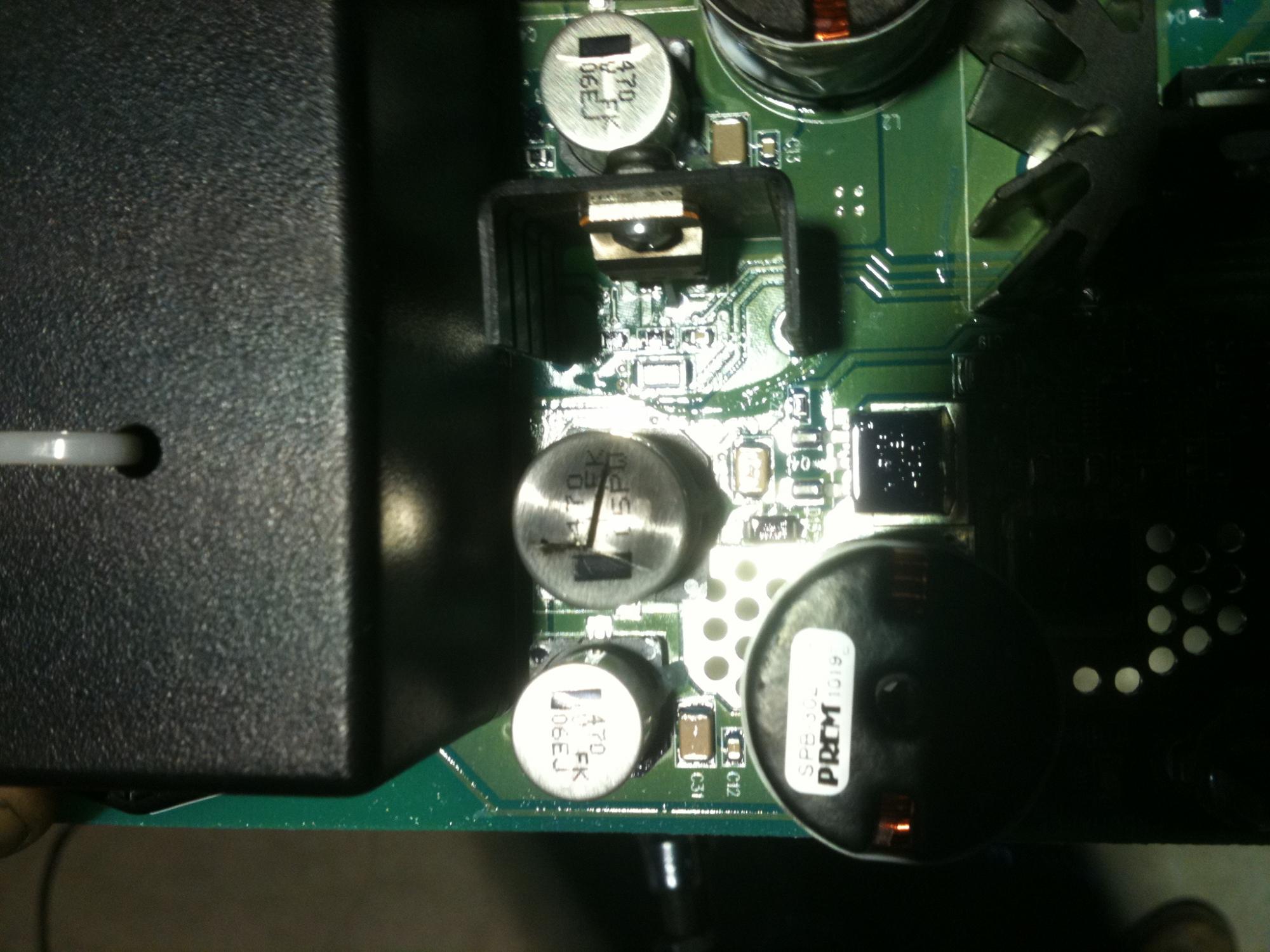

      Thank you very much! you are a lifesaver. This is all greek to me, but i am giving this information to our electrician to repair the board. There is a total of 4 smd caps, two are the one i described and two have a 470 V FK 06EJ for the markings. Per your suggestion, we should replace these too correct? And i would really appreciate any help on any suggestions for other caps to use in place of this.
        In your second picture, you have 3 capacitors. They're at various degrees of quality - if one is fallen, it could be the others are perfectly good or could be also on their way out.
        They're cheap enough (usually under 2$ each) that it's not worth taking your chances and have them die after a few months, making you waste time again... you should just replace all three.
        I only see three, if you have four there, by all means, you should replace all four.
        It looks to me all three are 470uF, but I'm not sure (due to the flash from the camera) that they're all J (63v), but the datasheet lists several letters which tell you the maximum rated voltage:
        Rated Voltage Mark (mm)
        j 6.3 V A 10 V C 16 V E 25 V V 35 V H 50 V J 63 V K 80 V 2A 100 V
        If you can't tell the maximum voltage by letter, you can usually determine it by measuring the sizes of their bottoms and the height of the actual capacitor - the proportions are usually different depending on voltage and they're all listed in the datasheet.
        When selecting replacement capacitors, you don't have to go strictly with that same manufacturer and series - in your case Panasonic FK. You can select other brands but you must pay attention to the "footprint" (so you will be able to solder it in the place of the old ones) and then make sure they're just as good as the old ones.
        You need new capacitors to have at least as much ripple as the old ones (1410 mA) in your case, and at most 0.082 ohm impedance.

            Originally there was four on the board, two different ratings. Our electrician pulled out the two that blew, which were the 470 J FK 05PW. They are in sets of two (I apologize if i get terminology wrong, this is not my area of expertise). The smaller one of the two, as seen at the top of my second picture, is a 470 V FK 06EJ. The very top cap and the very bottom cap are the same, the one in the center is the same as the one we pulled, which resides just out of frame of the picture, above the top cap.
            If i understand this correctly, the second cap (470 V FK 05PW) is also a 470uf, V=35, is in the same FK series, and has a lot number of 06EJ. With that being said, the cap i am looking for would be EEEFK1V471AQ, since its the only cap in the FK series with a 35V rating and 470uf capacitance. Is this correct?
              They also call their SMD "V" type in some places.
              So, EEV-FK1V471Q is also a valid number.
              [as so]: http://search.digikey.com/us/en/prod...64TR-ND/396276
              [or]: http://search.digikey.com/us/en/prod...2CT-ND/1879893
              And the 63v: http://search.digikey.com/us/en/prod...85CT-ND/396344
