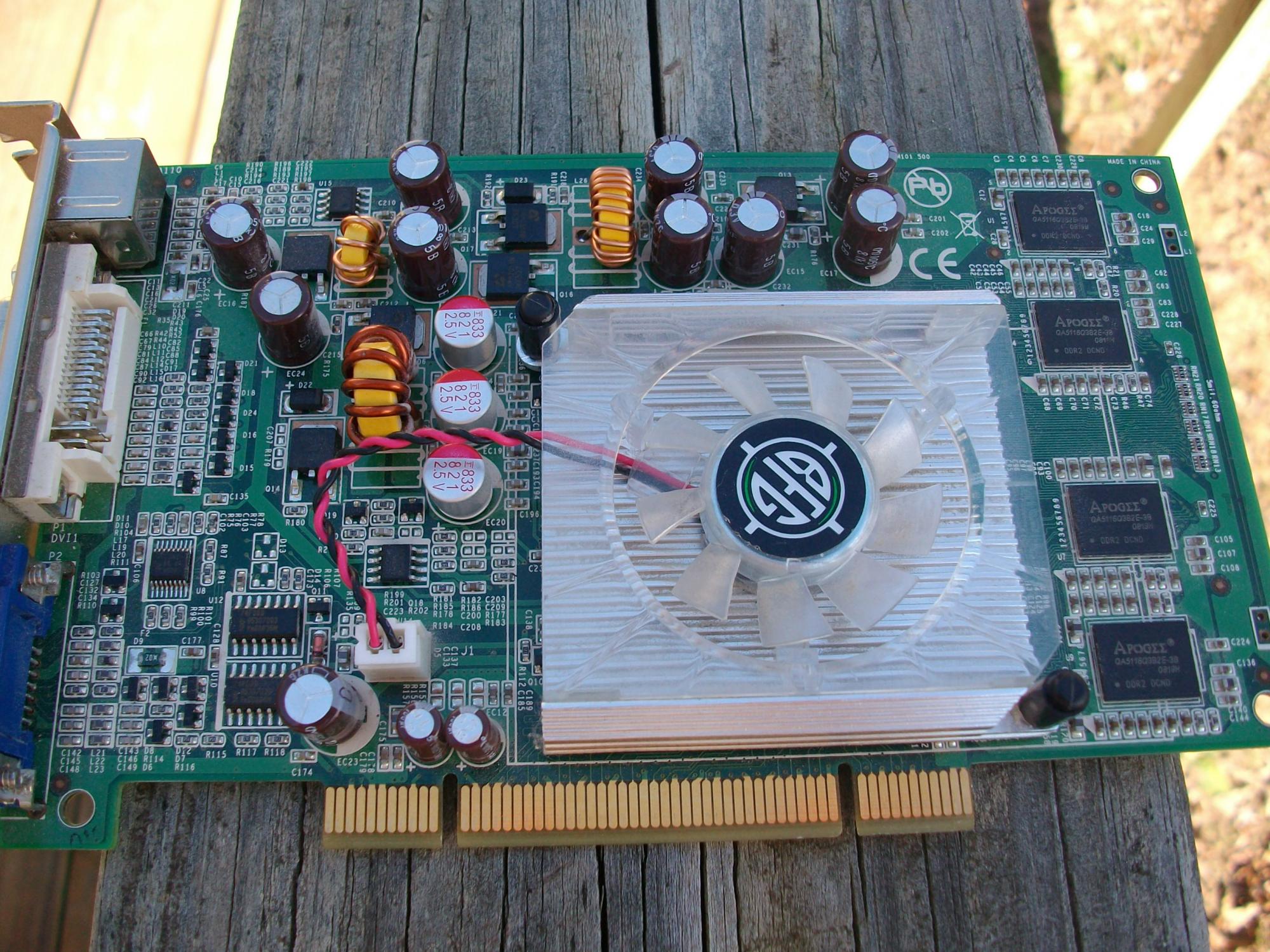

    Have an (older) GeForce 6200 card with about 10 of these on it, as well as three caps, look to be polymers. (red print, marked (F with a line on top and under it) 833 821 2.5V). Sometimes this card starts going weird to the point that a reboot is necessary. Any chance that I'm dealing with bad caps here? I'm not sure on the three small ones.

    The ones marked with F are Fujitsu, they should be fine.
    For the rest, how about you post a picture of the card?
    But generally, the KZG capacitors are bad series, wouldn't hurt replacing them - it's just a question if it's worth doing it - sometimes cards are cheaper on ebay compared to the price of replacement caps.

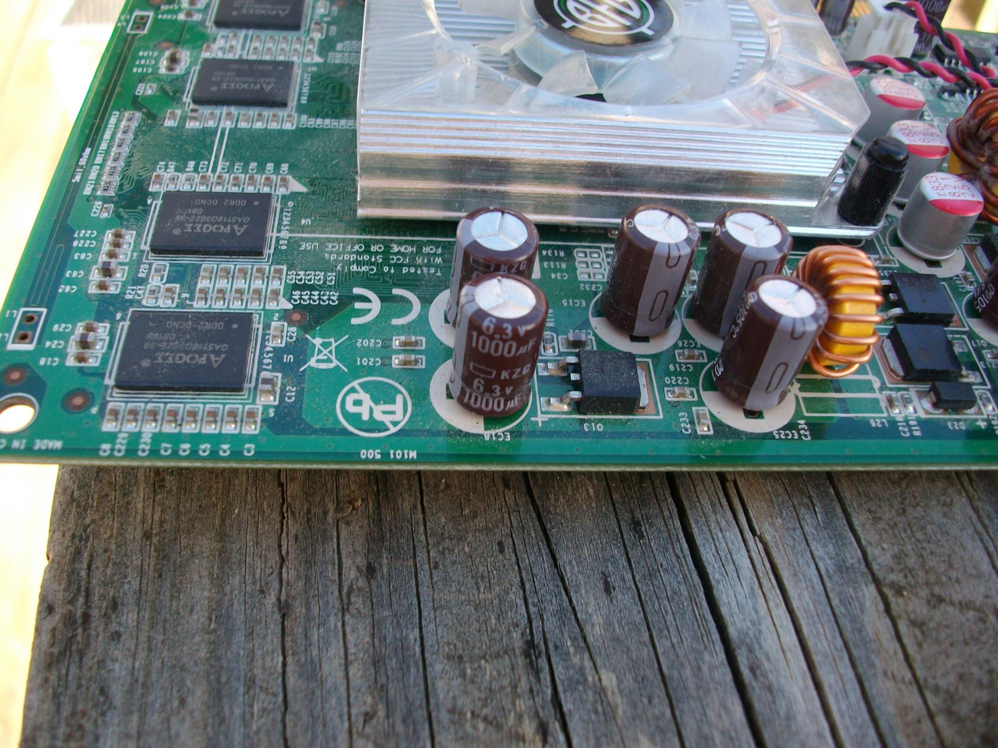

      Here ya go, took it outside to get the best possible pictures.

        KZG should always be considered bad.
        You aren't going to know if you have some other problem too unless they are replaced.
        KZG specs are equivalent to Rubycon MBZ, Sanyo[Suncon] WG, Nichicon HM,,,,,
