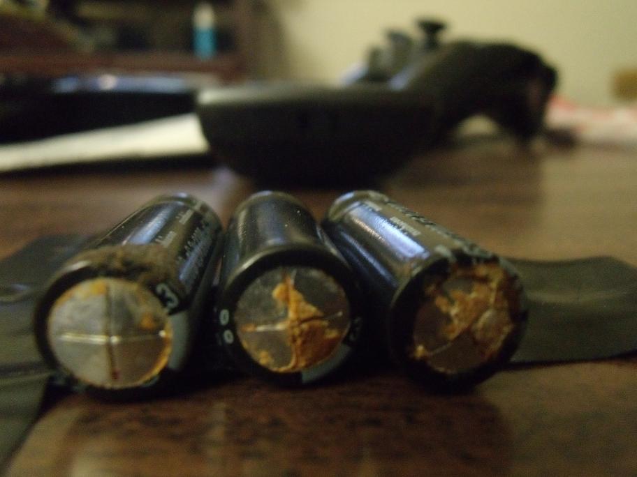

    Does replacing bad cap give much of a performance boost?
    Does replacing bad caps give much of a performance boost?

      Re: Does replacing bad cap give much of a performance boost?
      No, they won't give any performance boost. They just give better quality power to components which makes you system more stable and may give you better overclocking if you install capacitors of higher quality than the old ones.
        No... but it prevents your board from dying entirely. However, if you were experiencing random crashes, replacing the blown caps should fix that.

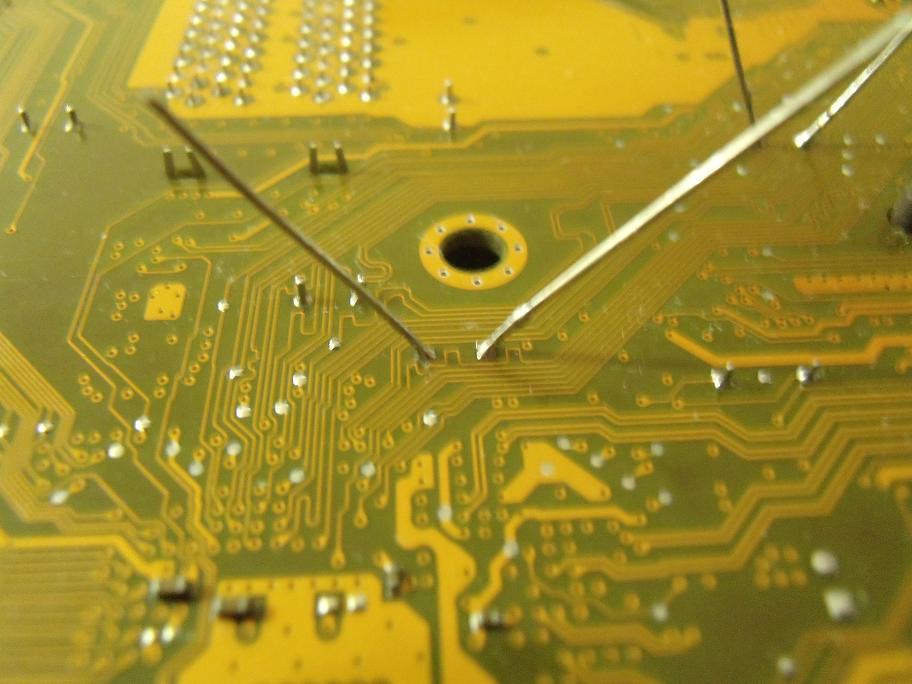

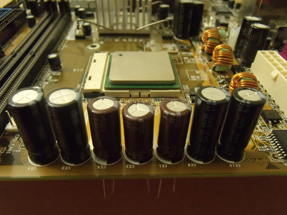

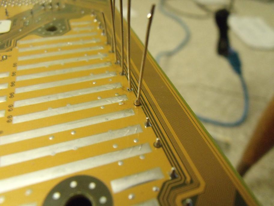

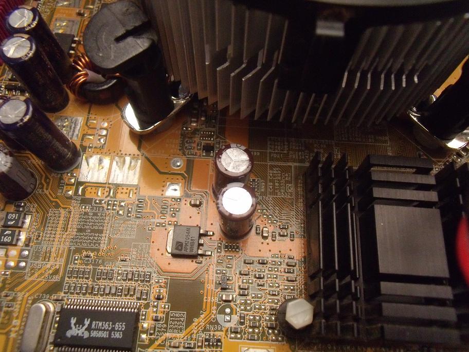

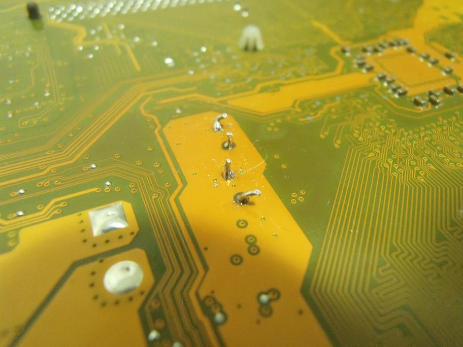

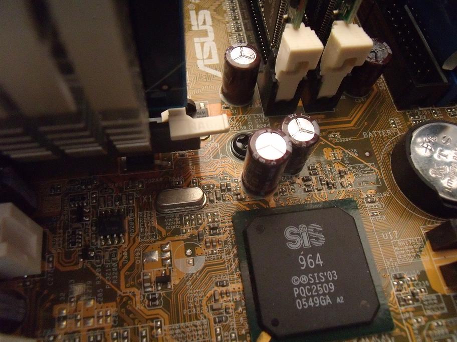

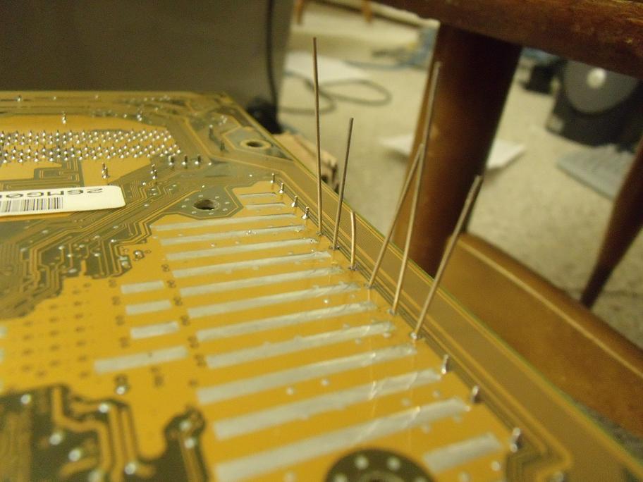

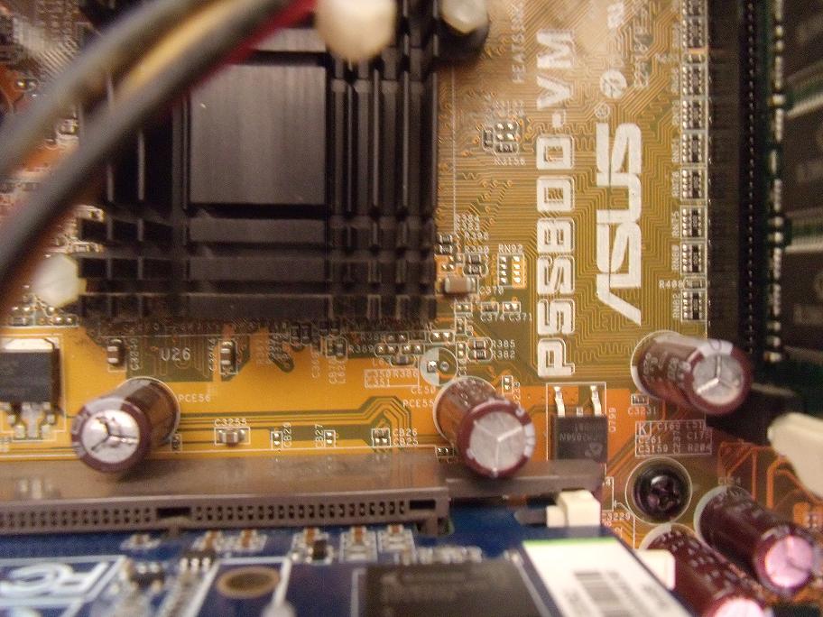

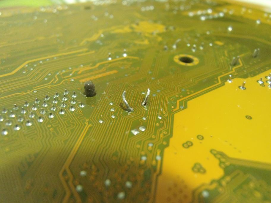

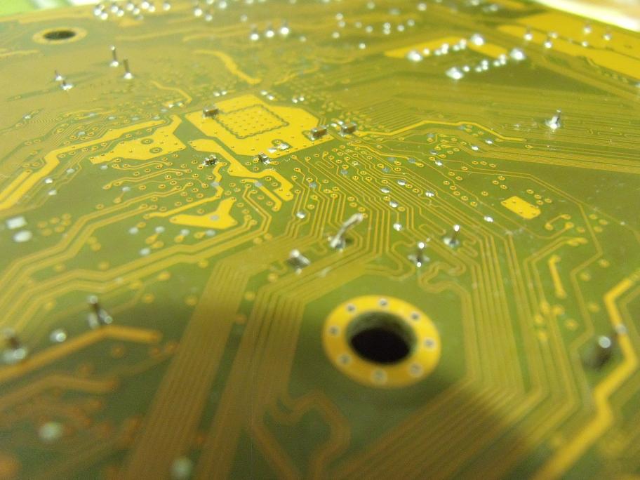

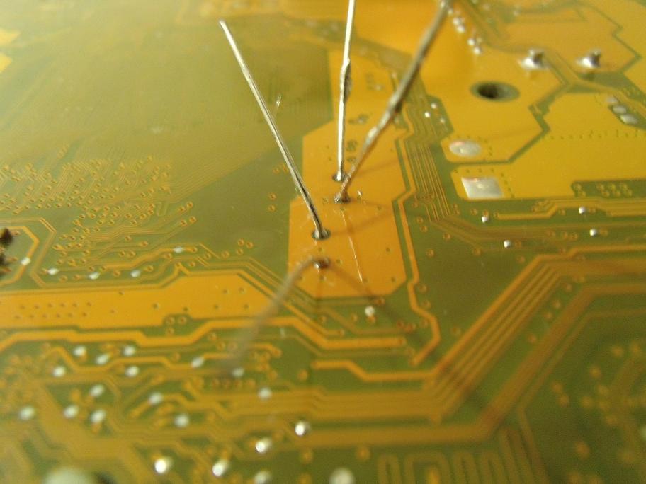

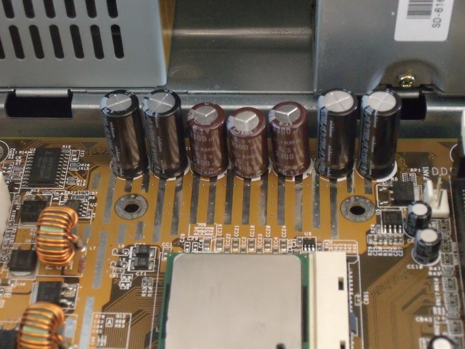

          ok thanks and those pictures are of my first 2 motherboard recaps.
          im going to go pick up 5 more caps for the first board one of the old caps went if i were to replace the rest that would be 21 more caps to replace so i am just going to do the ones cloaser to the cpu and hope for the best for now at least.
            pictures.
            That's a P4 board. Those are VRM capacitors. Likely Nichicon HM. Your replacements are Chemicon KMG, and are inadequate for use as VRM capacitors.
            Let's take a look at specifications.
            Nichicon HM 6.3V 3300uF has the following specifications:
            ESR: 0.012 ohms
            Ripple limit: 2800 mA @ 100kHz
            KMG has the following specifications:
            ESR: 0.038 ohms
            Ripple limit: 907 mA @ 100kHz (840 mA at 120kHz)
            When selecting a replacement, you generally want the same or less ESR, the same or more ripple. The KMG handles less than a third of the ripple that HM can handle, and has over 3 times the ESR.
            Good replacements for HM include newer HM (there was a manufacturing defect with older batches), Rubycon MBZ/MCZ (discontinued), Sanyo/Suncon WG, Panasonic FL/FJ.
            I would also replace all of the HM capacitors, not just the failed ones. Just because they haven't visibly failed doesn't mean they aren't on their way.

              well im a bit strapped for cash right now so i can only do so much as for the other board not the P4 the celeron with the big caps i installed windows on it and it only has a 8 mb video adaptor lol uhg whats the biggest pci vid card you can get?

                oh and about those caps i put on there i had ordered rubycon caps but the caps that are on there is what they gave me i wasnt happy about it.
                                    Hahahaha
                                    That was in the 70's...
                                    Mann-Made Global Warming.
                                    - Dr Seuss
                                    • Uranium-235
                                      Comrade Glimmer
                                      • Aug 2007
                                      • 5042
                                      • US
                                      in a way it CAN be true. If you have a bad cap giving your CPU too much juice and causing it to run hotter...some motherboard are set to downthrottle if the CPU gets hot. so in SOME instances it can increase performance...by fixing a larger problem
