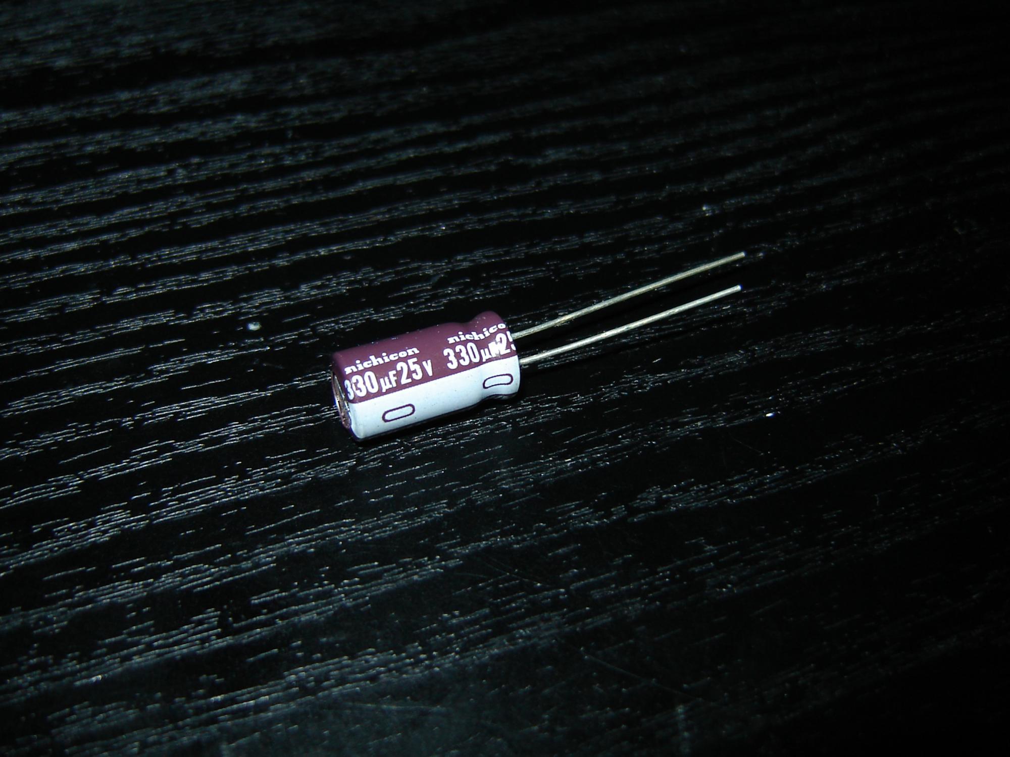

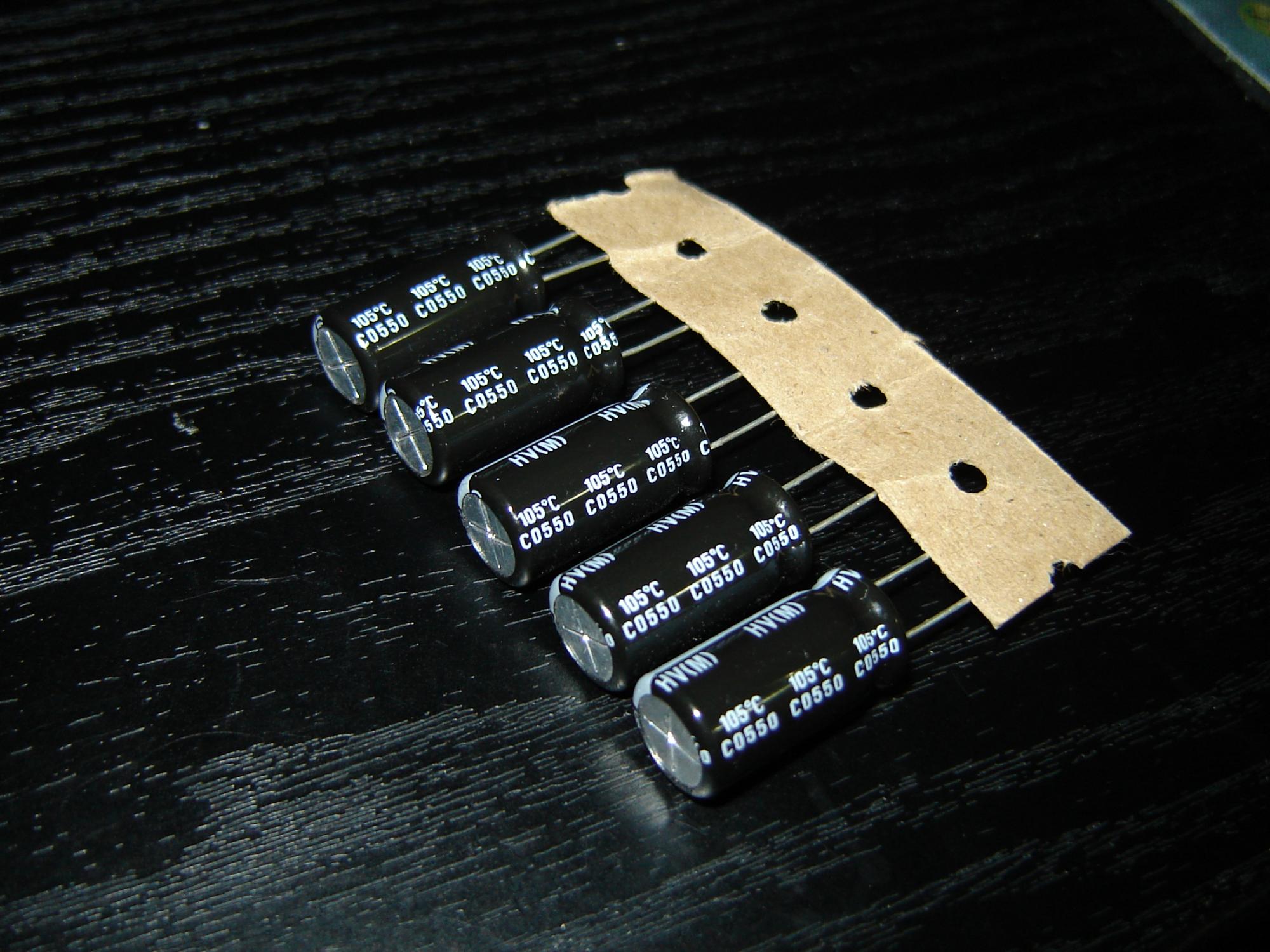

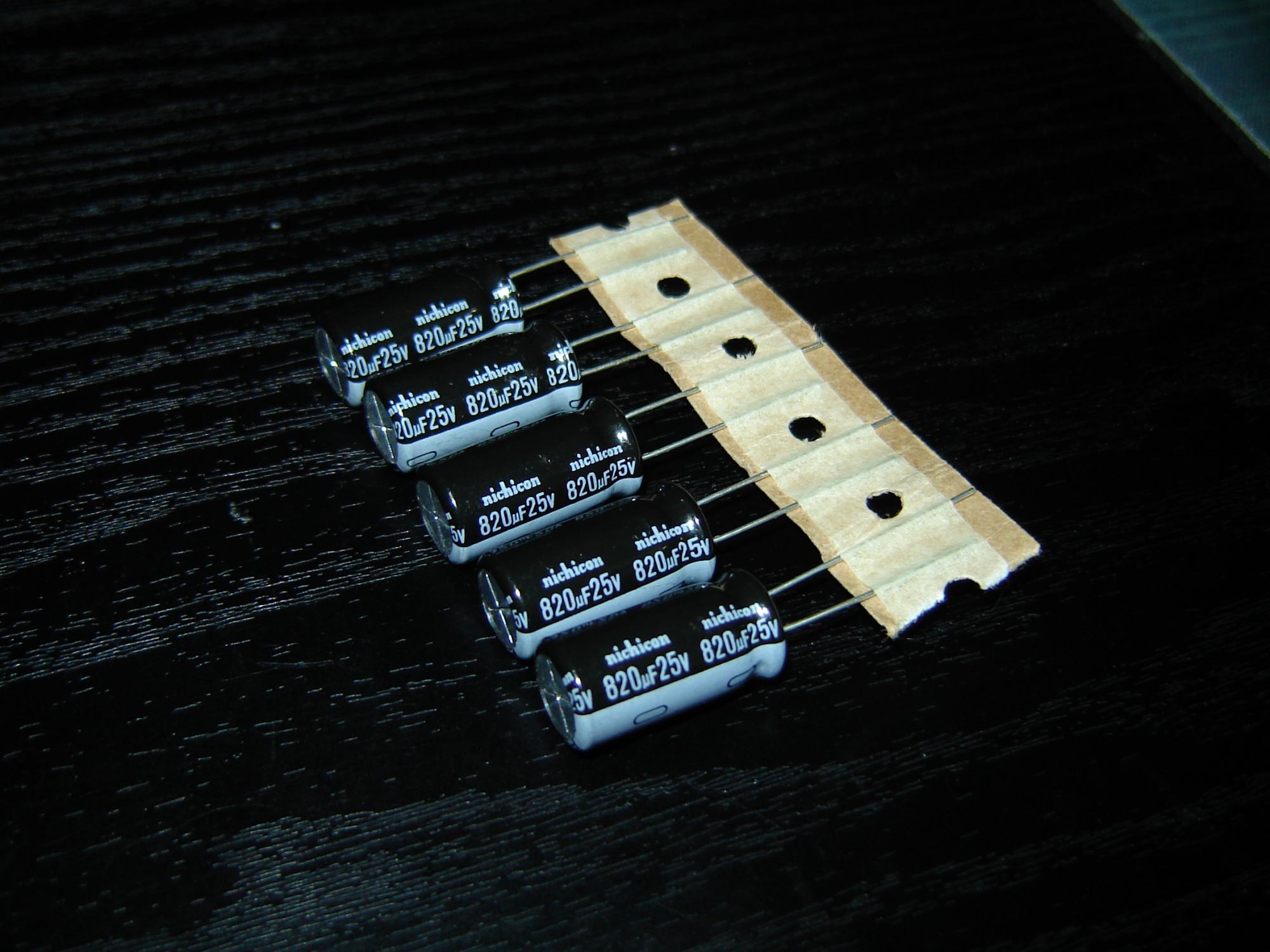

    I replaced my capXon caps in my monitor with these nichicons and there's a high pitched noise which i suspect is from overheating due to one of these caps being high in ESR?
    Black ones are 820uF 25v.
    Brown one is 330uF 25v.
    Thanks.

    My guess is the ESR for the Nichicon HV caps you used is too low. Too low an ESR causes coil whine from what I understand.
    FYI, HV is miniaturized HD. The ESR for your particular cap is 0.019.

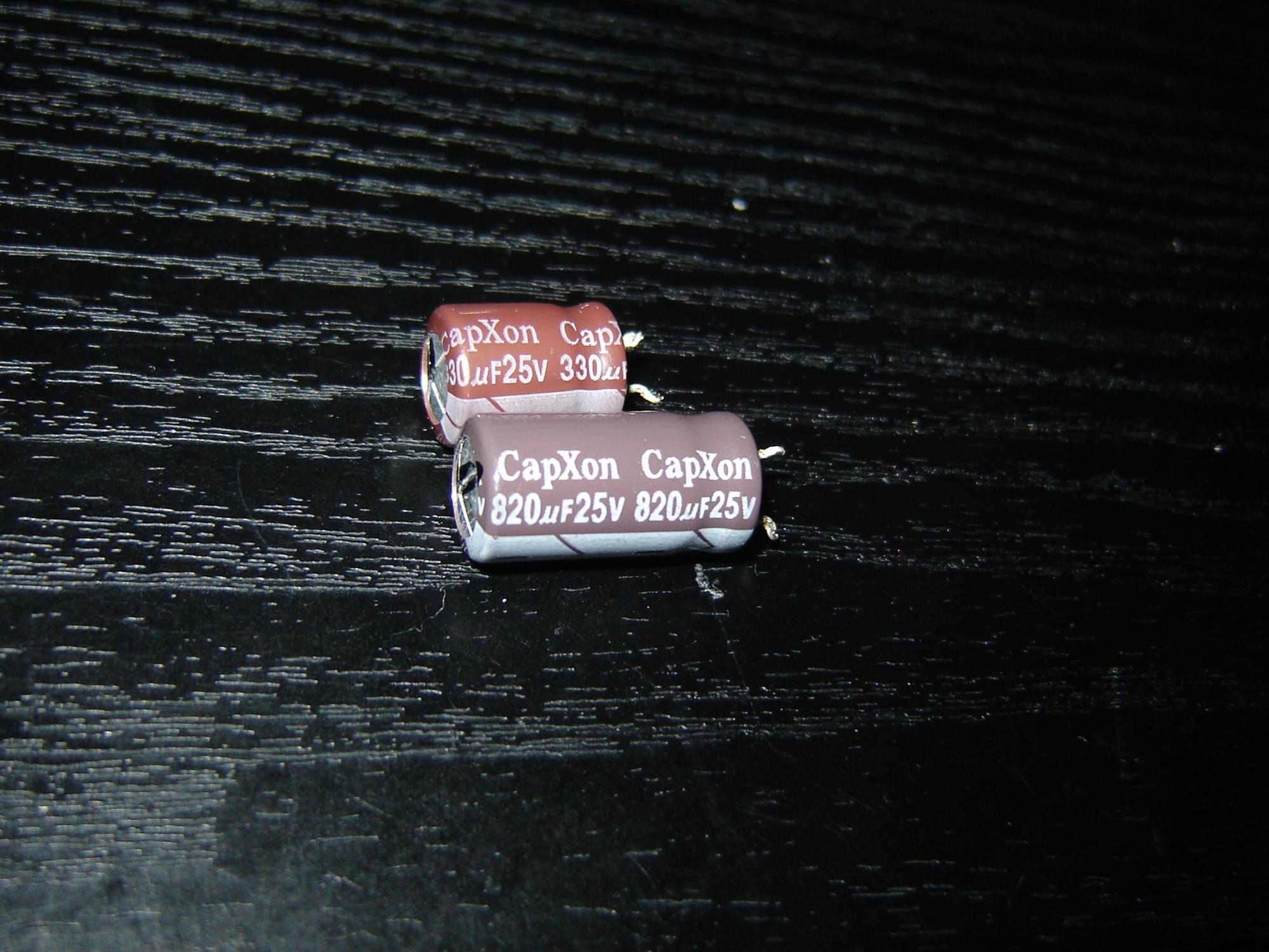

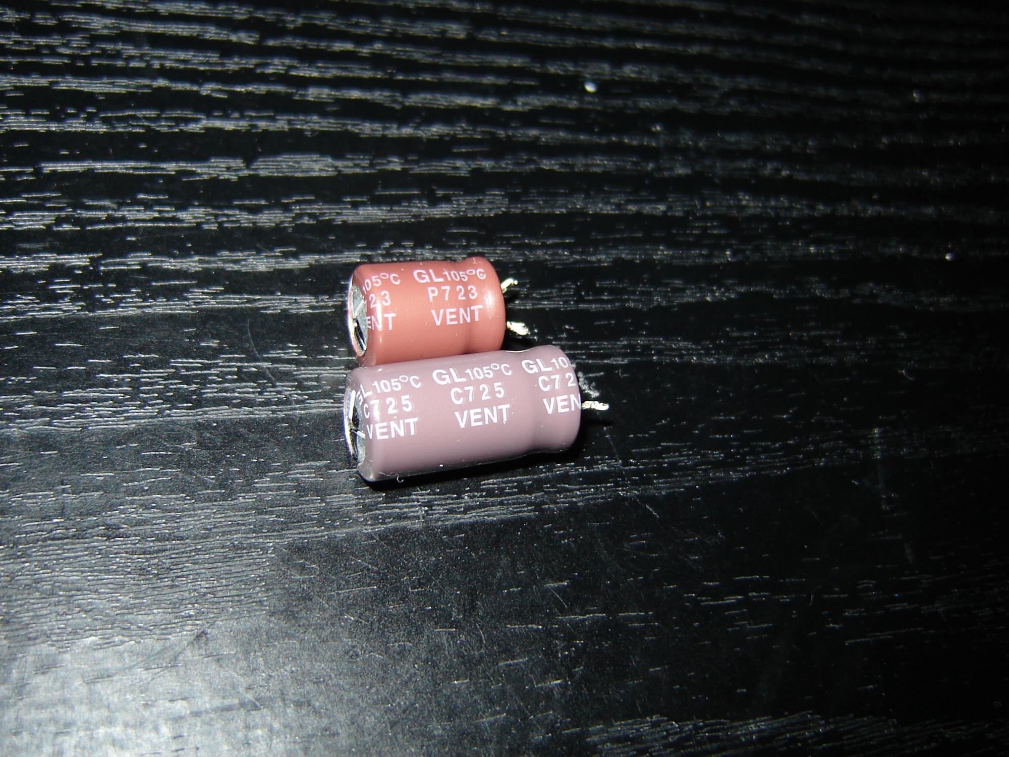

        I believe the old CapXon caps were the GL series, for both 820uF and 330uF caps. (Ive attached pictures)
        As for what exactly I did, I replaced the following on the SyncMaster 216BW PSU:
        5x CapXon 820uF 25V
        1x CapXon 330uF 25V
        with the nichicons i mentioned before.

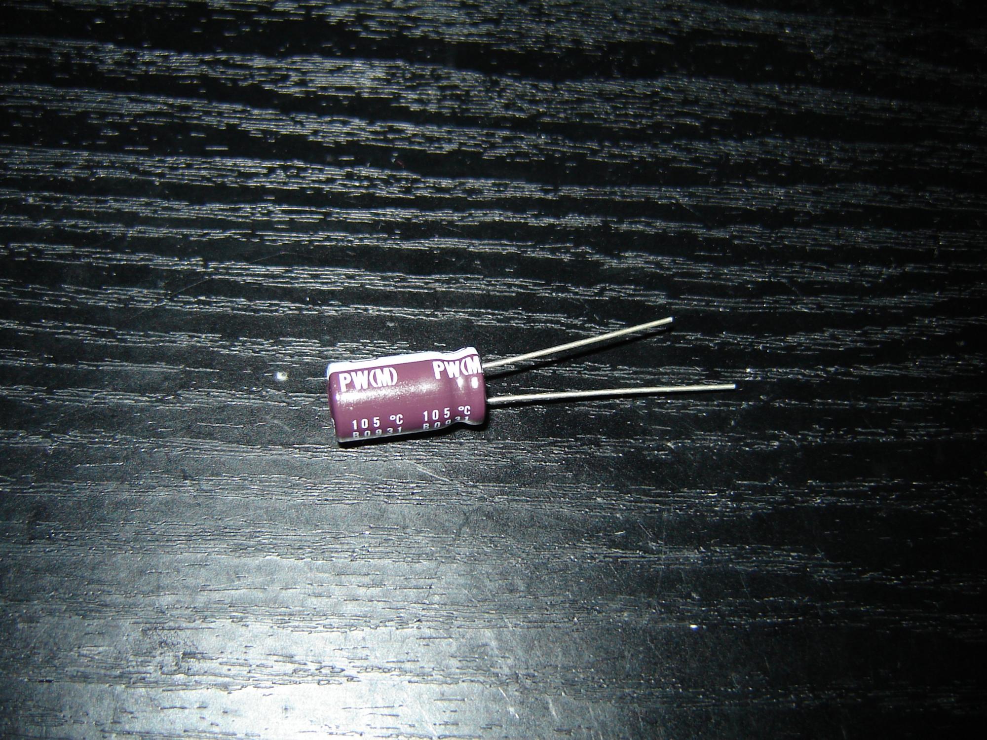

          GL 330uF 25v 10mm , Ripple -740 mA , ESR - 0.082 ohms
          PW 330uF 25v 10mm , Ripple -760 mA , ESR - 0.090 ohms
          Raising ESR is not a good thing but 0.008 ohms [10%] isn't going to kill it or anything.
          The GL specs are likely that far off anyway... LOL
          GL 820uF 25v 10mm , Ripple -1460 mA , ESR - 0.043 ohms
          HV 820uF 25v 10mm , Ripple -2180 mA , ESR - 0.019 ohms
          More than 1/2 might be a problem. Isn't always. Just sometimes.
          Look at where the 820's went in the circuit and thinking about where Ripple would go consider if any are likely to pull more Ripple through a coil or transformer.
          If the make-shift stethoscope suggests that is the area the noise is coming from then that/those cap[s] are what you need to 'de-rate' back closer to original specs.
