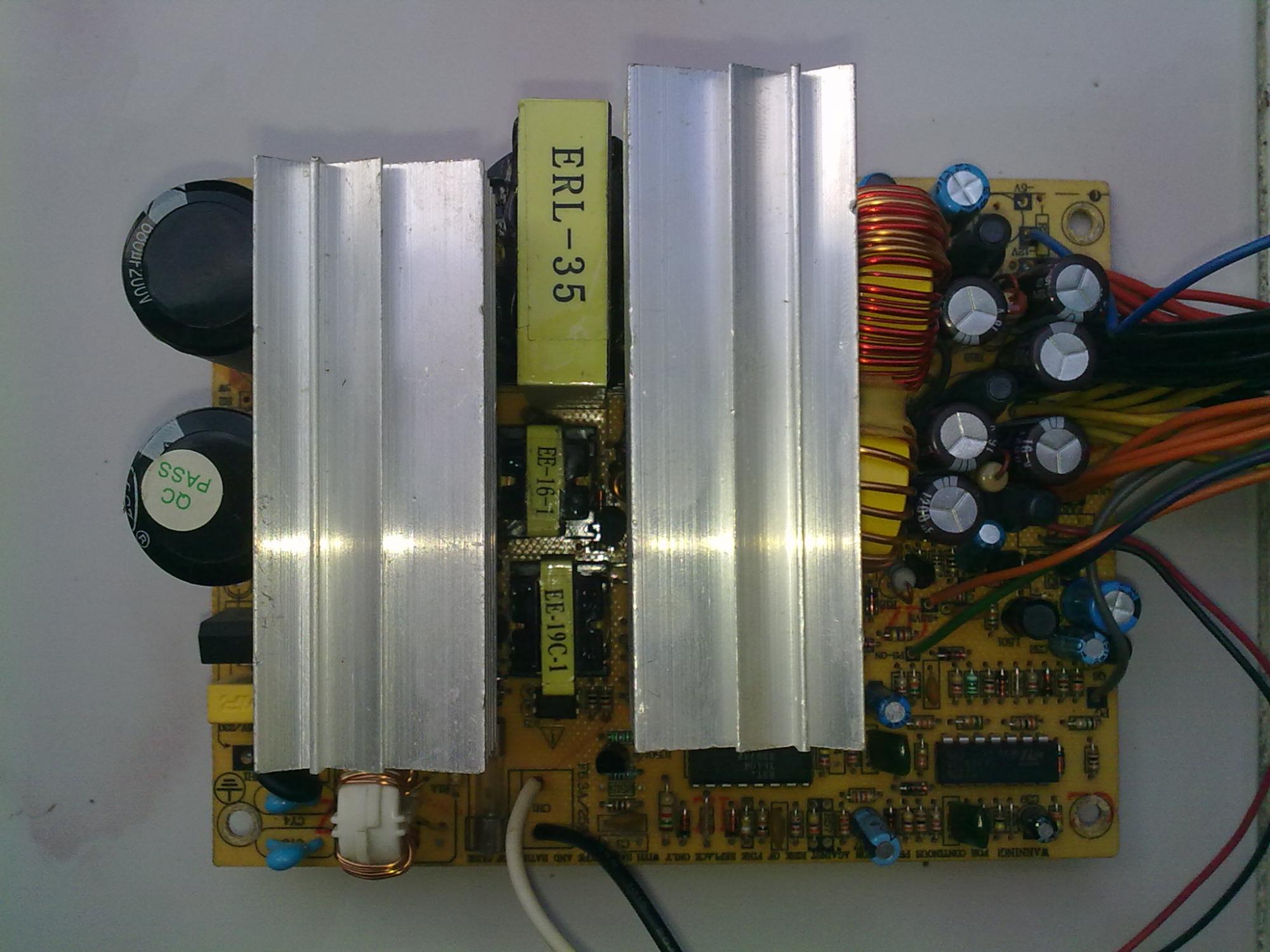

    Hi everyone, I want to know how to repair a PSU unit, how to identify wich part is broken and where to buy the replacement parts. Coz I've been dealing with a lot of faulty and even dead PSU. Is it possible to repair it?
    Right now I have a PSU that still alive but won't boot a PC, also have one that keep making problem with the Hard Drive (damage it), Optical Drive (burning failure) and also making all the Case fans dead.
    I'm really curious about fixing this thing and even make it better and more reliable than before.

      Ok, here's the picture. There's nothing burnt on this unit. But I've test it with DMM and the +5V would starts from 5.30V and then goes down and stay at 5.25V. The other Volts are still in normal range.
      Here's the caps spec :
      2x 16V 1.000uF D10mm - Nicon (Black)
      1x 16V 1.000uF D8mm - Nicon (Black)
      2x 16V 220uF D8mm - Nicon (Blue)
      4x 10V 1.000uF D10mm - Nicon (Dark Blue)
      1x 50V 100uF D8mm - BH (Purple)
      3x 50V 10uF D5mm - BH (Purple)
      2x 50V 2.2uF D5mm - Nicon (Blue)
      2x 50V 1uF D5mm - Nicon (Light Blue)
      2x 200V 680uF D22mm - LCZ (Black)
      The PC won't boot with this PSU, when I replace it with other PSU the PC is booting normally. I haven't test the PG since I don't know how to test it with a DMM. But this PSU has made a Hard Drive goes faulty, and all the chassis fans are busted.

        Okay, first.
        If it's killing hard drives you may be having voltage spikes that are too fast to see on a DMM. You would need an O'scope to catch that and if you don't have access to one I'd be -really- uncomfortable about putting this one back into service even after a recap.
        Some of the caps look like the first stage of bloating. Plumping up between the 'ribs' of the vent stamp but not bad enough yet to push the ribs up too.
        None of those are good cap brands.
        Does the PSU itself start and stay on, or just 'kick', or does it act dead?
        [Can tell by PSU fan running.]
        Is that +5v the standby +5v or the main +5v rail?
        Chassis fans are what voltage?

          hi HexaPro ..glad to see other member from same country (i'm indonesian too) ..
          i recently have a problem with cm rp-650-pcar psu
          that thing have a lot of badcaps ..
          my suggestion in do a full recap on secondary
          my psu now run smooth and normal ..with just only 3 recap capacitor ...yes only 3 of all secondary caps..so what happen if i recap all capacitor in secondary ?? you can imagine ..the result will be awesome
          @PCBONEZ .. in my country, the generic case fan running almost from +12v

            Originally posted by PCBONEZ
            Okay, first.
            Ok, I'll note that. But I don't have any O'scope.
            I've replaced all the output filter caps (16V 1.000uF & 10V 1.000uF D10mm) (6 Total) with a used 6x UCC KZG 16V 1.200uF just to test it. I'm planning to poly mod the PSU.
            You're right, I also laugh when I read the brand. Sounds like Nichicon fake, hahaha...
            The PSU stay on, but it won't boot. I don't have the complete note of all the rail voltage since I think they're all fine accept for the +5V rail.
            I've test all the rail for the +5V and it score the same value 5.25V
            holmes222 is right, I've checked the fan voltage and it connected to the 12V rail.
            I just found out that there's a resistor that's not soldered on one lead (What a great QC). So I put in the lead into the corresponding post hole and soldered it. now the +5V reads 5.12V or 5.16V (I forgot to write it down) and it would boot the PC properly now. What a silly problem.

              Re: How to repair PSU?
              secondary i mean ..filtering output caps for all rail
              the last that goes to cables ..
              also the caps that near the +5vsb need to be checked if going bulged
              what brand is it ?? acbel??enlight??other??
              • mockingbird
                • Dec 2008
                • 5484
                That looks like an old Young Year (Circa '99 - '01).. I tried to recap one of those, all I got was a spectacular flash and a blown fuse when I gave the thing power.

                    Youngyear, Sunpro, Golden Tiger, etc... all make a variation of this design. It's a common design among small Chinese manufacturers. Is it worth recap? Not with high quality ones, and shouldn't be used in a working computer.

                      Simbadda SimCool 430W. Please don't laugh
                      It's not the best, but It's quite good I guess by the look of the Transistor, Rectifier, etc. I sell these SimCool and it's more stable and it's still better than those Sim-X, Mentari or Okaya PSU which always making a reboot problems. I'm thinking about replacing it with Simbadda 500W (Lifetime Warranty) when this unit is broken beyond repair.
