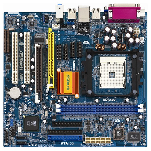

    Hello, my sister was having some stability issues on her computer. I noticed that 5 of her 3300mf 6.3v caps were bulging. I replaced them with Rubicon caps and the mother board now shows no signs of life. All the filets look good. I am using Kester 63/37 .031 ra flux core solder. I pre-tinned and fluxed the pins prior to soldering and keep the act of soldering to about 3 seconds. I do my best to follow IPC protocols. I am using a Metcal PS2E-01 station and a 700F 1.78mm chisel tip for the ground plain side and a 600F 1.78mm chisel tip for the positive side. I pre-fluxed the filets and used my Soldapult to de-solder the filets. The positive side was clear and ready to pull out. The ground plain side required a little additional heating to pull out.
    I have repaired many motherboards over the years and have only had this happen one other time, but it would only occasionally boot up but would only run a few minutes before locking up and would fail to re-boot. I figured that it was just unrepairable. Plus, it was a socket A Foxconn.
    Any thought or suggestions would be appreciated. Thanks.

              Asus is known for reverse cap markings on the board. Are you sure you installed the new ones with the POSITIVE on the WHITE half?
                SOB!!!! Pardon my acronym. I think you nailed it right on the head. I was so used to the white side being ground that I did not notice that is is reversed on this board. What a lame mistake. Well, that is why forums like this sometimes exist is to straighten out stupid mistakes. Wow, thank you very much. Should I just junk these caps or do you think that rotating them to the correct alignment is adequate? Thanks again.
                P.S. I will post the outcome of getting the cap orientation right when finished.

                  A common error. Older and wiser have FUBAR'd worse, trust me.
                  I'd just rotate them. In all likelihood, and since you did it to all of them, the PSU was shutting down because of the overload. It probably saved them.

                    Unfortunately rotating them changed nothing. I hope replacing them will all new caps will do the trick and I have not toasted the motherboard. I wonder how many times the PCB can tolerated changing caps before damage? I really do not look forward to telling my sister that I broke her computer

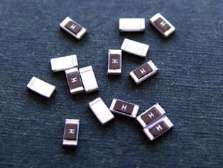

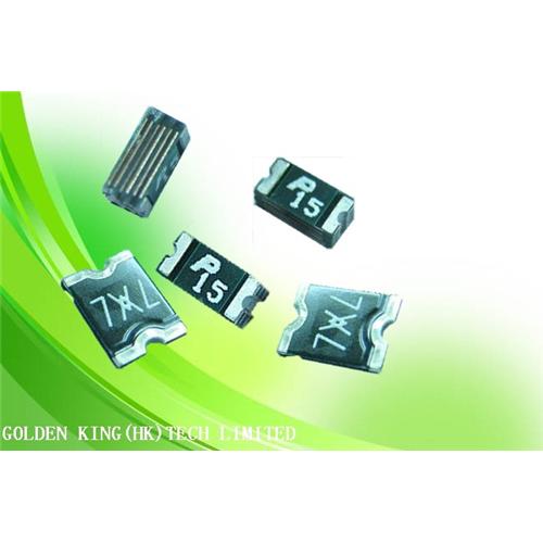

                      Since the pic I provided is small and unclear, I can't see if there are any fuses back near those caps. They will be flat, thin, chip SMD devices with little ) ( on each end about a 1/4" long X 3/16" or so. Probably marked F#. Look around.
                      The FET's may have been toasted, but usually they are -obviously- overheated. If the OCP was working on the PSU, it's doubtful they were harmed.
                        I did not find any -obviously- blown FETs
