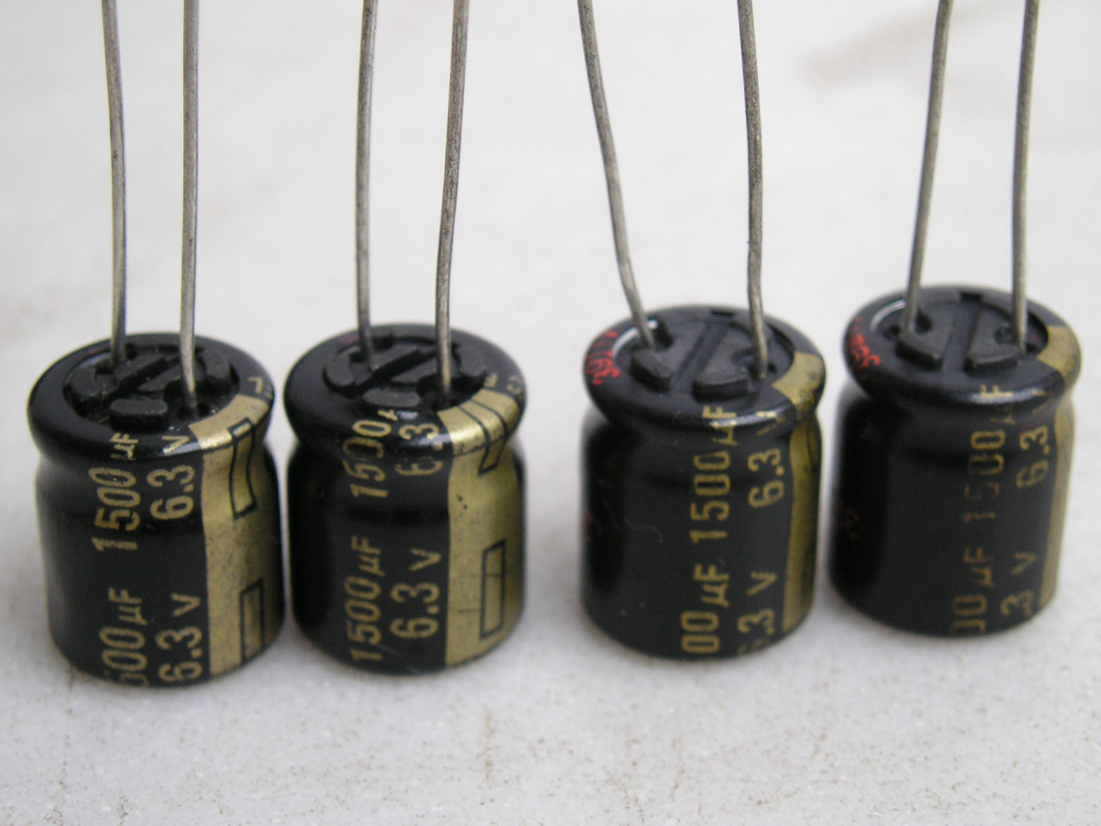

    Hello guys.
    I recently purchased 12 Panasonic FL caps through eBay, from member PCMCS (egekecu) which I "thought" was a "trusted" seller...
    This is the link of the auction: http://cgi.ebay.com/ws/eBayISAPI.dll...m=300355937594
    Upon receiving the envelope and after opened it, I found that not all the 12 caps were the same. There were 5 odd looking ones...
    Are these caps fake ? On the pics, the two ones on the left looks ok to me, the ones on the right are the suspect ones. What do you think...? All the caps in the photos are from inside the envelope.
    Thanks.

        Re: Fake Panasonic FL caps ?
        They are not fake.
        Just a mix of different date codes. - Almost a year apart.
        And Panasonic DOES have more than one factory you know...
        They may not have come from the same one.

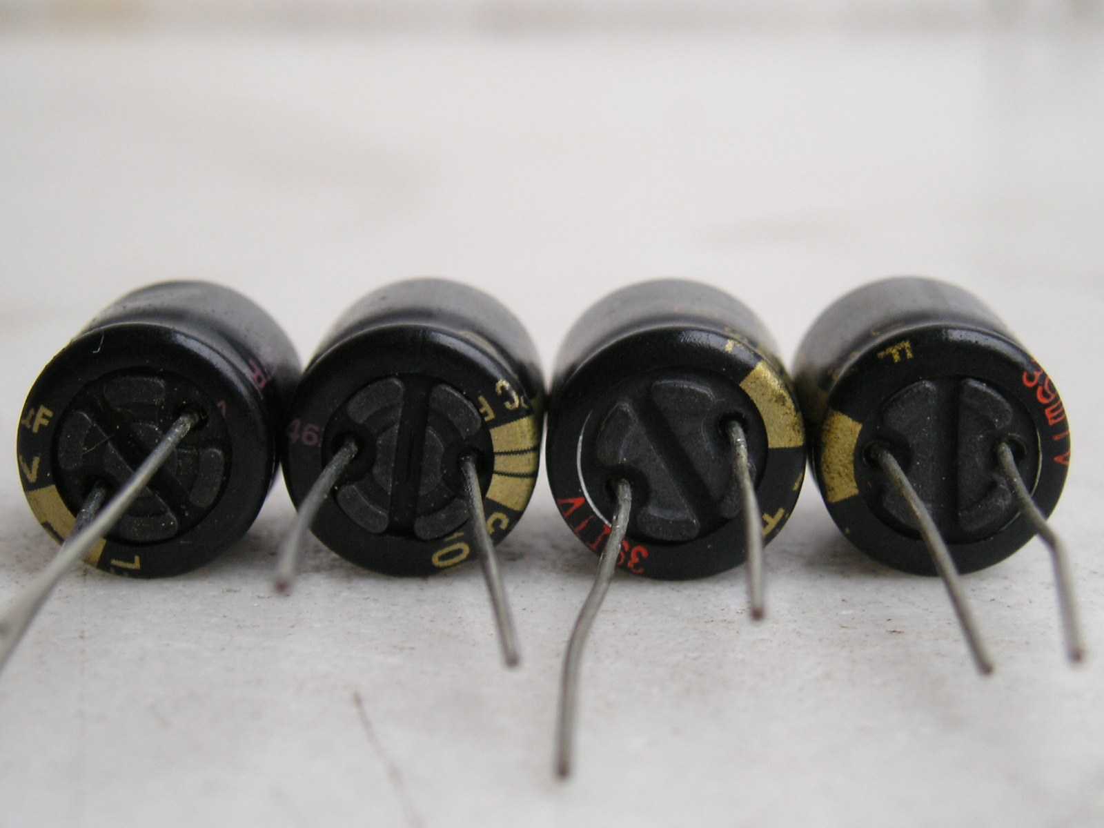

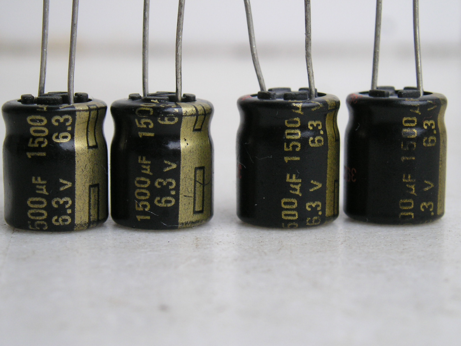

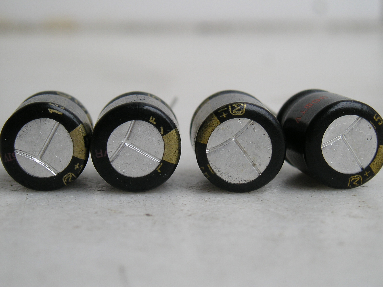

          Doesn't the bungs look weird ? I thought Panasonic ones are like the first two capacitors in the pics. What does that date code with the inverted triangle at the end could possibly mean ?

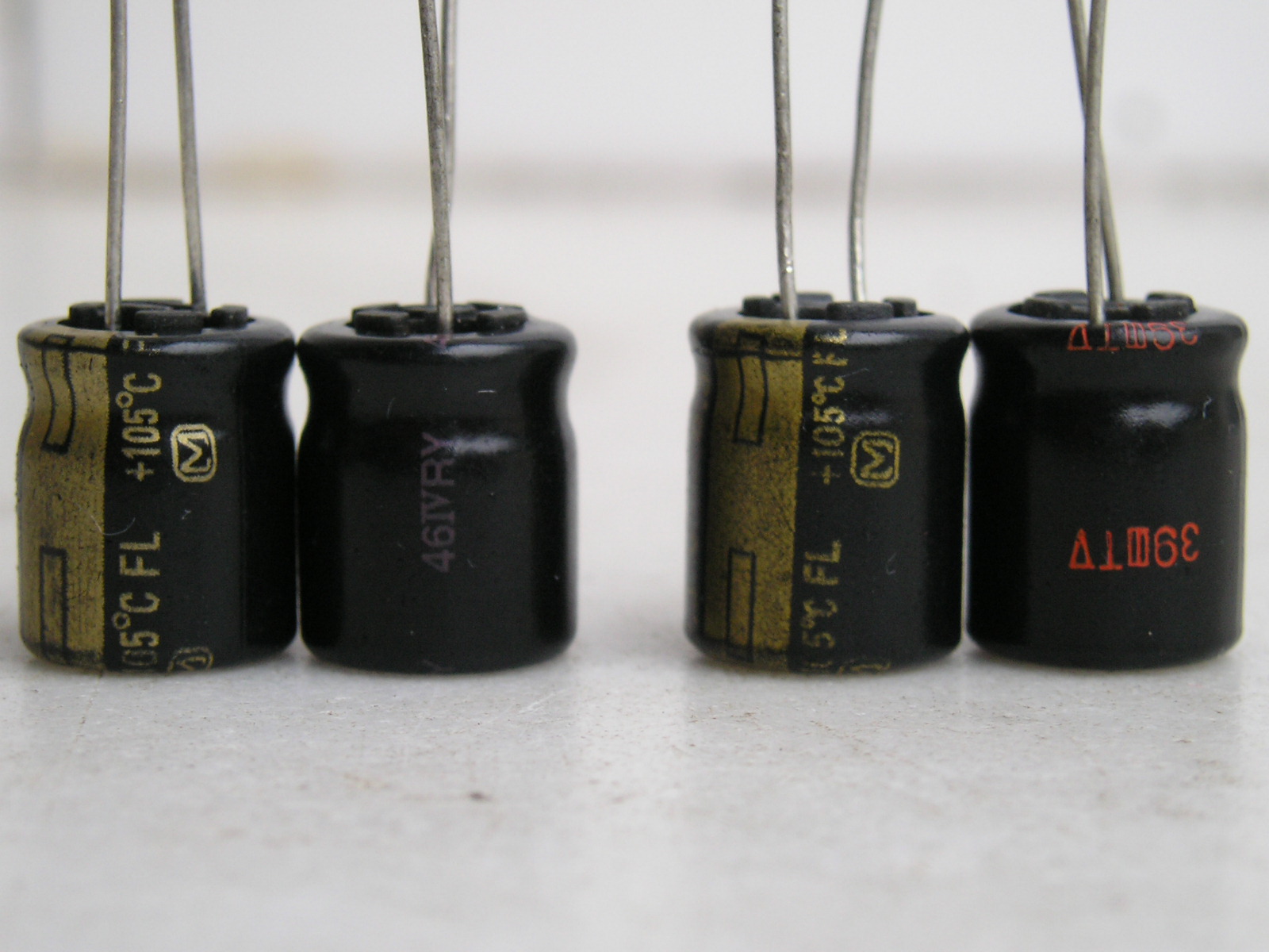

            No. Not weird.
            They look different form each other,,, like different production runs,,,
            Not even unusual with caps that far apart in manufacture date.
            What does that date code with the inverted triangle at the end could possible mean ?
            It's the week.
            The first digit is the year, second is the month.
            https://www.badcaps.net/forum/showpo...09&postcount=4
            You have caps from June 2004 and Sept 2003 and they may not have come from the same Panasonic factory.
            - But they ARE legit Panasonic caps.

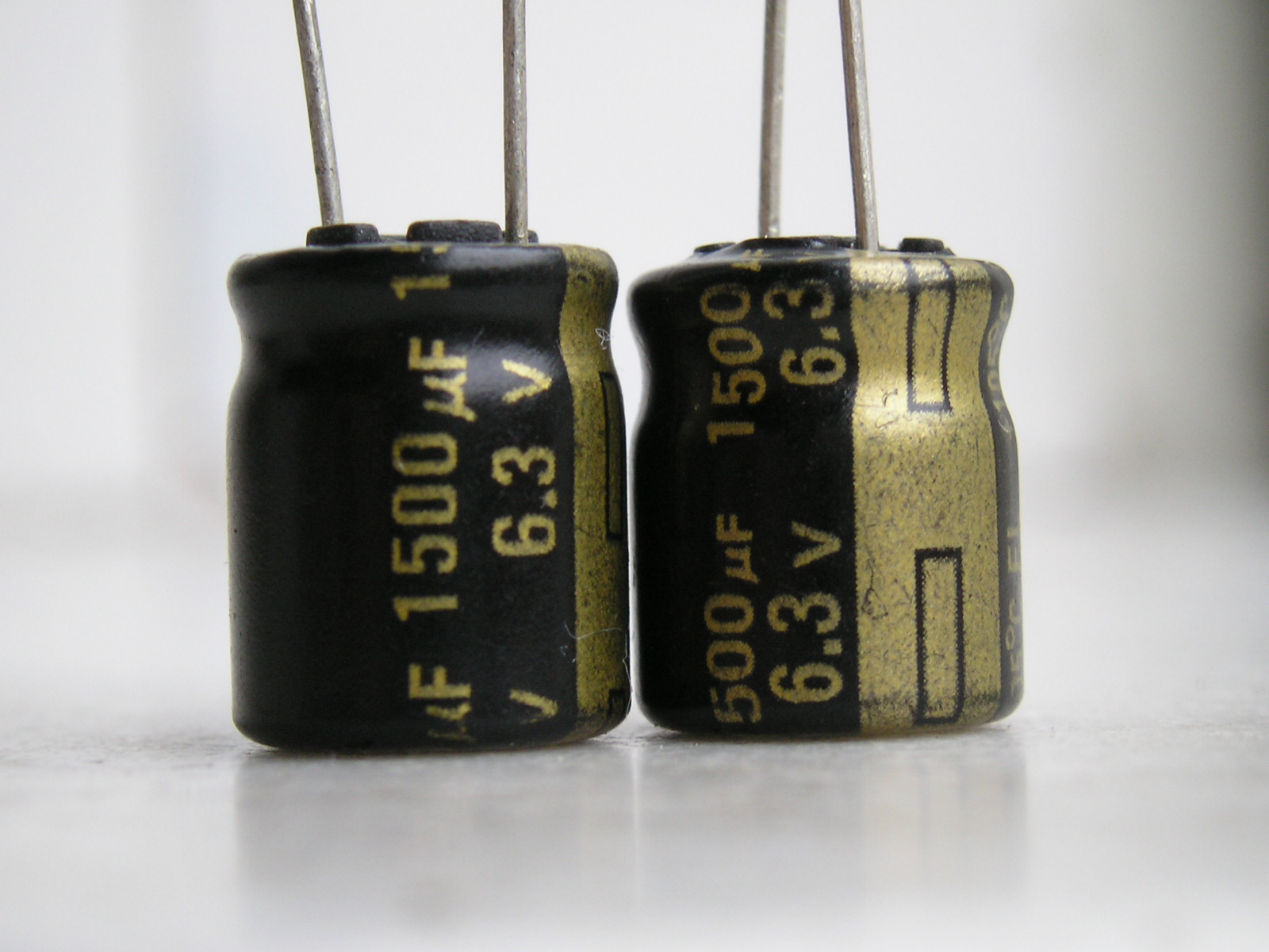

                I'm planning to buy one, but don't have one right now, sorry.
                Thanks for the explanation about the datecodes. I still don't know what that inverted triangle means, as there's no explanation for it in the thread you pointed me to. There should be a letter (A-Z) there...
                EDIT: I guess it's not a "triangle" but supposed to be a V.
                EDIT2: The ones with the red datecode seems to be taller than the other ones. Is that normal ?
                  Your caps have the 5-digit code.
                  The last one in the link is the only one with 5-digits.
                  It says they are Greek numbers.
                  I'm not too fluent in Greek numbers.
                  Not that I'd care what week or day they were made anyway.... LOL
                  Minor size variations from run to run is normal just like bung variations.
                  Also won't be exactly the same from two different factories.
                  Entirely possible the height difference is due to the different bungs.
                  You really need to stop sweating this.
                  They are legit.
