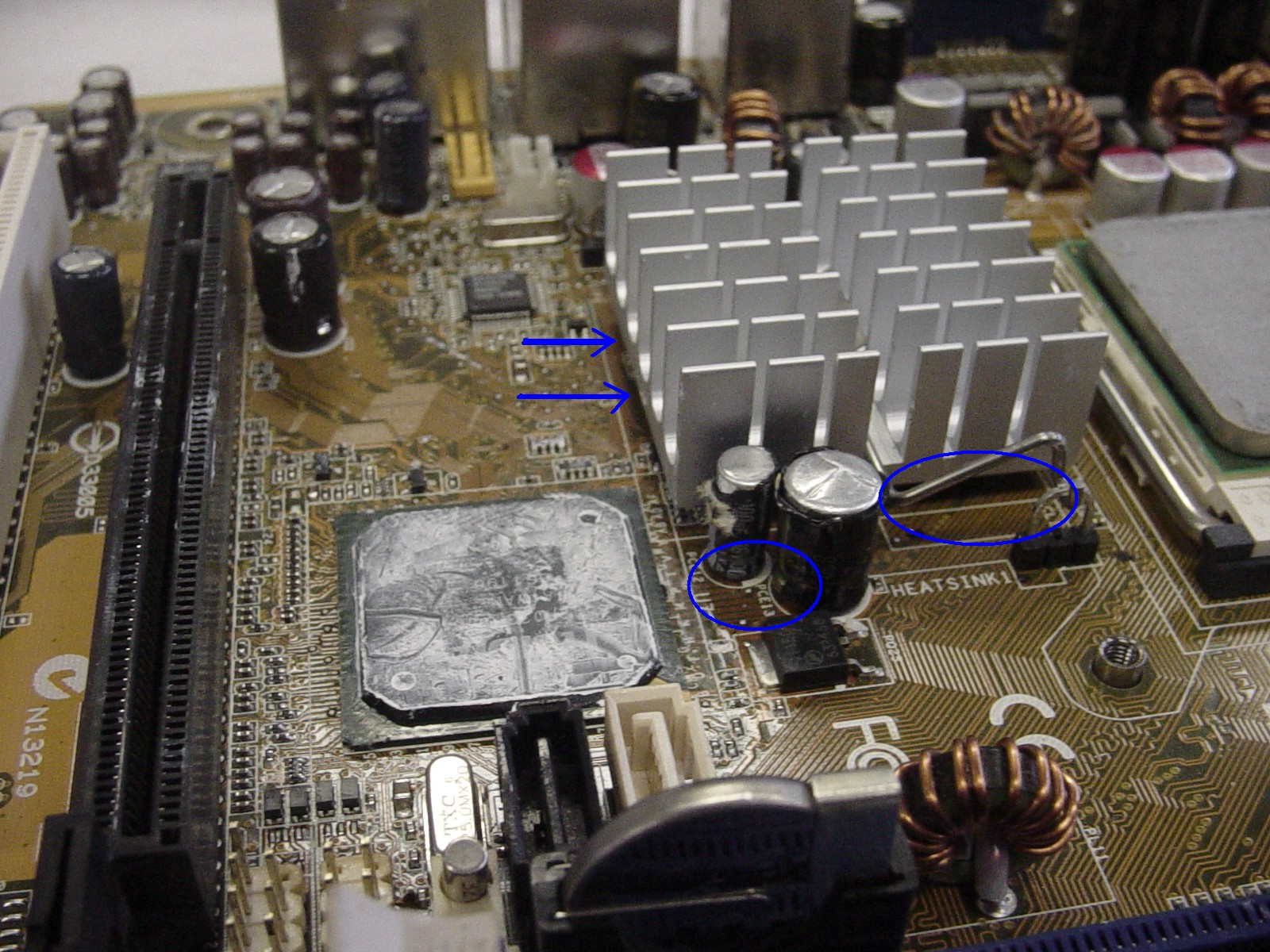

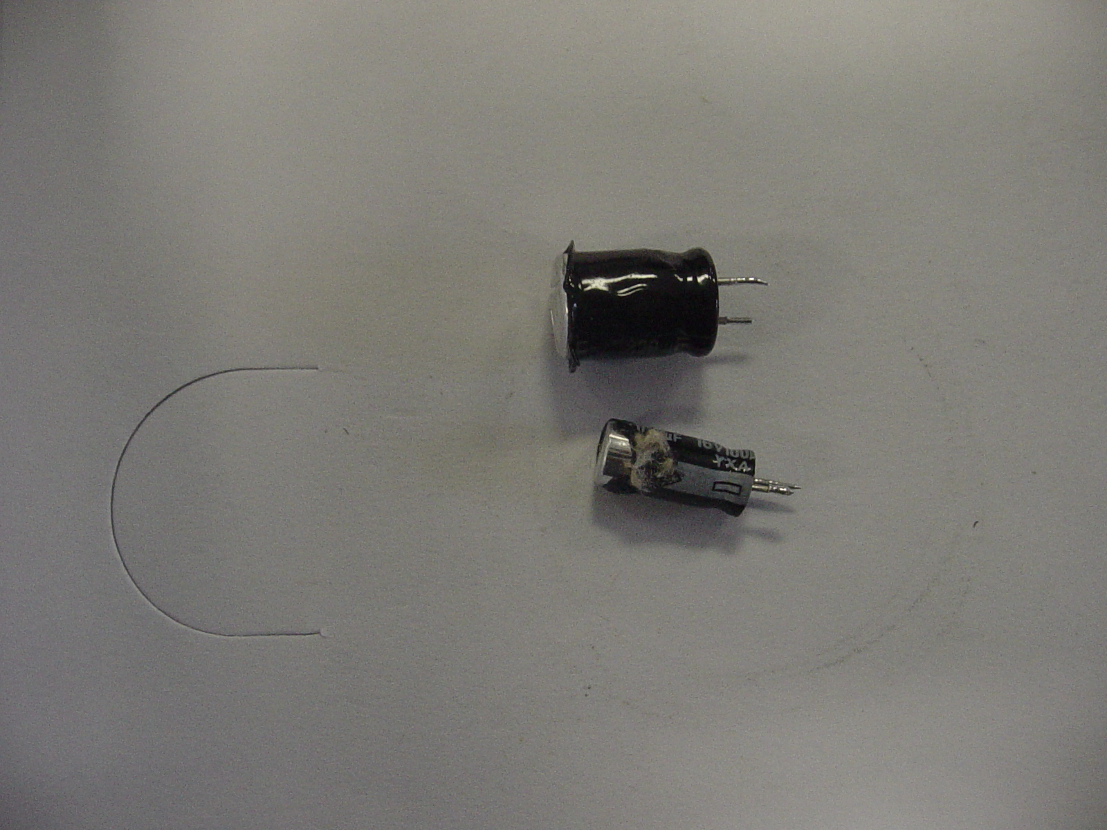

    This HP Slimline is a freebie that I opened to see what was wrong. Beyond the memory having been changed, Dead Hard drive, Missing Optical drive I found these.
    I have no idea what happened to them, I believe the large one is a Panasonic from the funny T on top and the small one is a Rubycon.

    That's called cooked.
    The PCB under that heatsink behind them got so hot it blackened too.

      What puzzled me was that the top of the 820uf looked squashed down.
      Oh well. I'll have to put a light on the board since I never noticed it looked like it had got hot under the heatsink, In fact I have it running right now and the heatsink is fairly warm but not super hot.

        Well when it gets really hot and leaks past the seal and then cools down and doesn't leak in.... you see.

          If you have a bad application of heat-sink grease [or similar] under that heat-sink the heat isn't going to get to the heat-sink to be dissipated [or warm the heat-sink], yet the chip under it can get hot as Hades.

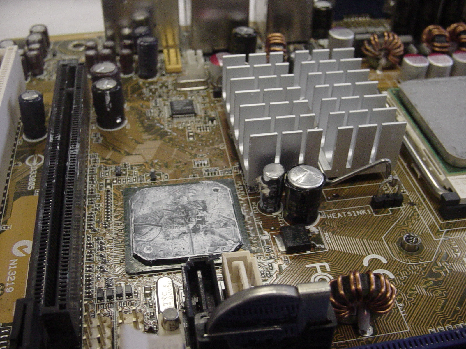

            I don't see where the PCB had darkened either. It looks like someone may have tried to reflow the chip with a heatgun and didn't try to make sure nothing else got cooked. Everything around the chip with no heatsink looks melted.
            Also, what is the white stuff that is smeared all over the board?
              Shown
              That would do it too although there is no mention of what chipset it is.
              Presumably the heat-sink compound that should be under the heat-sink.

                  AMD HP slimlines are pretty much ALWAYS Nvidia 6 series, which explains why they tried to reflow the chip. I have three dead slimlines, two nvidia and one intel all with bad nvidia chips (well bad balling due to overheating)
                  at least you get an am2 chip, those slimlines are usually dual core

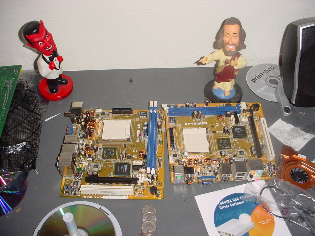

                              two amd/nvidia 6 boards I have. both messed up BGA. I've already taken several polys off them for re-use =)

                                    I got it with the white stuff on the south-bridge chip, My guess is southbridge chip anyway. It feels like heat-sink compound. I do not see a way to mount a heat-sink and that chip runs slightly warm. I may pull the north-bridge heatsink and redo it. However replacing the dead hard drive, Loading Vista and all drivers it appears that the Ethernet port is unop.
                                    The Northbridge heatsink gets hot but not super hot. I have another of these beauties where the northbridge got so hot you'd burn your fingers on it. and the PC would shut down. I stuck a small fan on that one and it stays on, the heatsink feels cool however the CPU fan periodically races. I suspect that voltages are off.
                                    Now that I have two of them I can swap power supplies.
                                      Ah-Ha! That could explain it, Thanks
                                      I don't know what may have happened to it previously. I was curious about the heatsink compound on the one chip
                                      At worst I now have AM2 socket processors. One 4000+X2 and a 5400 X2
                                      for future use.
                                      OTOH if I can get them working........

                                        nice. you can get a lot of good motherboards to take those chips
