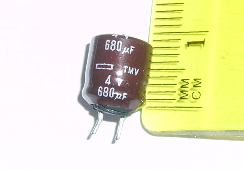

        Re: Specs for Nichicon HN 820uf/6.3v, ***8x20mm***
        4v...
        680uf...
        TMV...
        no top vent...
        LGA775 motherboard...
        but... the small one I'm referring to does appear to be 8mm diameter, and it sounds like yours with these specs was smaller than 8mm?

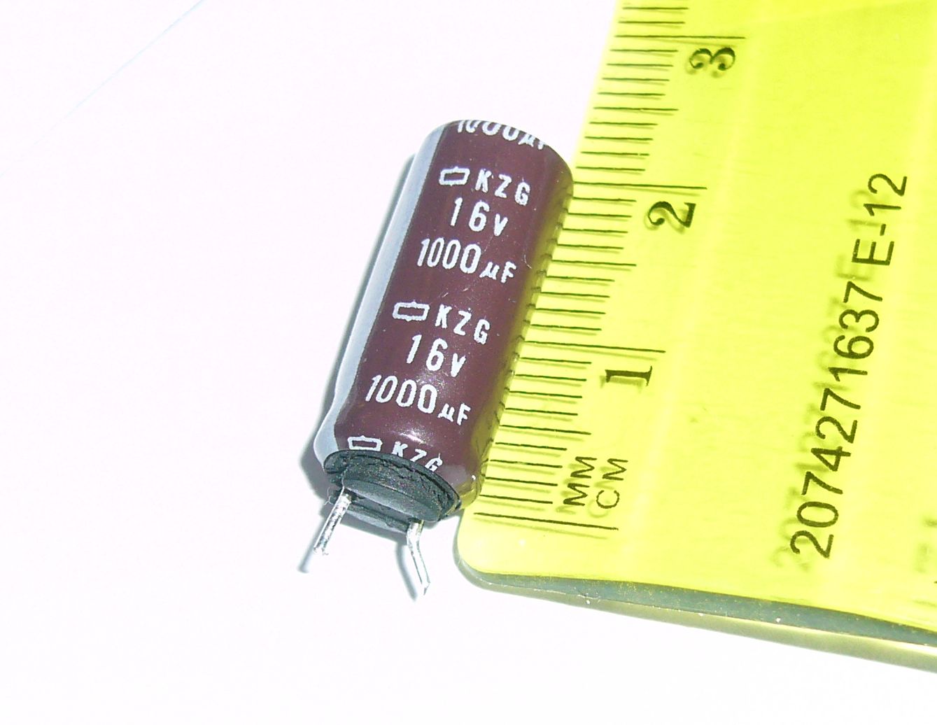

          Pictures attached.
          Would the 1000uf/16v KZG be a good candidate for a Samxon GC?
          • brethin
            • Dec 2008
            • 1907
            Originally posted by bw1
            Pictures attached.
            If you are asking if you can use Samxon GC in place of the 1000uf/16v KZG I would say yes as long as they physically fit where you want them to. If that is not what your asking then ask the question again in more detail.
            • bw1
              • Sep 2010
              • 172
              Yes that's what I was asking. Both are 8x20mm, so should fit exactly. Specs seemed close enough too. ESR was off a bit, but closest of the ones I checked it against.
              What about the little guy though?
                Pictures attached.
                If you keep it to 16v, yes.

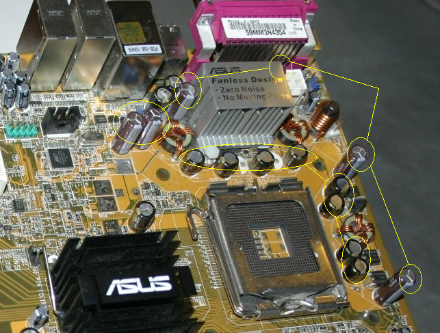

                            Here's that picture again. I've highlited the problem caps. Note: This is not my picture. These caps appear to be just fine. I'm using it to show what/where is bad.
                            The taller ones are the KZG's, the little guys are TMV's. I attached a close-up of both of them previously, and now am just looking for a good replacement for the TMV's.
                              The 8 'little guys' are in Vcore.
                              You could use 8x 680uF[enough] or 820uF[better] polymers and as long as you choose ones with the ESR at 0.010 ohms or less it will work out fine.
                              [Not sure if height is an issue so check that in addition to diameter.]
                              The common sizes of polymers like those are not that expensive anymore and they'll last much longer.
                              For the KZG:
                              Rubycon MBZ, MCZ
                              Nichcon HM, HN [but not w/ 2001-2004 date codes]
                              Sanyo/Suncon WG
                              Panasonic FL, FJ
                              NIC Components NRSK, NRSJ
                              Samxon GD, GC
