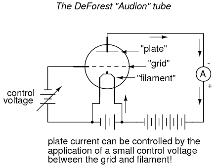

                        #31
                        Re: CEC Capacitors
                        Here's a couple pictures. The triode was the tube equivalent of the transistor. Now it's all chips for the most part. In the triode you have a cathode which puts out the electron fog Behemot spoke of. It approaches the grid. If the grid is biased highly negative the electrons are repulsed and no currant flows. If the grid is not biased at all, sitting at 0 volts, a little currant will flow. If the grid is biased with a positive voltage, maximum currant flow will result. The grid will suck in electrons and then the positive plate will pull in the rest.
                        Solid state works very similarily. The N gives electrons, the P determines if they go on at all, a little, or like gangbusters. The second N sucks up all that comes through from the other N layer.
                        In the diagram, they use the heater filament as a cathode which is usually not the same in later tubes. The cathode is actually a separate plate.

                          #32
                          Re: CEC Capacitors
                          Okay, I'm almost understanding now. But I still don't understand something. Let's take the NPN transistor. So, we have

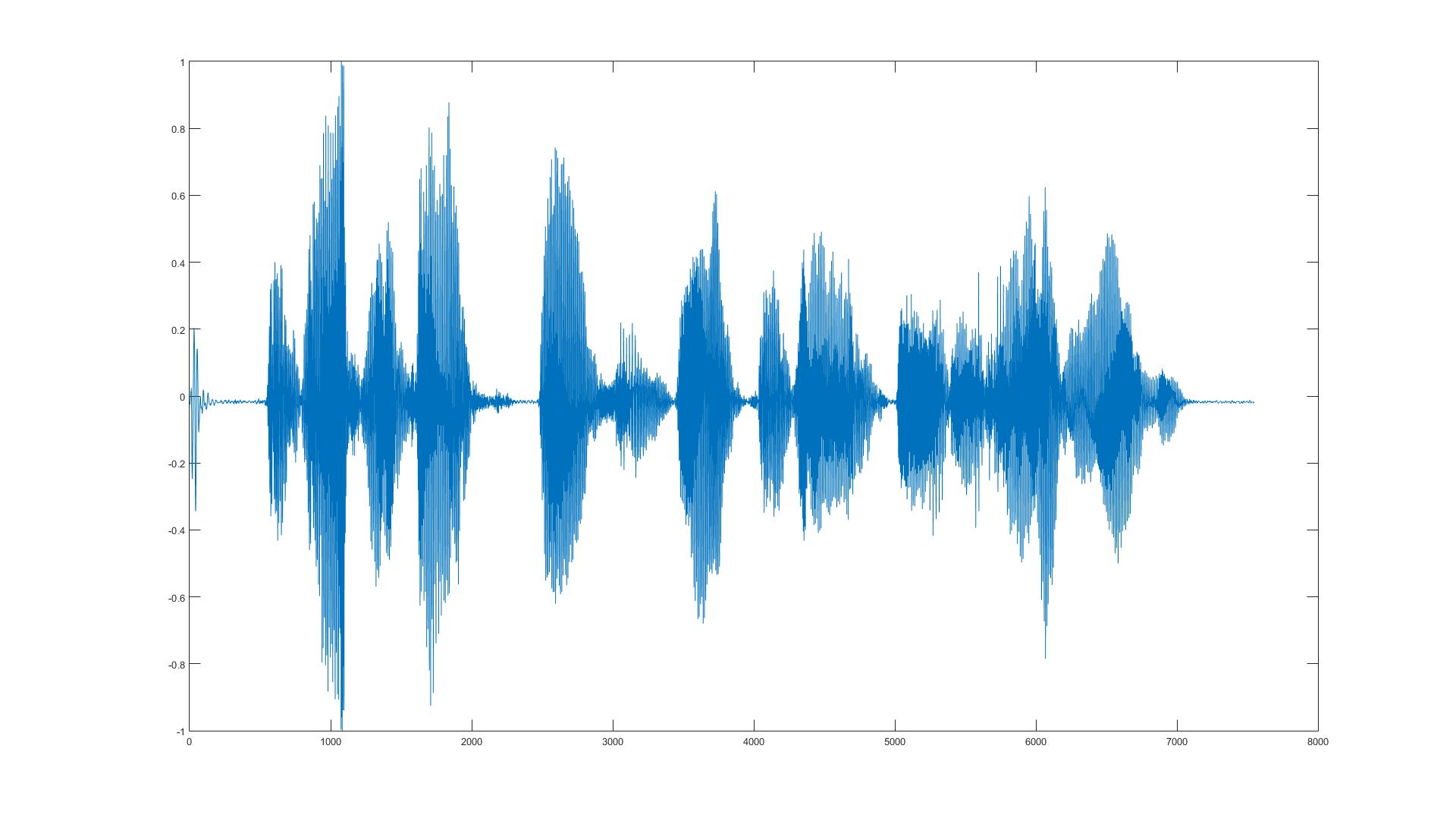

                                        #39
                                        Re: CEC Capacitors
                                        The transistor amplifies the signal. A volume control can only attenuate a signal.
                                        The transistor amplifies loud and quiet passages the same. When the source to the base goes negative the transistor passes very little currant. Then when it goes positive again you get a large currant flow. So it mimics the input to the base but with much higher currant flow out of the collector.
                                        Think of it as a large water pipe with a spring loaded valve in it. The valve is connected to a smaller pipe. The water pressure controls the valve. As the pressure goes up on the small pipe, the valve opens more. As you vary the pressure on the small pipe the water output from the large pipe will vary in the same way. You really haven't amplified anything in a sense because the water is always in the big pipe. But you have amplified the varying pressure signal on the small pipe. The big pipe will mimic the pressures on the little pipe.

                                          #40
                                          Re: CEC Capacitors
                                          The more voltage you apply to the base, the more current that's allowed through the collector, right?
                                          The audio signal would be seen as voltage, wouldn't it? If you applied to it to the base, I understand how it'd get amplified, but wouldn't it constantly be adjusting the amount of current that goes through the collector to the emitter?
                                          Just for example, if we applied something like 50 millivolts to the base, a little current might come out the emitter, but if we applied something like 200 millivolts, more current would come out the emitter, right? Wouldn't the audio signal produce a varying degree of voltage to the base, depending on the frequency of the person talking, which changes with what they say, right?
