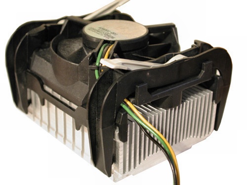

                        Originally posted by severach
                        I prefer the smooth and rounded Intel heat sinks made for the old slow Pentium 4 processors. What these Prescott heat sinks gain in radiating area they lose in dirt clog resistance.
                        Be careful with that one. [Check temps often until you know it's good enough.]
                        Those heat-sinks have fewer fins and therefore less surface area to start with.
                        They might be harder to clog but they are a less effective cooler even when completely clean and so it will take less dirt to make cooling inadequate.
                        I've had no serious problems with stock Intel coolers cooling, but I don't like the stupid lever clips.

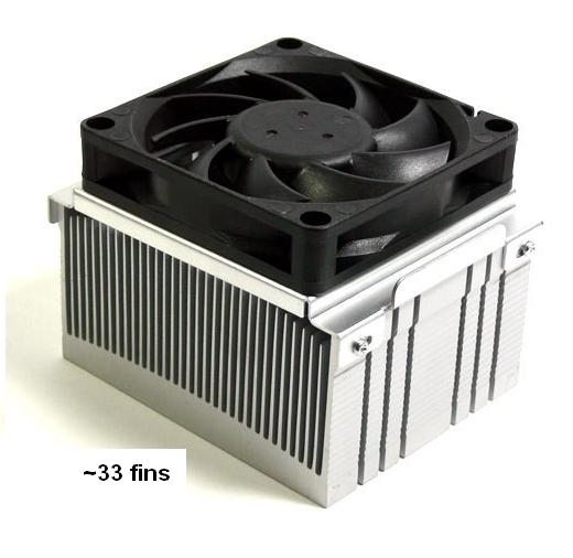

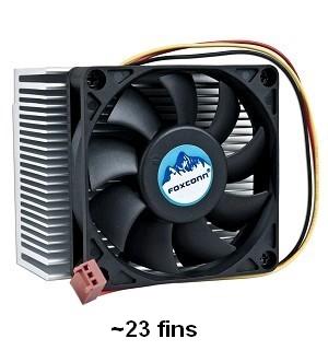

                        The kind I like and look for are shown in the pics.
                        Clips are easier to deal with, replacement [or upgrade] fans are easy to find, and they are easy to clean.
                        - BUT look closely at them. They are NOT created equal.
                        The harder to find 'good one' shown on left has 33 fins. [Anything over about 30 fins is good.]
                        That is what I prefer and use if the CPU is over about 70 watts.
                        [One in photo is a 'stock' Compaq/HP unit.]
                        The typical generic ones you see of that style have around 20 fins. [One shown has 23.]
                        Those are fine up to about 65-70 watts TDP. [If the case is properly cooled too.]
                        They don't -look- that much different but the 'good one' has roughly 50% more cooling surface.
                        - That is a BIG difference.
