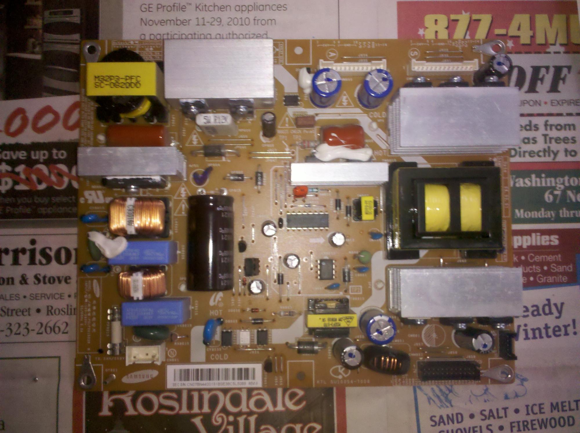

    My samsung tv wouldn't turn on so I did some digging and discovered it was most likely a bad capacitor. So I opened up the back and lo and behold one of them was bulging. So I removed it from the board, but I am extremely hesitant to buy a replacement since I have never done so before, and don't want it to be the wrong one.
    Therefore I figured I would turn to the experts here and ask for some help.
    The TV is a samsung 32" LCD, here are some pics of the capacitor I removed:
    And This one:
    So what I could ascertain from looking at it...
    Made by SamWha (I think model is XC?)
    2200 uf
    105 degrees celsius (M) which I think is max temp?
    10 Volt
    height is a little under 1" (maybe like .94)
    diameter is a little over 3/8ths of an inch.
    I went to digikey.com and tried to narrow the results down, but I still had like 12 results so I was not sure, since they had different ripple currents.
    ANY help would be greatly appreciated, like I said I don't want to do more harm.

    A couple of things: which board did this cap come from? XC is the series, which is not posted on their website (maybe a custom order?). Can size by your description would be 10mm diameter by 25mm height. Replacement would depend on where the cap(s) appear, but safe bets would be Panasonic FC or Nichicon HE (assuming you have clearance for another 5mm in height). If these are from your power supply board, and the TV is more than a couple of years old, you might want to replace the rest of the caps as well while you have it open.

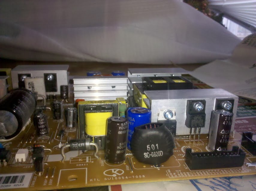

        Thanks for the swift reply, I will most likely buy the panasonic one and see how that works out, but I figured I would answer your questions first just in case
        So its coming from the power supply board, I took some pictures of that too:
        attachment1
        Bottom right is where I removed the bad cap
        attachment2
        Just to get another angle.
        The rest of the caps look pretty good, so I think I will just replace the one broken one (even though I realize it is a better idea to replace all of them).

                      Since it's on the power supply board, definitely use lower ESR caps. Shovenose pointed out one that BCN sells here which is a perfect fit and helps support this site. The Panasonic and Nichicon I linked are larger and may not fit (please double check!). If you do end up ordering from Digikey, don't forget to use First Class shipping. It's the cheapest, and usually one of the faster ways to get it.
                      Up to you of course! The only problem is that you don't know if the others are broken by only visually inspecting them, and as Shovenose says, this could end up stressing other components and causing more damage down the road. In any case, hope it fixes your issue!
