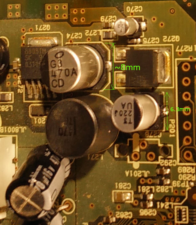

    Confused ID'ing this SMT electrolytic capacitor. I have:
    G3
    470A
    CD
    I think it's a Nichicon CD series but the ring logo I don't recognize. Should be:
    Lot. #
    Capacitance+voltage
    Series
    Would make it a 47uF 10V 6.3mm
    But the part is bigger - 8mm I estimate and that's a 470uF 10V size.
    Like "471A" marking I would expect then.
    What value is this part?

      Yep, it's a Nichicon CD series, just look at the photo of the larger capacitor in the datasheet. Let me know if you need any additional information.

        Physical size (8mm) it's 470uF, marking is "470A" but code should be 471 1A.
        It appears Nichicon code is only for the part number, or if the cap is too small to have 4 digits printed on it.
        Otherwise, it's capacitance in uF.
