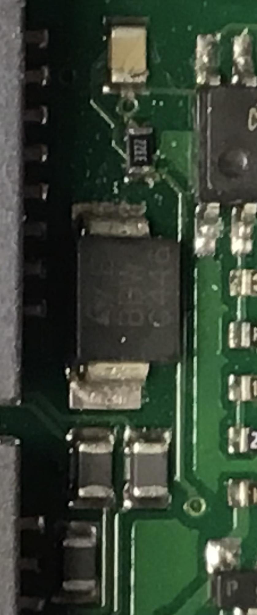

    Is this a capacitor?
    I cannot find anything about this component:
    E
    BBW C446. Is it a capacitor?
    I tried to measure it inline but got no reading.

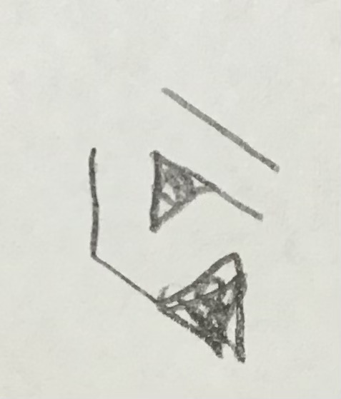

    Also, the logo seems to be ST, but I am not sure. I have attached a drawing of it.
    Thanks,
    Stenio

    Re: Is this a capacitor?
    st only make semiconductors.
    maybe it's a transorb
      It is likely a SMBJ48CA
        tvs so very likely its good . they short if bad ,
          I think you got it. Thanks.
            I agree. No short and no sign of damage in the area.
            Thanks.
              It is connected between the signal/power lines on a S0 bus of a ISDN phone. It makes sense.
