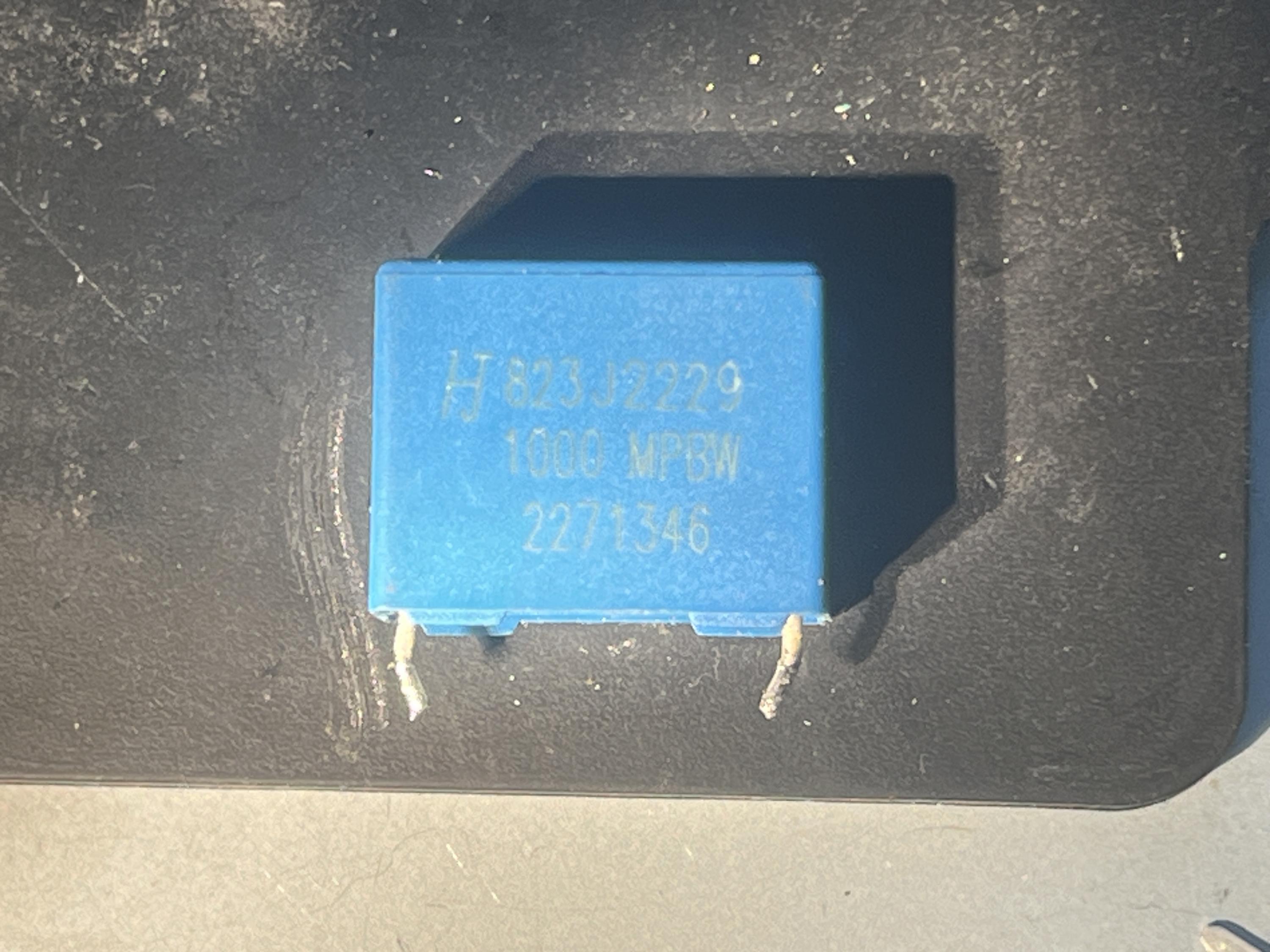

    PSU Capacitor ID
    The logo looks like a combo H and J
    The numbering is
    823J2229
    1000 MPBW
    2271346
    Im not totally sure if its bad or not. My ESR meter shows its at 20 ohms which seems high.

    Re: PSU Capacitor ID
    Possibly .082uF, +/- 5%, 1000V?
