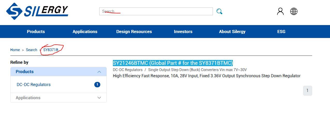

Hello there I need help identifying this components, one of this is probably shorted, because it has low impedance measuring coil from vout to GND, I suspect it might be 5 or 3v but not sure, I don't find any references to this marking codes. If someone has any info please let me know. DFAF JB, CUHF JC. It is from a HP Victus laptop DDR5 CPU AMD. There are no schematics or boardviews for this model, and no datasheet. I read something this chips were proprietary manufactured ๐คท๐ปโโ๏ธ. Cannot find even where to buy it ๐.
identify components in mb LA-M788P from HP Victus

Thanks mate, is there any available schematics where I can see sy8371b?? There is little info about that chip and is the one I think is shorted, I think is 3v railComment
The datasheet is here https://www.silergy.com/productsview/SY21246BTMC .That might look like the wrong part number/datasheet but it isn`t, silergy have started using a different part number called a Global part # ,it can be a bit confusing.
SY21246BTMC (Global Part # for the SY8371BTMC)Comment
