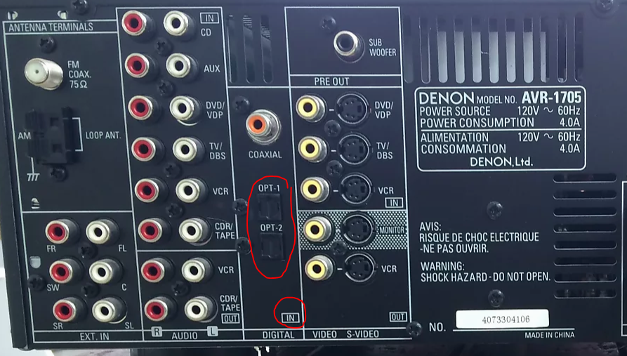

    In the above TV I want to connect a classic Denon amplifier particulary (AVR - 1705) with rca in socket
    can you suggest me any way?

          The avr-1705 has an optical input, the tv has an optical output, all you need is an optical cable between them.

            Yes, then there is no problem to connect TV to Denon, only an optical cable is used.

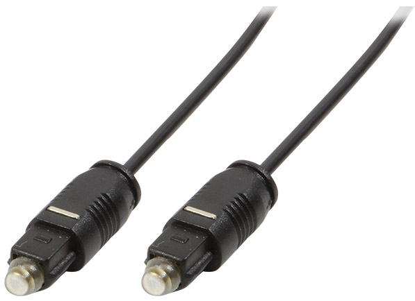

                    The last thing I want to ask is the photo cable suitable for my situation?
                    I translate the description given to its characteristics
                    Description
                    The optical Toslink cable is ideal for enjoying the best sound quality in your home cinema. Compared to conventional copper cables, Toslink signals are transmitted optically over optical fibers and are therefore completely protected from electrical or magnetic interference.
                    Connection 1: 1x Toslink male.
                    Connection 2: 1x Toslink male.
                    Black color.
                    Cable length: 1.5 m

                        and the optcal fibers of the photo are suitable ?

                          yes that one will work, as long as the tv and receiver both have the toslink inputs so you can connect it, looks like your receiver has 2 of them so thats good, if you have the same input on tv, don't have to have 2 on tv one is fine, just plug one end to tv and one end to opt 1 or 2, and choose setting, it will work for sound from tv to receiver speakers.
