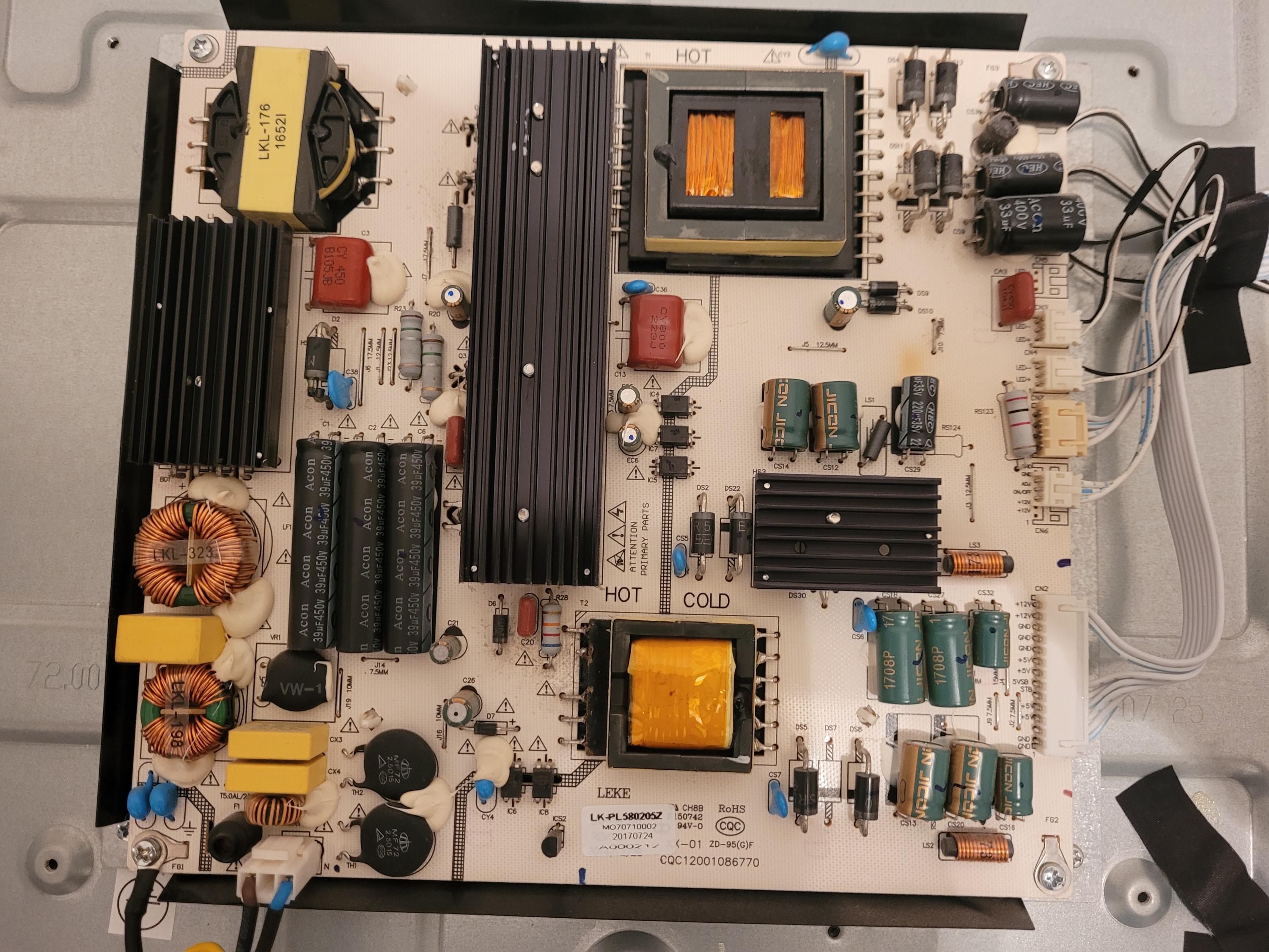

    Friend has asked me to look at a Baird T16509DLEDDS
    When plugged in, red standby light comes on, press power and green light comes on, but get nothing apart from that.
    With back removed, there is a blue LED illuminated on the small network/wifi board (if thats what it is called lol)
    I have tested the voltages coming from power board, and all seem ok, except dont get any readings for the power to the backlights, whether backlights are plugged in or not, is this normal?
    Any suggestions what to try next, or any know issues much appreciated

    If all the supply voltages are normal, then the firmware may have crashed, if there is a programmer, then you can merge the contents (Dump) and put it here, I'll take a look and if it's not working, then I'll fix it.

        So, no picture on screen with flashlight? What is voltage across main capacitor?

          Yes there is picture with flashlight
          Main cap voltages are 390v
          I have a suspicion its the backlights at fault, however I dont really want to pull the screen if I dont have to being a 65", thats why I was asking when testing votages on the PB, should i get voltage where the backlights plug into?

            If you have a picture when using a flashlight, 99% of the time it’s the backlights that are bad

              When turning on tv you should get a voltage rise on the led pins.

                Cheers m8, I was doing it wrong, I was turning TV on then testing voltage afterwards

                  Yeah I know m8, was just throwing me off that I wasnt getting backlight voltage from PB, but I was testing incorrectly

                    Problem solved, backlight failure, thankyou everyone
