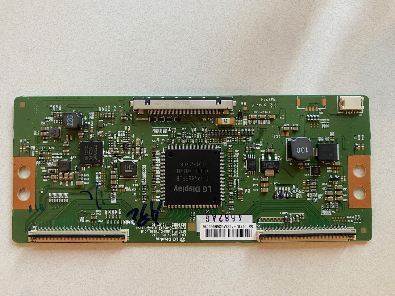

Phillips 55PFL5602/F7 T-Con failure?
  • howardc64
    • Jun 2017
    • 634
    Powers on
    Backlight comes on
    Plays sound (firestick menu sound through HDMI)
    LCD dark grey, no boot logo, no image
    I guessed Main board and PSU likely good and focused on T-Con + Panel. No experience debugging T-Con.

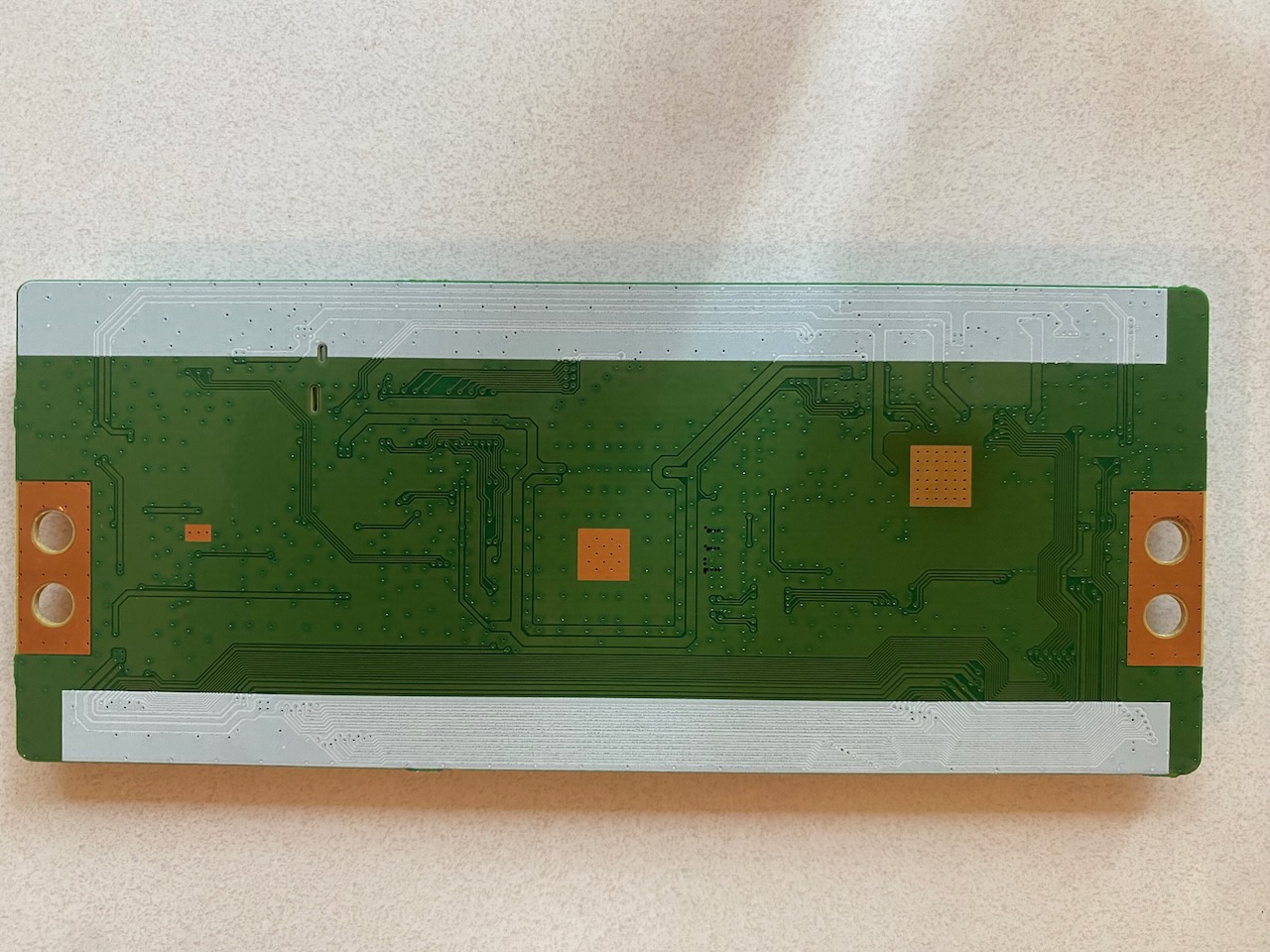

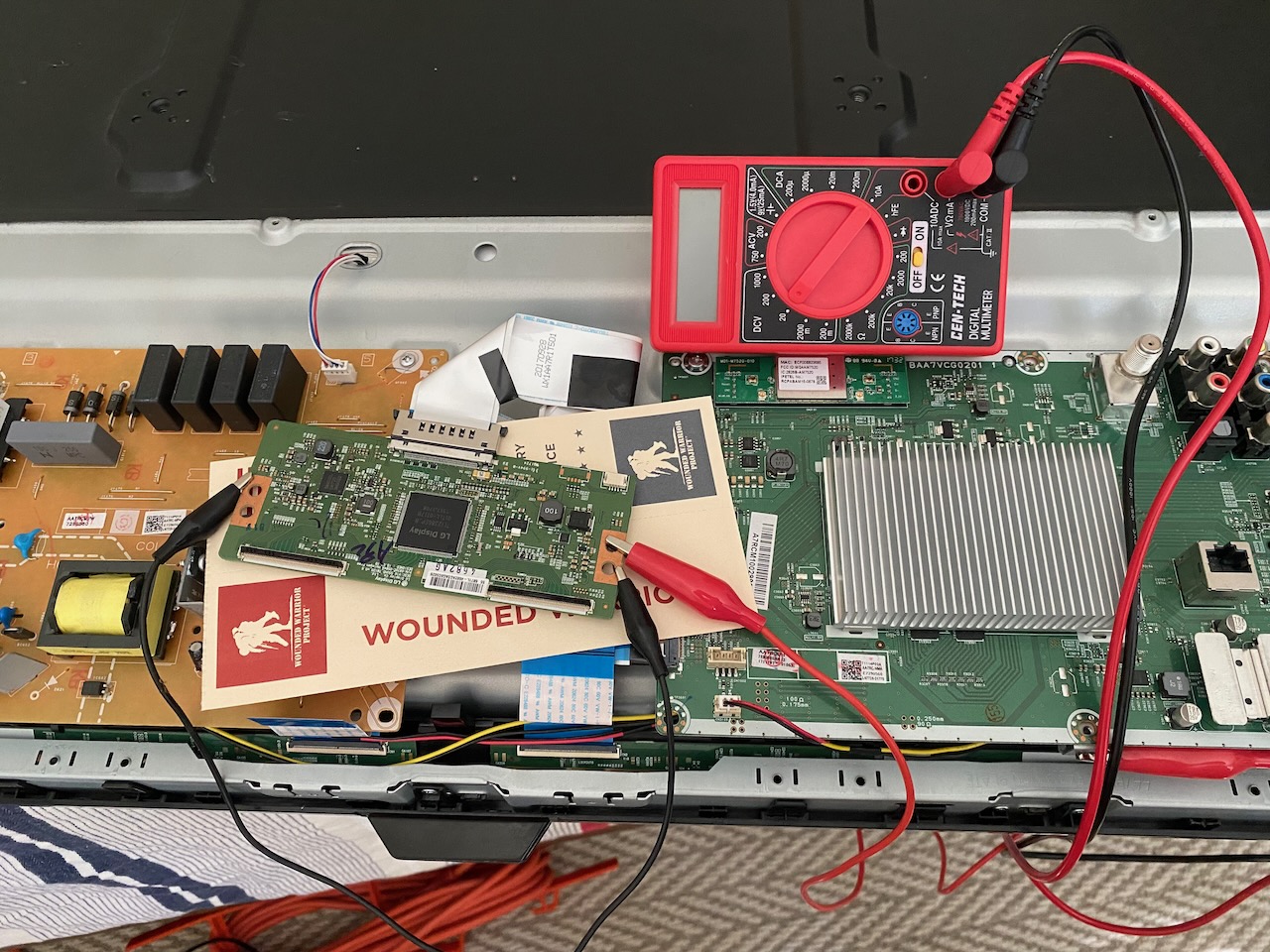

    T-Con
    Disconnecting one of the LCD flex to T-Con doesn't improve anything. Screen remains dark grey but the side with the pulled flex is slightly different shade of grey.
    T-Con Voltages
    All voltages are stable for about 20s then starts cycling at ~2s intervals. This is with both LCD flex connected, disconnected, or only 1 side disconnected. Seems cycling is not normal.
    F1 both side of fuse cycles between 12.03 <-> 12.1
    VCC 3.3 <-> 0
    VCORE 1.2 <-> 0
    HVDD 0.06 <-> 0
    VGH 1.38 <-> 0
    VGL1 -6.9 <-> 0
    V??2 (near D3) -14.8 <-> 0
    VCOM1 0.12 <-> 0
    VCOM2 0.33 <-> 0
    VA1/VA2 (not sure which is which from the label) 0.03 <-> 0 12.08 <-> 12.03
    VIN 12.08 <-> 12.02
    VST -14.8 <-> 0
    VCC1B 1.83 <-> 0
    VCOMRFB 0.13 <-> 0
    VDD 2.09 <-> 0
    V1/V4/V5/V6/V9 2.26 <-> 0
    V10/V13/V14/V15/V18 0.16 <-> 0
    T-Con does get pretty hot. Hotter than I would have expected but don't know what is norm.

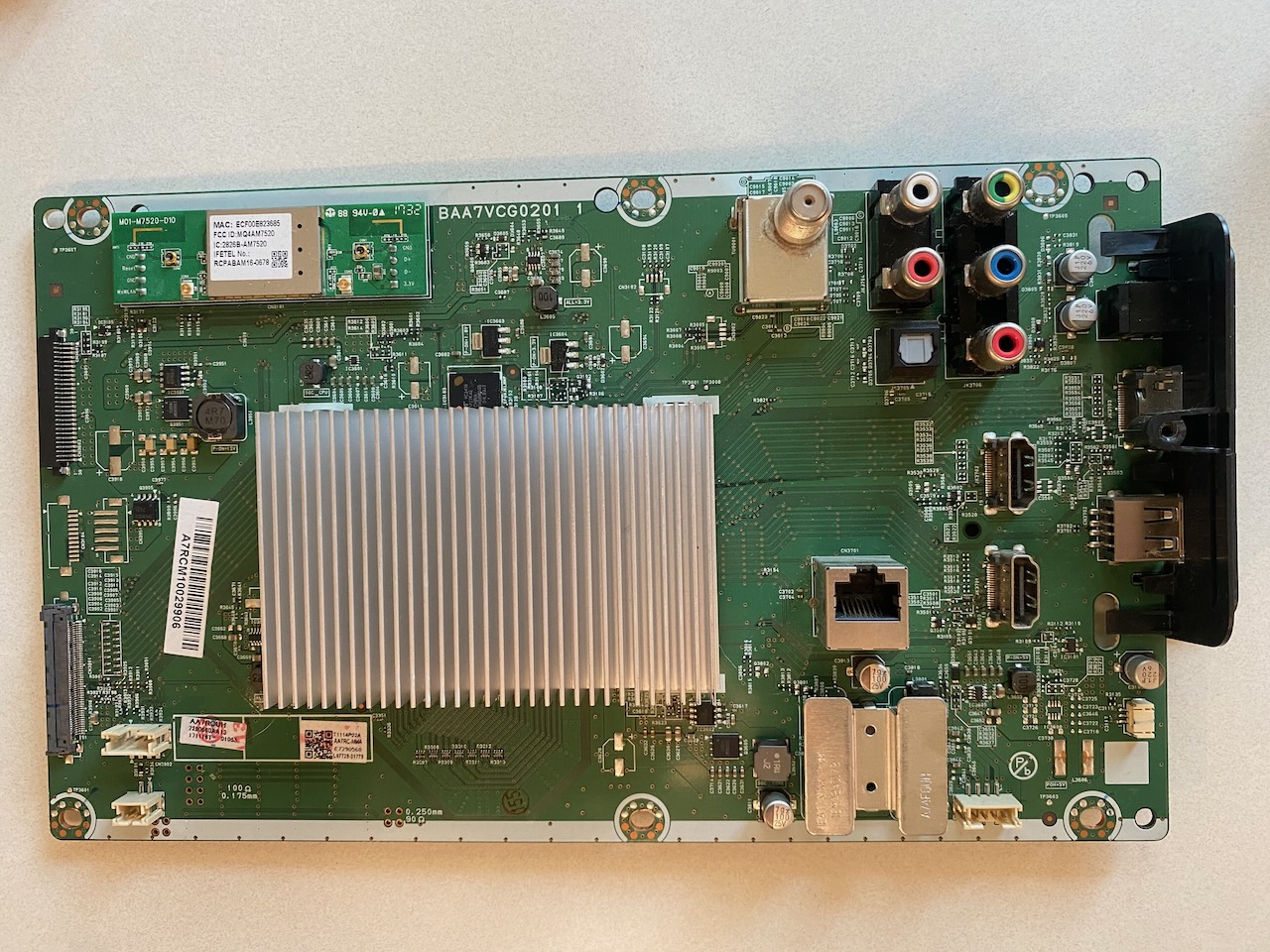

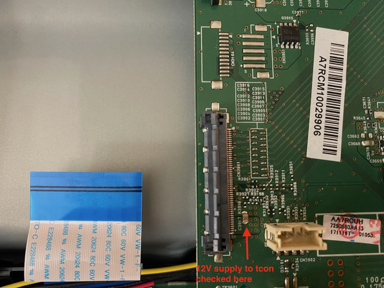

    Main Board
    P-ON +12V shows 12.1v rock solid
    Cap near pin 51 of T-Con connector shows 12.08 <-> 12.10 with T-Con connected. Solid 12.10 without T-Con connected

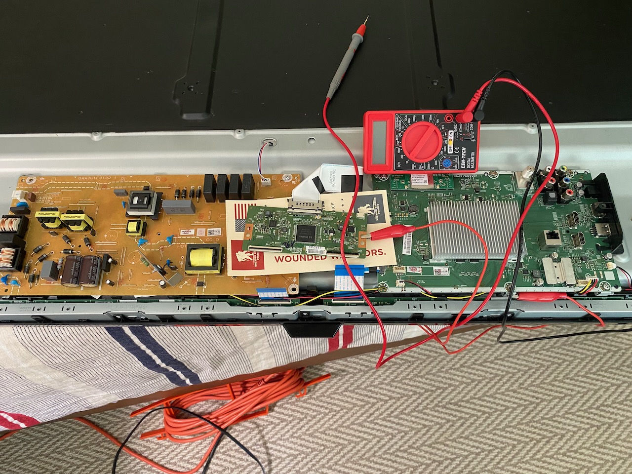

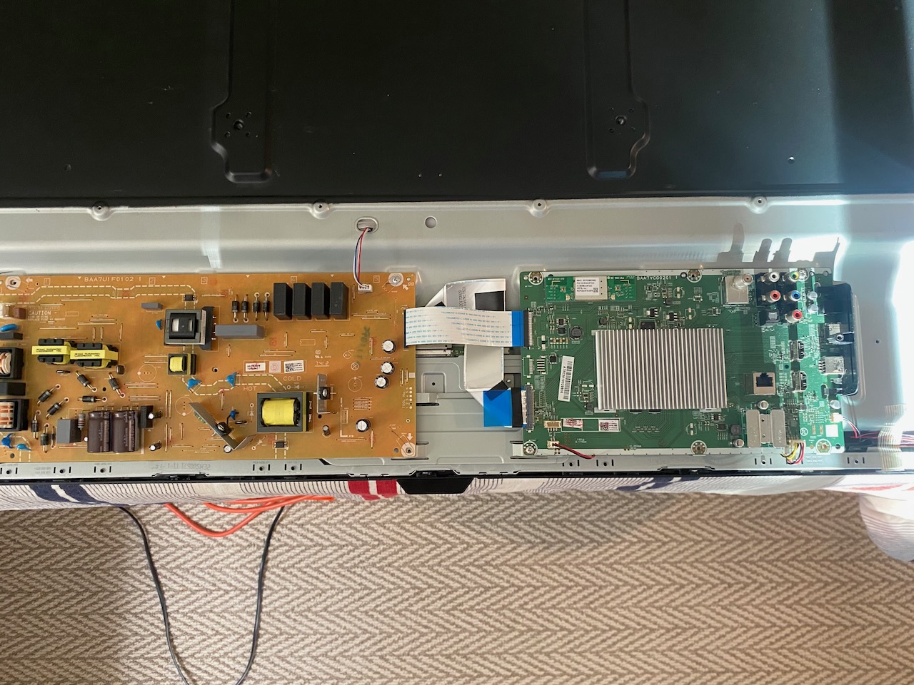

    Testing Setup
    T-Con is assembled under the PSU and main board. Mostly covered by PSU. To read the test points, moved T-Con above with paper underneath for insulation and ground jumper to chassis. See last pic.

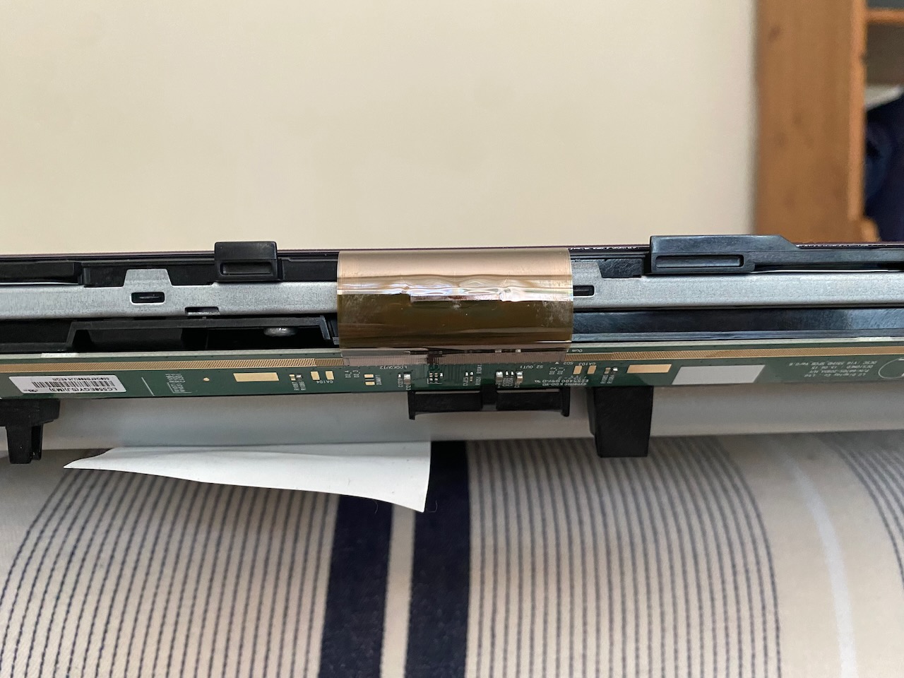

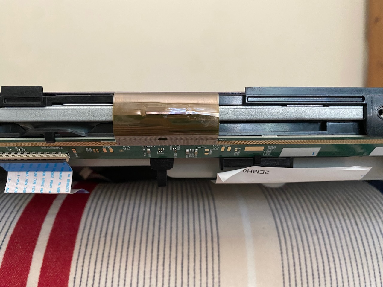

    - Should I expect white on 1/2 of screen with 1 panel flex disconnected from T-Con? I've seen this behavior before on a Samsung but perhaps its panel dependent?

        One thing I forgot to mention is inspecting the panel edge driver board in case of liquid drip (all clean). What I did find is the flex between the driver board and panel made a rubbing mark on the metal frame that encased it. Right where the filter caps/resistors is (but its on the other side so presumably the flex itself is the insulator). Not sure if that shorted out anything. I tape insulated it on reassembly for precaution. See pics
        • howardc64
          • Jun 2017
          • 634
          Re: Phillips 55PFL5602/F7 T-Con failure?
          Originally posted by dskall
          So, you basically have only 12v on t-con with cables hooked up? And you checked voltages when you removed cables and same no voltage?
          Did the following test combos to read voltages.
          - Everything is connected. Panel to T-Con, T-Con to main, main to PSU, PSU to backlight. IR and button panel to main. Skipped speakers.
          - Disconnect either one or both Panel to T-Con flex. Made no difference to the voltage readings.
          All T-Con voltage readings are the same in all these cases.
          I also tested main 12V near T-Con connector with T-Con connected and disconnected just to confirm the voltage cycling wasn't coming from main.

              • howardc64
                • Jun 2017
                • 634
                Thanks. I suppose a touch test to see what component heats up first might be worth a try. I'm assuming safe enough with no high voltage/currents. Don't have thermal cam (need to get one of those soon along with BGA reflow station haha) Also didn't find any shorted caps.
                And yes, t-con is cheap enough to try. On matching the white stickers... looks like only first few #/letters match. Rest looks like serial of some sort. There is a Desc and PN printed that has version #. Probably should match that. I believe the following are probably the key #s to match up
                DESC V16 55UHD TM120 v0.6. (seen other versions)
                PN 6070C-0586A (seen non As)
                White sticker should say 55 (seen other screen sizes) 6871L-4682A... (haven't been able to match beyond this sequence)
                BTW, LG is the T-Con board manufacturer. I know LG/Phillips used to JV on LCD South Korea new gen LCD factories. Maybe still does haha.

                                • howardc64
                                  • Jun 2017
                                  • 634
                                  Originally posted by diif
                                  HVDD looks to have no voltage what's the resistance to ground of L6 ?
                                  Thanks for the suggestion. Led me closer to finding the short
                                  L6 is 2.64k to ground. L2 8K L1 526 L3 0!
                                  Tracing L3 circuit led me to this post of the same T-Con with probably the exact same failure. My T-Con also gets hot (also without panel flex connected) but haven't tried to setup again to see if same QFN thats source of heat (but probably likely given the L3 short)
                                  https://www.badcaps.net/forum/showthread.php?t=74520
                                  Post #2 gave rough summary of the QFN chip and post #6 provides the schematic of similar circuit. On my board
                                  L3 = L0N4 on schematic. Short to ground on both sides
                                  Couldn't find the R9N2 and C4N6 equiv on my board
                                  D3 = D1N0 on schematic. VGL2 test point (hard to read, right next to D3) not short to ground. Couldn't find R2N4 equiv on my board.
                                  I guess could remove L3 to see if short is gone.
