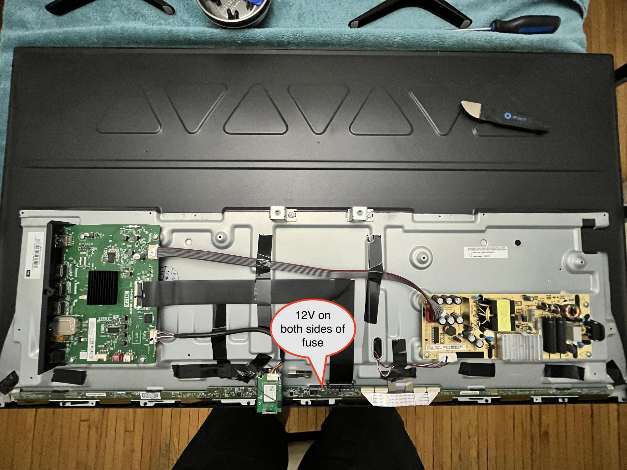

    Power supply:
    Main board goes into standby, so no reason to suspect anything here. Backlights turn on, etc..
    Driver boards:
    I have 12V going on both sides of the fuse on the panel driver boards.
    VGH and VGL are around 1V when powered on.
    No shorts to GND on any of the test pads or any of the caps on the driver boards.

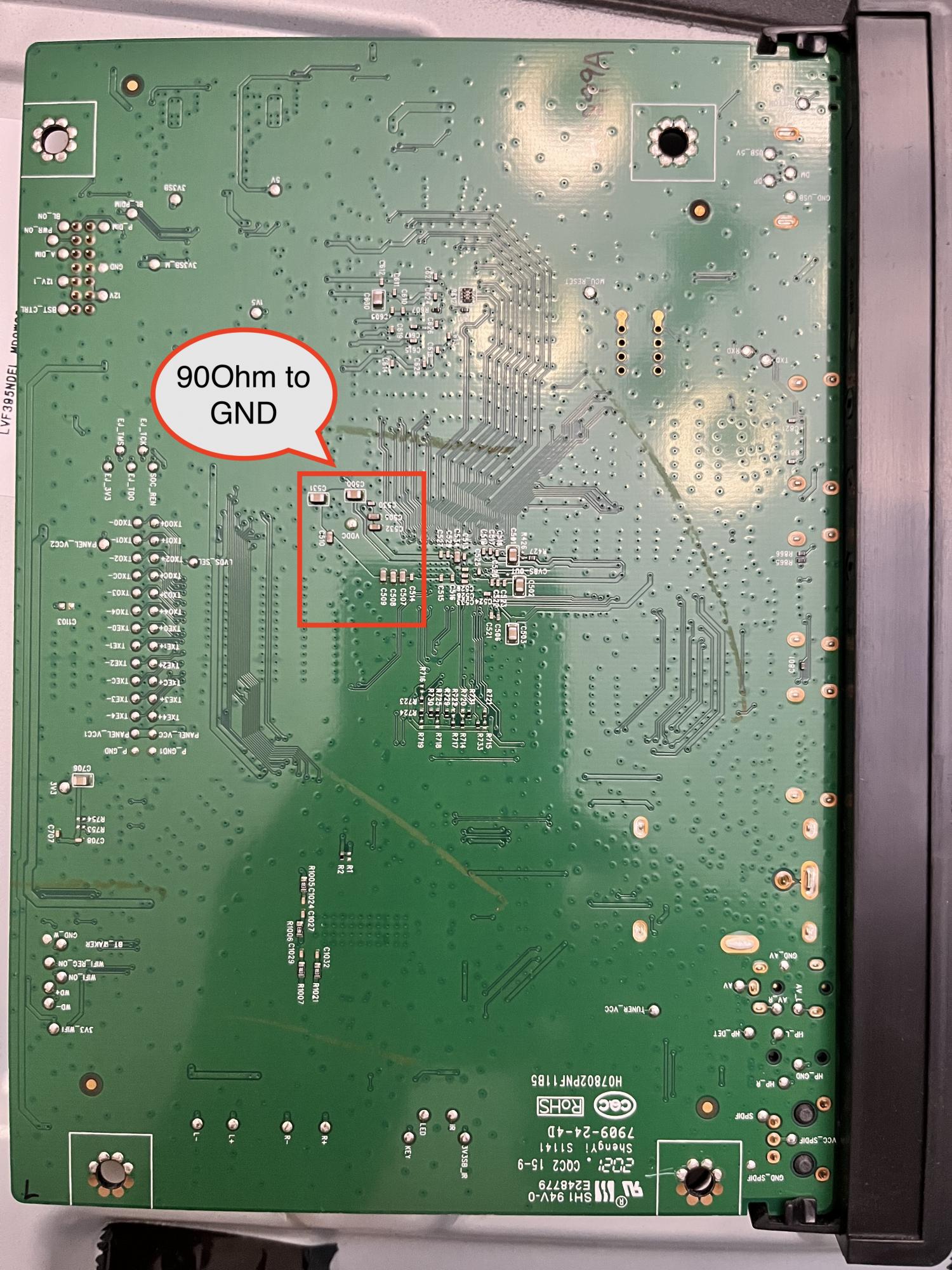

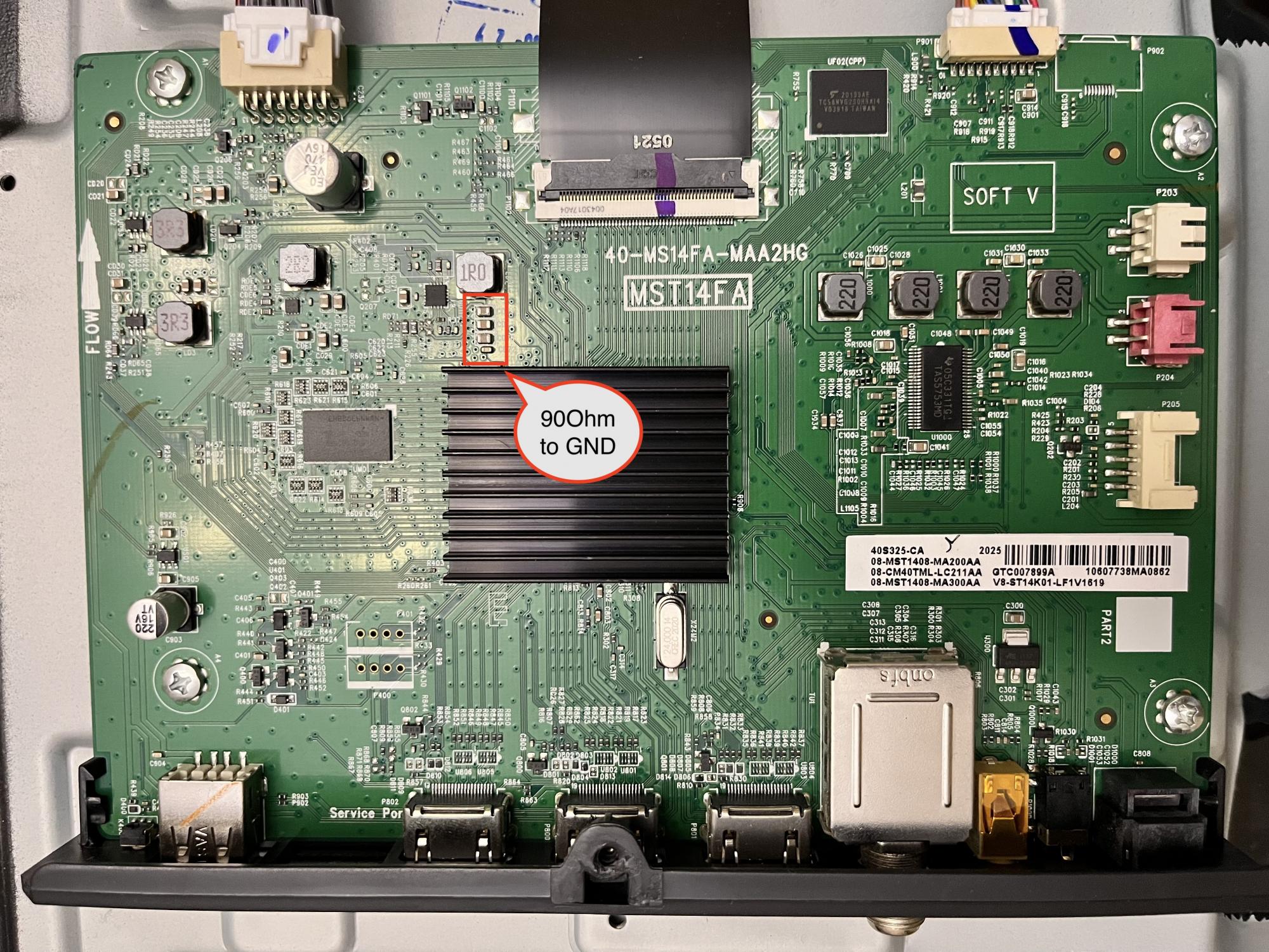

    See pictures - a number of the caps seem shorted, however they're about 90Ohms to GND. In diode mode, red probe on GND, black probe on non-GND side of the caps then I get about 0.05V.
    With the TV turned on, there's about 1V on the caps.
    My FLIR doesn't show any excessive hot spots on the board except for the main processor.
    Thoughts? Main board toast?

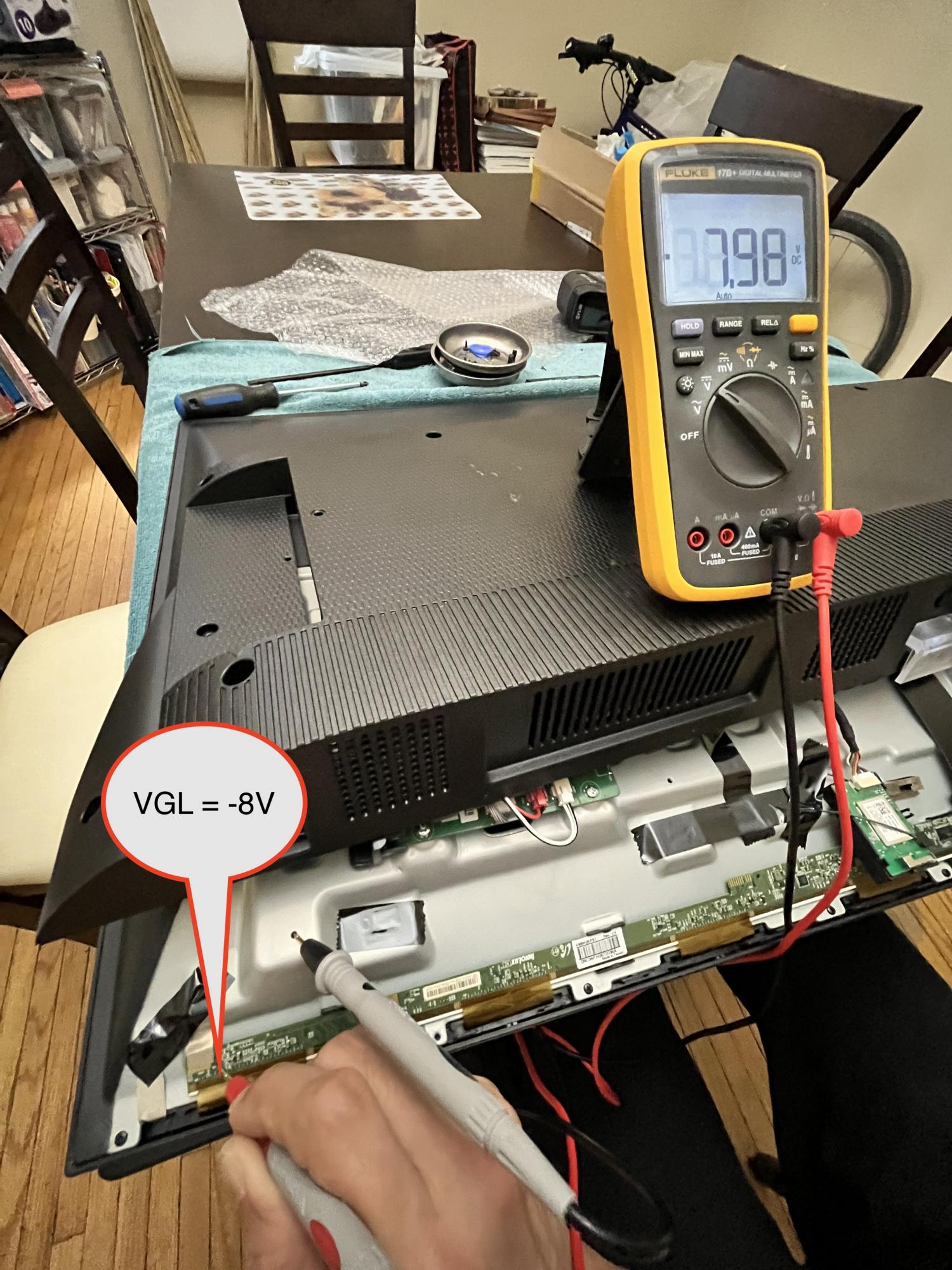

    Vgh and Vgl are both bad.

        90 Ohm is a normal resistance, it can be even lower, and 1 volt is the power supply of the processor core (there is always low resistance on this bus).

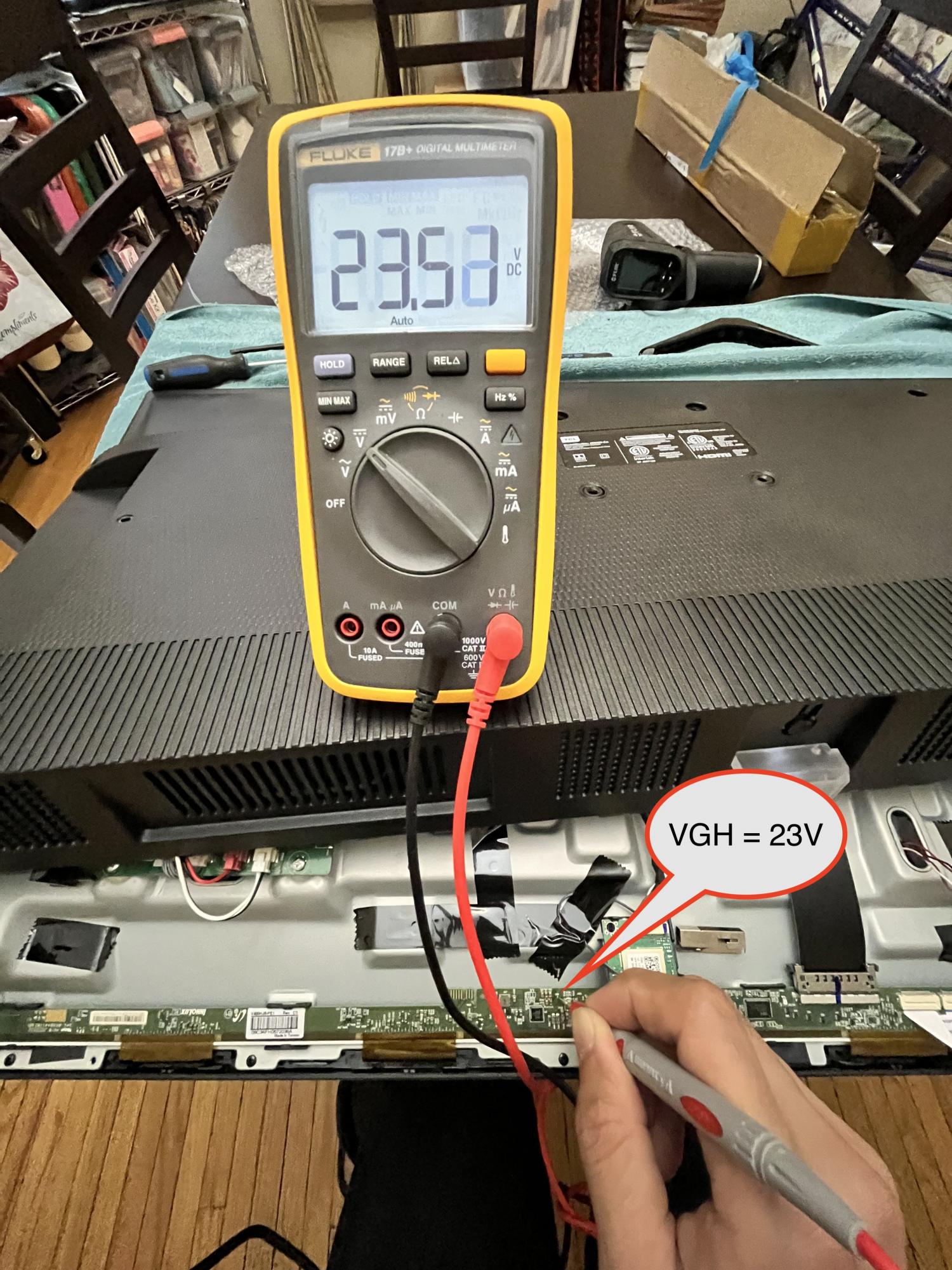

          vgh should be 20-30, vgl -5 to -12.

              Re: TCL 40S325-CA backlights, sound, no picture
              This is very good information. Thank you!

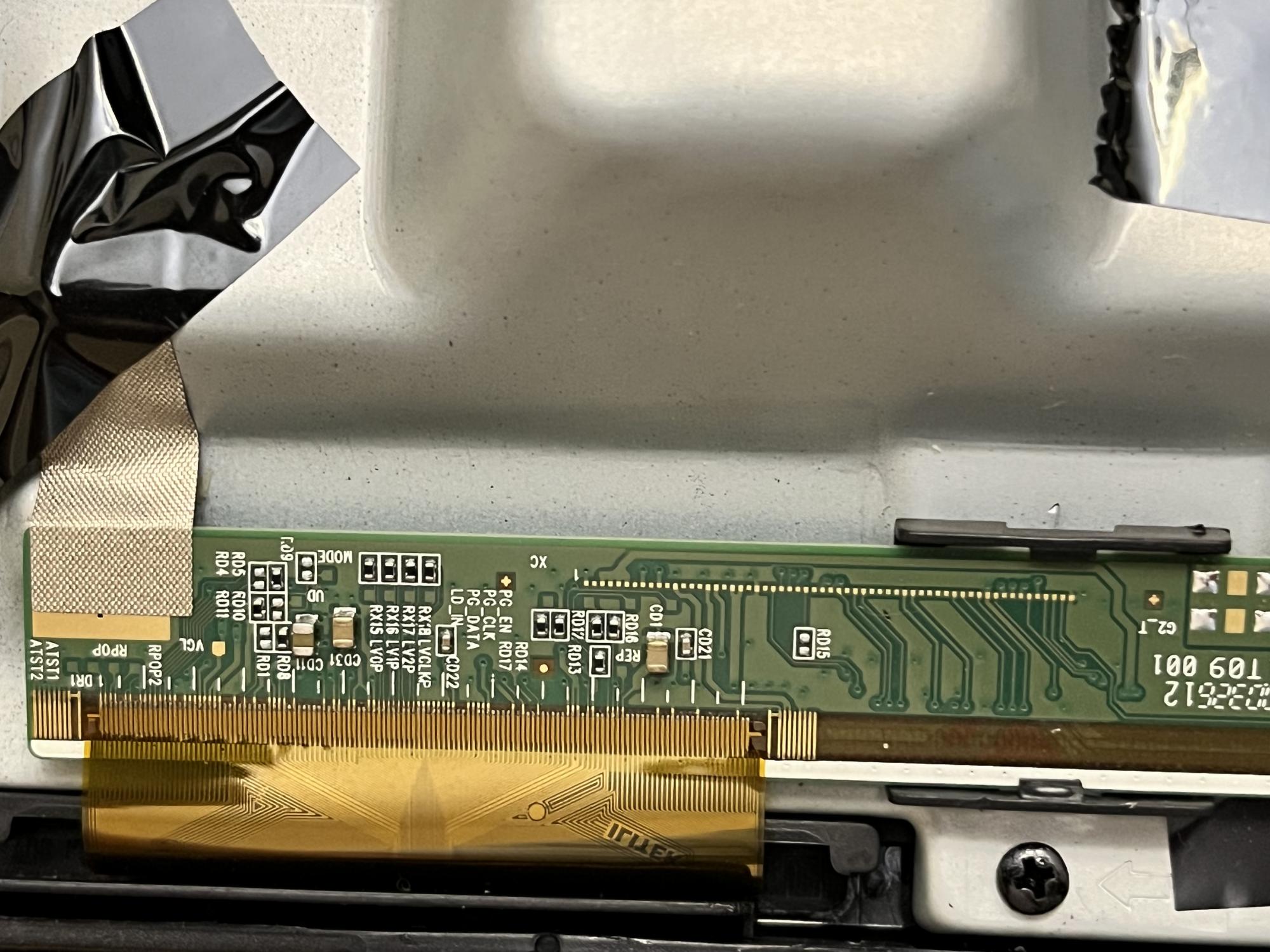

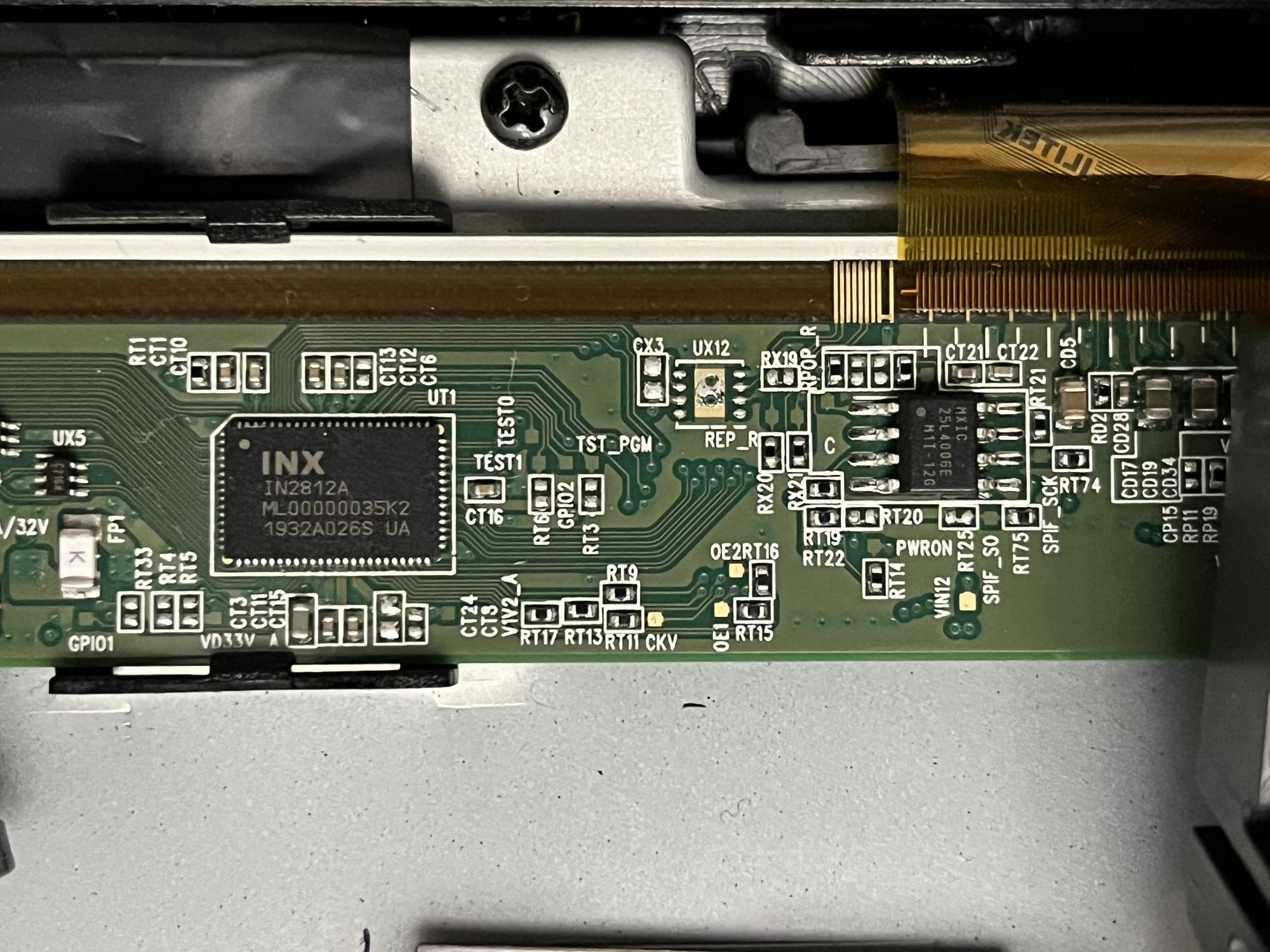

                  Okay, I did a bit of troubleshooting. Of the two FPC cables that join the two driver boards, I found where VGH/VGL are and disconnected that ribbon cable.
                  I turned on the TV but VGH/VGL is still missing, so it's not the secondary (left-side) driver board.

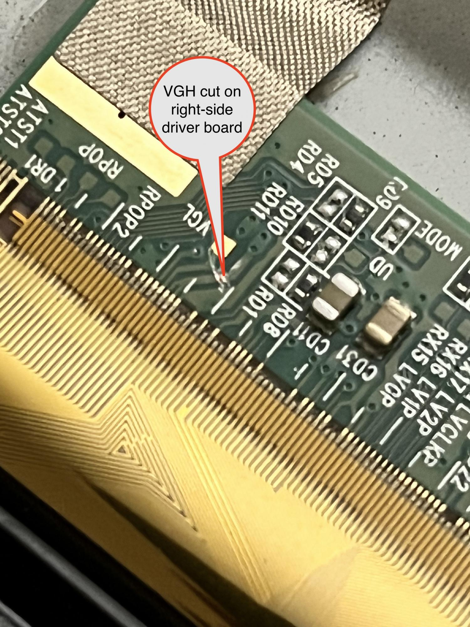

                  Since this is a trash TV, I had nothing to lose so I found where VGH was going to to the COF flex on right-side driver board and cut the trace. I turned on the TV and got VGH=23V and VGL=-7.98V. A bit of success!

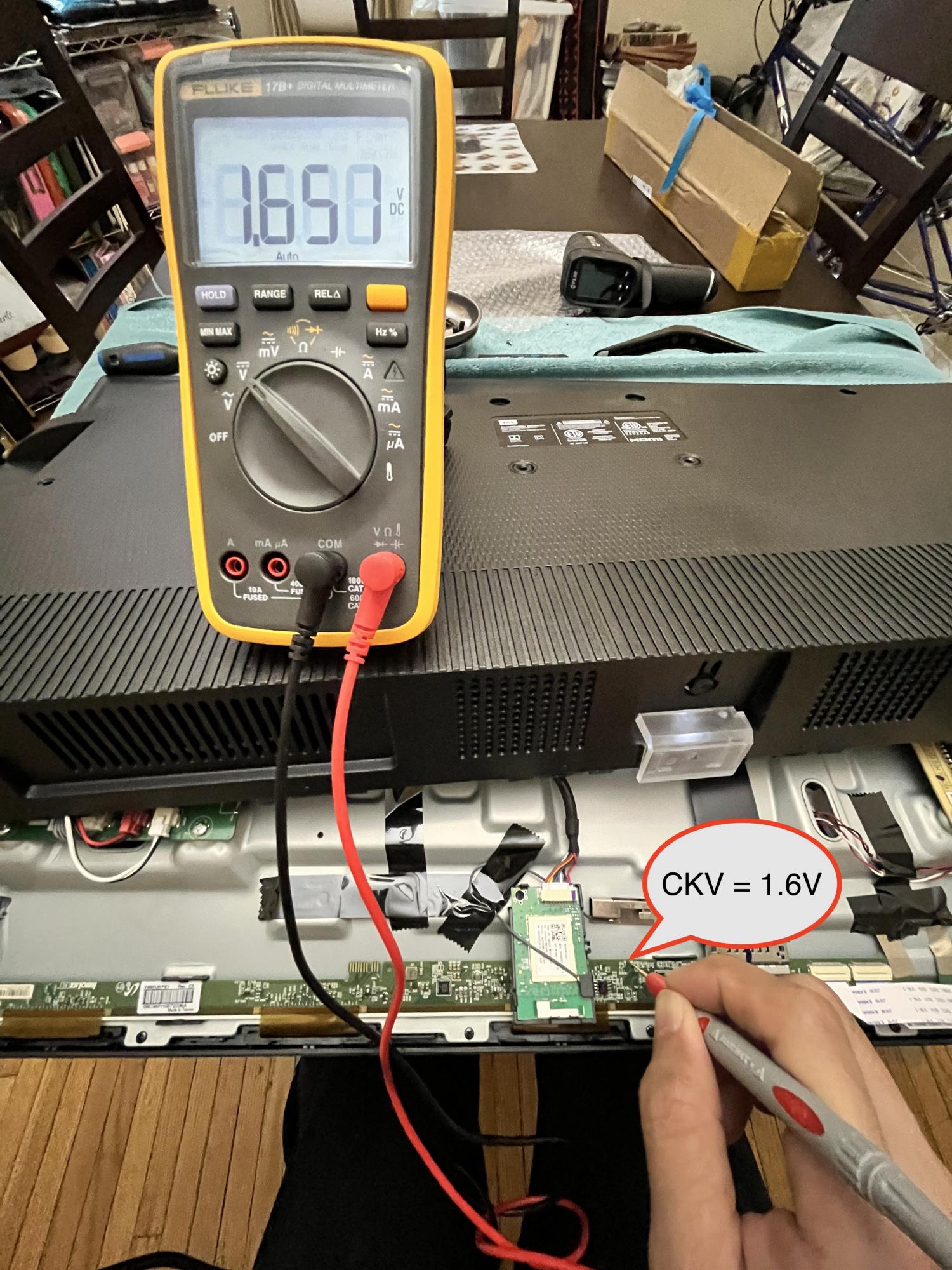

                  CKV=1.6V
                  STV=0V

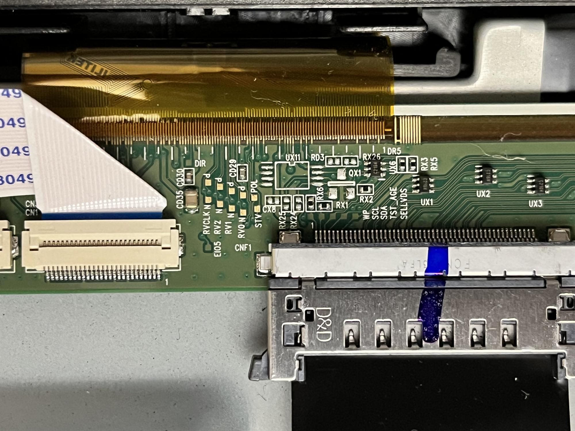

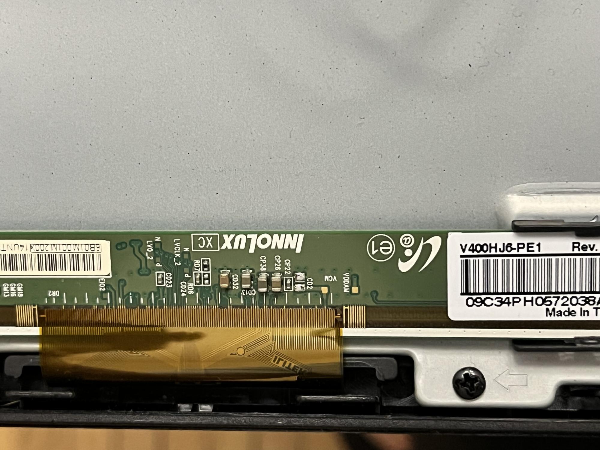

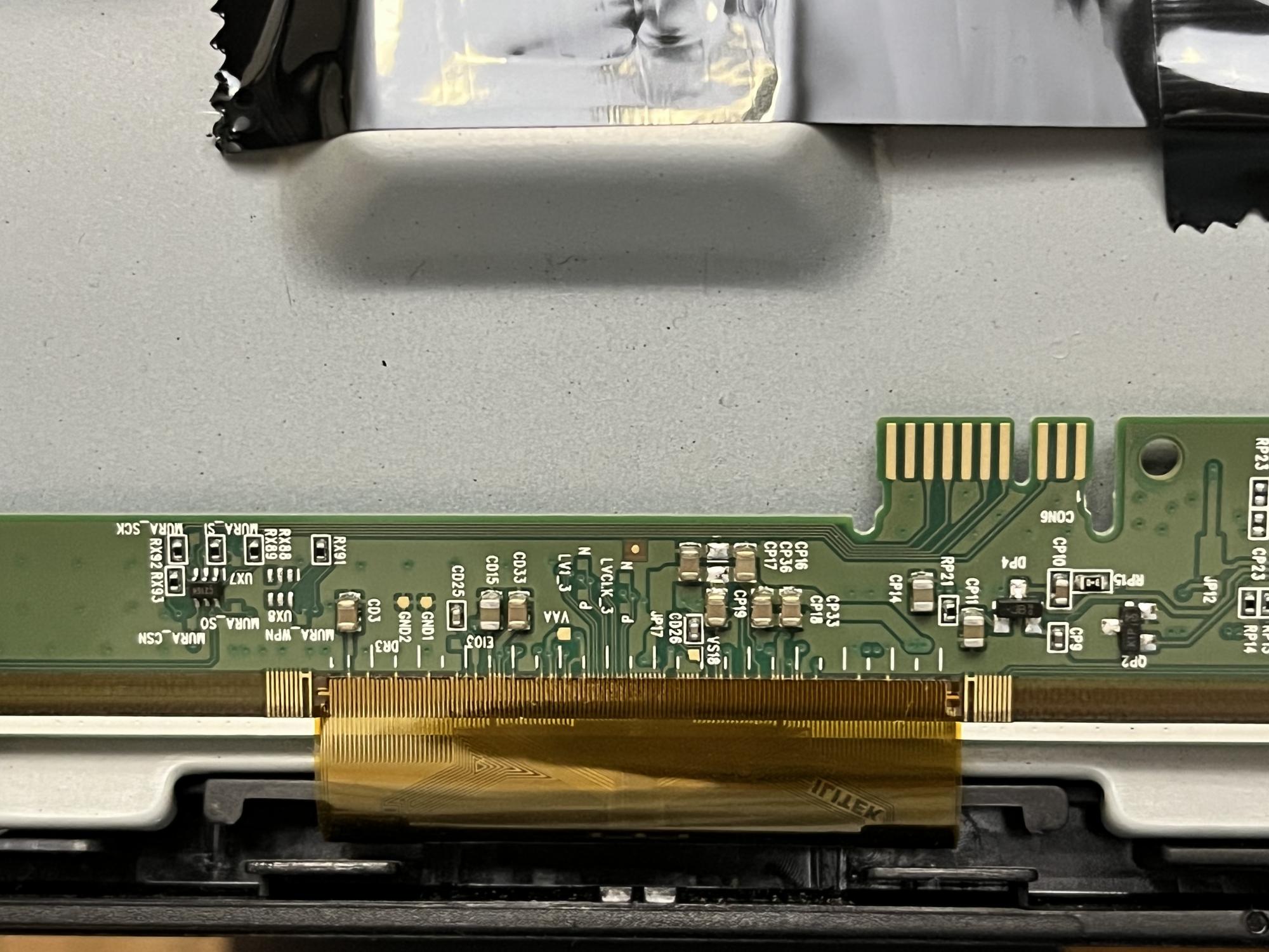

                    Attached are some more pictures of the panel driver board that I've been poking at.
                    Apologies, but the last two pictures seem to have been uploaded and rotated 180!
                    Last edited by lapse; 07-01-2022, 09:51 AM. Reason: Noticed last two pics are 180 out

                        I don't think it will... there's no dedicated TCON board. The signals seem to be passed-through one driver board to the other.
                        I think the tape cut off method _might_ work if the problem were on the panel driver board that's daisy chained off the main panel driver board (see first set of pics). However, the VGH trace that I severed is on the "main" panel driver board that has the LVDS connector going to it from the mainboard.

                          Probably need to inspect panel traces for short. And look at side cofs. If panel short you can jumper around it

                                Okay, I jumpered VGH to the side COF and got picture. Unfortunately huge horizontal lines are running across the screen. Spent enough time on this one, so I’ll scrap it for parts and take the rest to the dump!
