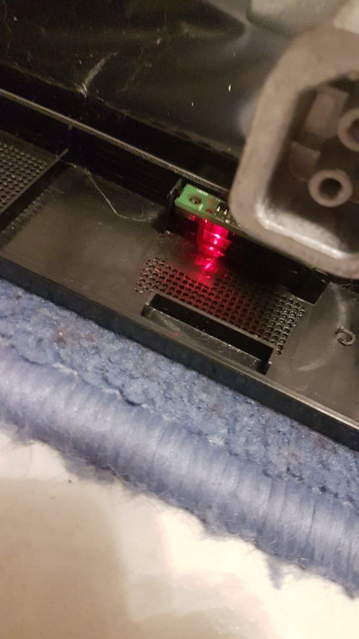

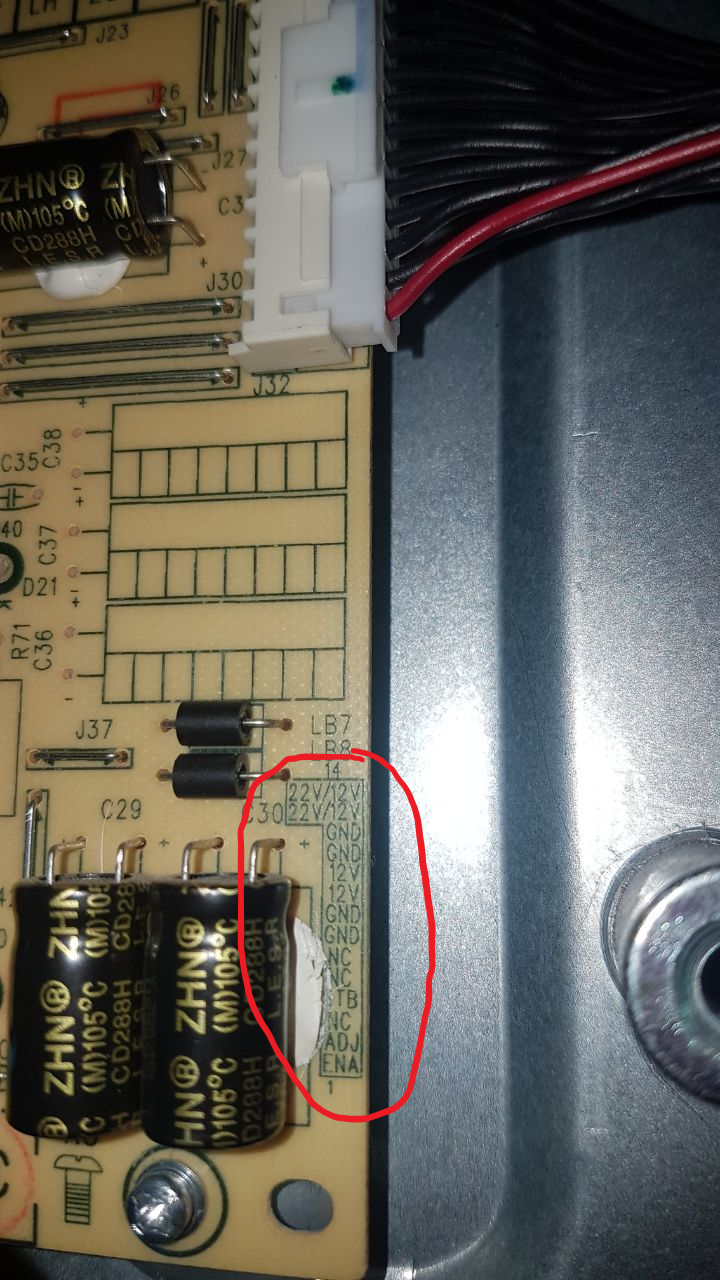

Strange Power Supply Behavior on Skyworth 55U5A14G
  • Gjackson
    • Aug 2021
    • 134
    • Malta
    Strange Power Supply Behavior on Skyworth 55U5A14G
    Hi, I have a 55 inch Skyworth tv that has a visible standby light but won't power on, Usually this fault is indicative of a bad main board but I went to test the power supply just to make sure of that. The power supply output has 14 pins (see image attached), here are my readings when the main board is connected to the power supply (PSU model: L5R021 ,I cannot find much info about it as it is not popular):
    22/12v - 12v
    22/12v - 12v
    GND - GND
    GND - GND
    12V - 12V
    12V - 12V
    GND - GND
    GND - GND
    NC
    NC
    STB - 4.66V
    NC
    ADJ - 4.98V
    ENA - 0.05V
    This is already a little confusing to me, first off I do not understand how 12v is at the output, isn't the enable pin practically at 0 volts? What is ADJ? and The STB seems a little low to me.
    The following are the readings I get with the main board and backlight connector disconnected from the PSU.
    22/12v - 12v
    22/12v - 12v
    GND - GND
    GND - GND
    12V - 12V
    12V - 12V
    GND - GND
    GND - GND
    NC
    NC
    STB - 0V
    NC
    ADJ - 0V
    ENA - 0V
    How come STB is now completely gone but the 12v remains still? STB should always maintain a constant voltage even when the main board is disconnected correct?
    If I have 12v at the output always, is the missing STB when it is disconnected an issue? Could I just buy a replacement main board and it would work?
    Forgive my inexperience but this all seems a little too confusing for me, any help would be very much appreciated!!
    Last edited by Gjackson; 05-21-2022, 04:23 PM.
  • R_J
    • Jun 2012
    • 9535
    Re: Strange Power Supply Behavior on Skyworth 55U5A14G
    This is an always on power supply that outputs 12 volts at low current, The stb pin voltage is supplied by the main board and turns on the pfc circuit etc on the power supply so it will operate at a higher current to operate the tv/backlights etc.
    The main board will likely have a 12 volt to 5 volt regulator.
    The STB pin is the same as a PS_ON pin.
    Last edited by R_J; 05-21-2022, 05:07 PM.
    • Gjackson
      • Aug 2021
      • 134
      • Malta
      Re: Strange Power Supply Behavior on Skyworth 55U5A14G
      Thank you!
      • dskall
        • Oct 2016
        • 2905
        • usa
        Re: Strange Power Supply Behavior on Skyworth 55U5A14G
        So then STB should change state when you push power button? What is ENA for?
        • lotas
          • Jan 2016
          • 4562
          • Russia
          Re: Strange Power Supply Behavior on Skyworth 55U5A14G
          ENA - enable backlight
          • Gjackson
            • Aug 2021
            • 134
            • Malta
            Re: Strange Power Supply Behavior on Skyworth 55U5A14G
            I see, I had them mixed up. I thought ENA was for the PSU enable not backlight, i will buy a new main board and replace it. The PSU seems fine at this stage
              by sam_sam_sam
              03-31-2024, 02:12 PM
              by sam_sam_sam
              07-01-2024, 06:34 AM
            • CMCM
              Russound CA4 Power Supply Repair
              by CMCM
              Hello Everybody,
              Trying to repair a power supply from a Russound CA4 Multizone Controller (picture attached)
              Russound no longer supports it but were kind enough to provide a schematic of the power supply (pdf attached).
              The outputs marked 12v and 20v are all measuring only 1v.
              The board is clicking, which I think means it is in something called hiccup mode when the flyback transformers switches because of an internal problem or something else on the board Overloading it.
              The capacitors physically look clean (no bludgesor leaks) and...
              07-03-2025, 01:12 PM
            • Dani_2024
              by Dani_2024
              10-28-2024, 05:06 PM
