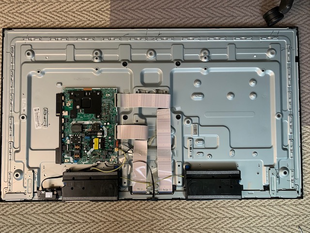

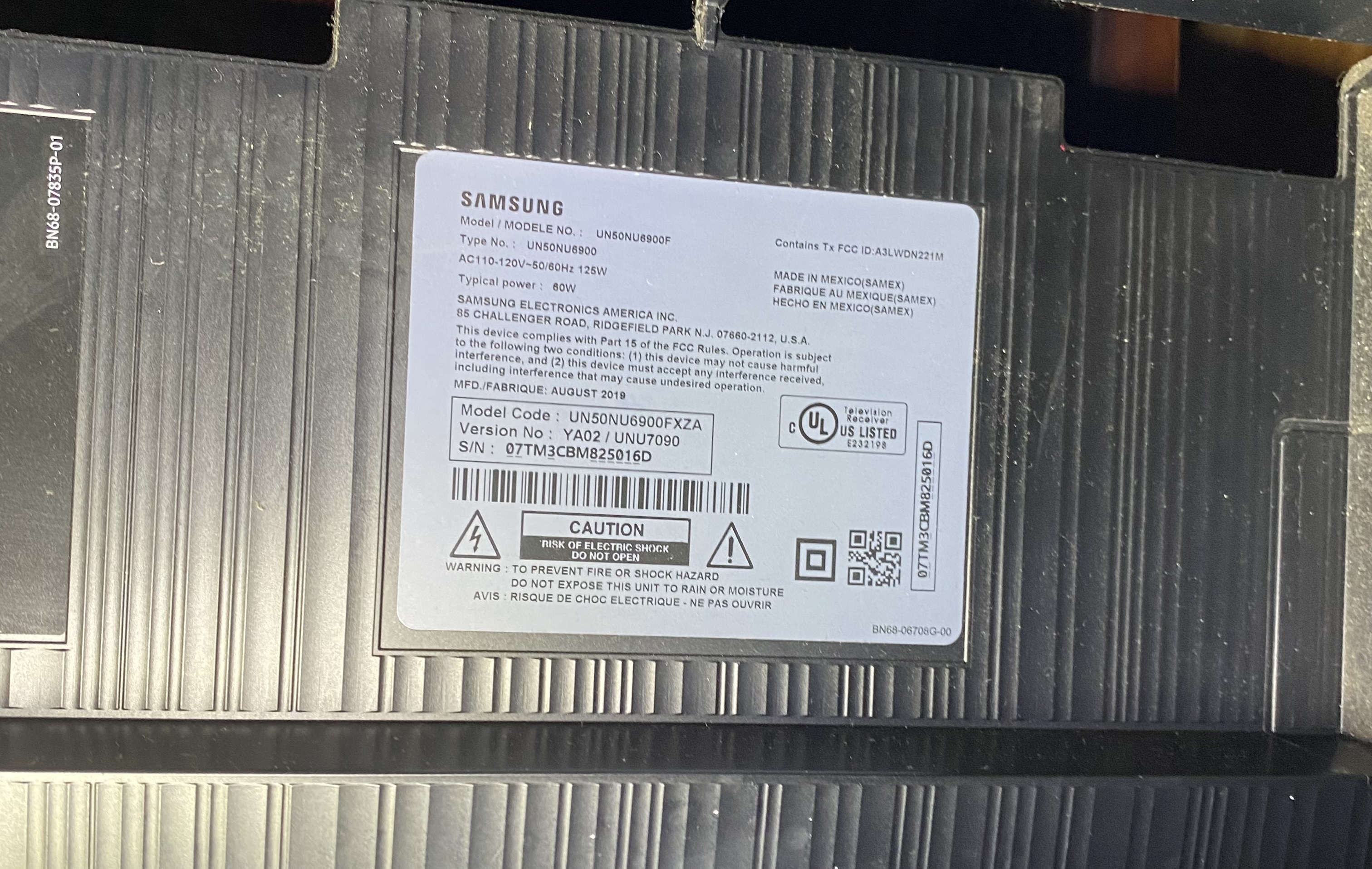

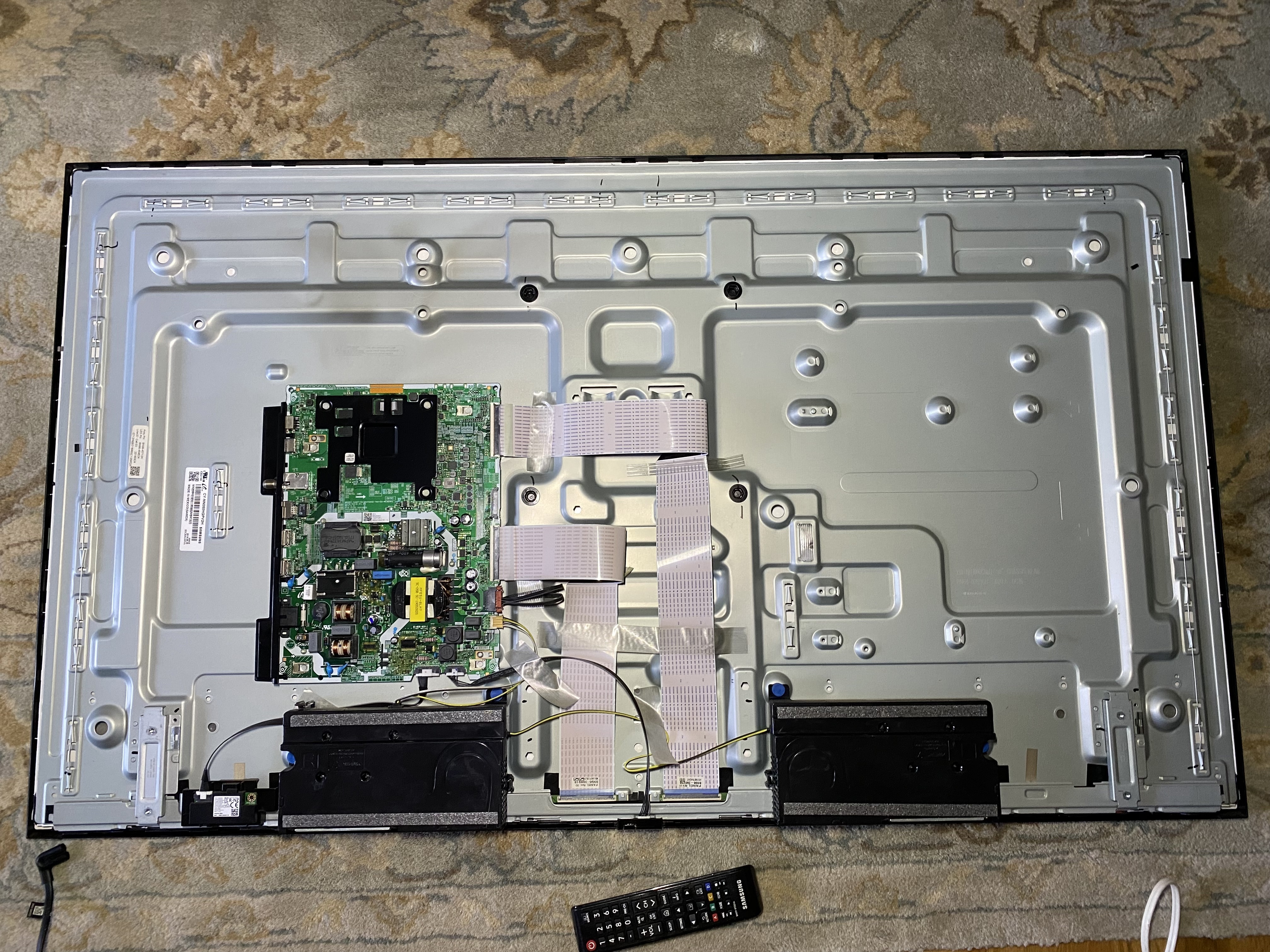

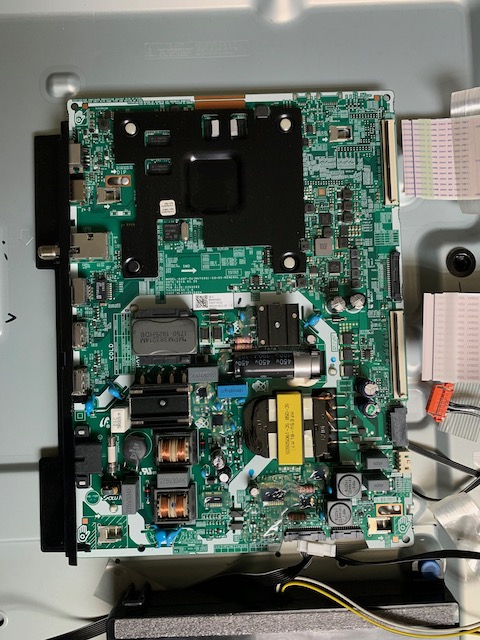

    Looks like a common problem. Remote powers on power light with only high pitch squeal (and eventually cycling 3x) from the all-in-one board (main+PSU+tcon). No picture no sound. With the rear cover removed, squeal sounds like it came from main board section under the heat sink (which doesn't make sense of course but maybe just due to all-in-one board design) Here is a sound sample, turn up volume to hear.
    https://youtube.com/shorts/oc5PQiZkQ8g?feature=share

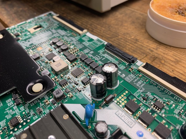

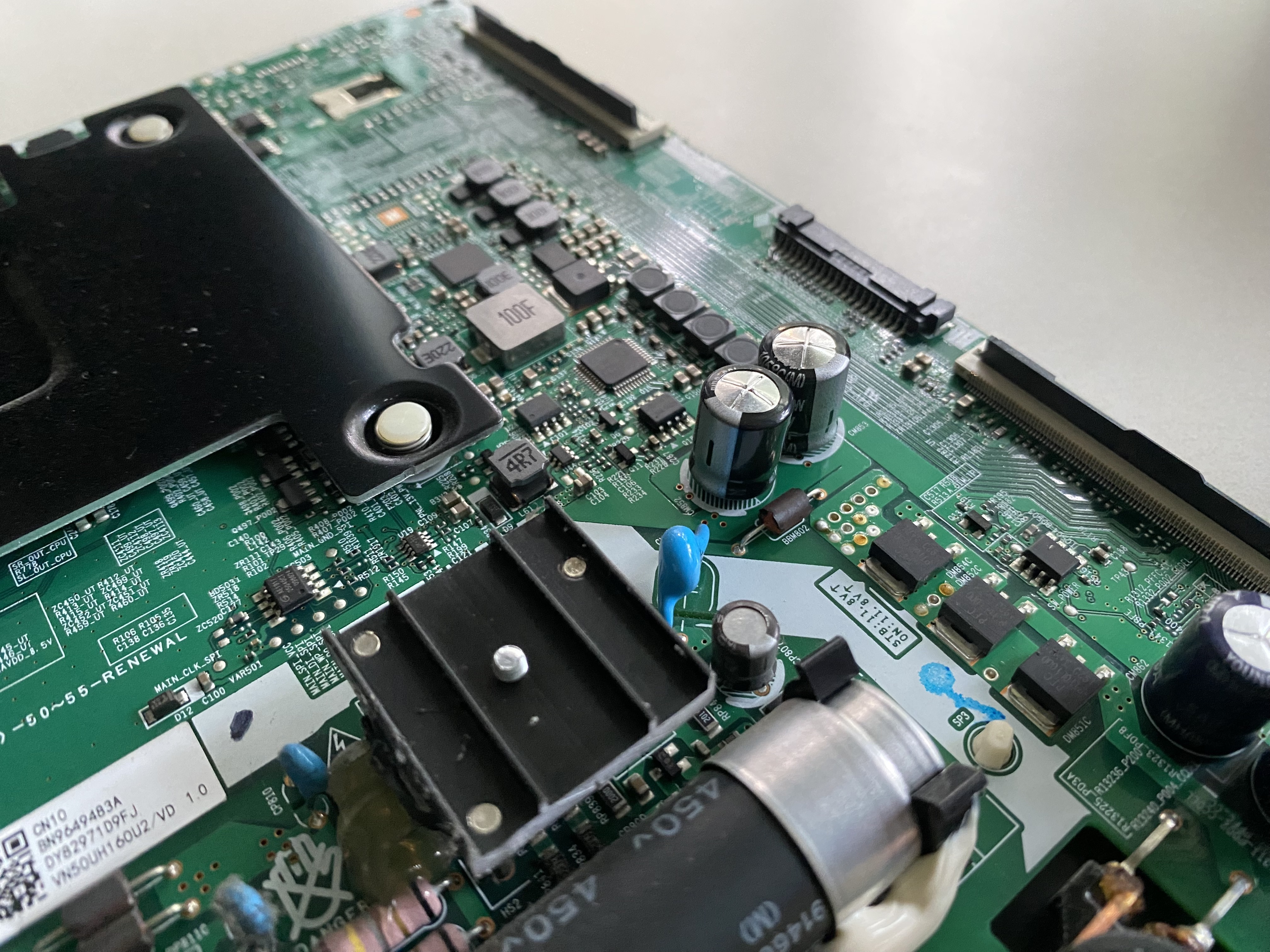

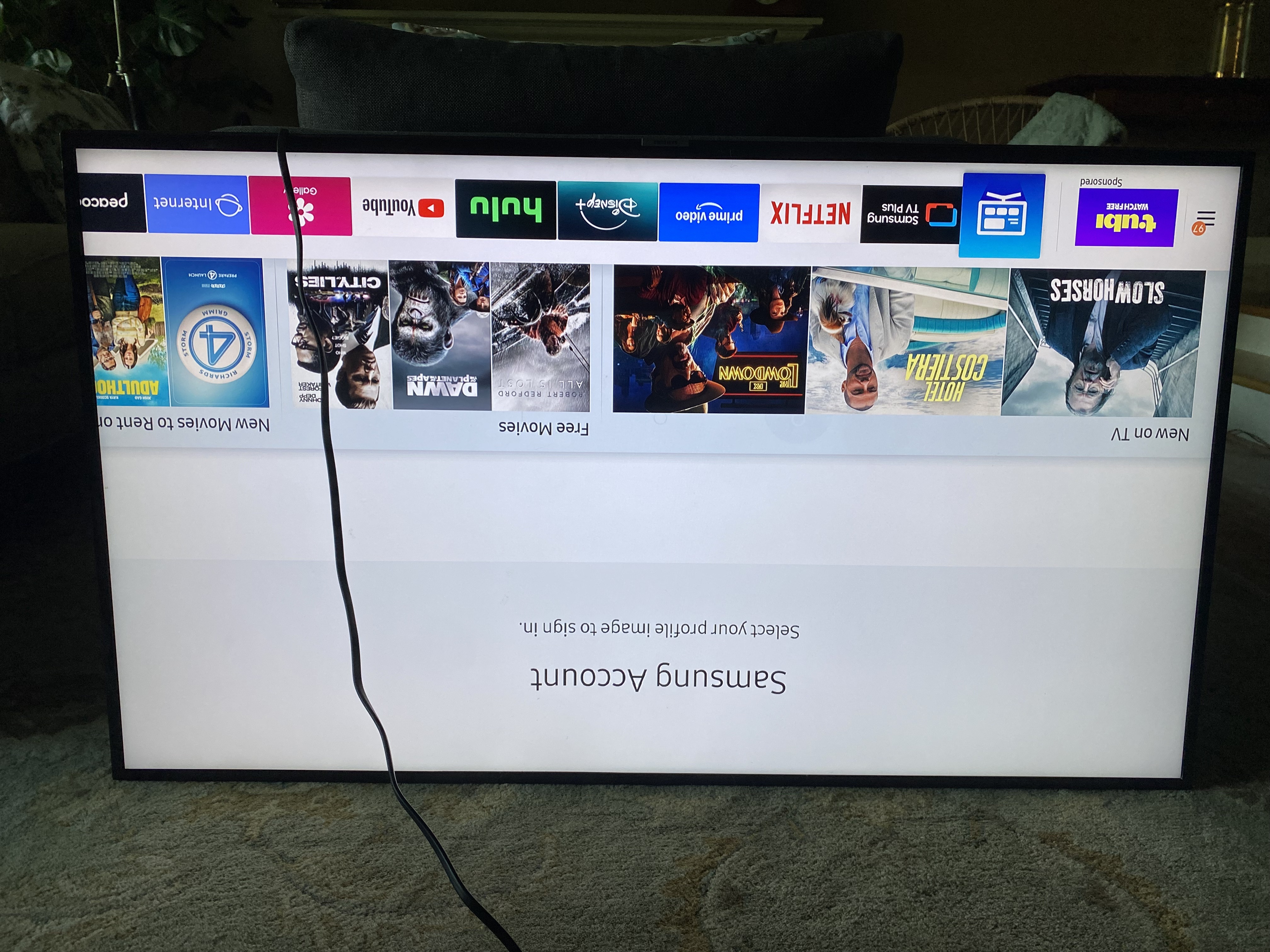

    2 PSU section caps were bulging. Replaced both of these fixed the TV. Spec is 470uF 25V and only reads 120uF after removal.

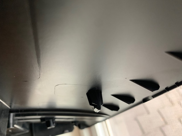

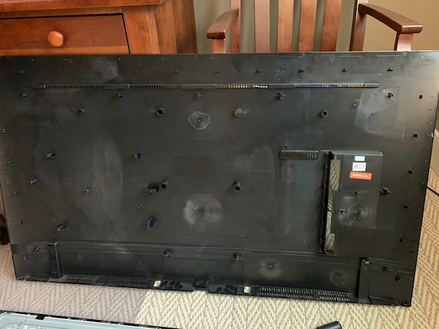

    Here is how to open the back. See the pic showing the plastic fingers on the rear plate clipping onto the metal frame+wire. Do both sides and top first and bottom last. Bottom separates pretty easily with a flat screw driver parallel to bottom face. On the bottom, don't jam it inside where all electronics, wires, and speakers are.

    NU series has lots of backlight failures due to edge lit design with lower number of LEDs running brighter and hotter. Rare to see cap failures in LED TVs. Have never seen one personally yet.

          Samsung has decided to go screwless on these. Basically snaptite construction everywhere. I taped everywhere the rear case snaps onto the chassis and the 2 metal leg mounts where its metal on metal contact. Clicking seems quite a bit less.

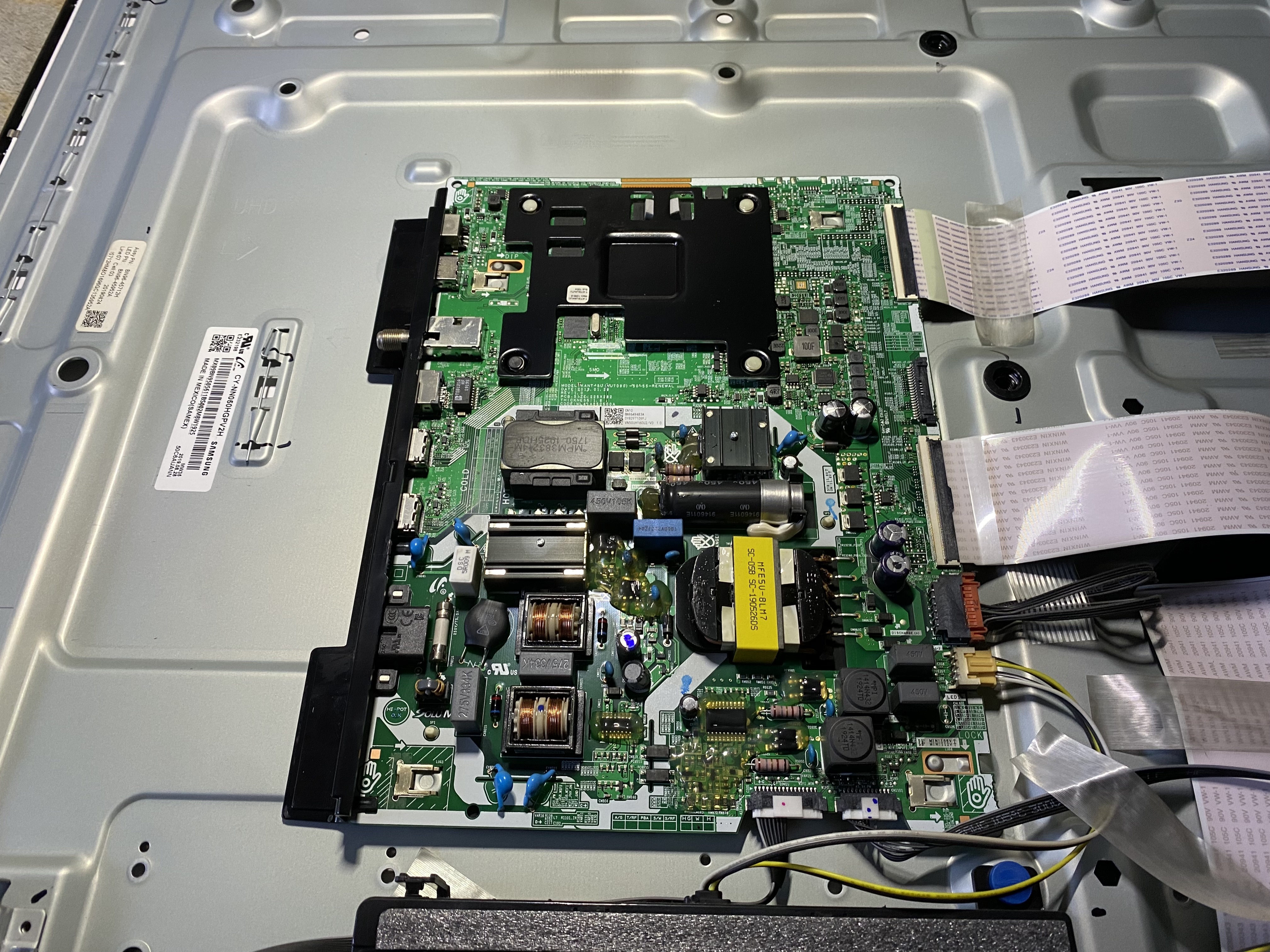

            I am fixing the same model right now.
            Noticed some buzzing noise coming from main board.
            Narrowed it down to one of these 2 inductors, they are in backlight circuit.
            Tone of the sound correlates with amount of backlight.
