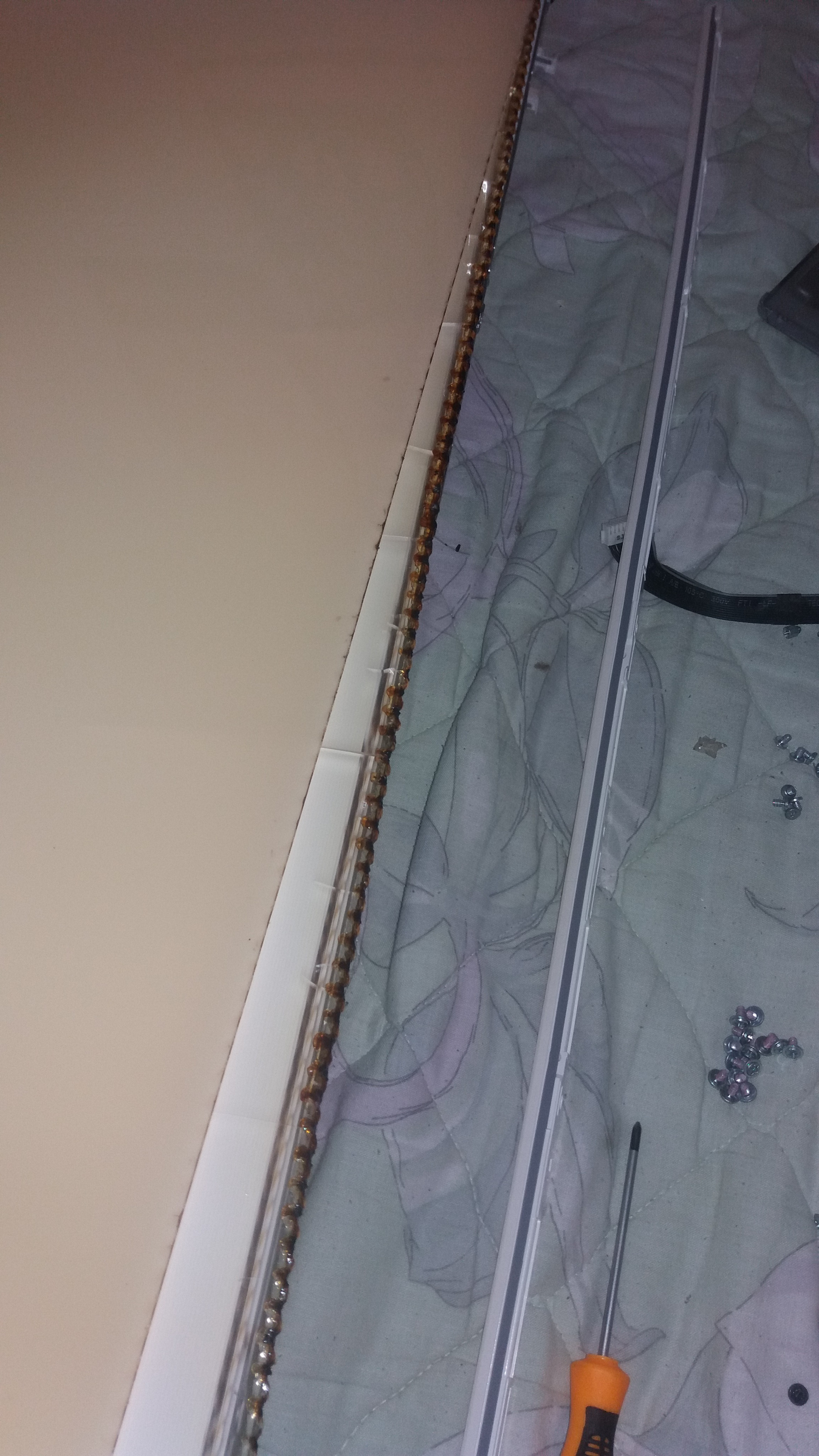

    This is a curved samsung EDGE lighted TV With bad leds. Now When i opened it up i found disperser glass to be terribly burned by the leds and even has some heat stress cracks on it as you can see in pictures. I already told the customer about the issue but to be honest i dont know if replacing the leds will yield a good picture. Im thinking its probably gonna have dark spots , but do you think its worth doing this job on this condition of glass? Here are pictures
    This last picture really shows the terrible condition the glass is in.
    Is this a dumpster TV?

      Not worth fixing. Even if you replace leds you will see the black burn marks. And if you clean them off you will get bright hotspots unless you replace that diffuser.
