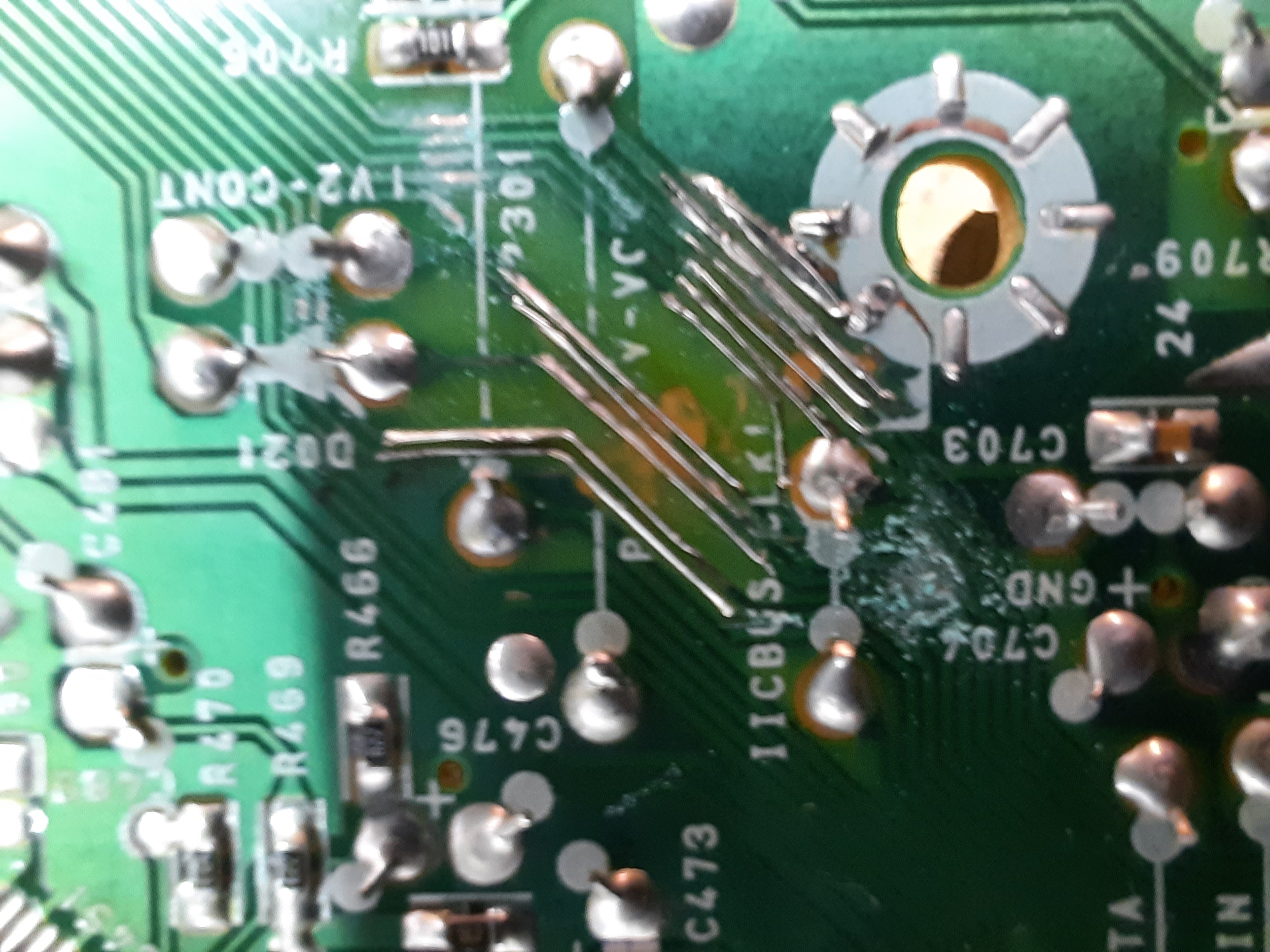

          Discovered some recent looking track work on main .
          Clean off flux & checked the track repair , which seems good .Not sure if this is related to current issue .

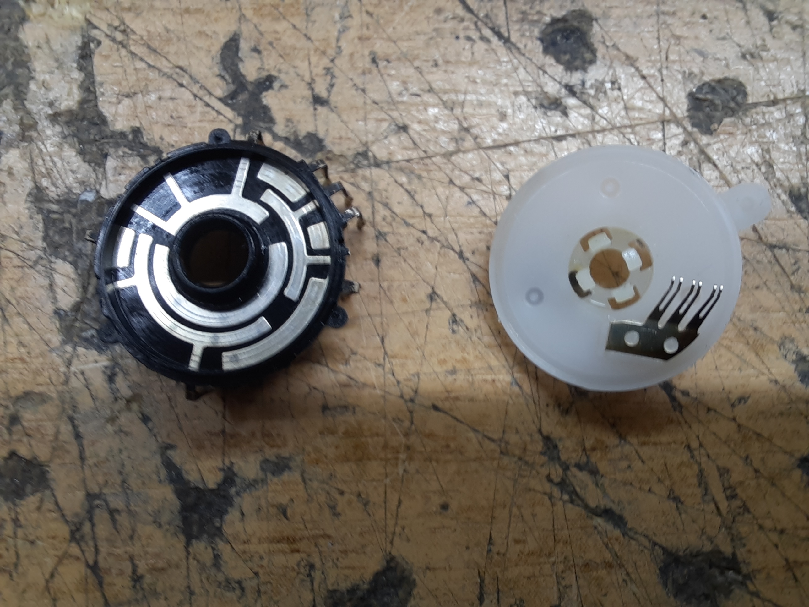

            Stripped VCR mode switch , cleaned tracks & re - tension ed spring contacts .

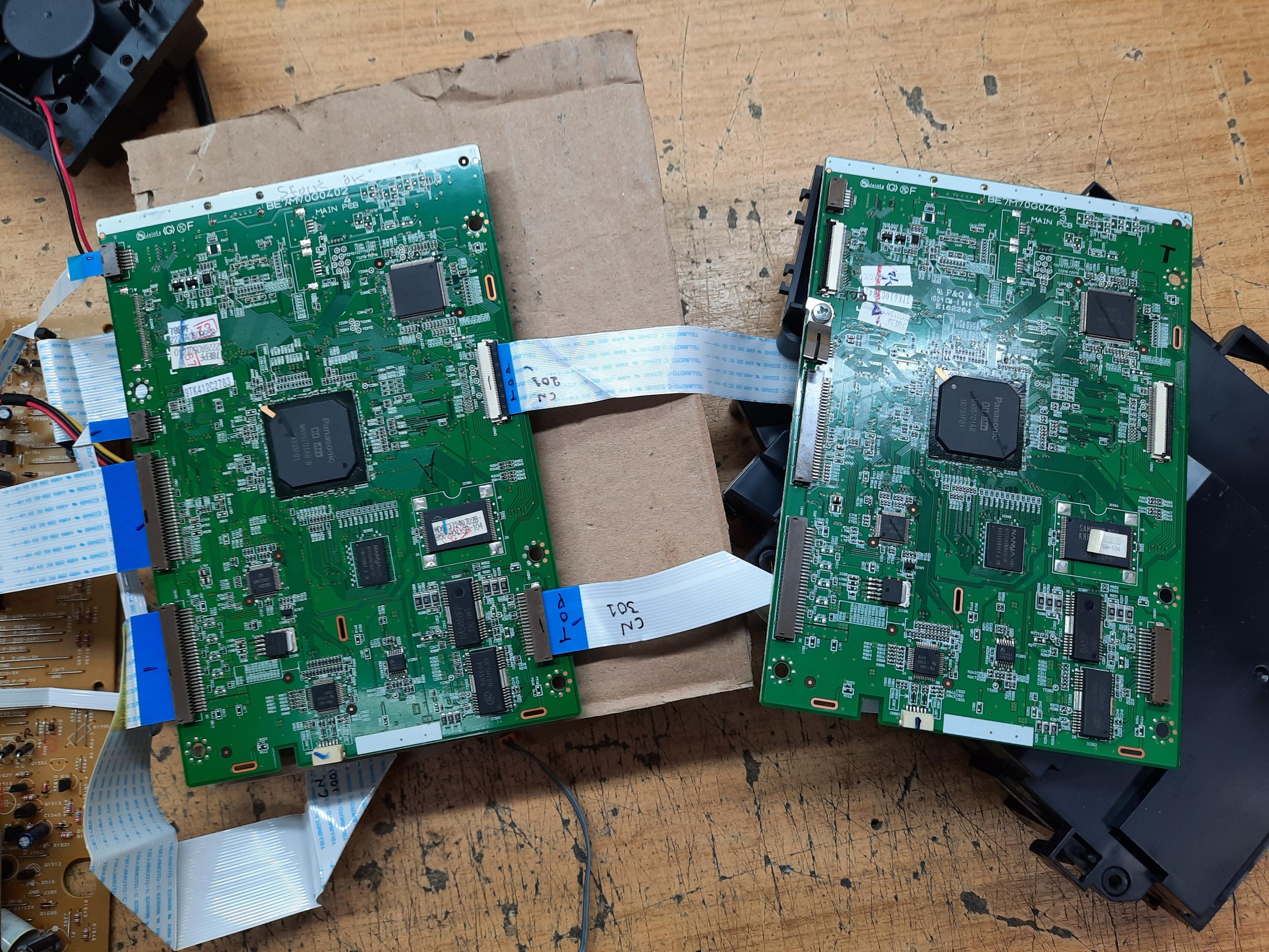

                Anyone know how these machines react with HDD disconnected ?
                Managed to get hold of a working digital board , from a non HDD version of this machine to test . It looks identical apart from no connectors for hard drive.
                Unit still shuts down immediately .

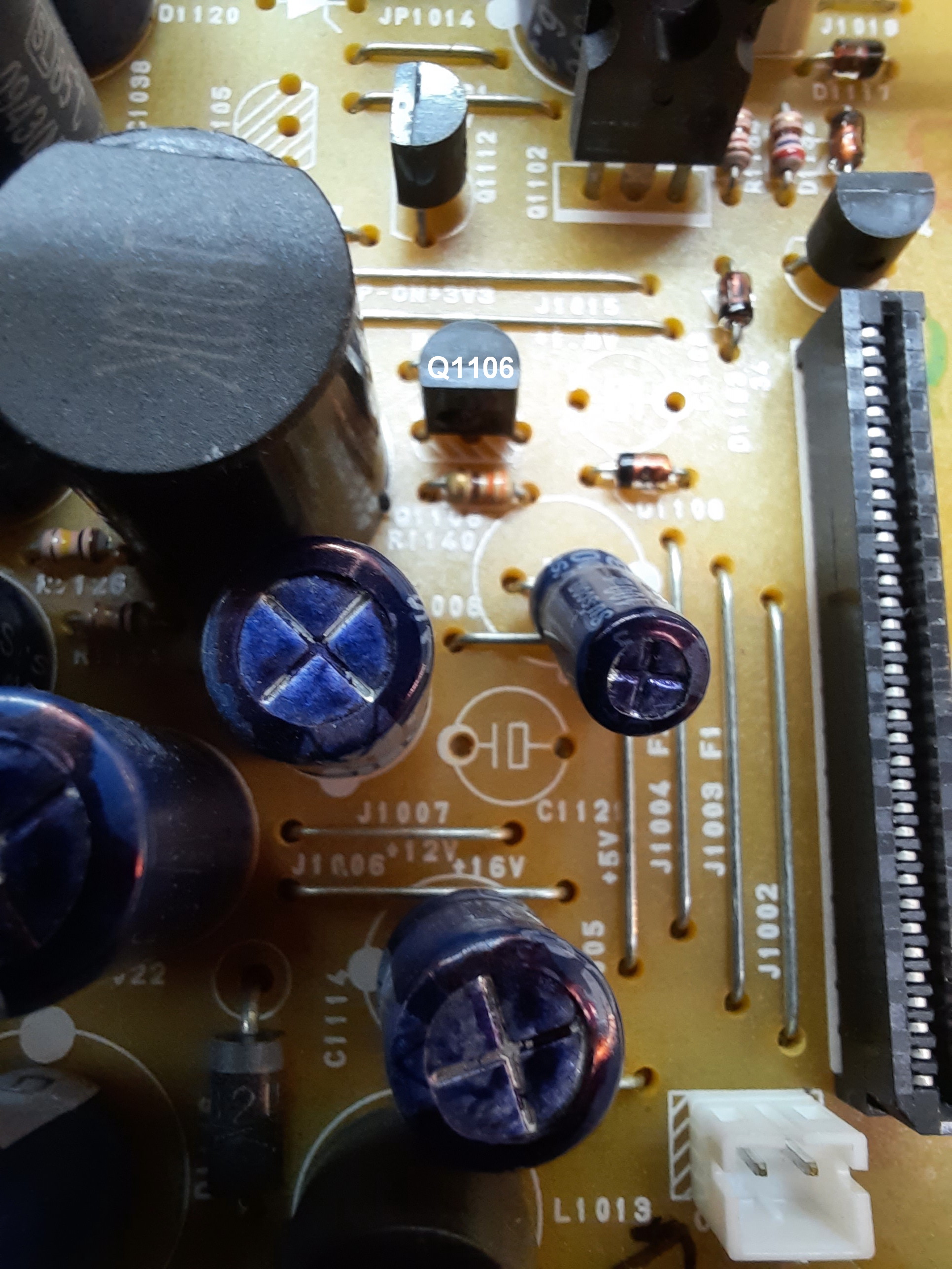

                  Got it . Hard to spot but there's a burn mark on Q1106 ( STD1862 ) PSU module .
                  Slightly confusing as wiring doesn't match up with schematics .
                  I assume PSU must have been revised after schematics drawn up .
                  PSU TYPE BE3TK3F01 02 3-A VERSION - 08
                  i'm sure there will be more components faulty . Will update.
