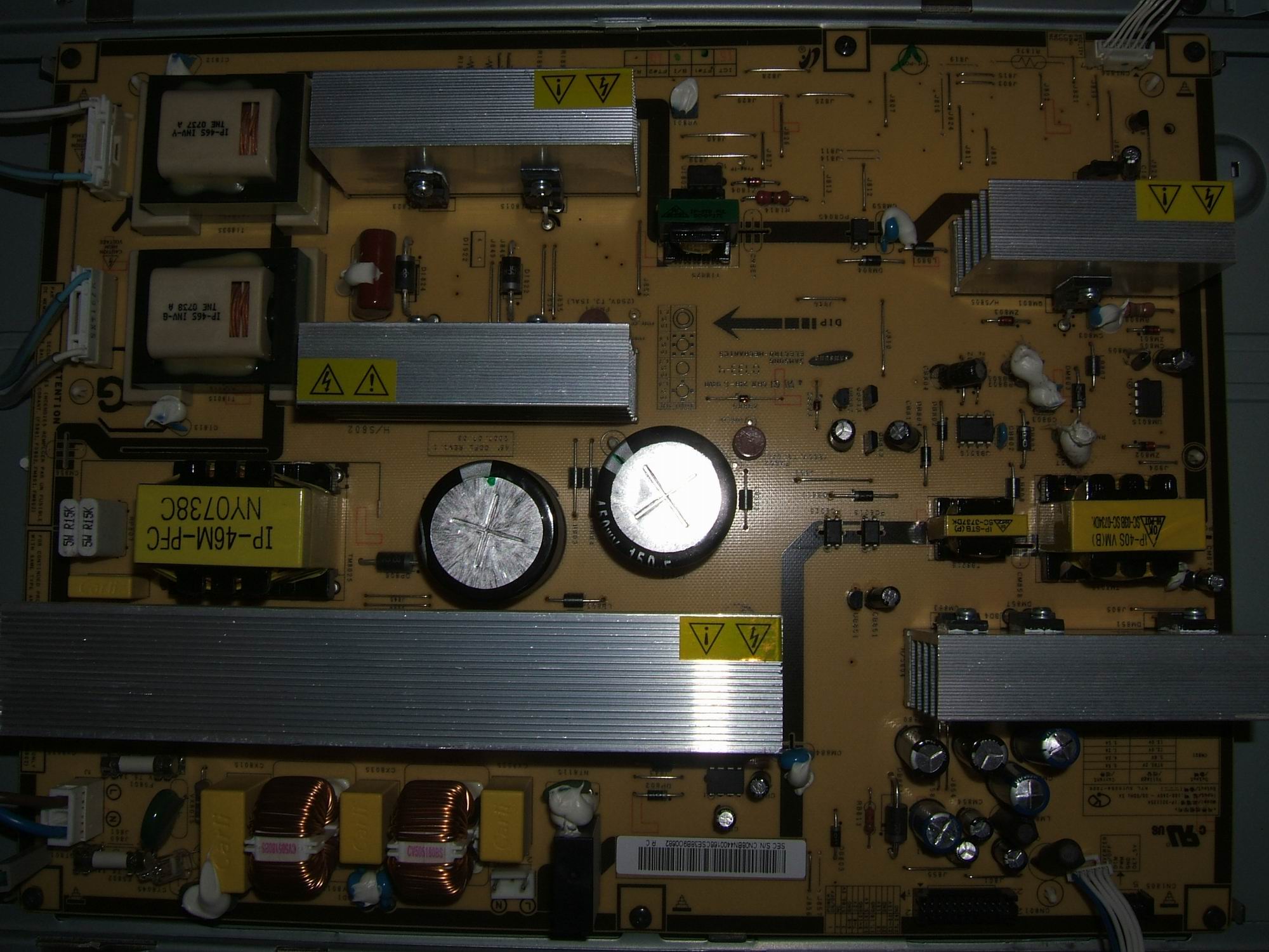

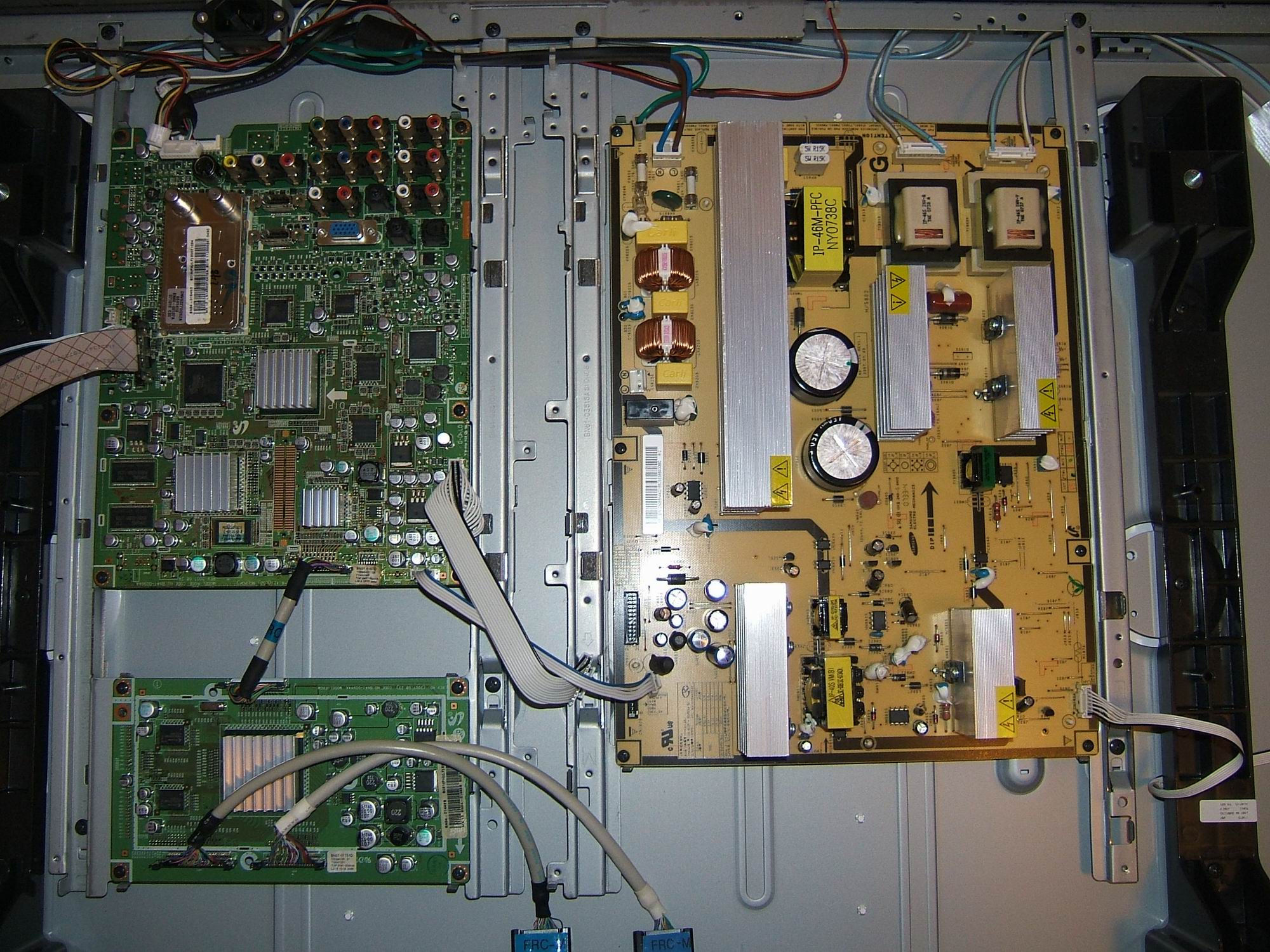

    Power Supply IP-321135A BN44-00166C 380203337243 KTLSU10054-7006 ICE1PCS02 DM0365R ICE2BS01 FAN7382

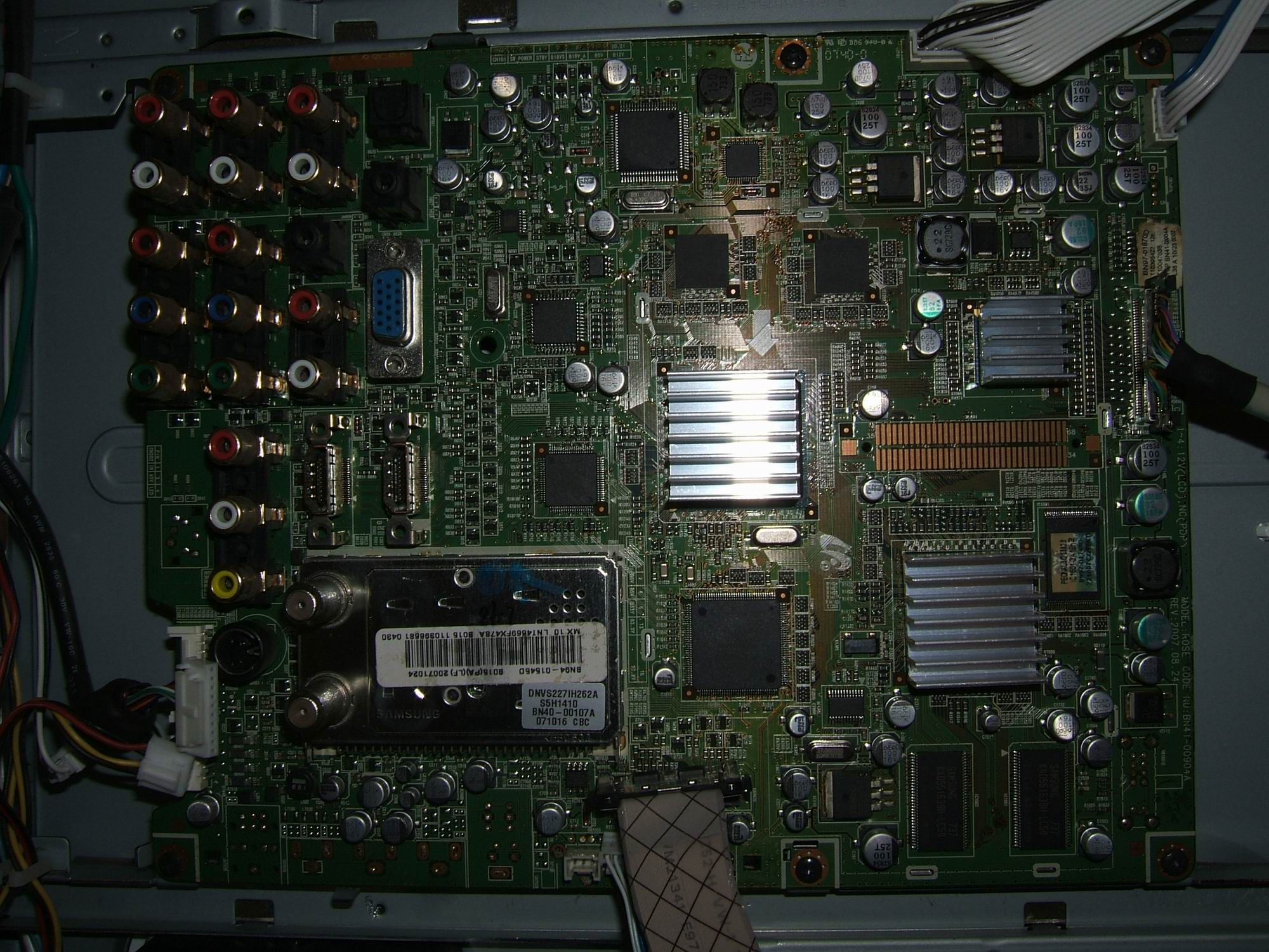

    Video Tuner IO Processor Board BN41-00904A BN97-01870D BN41-01545D BN40-0107A MSP4450K WT61P6S Sil9185CTU Sil9125CTU

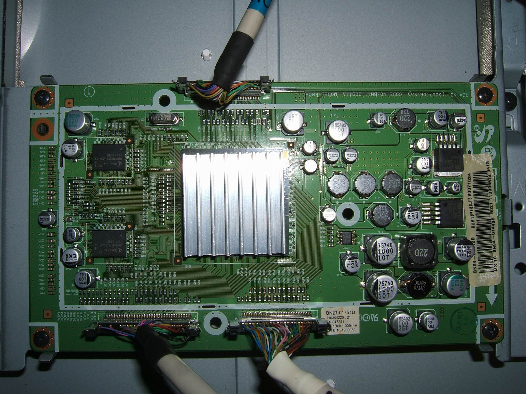

    Panel Interface Board: BN41-00944A BN97-01751D BN94-01442B
    Panel Driver: 40/46/52HHC6LV3.3

    There are different but compatible versions of the BN41-00904A board. Some TVs have HDMI3, USB, and AV2 on a separate board at the edge of the monitor connected by wires. Other TVs do not use a separate board so all of the connectors are soldered directly to BN41-00904A. My TV has the separate board and I bought a BN41-00904A without the riser connectors so I transferred them over. I cut the steel shield.

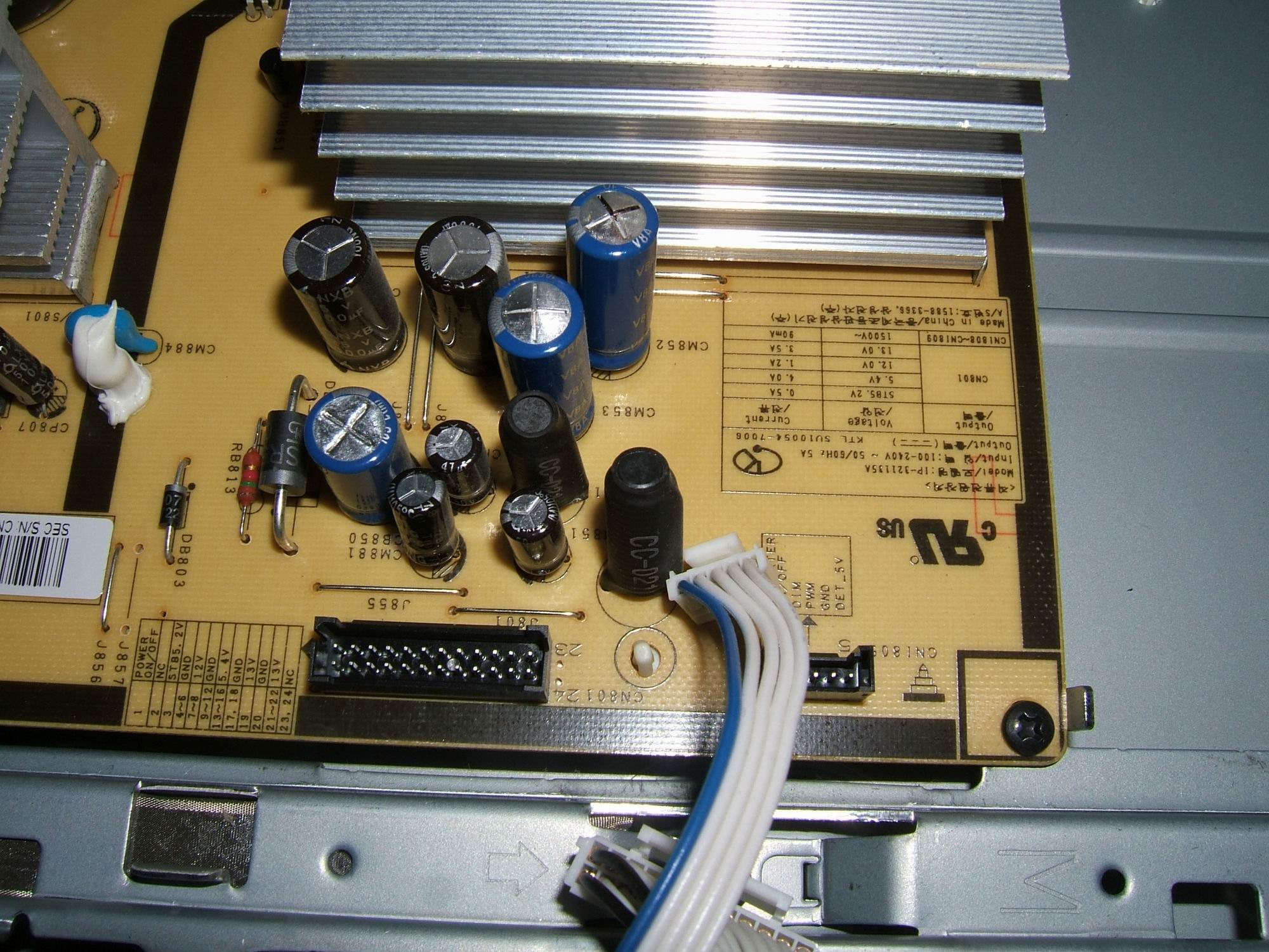

    TV didn't turn on. Two power supply caps popped supplying the 5.4v rail.
    CM851, CM852: Samwha 2200uf 10v 105*C XC
    Other nearby caps didn't burst:
    CM880, CM876: Sam Young 1000uf 25v 105*C NXB
    CB850: Samwha 1000uf 10v 105*C XC

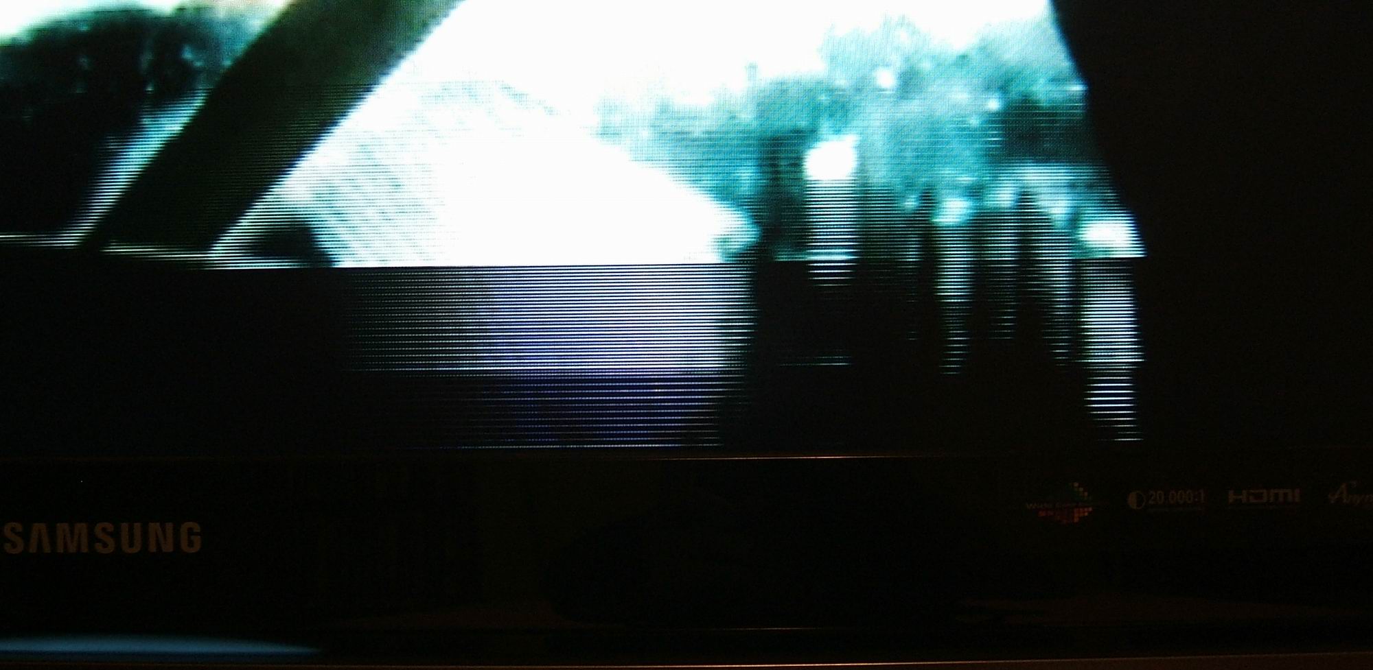

    With the new caps the TV turns on just fine but there's a picture problem. After an hour or so into a movie the lower 1/5 of the screen goes interlace crazy. The picture spreads out over every other line. The line where the interlacing starts varies so the spread picture bounces up and down. Bad interlacing only shows up when the plastic back is on.
    Interlacing is a complex function and should be controlled by the main board BN41-00904A and it looks like it is affected by heat. Heating chips with the SMD heater set to 100*C didn't show anything. I threw a towel over it with the cover off to trap the heat which didn't show anything. I did a heat survey. The hot spots are the chips with heat sinks IC1901, IC1301, IC1001, the regulator IC107, and IC202 that run at 160*F. Other areas run about 120*F. Then I did a cap ESR survey. The caps near the hot spots look pretty good.

    Testing just a few of the worst caps doesn't show any clear cap failures. It takes a long time to verify whether a part swap was successful. This wasn't a problem before the power supply caps went out, a problem that is more likely to damage semiconductors than caps. I quit testing for bad caps and ordered the video board.
    With the new board in I tested the TV for a few hours with the back on and a towel over the vents. No interlacing. The TV was returned to the owner and no more interlacing.
