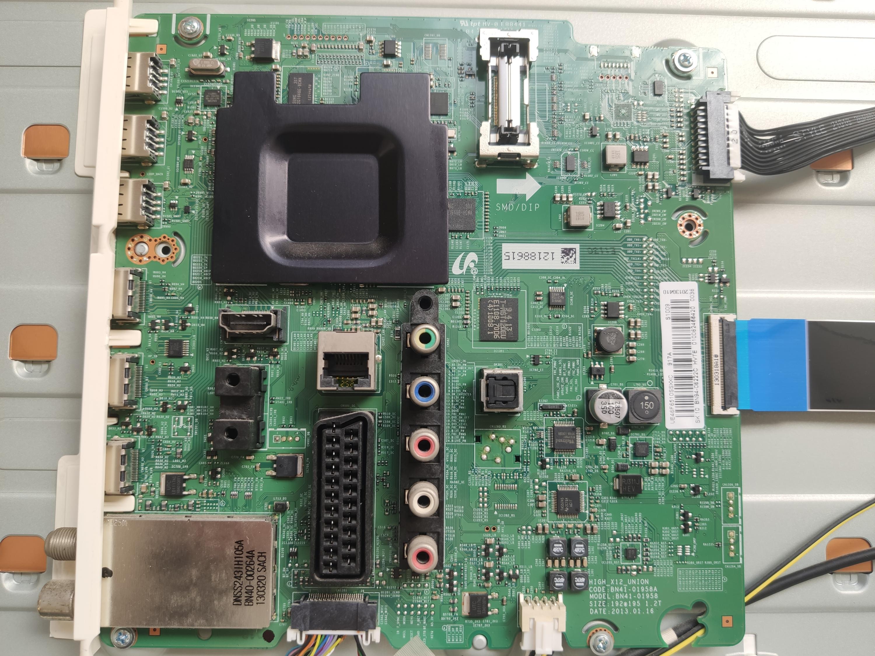

Samsung_ue32-40-46-50-55-64-75f6400_u85a reboots on volume up.
  • pepegotera454
    • Jul 2014
    • 15
    • andorra
    Hello, I attached diagrams and solution to the problem. It is a problem with the power supply board, the CS858 Capacitor must be replaced.
  • pepegotera454
    • Jul 2014
    • 15
    • andorra
    Re: Samsung_ue32-40-46-50-55-64-75f6400_u85a reboots on volume up.
    It is a problem with the power supply board, the CS858 Capacitor must be replaced. The reason for the reset is an increase in current consumption at the output stage.
