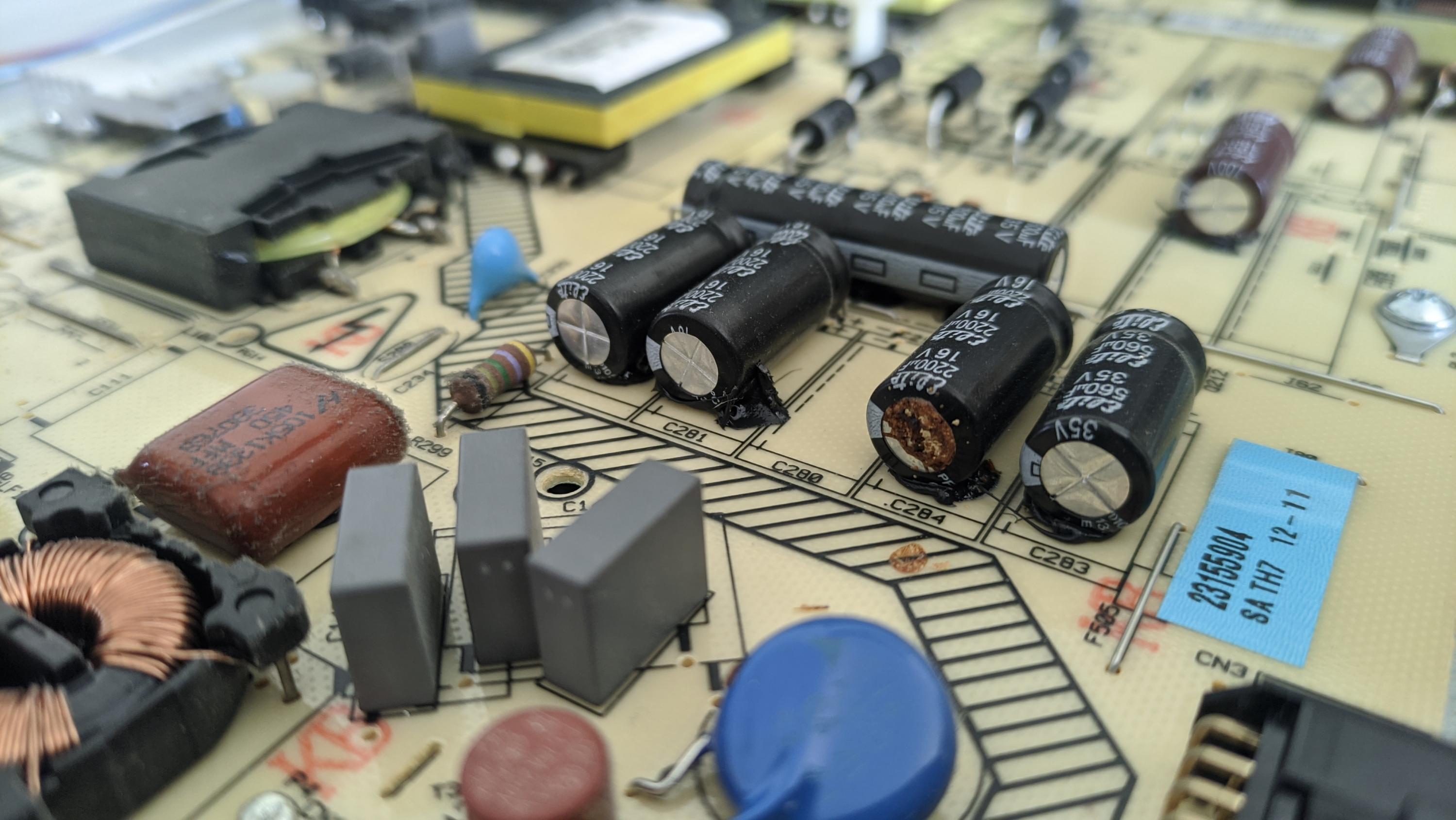

                Great news - fixed! Issue isolated to left side of screen by disconnecting t-con ribbons. Used tape cut-off as suggested by nomoresonys to block clocks and all is good ;o)
                Also noticed a bad cap on the PSU so will replace as preventative measure.
                Thanks guys.

                  Glad to hear it, you don't suppose that bad cap was causing the whole problem?
                    Could be I guess, Caps should be here Saturday so I'll try and report back. Either way I'm a happy fella!

                      Replacing CAPs had no effect on flicker.

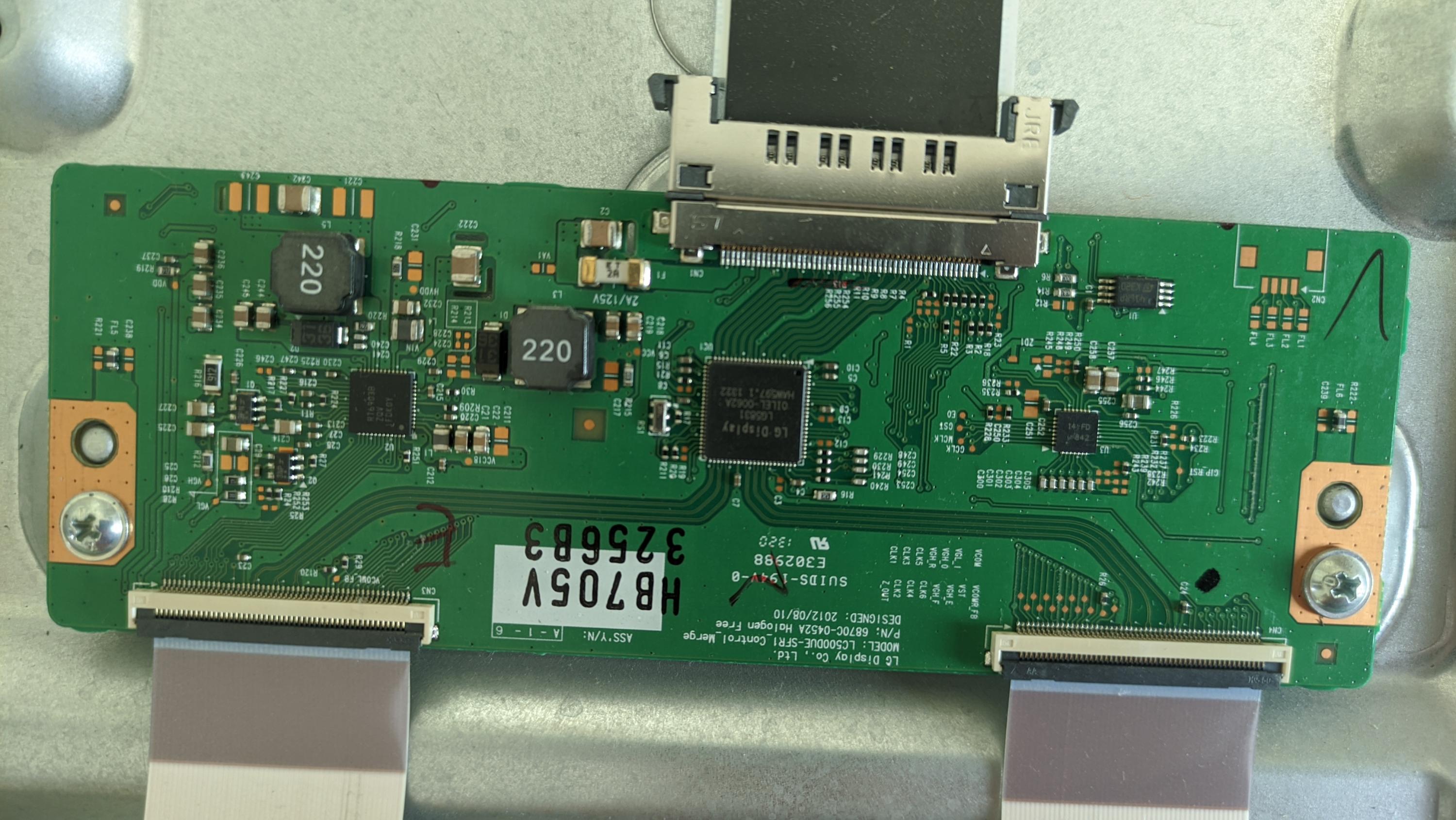

                      Thinking of replacing t-con board as I can get one for £10. Board is an LG part: LC500DUE-SFR1 per photo.
                      Are they model specific? Some listings show for 42" TV, 50" TV, etc with usual caveats that part will only work on that TV.

                        If blocking lines fixed the problem, then you have a panel problem not a t-con problem.
                            Can I do anything about the panel problem?

                              If you now have a good picture, you have fixed the problem.
