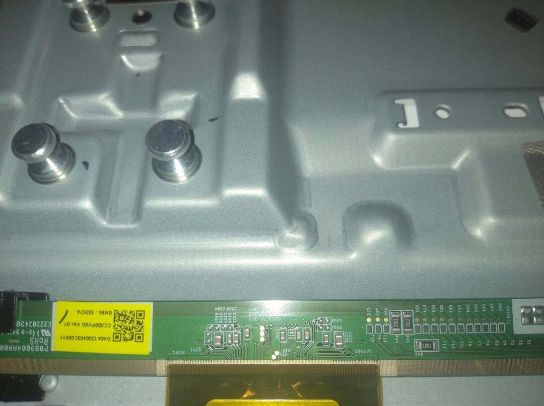

samsung un50tu8000 and un70yu7000 displays shorted

      Any update on this? I am having the same problem. Few people are selling LCD Tab BIOS chip. Is this a known failure on these boards? has anyone tried replacing the main board?
      Thank you
      This guy shows us one way to do it. https://youtu.be/atNmhu7HMj0
        Just recently fixed a 50au8000 with the tape method but with the the next tv exactly the same model the tape method would not work so just as I was giving up I cut the vgh,ck1,ck8 and the tv came back to life
        although the screen is noticeable that it's still faulty it works at least
