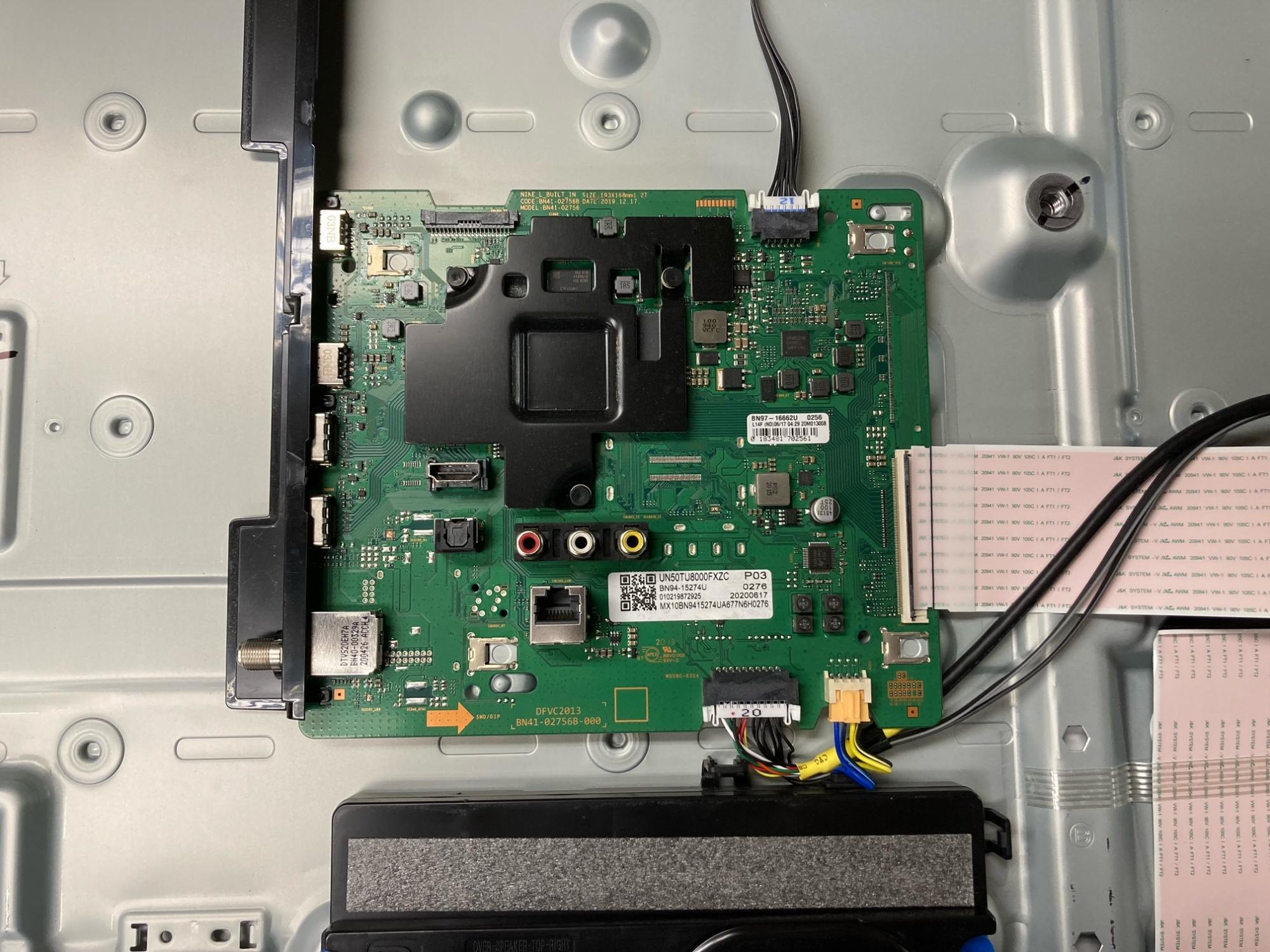

    I have two of these units un50tu8000 and un70tu7000 that have displays shorted.The unit cycle on and off with lamps coming on and going off.When i remove the lvds cable to screen i get the intro sound on both and sets remain on with lamps on.Both have identical boards and little over a year old.Anyone have this issue?

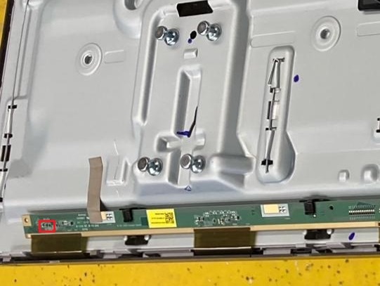

              ESD diode same to any other NU serie... it will located at the end of the right side bufferboards ( when you look from the back side )... you can check if you have U ribbon on the right bufferboards ... disconected and see if you have 3/4 SCREEN DISPLAY
              you can also masking the pins on MB side if you can located them which goes to the end of the mentioned bufferboards.

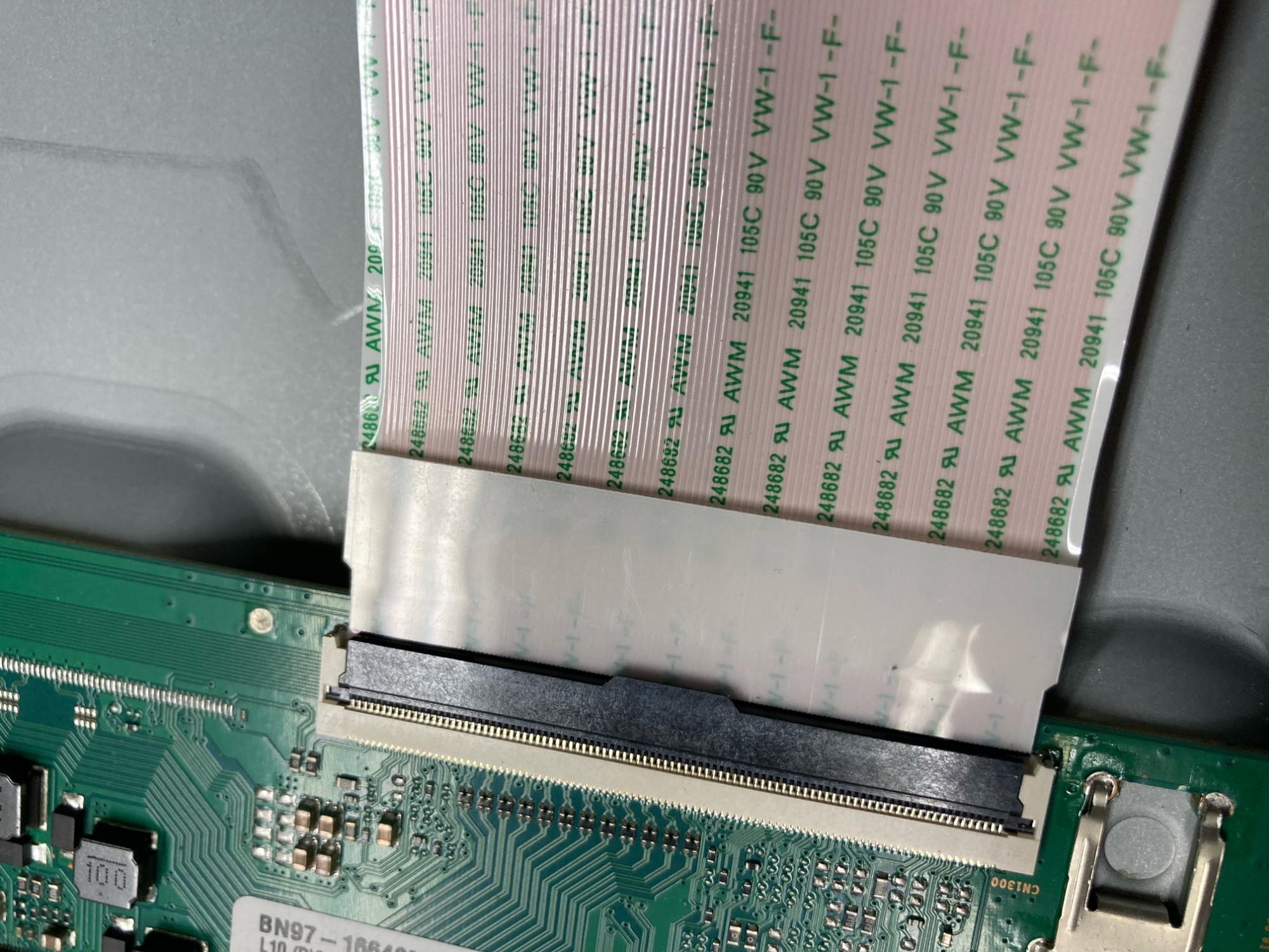

                    Diah yes i disconnected the U ribbion on both sets and no 3/4 picture,looks like shorted caps on left side.I did find a couple of caps shorted.There is tape method but why not remove the caps?Also my models have one large ribbon cable vs others show two ribbons from main board.

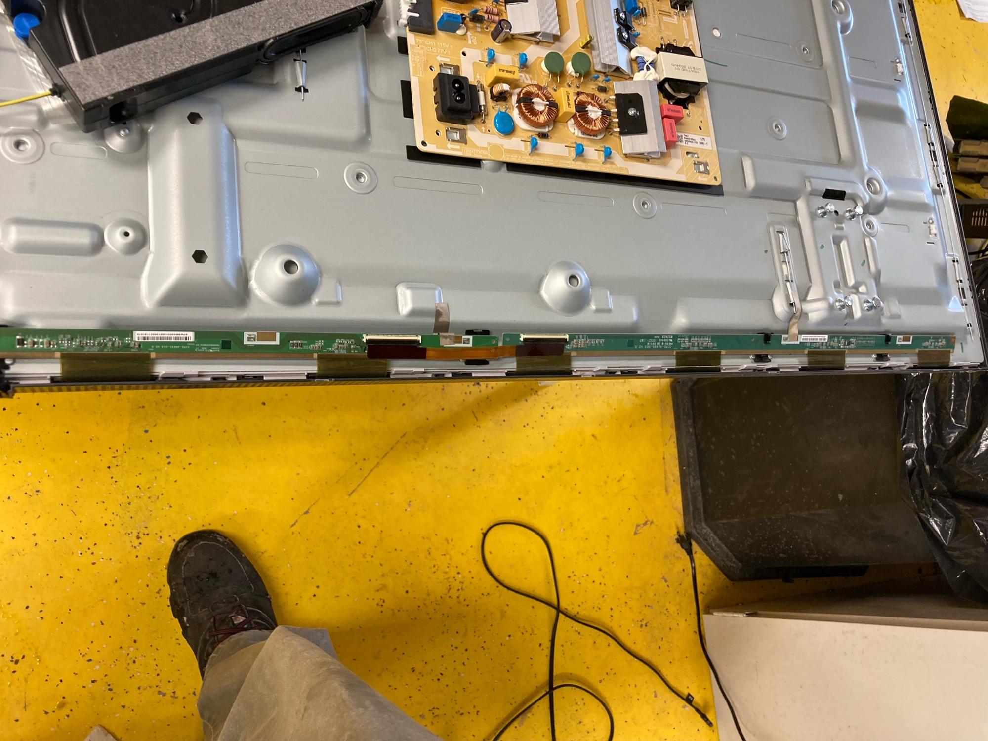

                        can you show us the Panel bufferboards of both side ?

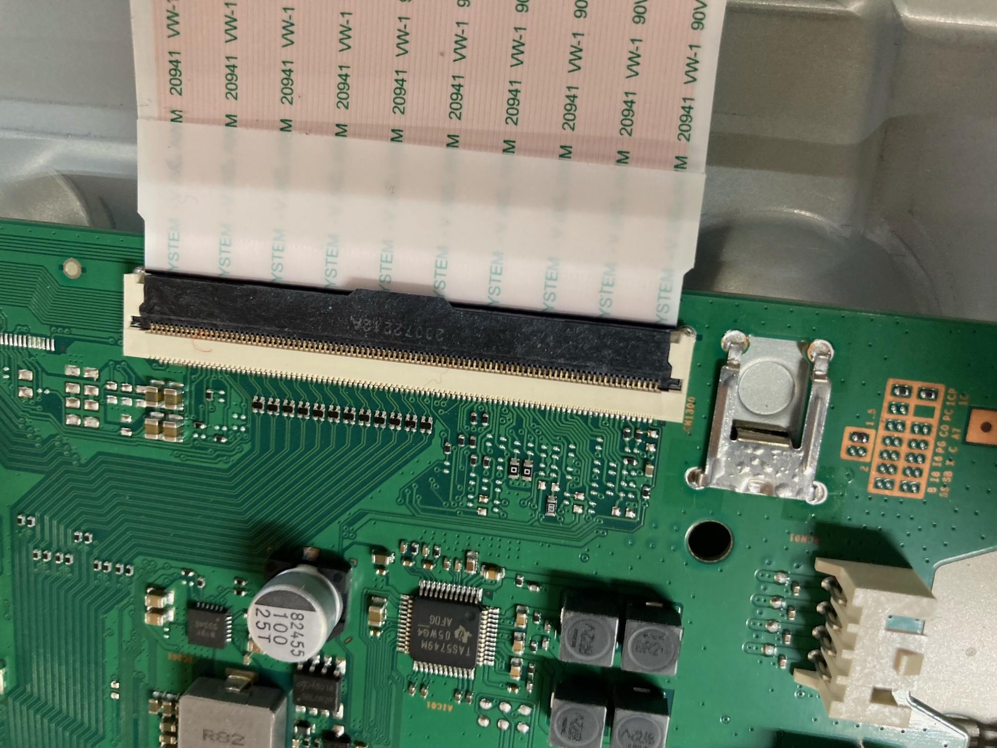

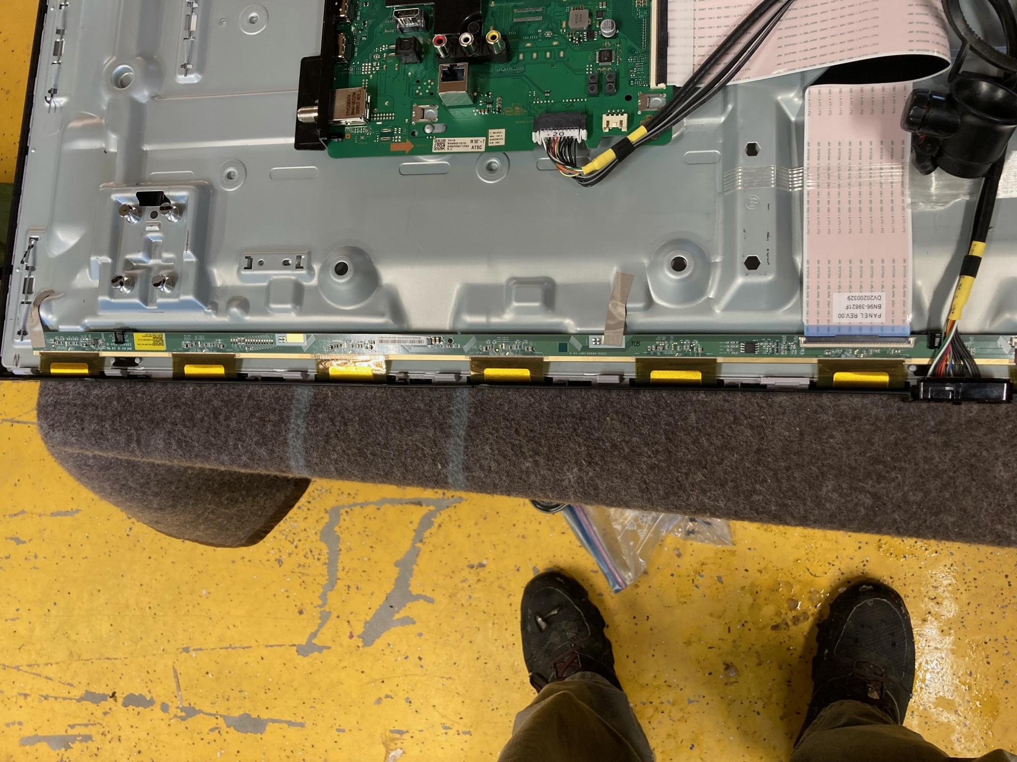

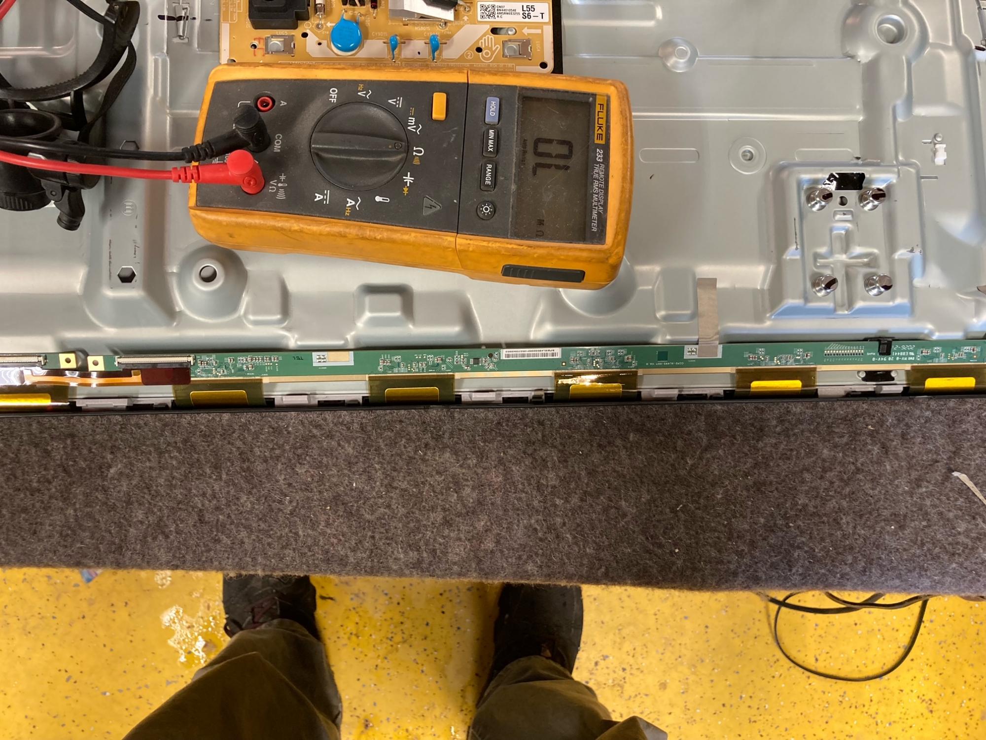

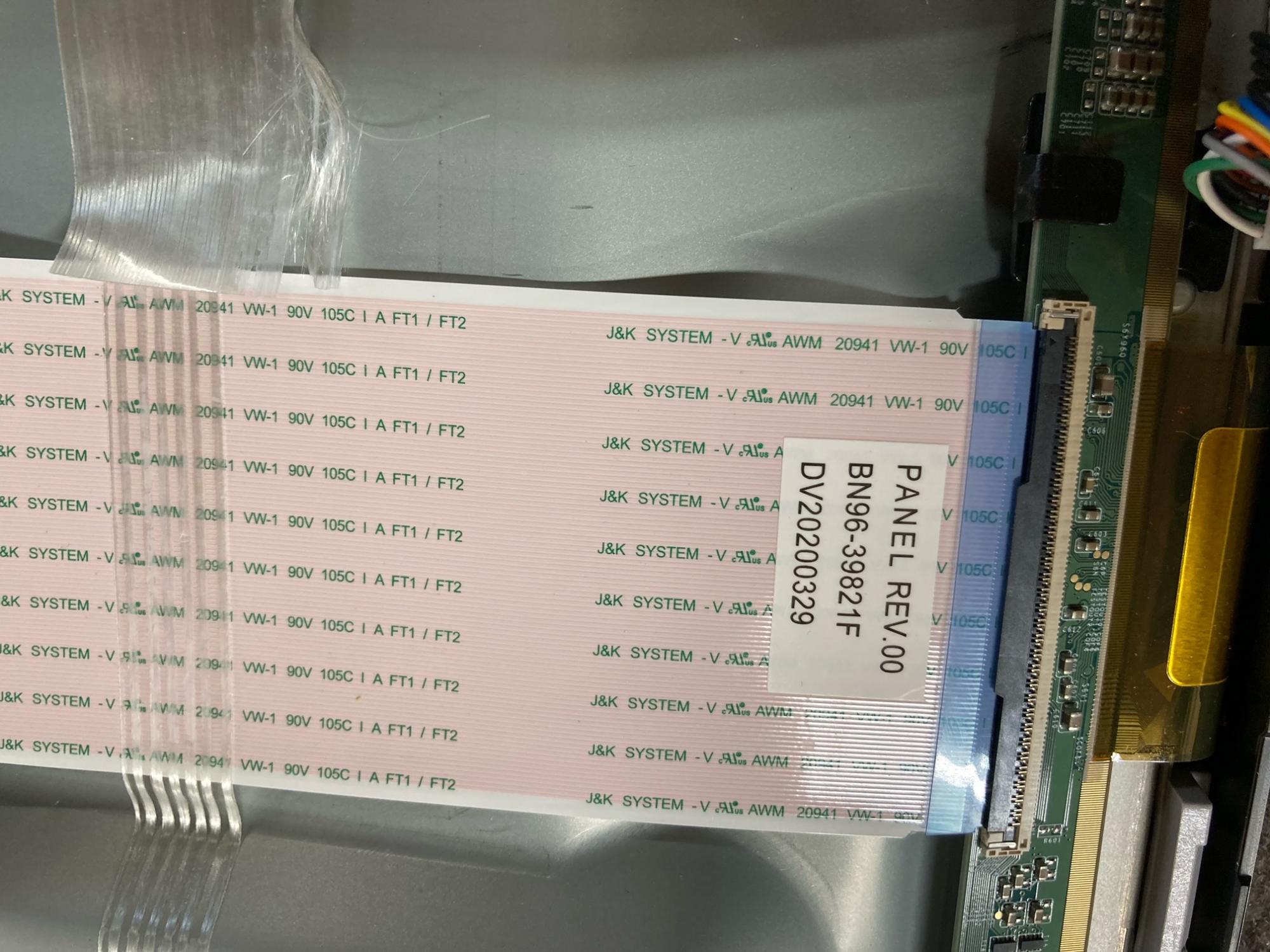

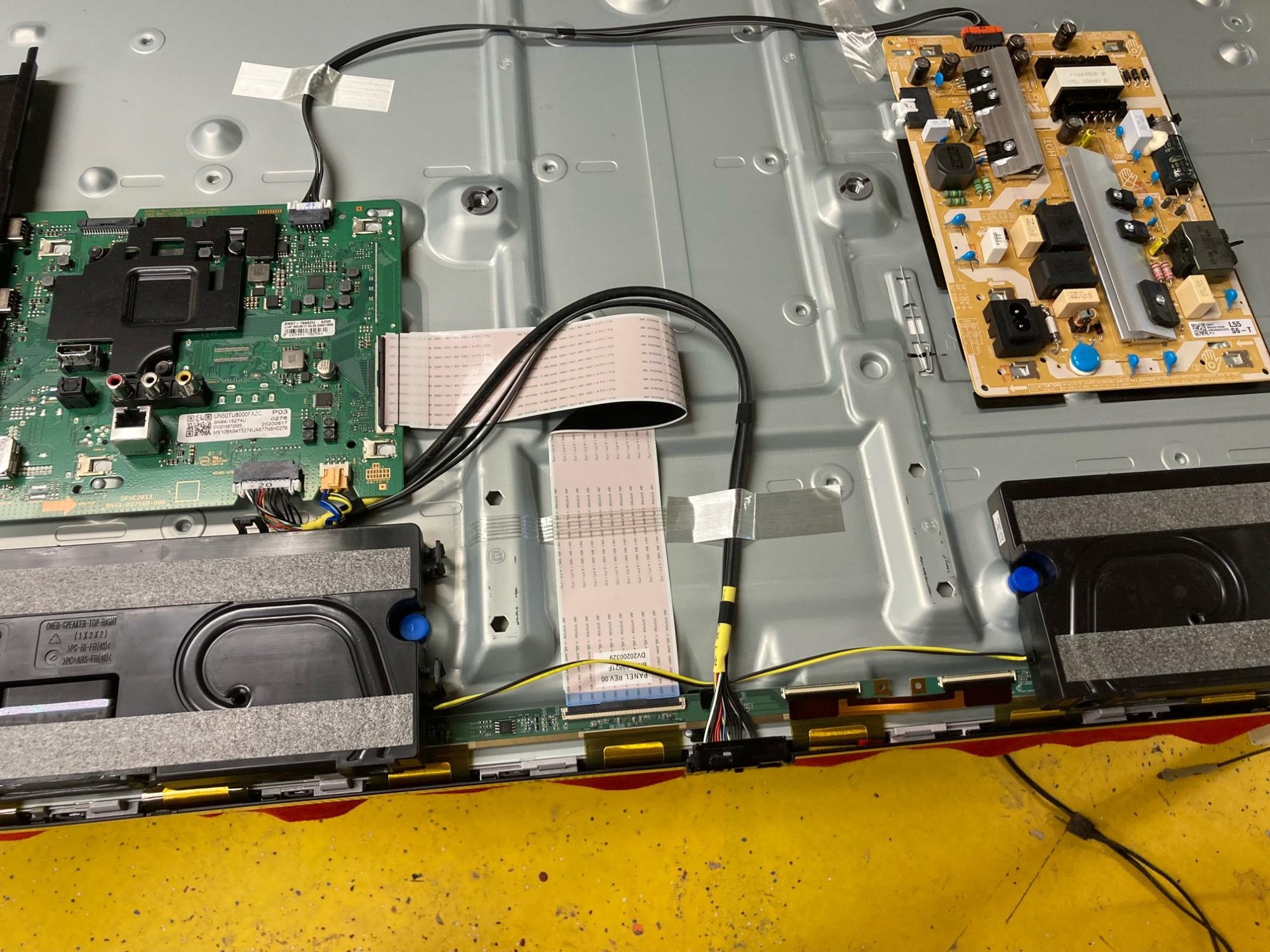

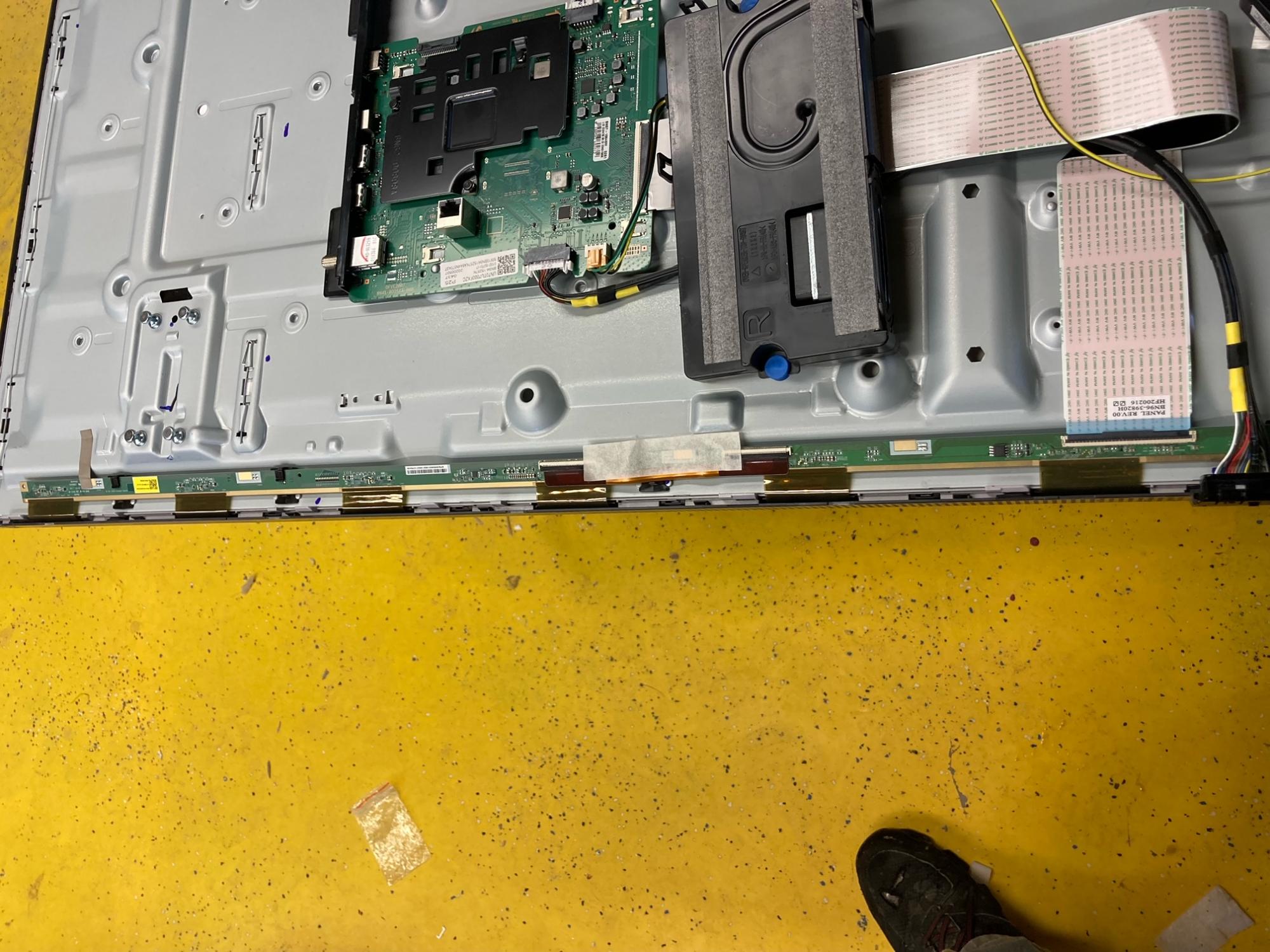

                            Re: samsung un50tu8000 and un70yu7000 displays shorted
                            Here are pics of bufferboards Diah.I remove a cap that was reading 59 ohms but 59 ohms still remains.
                            • Diah
                              • Feb 2013
                              • 6496
                              can you tell if these i marked are ESD diode !!!
                              its strange as you said when remove the U ribbon on each side at time no 3/4 picture...

                                so does the removed cap read or still read short off the board and are any of the others still reading short on the board? are the pads it came off of reading short?

                                  cap is reading ok pads reading short.I will post pic with microscope tomorrow.Thanks guys for all great help this is awesome forum for sure.
