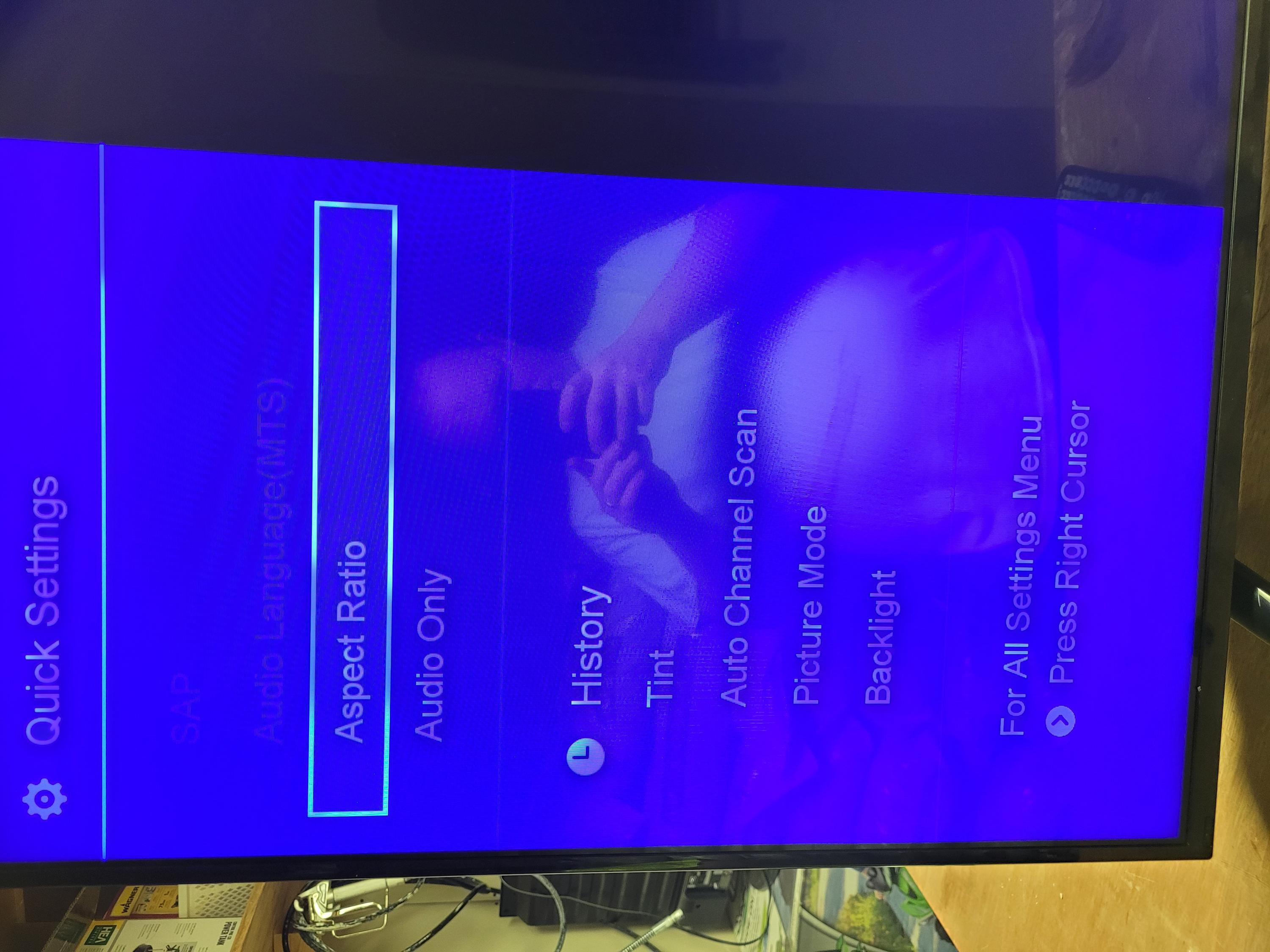

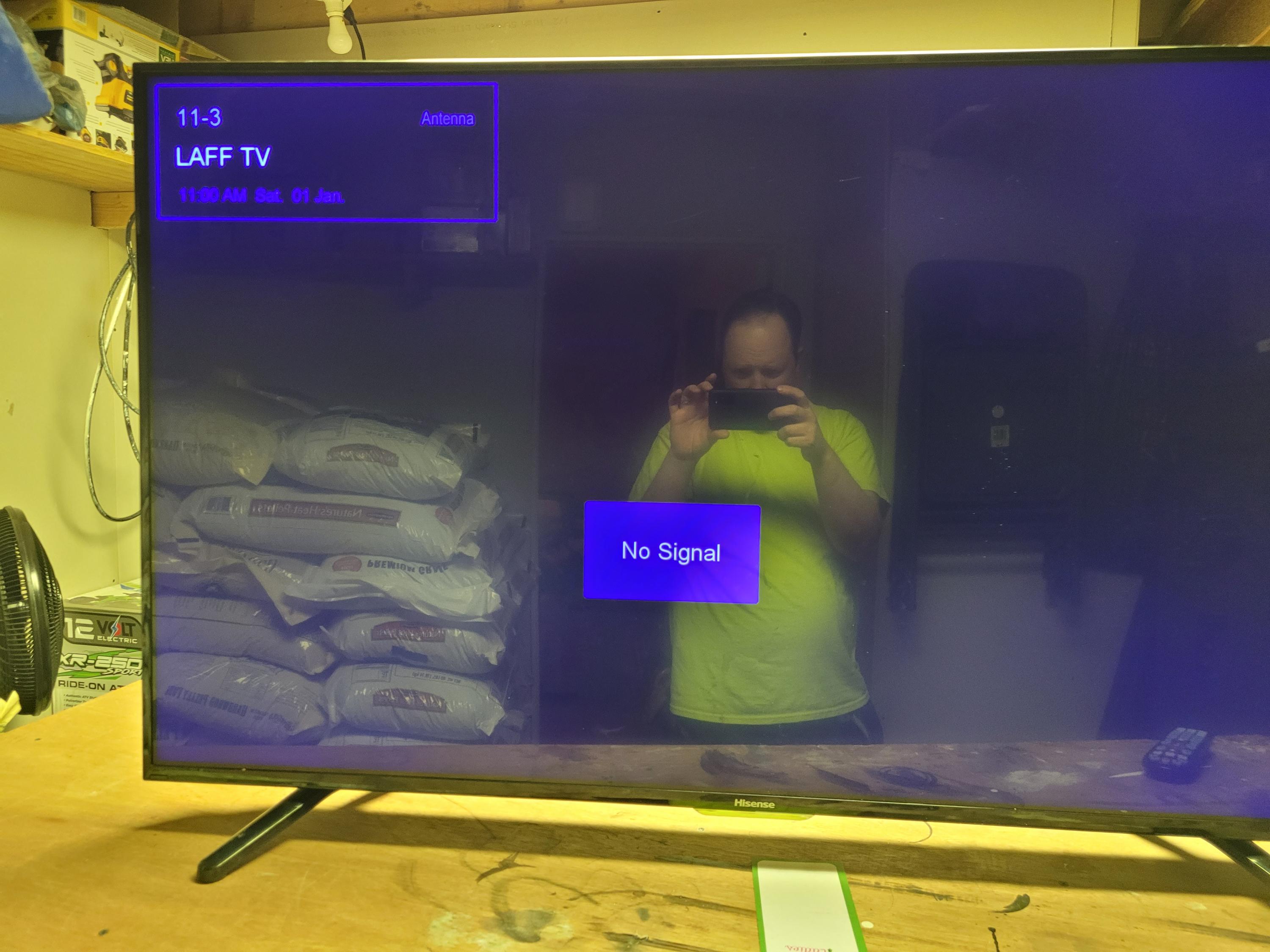

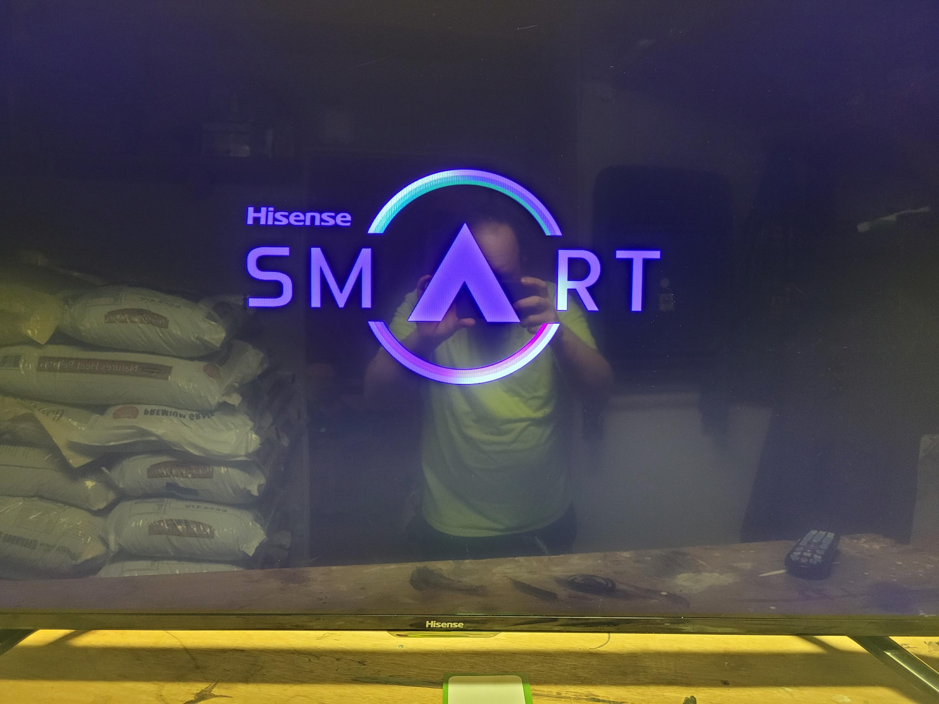

              Re: Hisense 55H6B Blue tint
              Here are some photos
                Looking through the back the leds definitely look blue and not white so I am guessing that is the issue.
                  Picture looks ok in spots, so would say your leds are the problem.
