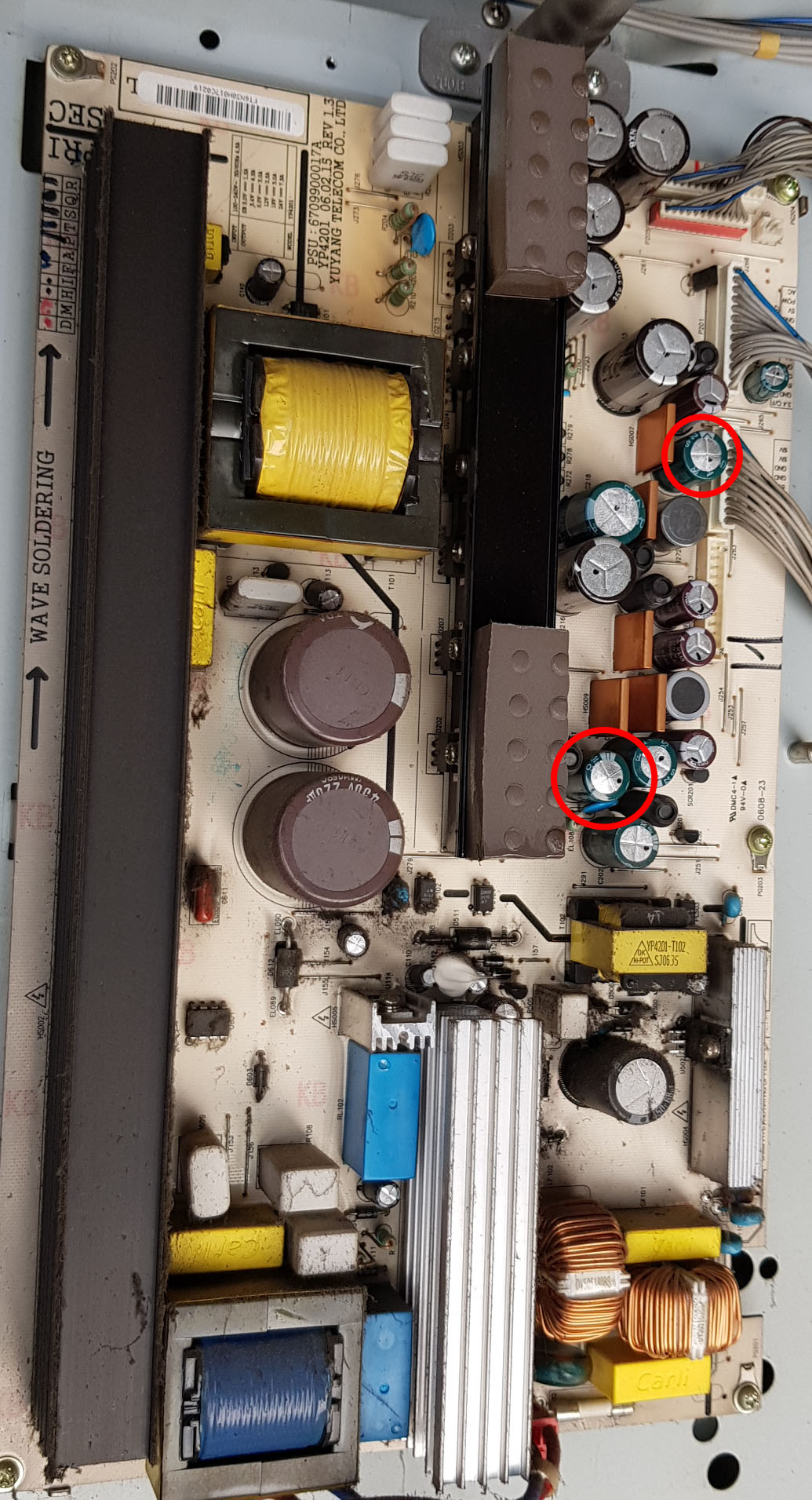

    When I first opened it I noticed some pregnant 2200uF capacitors on the Power supply board and I immediately replaced them:
    But everything remained the same, so I started debugging.

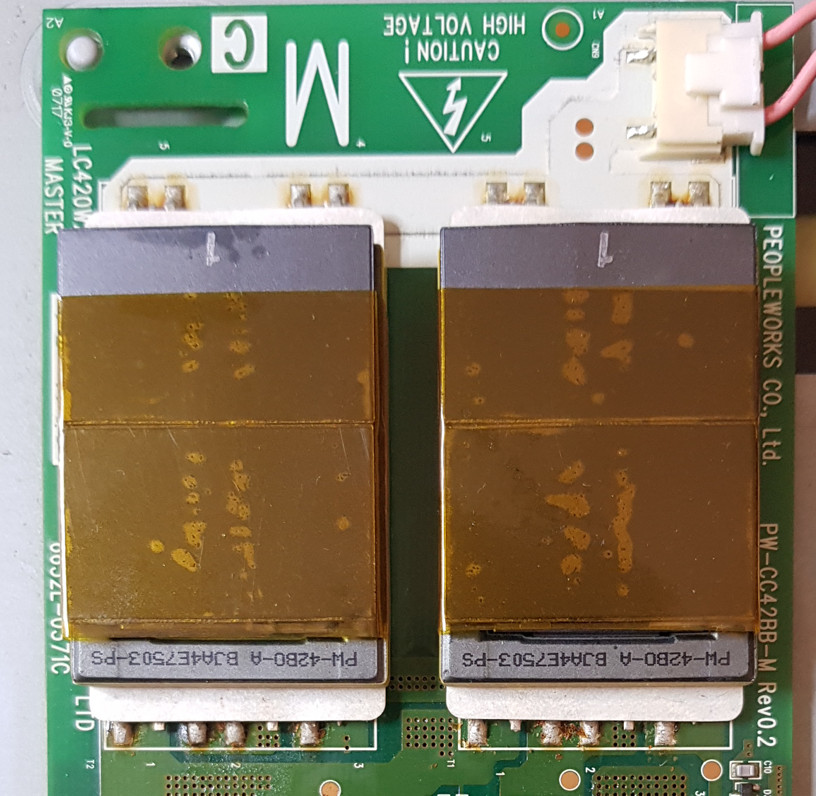

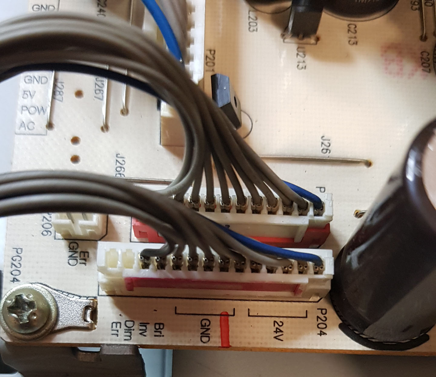

    On the Power supply board we have 2 connectors, one for each Inverter board (Master and slave), checking the voltage everything looks fine
    24 Volts on all 24V pins, 2.7V on 'Bri' and 4.76V on 'Inv' when TV turned ON.

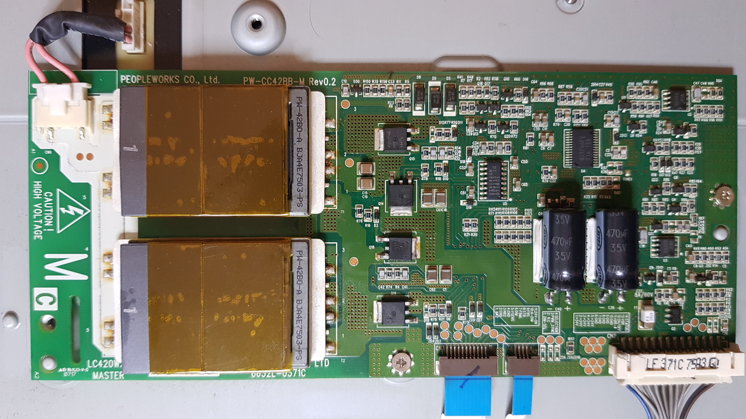

    Next step was to check the Inverter Boards.
    I found the thread for debugging this issue:
    https://www.badcaps.net/forum/showthread.php?t=10419
    I did the flashlight test and I can see the image on the screen.

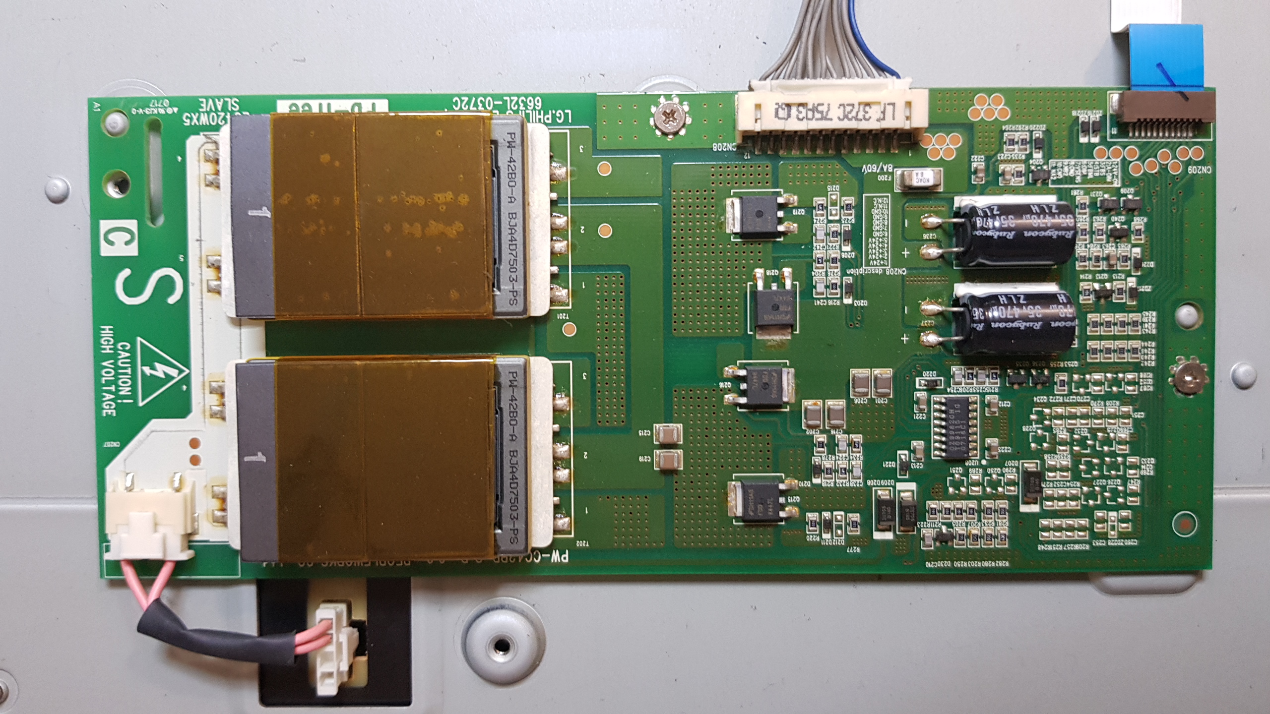

    Then I tried disconnecting the left CCFL (close to slave inverter) and TV does the same 2 second to black but only the right side of the screen is lit.
    Now when I connected back the left CCFL, the left side doesn't turn on at all. I don't know what is going on with this TV. I already checked and all cables on the Slave inverter board are connected properly.

    maybe if you have not, check the transistors on those balancer boards, Q15, Q18 etc, and check the little ceramic caps for shorts or low ohms.

      The Mosfets on the inverter boards are FDD8447L and they all read arround 3.5MOhm from S to D and G to D. From S to G they read 10kOhm.
      I actually already replaced the ones on Master inverter board with new ones and keep getting same values Q15, Q14, Q18 and Q19.
      Regarding the capacitors, you mean C15 and C19? When I start measuring them they are in the order of 200kOhm and start increasing until Mega Ohms.
      In circut they measure 19uF (parallel).
      Regarding the C16,C18,C1 and C62 they also look fine in the 950uF.

          You mean the main power board or the inverter boards?
          The main power board has 2 connectors for the inverter boards with proper 24v when TV is ON. I don't think it's damaged.

                On the inverter boards I already replaced the mosfets Q14,Q15,Q18 and Q19, I checked a lot of SMD capacitors and the 2 electrolytic caps and all looks fine, I just didn't test the transformers.
                How can I test the transformers with a Multimeter? I can't find a schematic so I don't know witch pins connect where.
