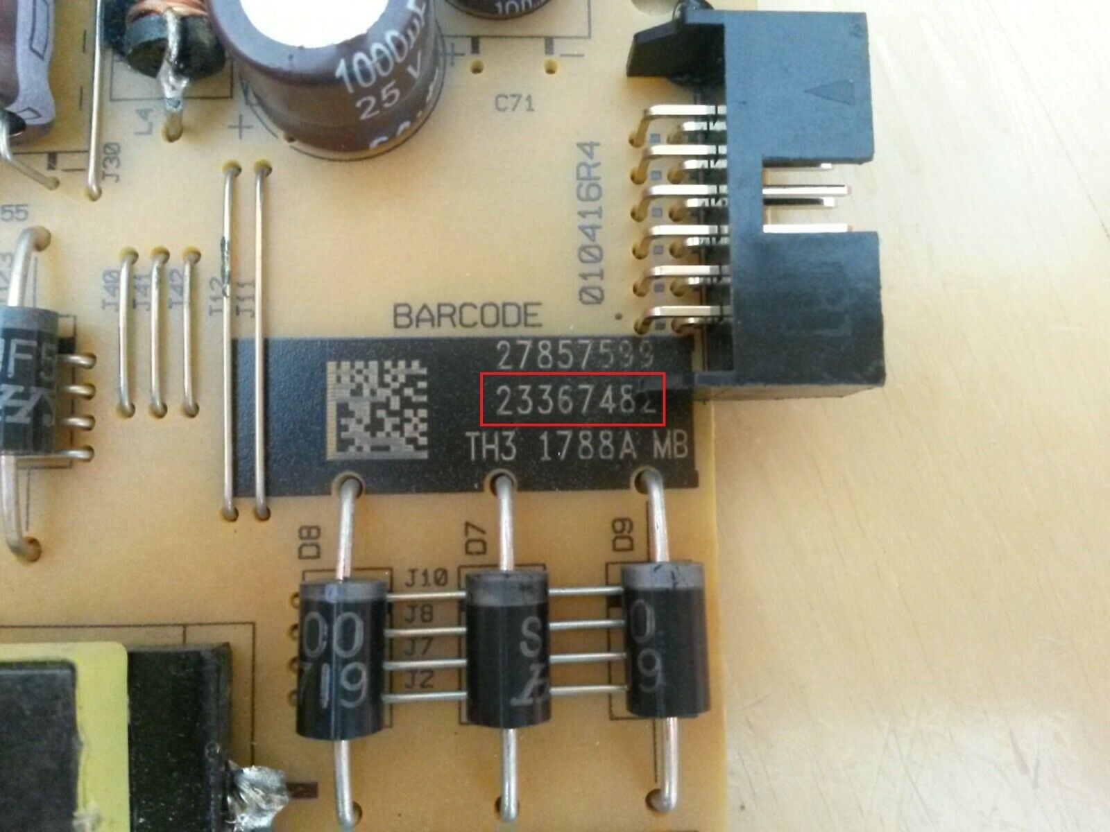

                        Re: Digihome PTDR32FHDS5 (Vestel) 32" LED Smart TV
                        Blimey I am surprised you haven't resourced a remote control for it. Use a Sky remote control if you have one and programme it up: https://www.sky.com/help/program-your-remote
                        The questions I would ask first off is what is the code on your psu it will be the code highlighted here in picture. This is the code that you would need to find a replacement for the psu. Check to see what model on ebay it is suitable for the size of the screen that you ordered a replacement for it. If it's for a different size screen or different number of leds inside the screen then that will be why your brightness is low.
                        Generic Vestel remotes will also access some of the functions. I have around 10 different vestel remotes that I use if I don't have the exact one for the TV. At least then you can ensure brightness isn't turned down as well as backlight as well.

                          I asked and he wrote that the power supply is ORIGINAL. So I can rule out the possibility that this is for another panel, of another size.
