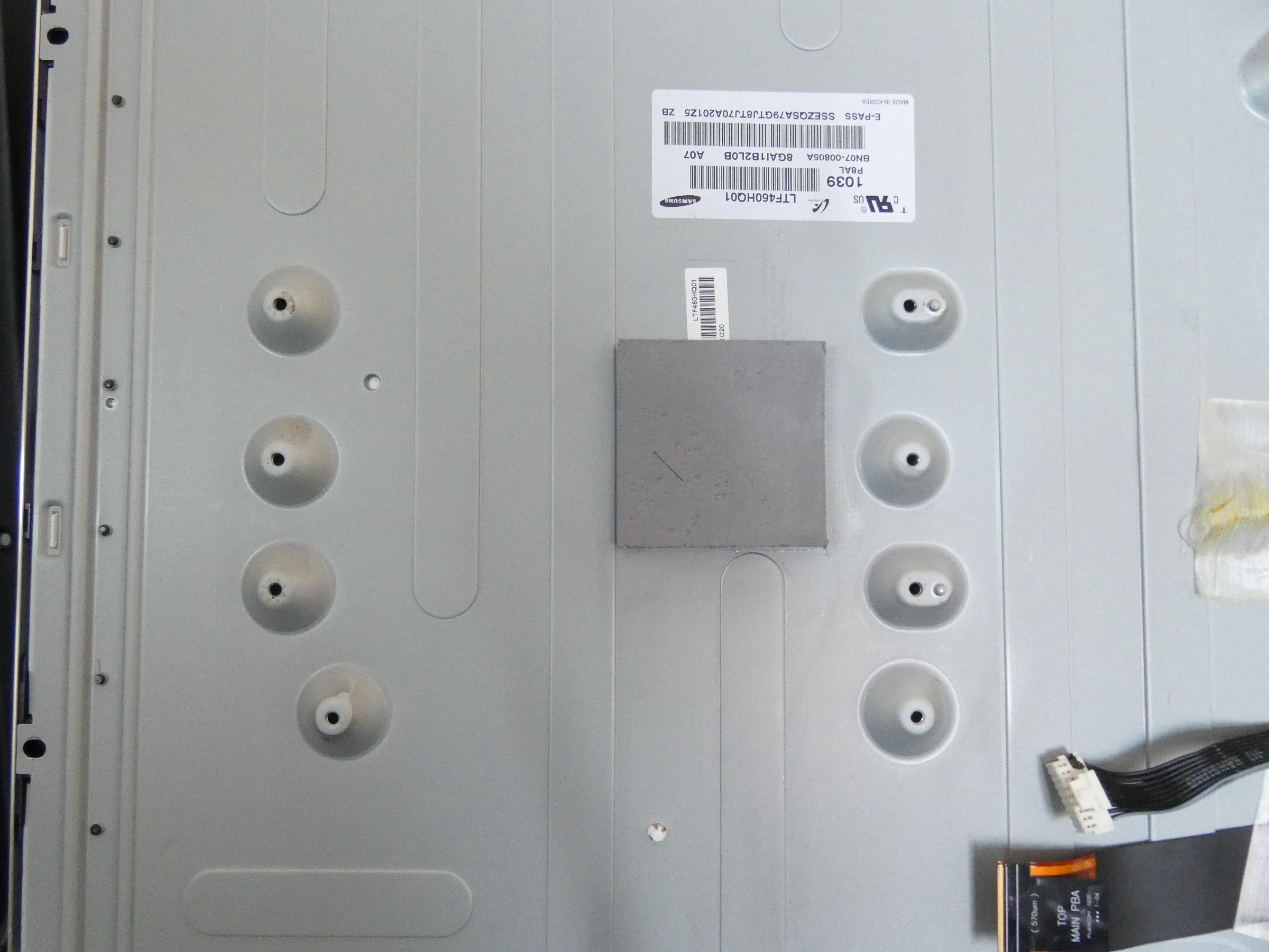

    The problem was a bad main board. Got a second hand one and all works fine now.
    I do have another problem that I didn't see before.

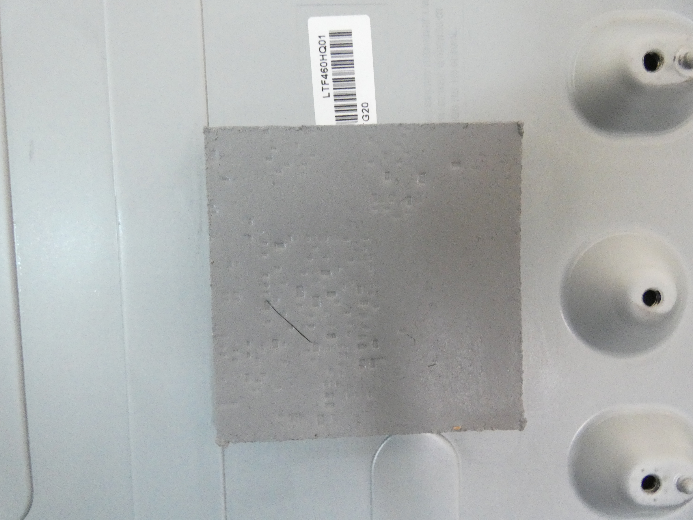

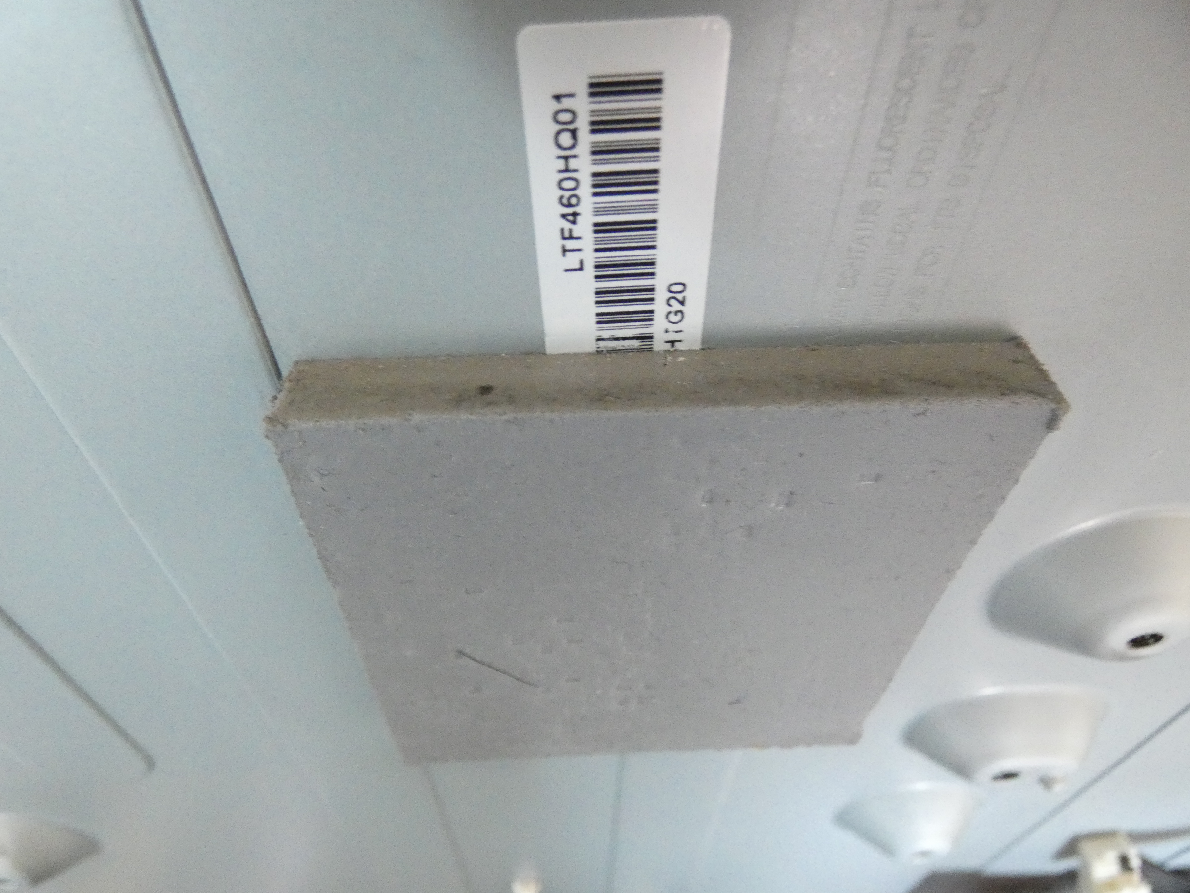

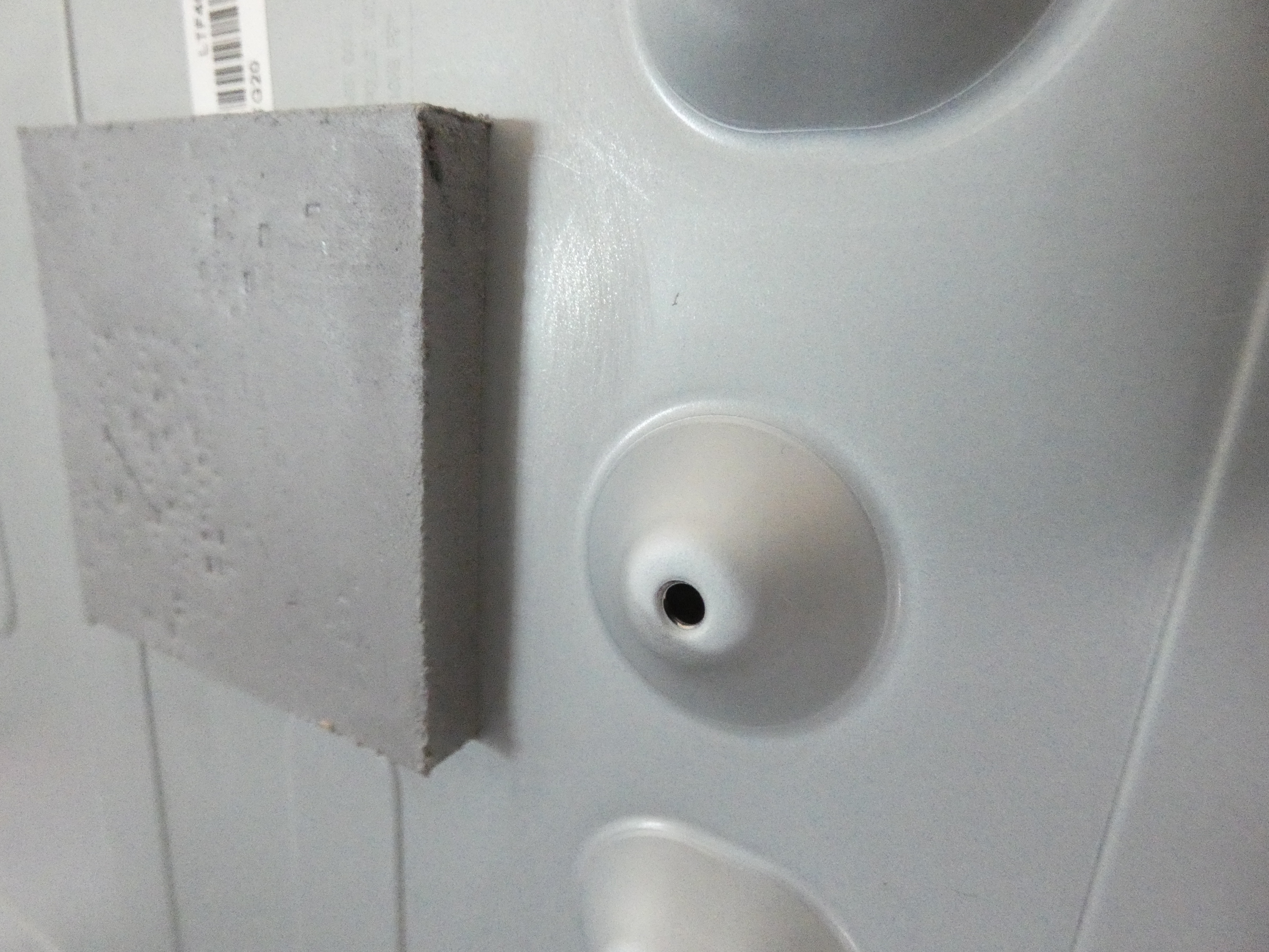

    The main chip has a large thermal pad between the back of the board/chip and the main metal frame of the TV chassis. The pad has some kind of sticky oil leaking from it and running down the chassis.
    Does this pad need replacing?
    I have never seen this before.
    Some pics of the thermal pad after being cleaned up.
    Size seems to be 60 x 60 x 7-8mm. Where can I order one of these?

      Re: Samsung LE46C750 TV, dead but backlight on.
      leave it as its,, dont worry on it since yours tv working fine.
