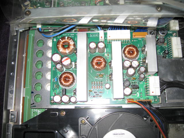

    Hey, I have recently aquired a Fujitsu pds4222w-s plasmavision plasma TV that doesnt work. It turns on, and the screen flashes white, and then it shuts off.
    I was wondering if anyone has ever worked on these or has any idea how to trouble shoot it. Thanks.

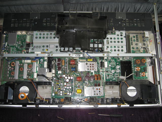

        I've checked for a service manual and haven't found any available from any place I trust. It sounds like the small signal board has detected a fault. Does the red led blink in any sort of a pattern?
        Post some pictures. Also, look for labels on the plasma panel that give a clue who made it.
        Most of the plasma power supplies I have seen have the power supply outputs labeled. If this one does, check to see if all the supplies are coming up.

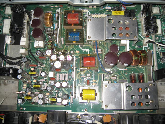

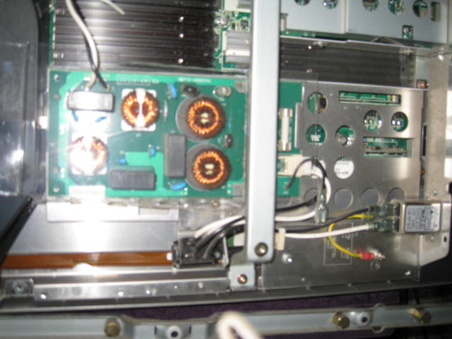

                    Re: fujitsu pds4222w-s Plasmavision TV
                    is it just me or do the big-ass filter caps (2nd pic, pretty much in the middle, 4th pic the ones on the right) look like they are swollen below the top plastic cap..?
                    as for the power supply connectors..
                    4th pic.. the connectors in the top right.
                    looks like they're labeled (just like plainbill said)
                      I think that might be an artifact of the picture, there is no real obvious swell in person.
                      Ok, they are labeled. Most of them are ground (GND, I am assuming). as well as VS, VA and VE.

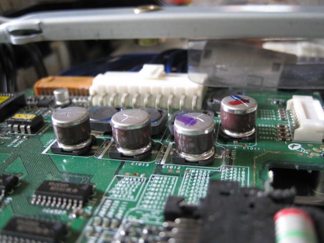

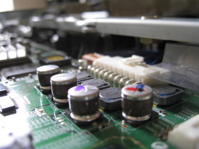

                      • acidophilus
                        • Apr 2010
                        • 50
                        I found these on the IC board. the one with the purple on the top seems to be a little swollen.
                              Ok, I uploaded the pictures again.
                              • acidophilus
                                • Apr 2010
                                • 50
                                The boards are made by Fujitsu Hitachi.
                                    Ok, The outputs are labeled as such:
                                    VCC1
                                    GND VCC1
                                    VE
                                    GND VE
                                    GND VS
                                    GND VS
                                    VA
                                    GND VA
                                    VS
                                    VS
                                    Using a multimeter I was planning on testing each one of these for voltage. How much voltage should I be expecting coming through these? (I was going to test 250V AC)
                                        Milkman, the boards generally produce DC voltages. There is one output that will likely be an AC output, the one that drives the plasma display itself.
                                        I would set my meter to DC, highest setting, turn on the unit, and measure from specified ground, i.e. GND VE, to the pin labeled VE, and so on. Most sets will produce voltages in the ranges of 5,12, and some in the less than 50VDC range. Most sets will have a 'standby' voltage produced to operate the remote control receiver circuit, and used to 'turn on' the rest of the set.
                                        That means that there should likely be a 5v standby voltage, and then 'run' voltages in the 5, 12, and so on. When you press the on button, or use the remote, there would be a change in one of the voltages 'in' to the power supply, from 0 -> 5 or 5->0 signaling the set to turn on.
                                        Using an analog VM works, as long as the ohms internally are high. I don't remember the numbers, but you can 'drag down' a circuit if the meter draws too much current while it is measuring. I have in mind "10,000 ohms/volt" or words to that effect.
                                        The ESR meters mentioned allow for measurement of the equivalent resistance that a capacitor emulates(?) while in use. When caps get old/dried out, the resistance goes up and messes with the circuit, leading to failure. You have to remove the caps from the board/circuit to test the ESR, or at least lift one leg of the cap[hard to do].
