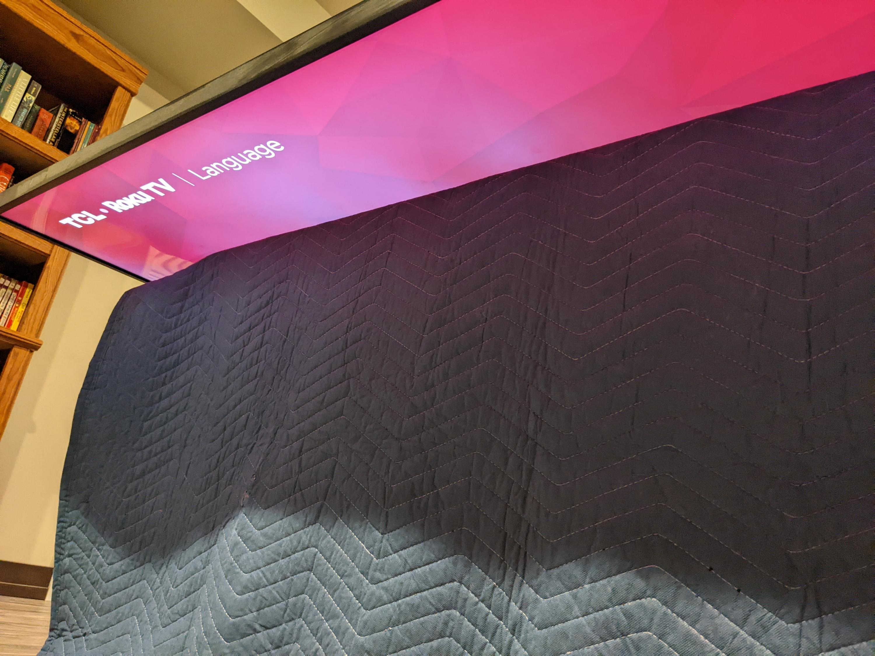

                  I replaced the cap as well as resoldering the heatsink and mosfets. I was too impatient to wait for the LCR meter to arrive. TV seems to power up normally!!! Great news. Thanks to all for the help and advice.

                    Thanks for feedback.
