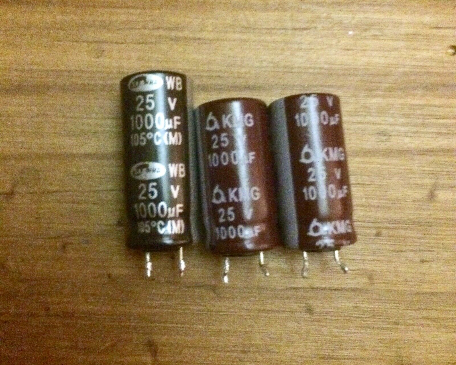

    samsung LE32A558p3f bn44-00208a
    Hi
    Could someone tell me the differance between the 2 types of caps in the attachment - i have repaired the power supply board by replacing 6 caps and tv is now working but it has a low level buzz/whistle which can't be heard when tv is being used normally but can be heard slightly when theres nothing going on on screen.
    In the kit i recieved it had all 3 of the 25v 1000uf the same as the smaller caps in the picture and the taller one was not included - when i asked i was told it would be ok to use the ones supplied.
    I've checked online and all these boards appear to definately have one cap a differant physical size so i assume there must be a reason for it but being a newbie to electronics i don't know why or what for.
    Could anyone shed some light on this for me please.

    Re: bn44-00208a
    What brand of capacitors did you use if can post a picture of the replacement capacitors that you used
    • R_J
      • Jun 2012
      • 9588
      Re: bn44-00208a
      The taller cap may be slightly better quality cap that was installed at the factory, That cap is for the +5v standby supply and that supply is always on that could be why they did it, installing a good quality cap in that location will be fine.

        Re: bn44-00208a
        Physical size could be that it may be better at reducing the ripple current on that supply.

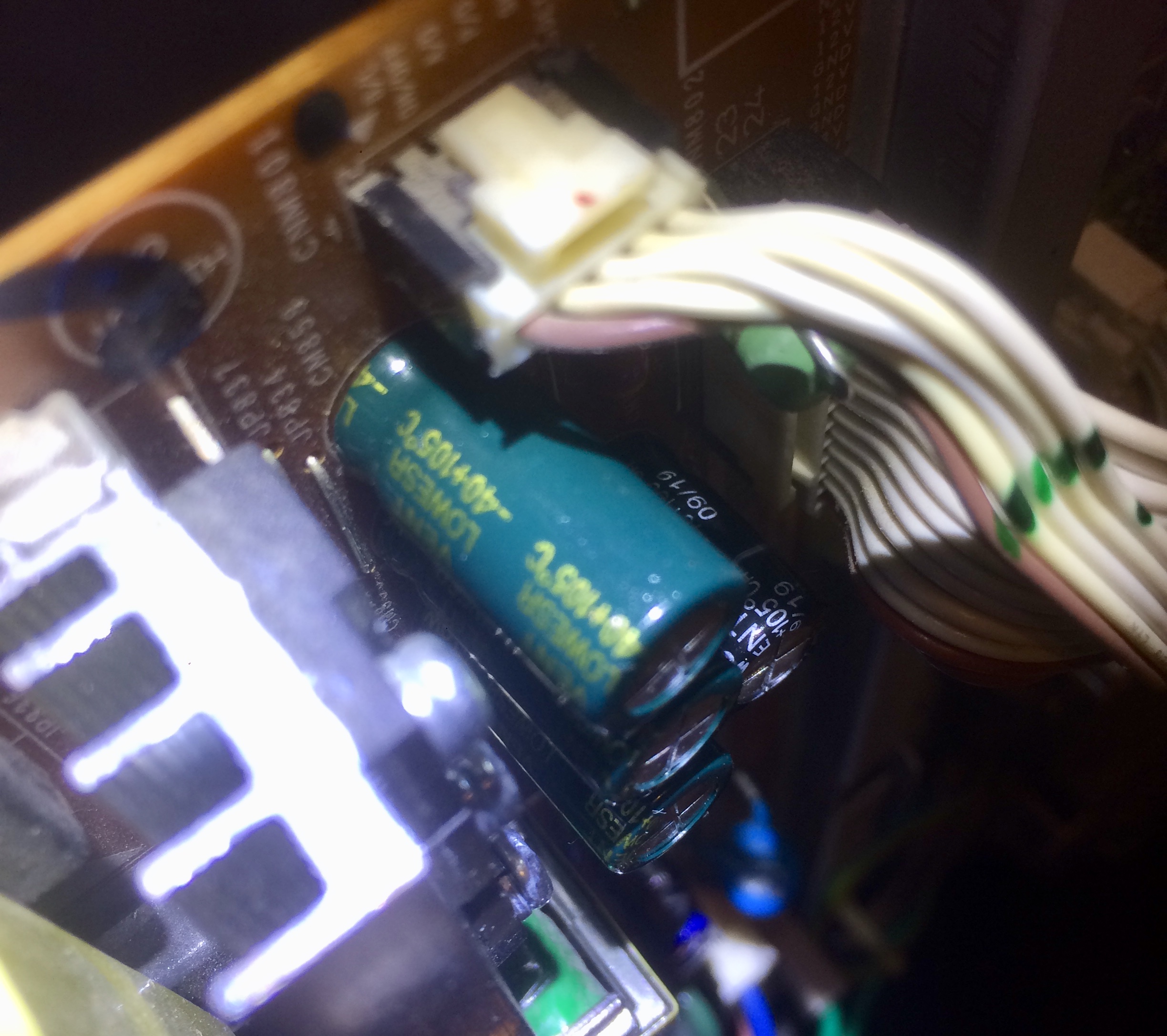

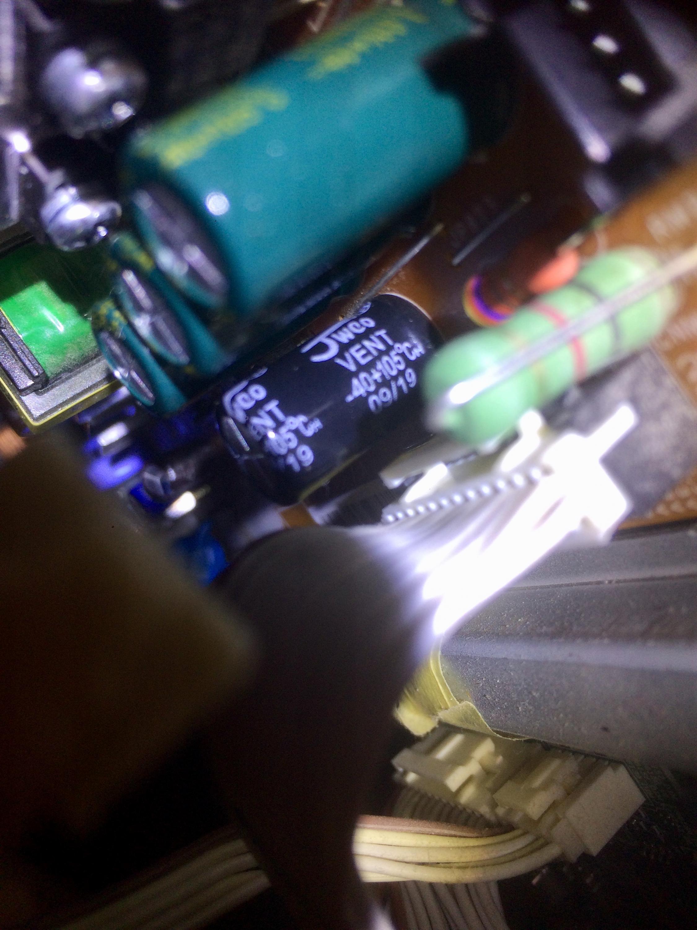

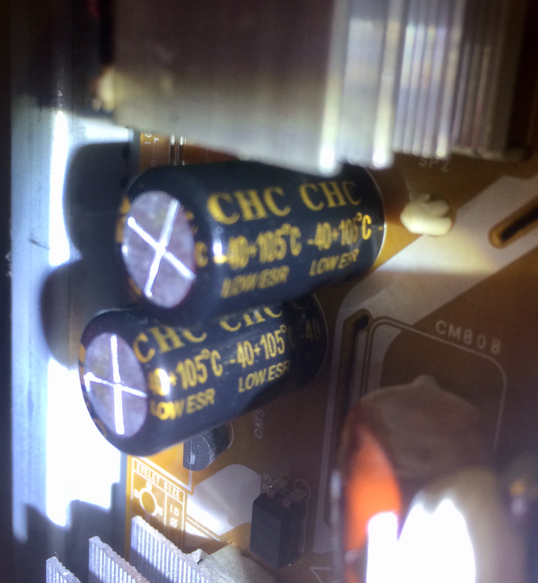

          Re: bn44-00208a
          Thanks very much for your comments
          I have attached pictures of the caps fitted and after taking a closer look i feel the noise is not coming from the power supply.
          The noise doesn't alter with the sound being turned up or down (its right down in the attached video)its not noisey in standby but only when tv is 'on' and does
          seem to get lower the longer the tv is on for but doesn't disappear totally.
          I don't know the history of the tv as only recieved it last week after it was being thrown out because it just went off and the owners bought a new one.
          It is a samsung LE32A558p3f.
          I'm not sure if i should have started a new thread for this problem or ok to continue with this one.
          Thanks for any input

            Re: samsung LE32A558p3f bn44-00208a
            Your replacement caps are a unkown brand probably low quality, swap them with Panasonic or Nichicon ones and you probably have solved, after replacement post also picture of soldering job, if you're a novice on that side.. also that Jwco are suspective, myabe changed by someone else, but good to be changed now that your're on the track.. place an order by reputable seller, preferably not Amazon/ebay..
              +1 Change the capacitors to Panasonic FR range of the same value. I guess you bought a kit off ebay as there are quite a few sellers selling no name capacitors of poor quality. Anyone buying these are liable to changing them in a couple of years if your lucky that they last that long!
              If you buy a kit always ask what capacitors are they supplying and the range as well. If they don't answer or fob you off with an answer 'like all suitable for the TV' then definitely look elsewhere
                    In reference to your original question, the taller cap has a temperature rating on it, whereas the others don't, implying that they have a lower rating.
                    You might pick up a cheap LCR-T4 component tester from Ebay and use it to test some of the caps you got and verify that they're within spec.
