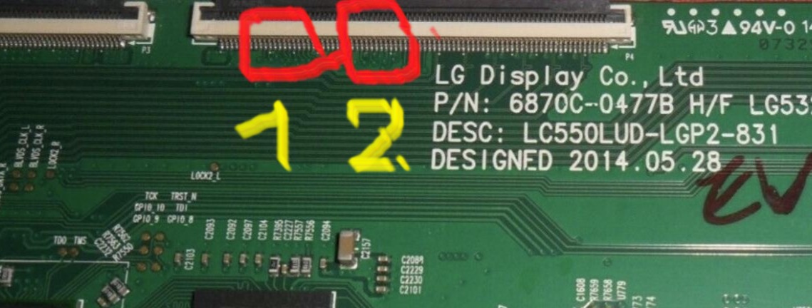

    blocking randomly? which is the tcon model?

      This type Davi borrowed from eBay as the tv is all done up for now thanks for your help

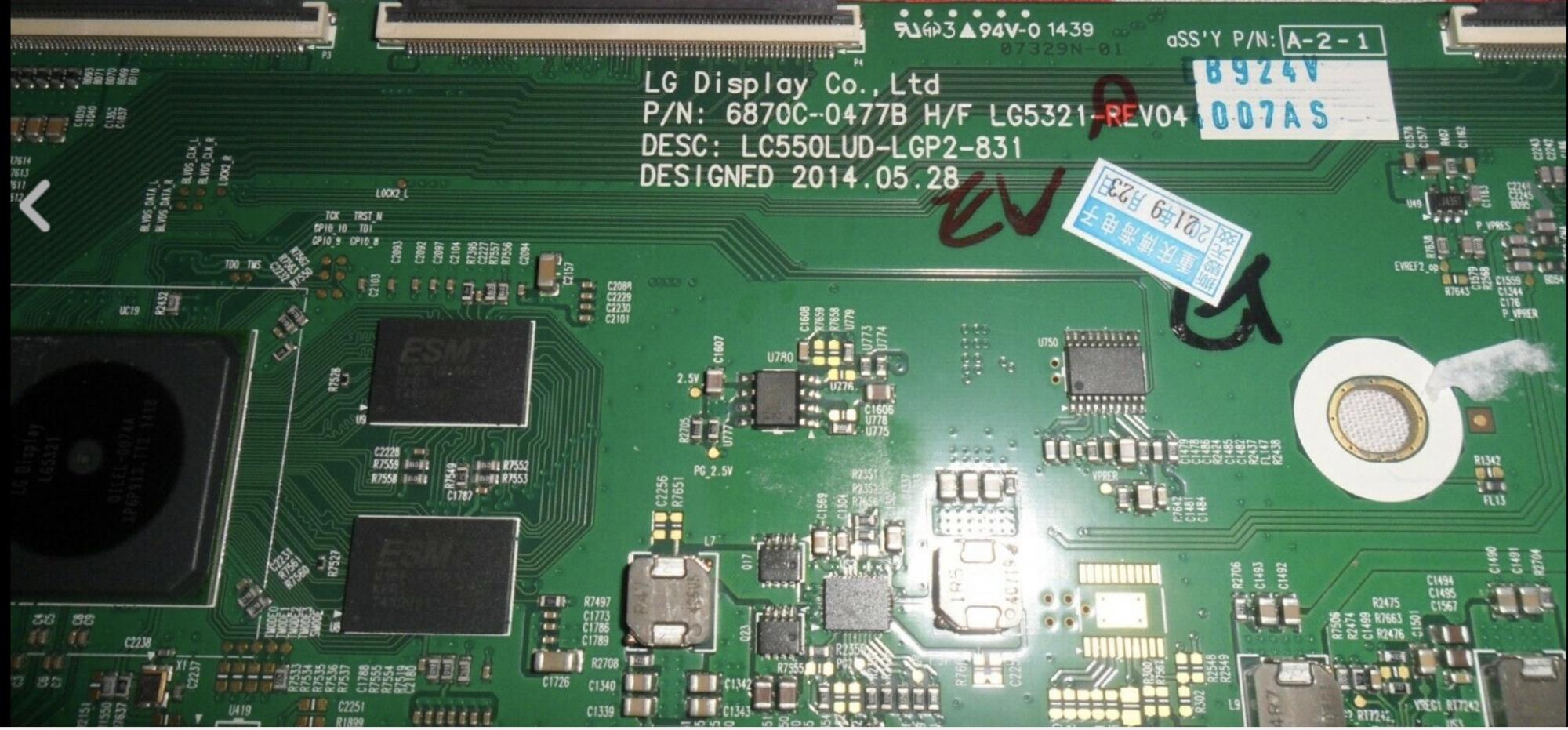

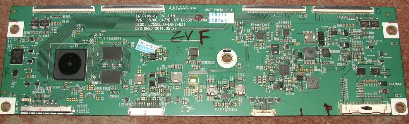

        Hope this helps

          i have to gather one better picture and an android sw for editing it

              i was ensuring you were blocking the right traces..

                      The traces to block are the group on 1 or on 2 , it is impossible to know without to try.. but this on the faulty side..

                        By blocking traces with tape the controller "thinks" there is a mistake and the t-con will go in protection. An Oled t-con works much different that a LED t-con.

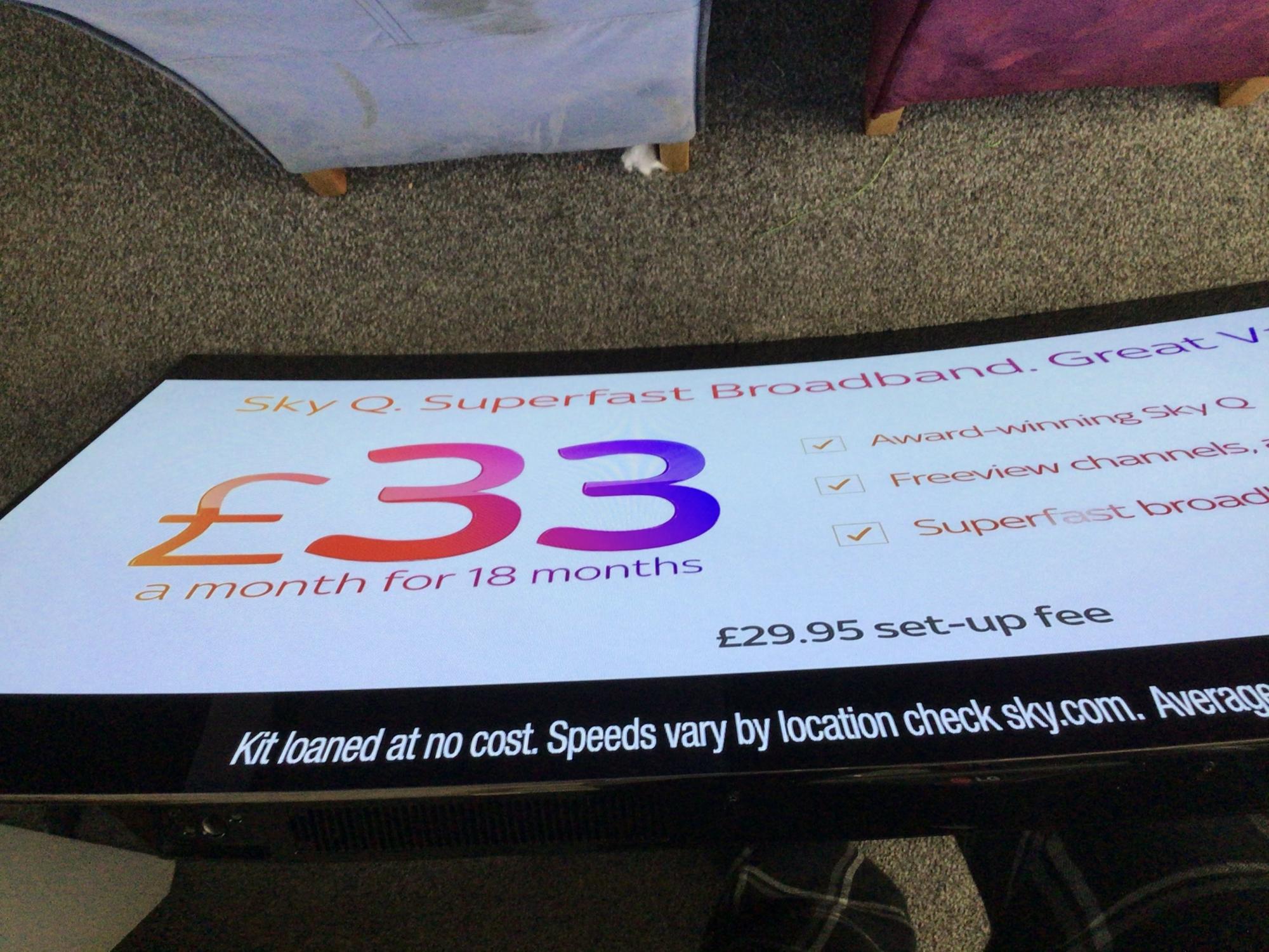

                              (Just a quick update) Well a bit of a change it’s starting to flicker now without any clk lines blocked the top 3 quarters darker shading disappeared for an hour then when I moved it it can back cleaned lvds cables with proper cleaner still flickers every no and then and sometimes I move the screen and it clears to a perfect picture
                              Thanks to Davi and William1967 for the advice and help so far

                                Here is the screen when the top half has cleared

                                  Maybe a defect of a connection within the panel like it happens on lcd tv, but need to know how are made these panels, if there are cof tabs on the side of them, in lcd world we can add a thin wire to rebuild the connection..

                                      Looks like failed gate driver on left side. You are only getting half the resolution in that section. Maybe disable VGH on that side to even out the resolution.

                                          Hi guys moved it on now it was very intermittent
                                          Just waiting for a tcon for the second one now same model but has banding on the screen which I gather is common
                                          Thanks again guys
