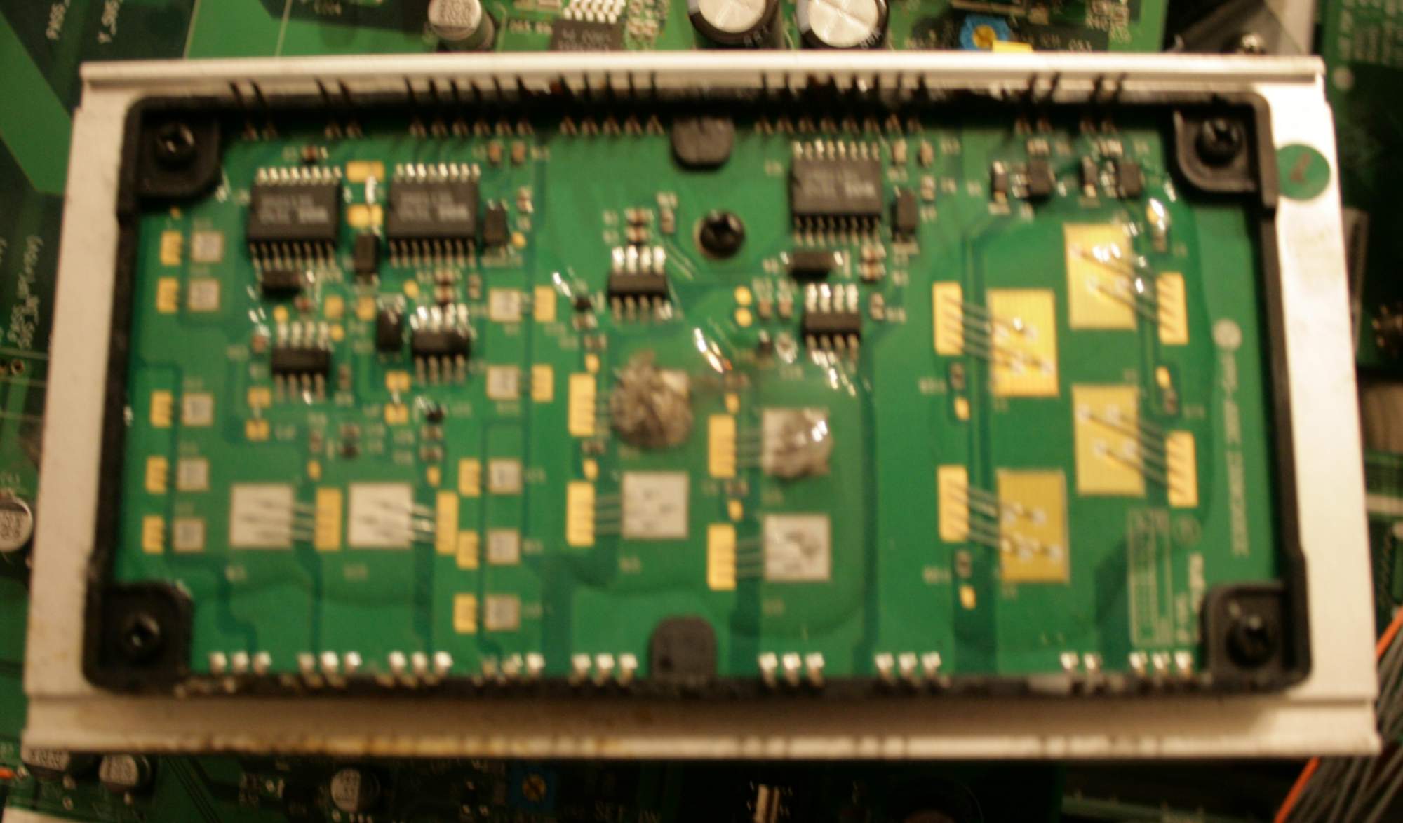

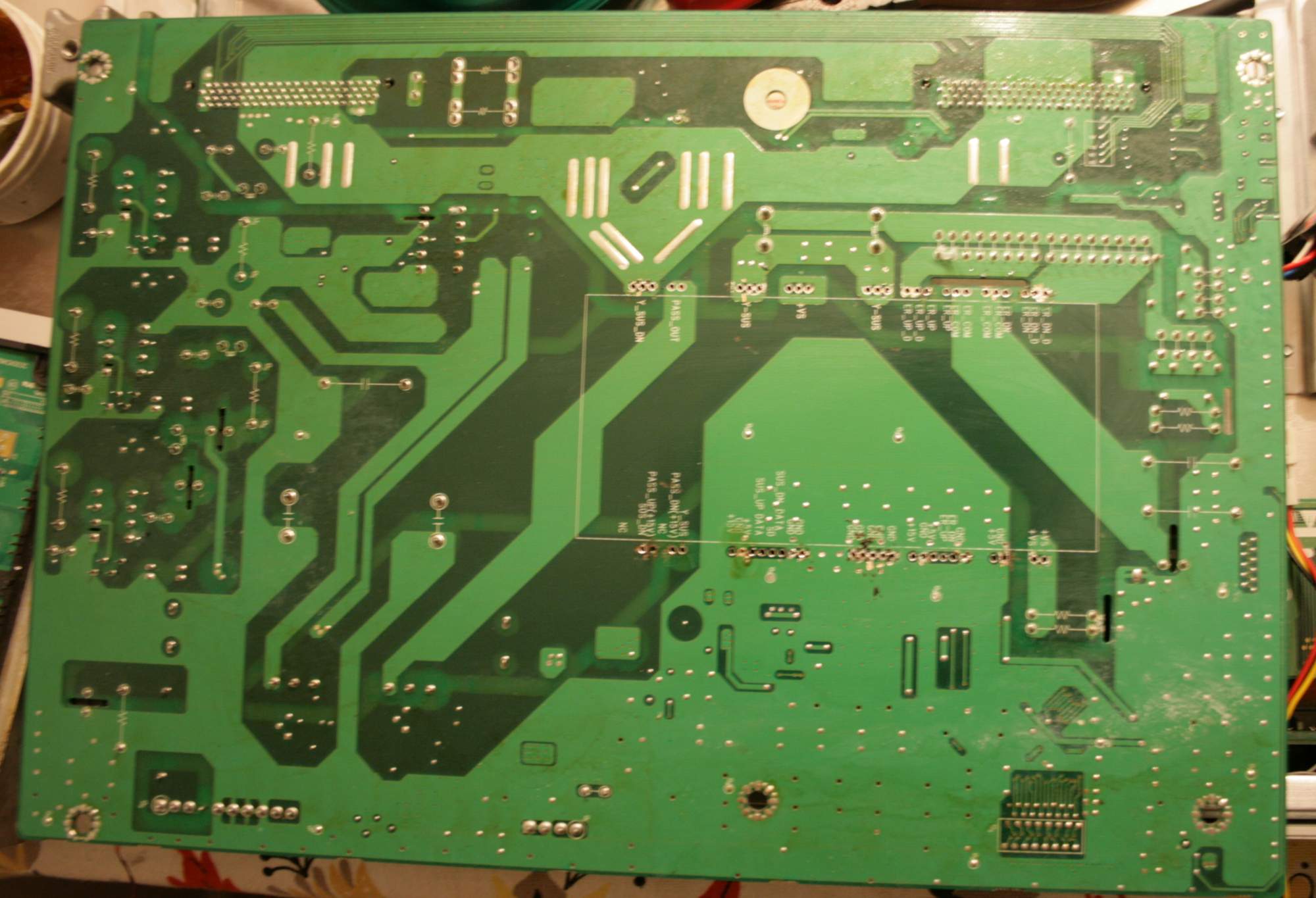

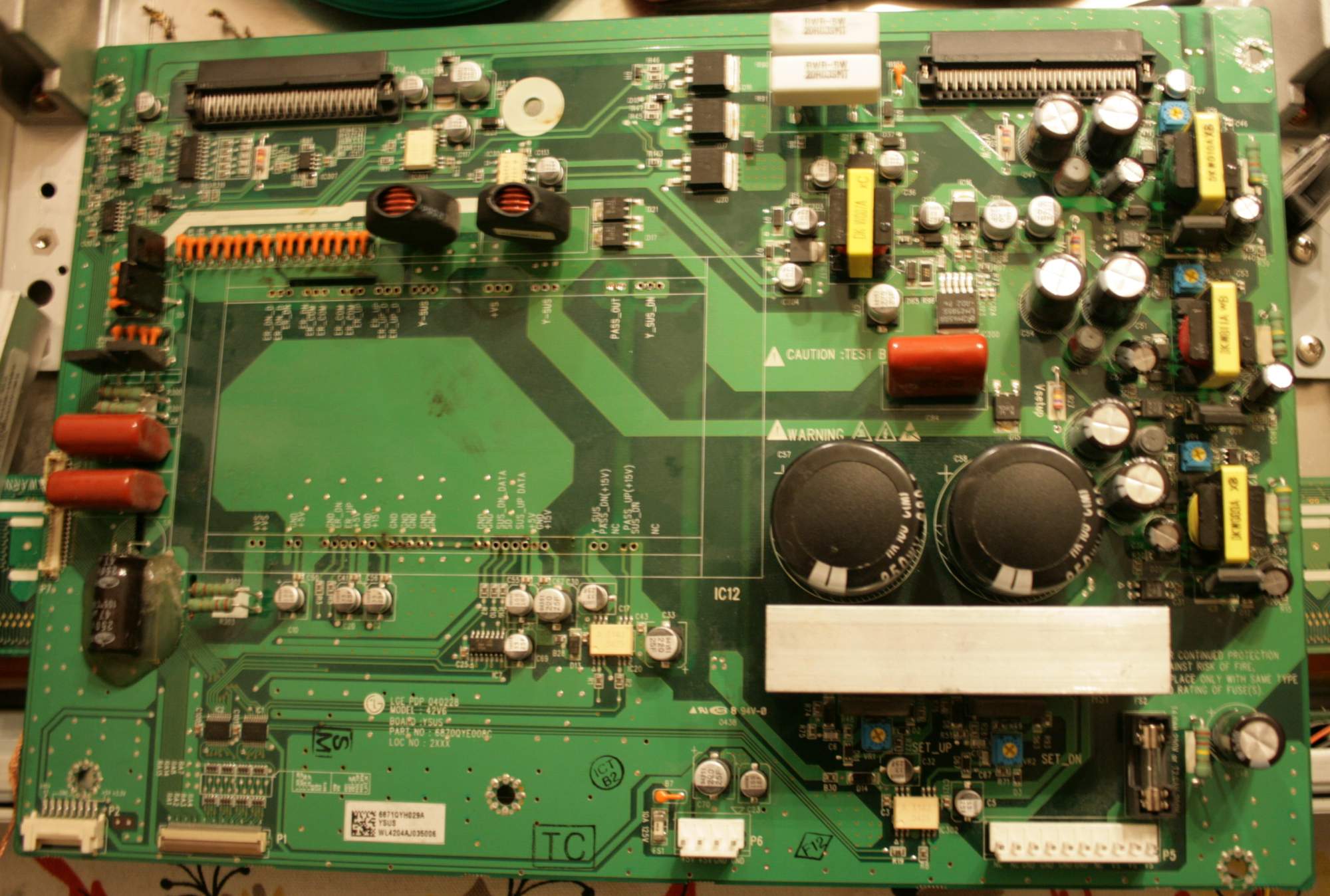

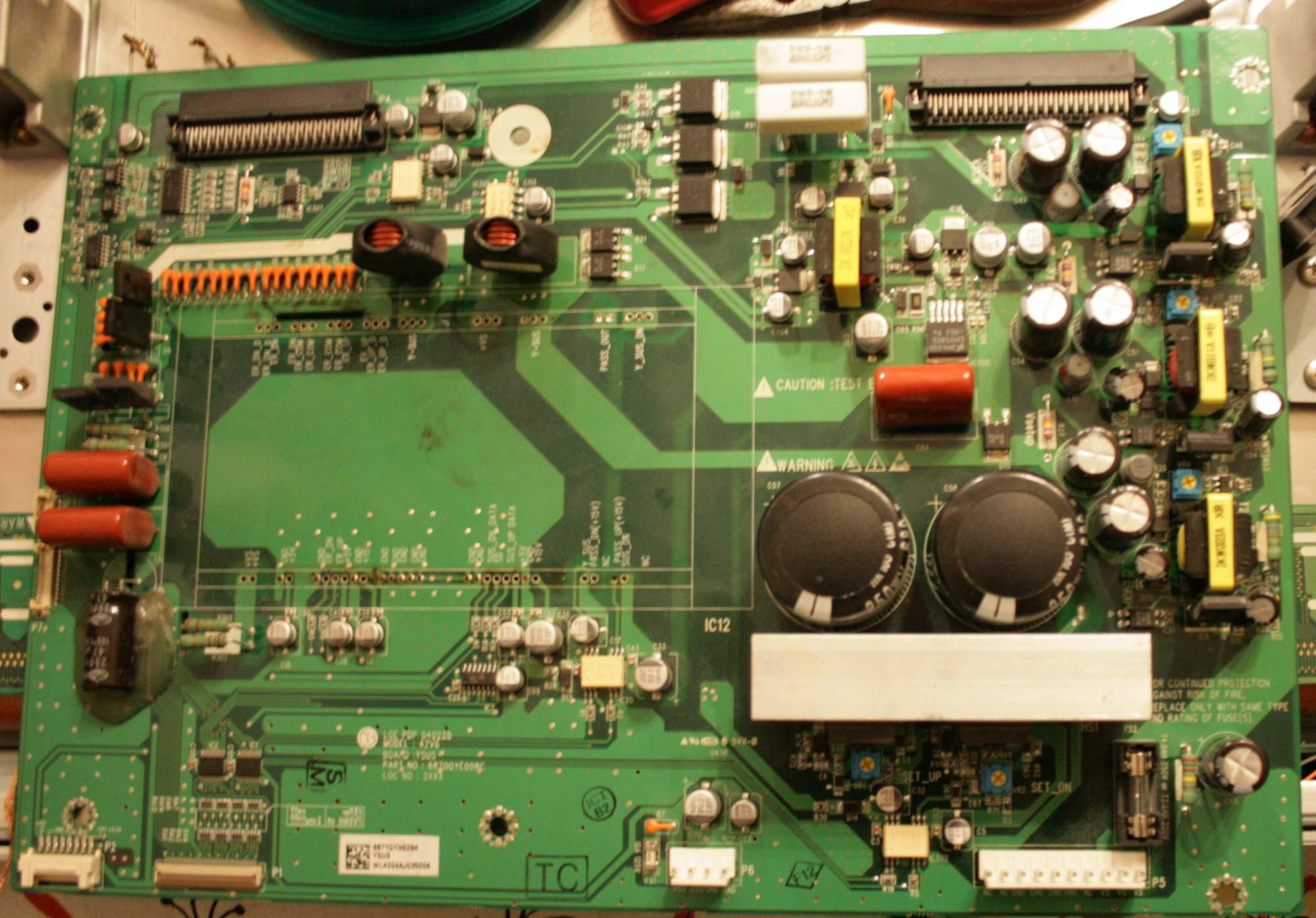

I got this TV from a job for free. Cracked it open and the Y-Sus fuse was out. Replaced the fuse and it now goes into protect. Power supply is OK the 190/65 voltages are there when I unplug the Y-Sus board. As is the 5v+

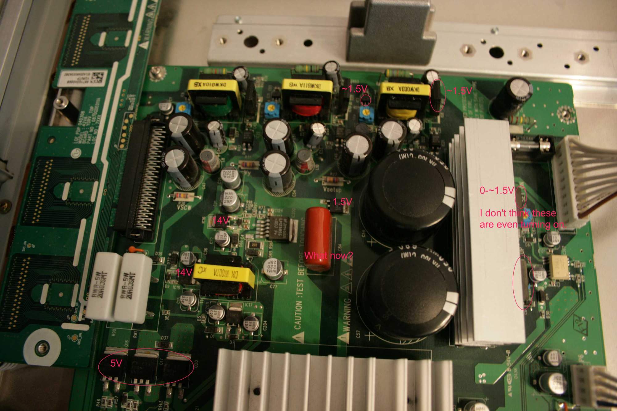

Went through the board. I only get 1.5V at the top.
I do get 14V on the lower portion and 5v on the 3 fets. The 700v Mosfets do nothing.
The panel in this is PDP42V6, from searching this isn't good. Don't want to drop $$ on a new board, I'd rather fix it my self. Seems simple enough.
