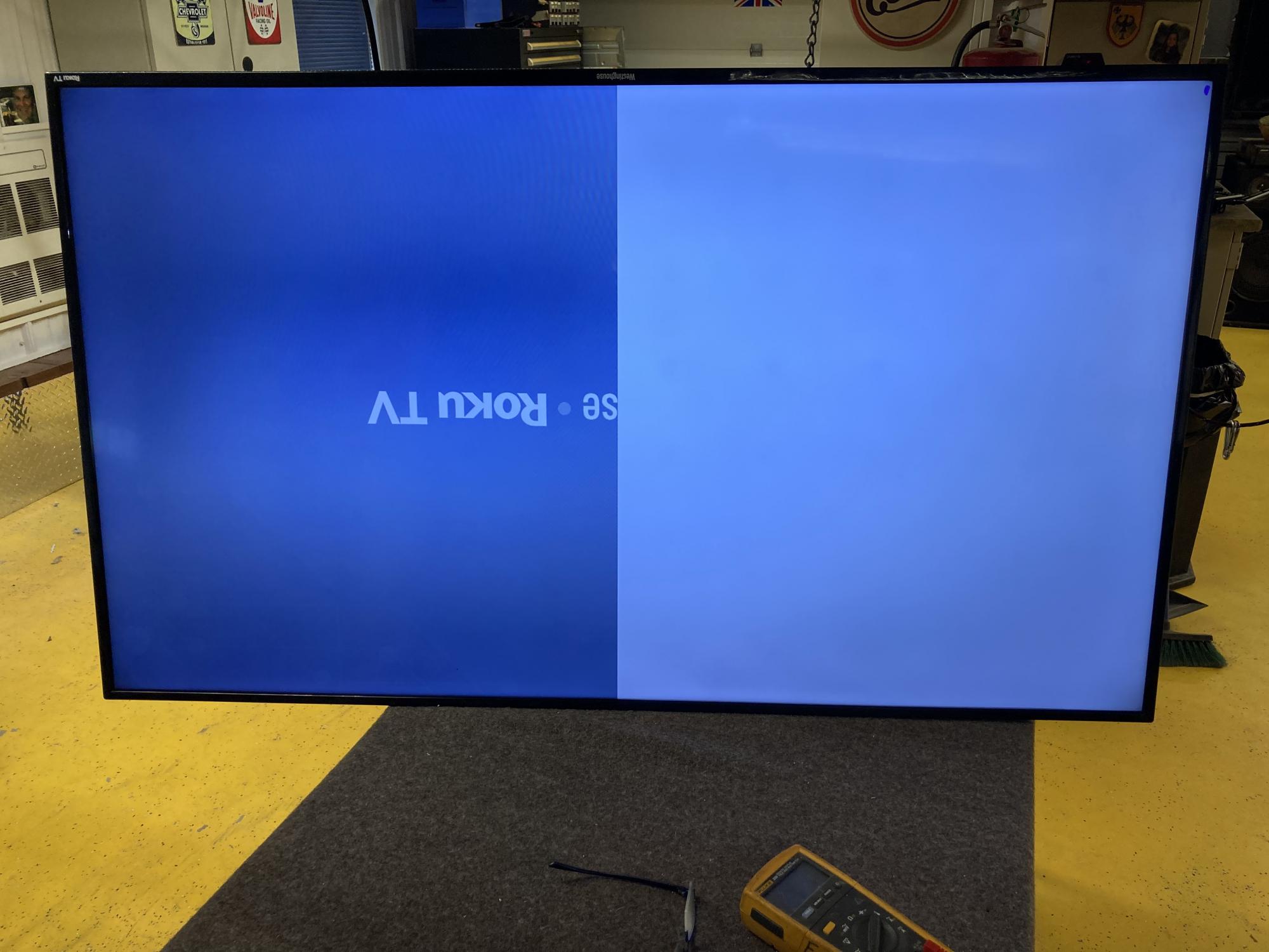

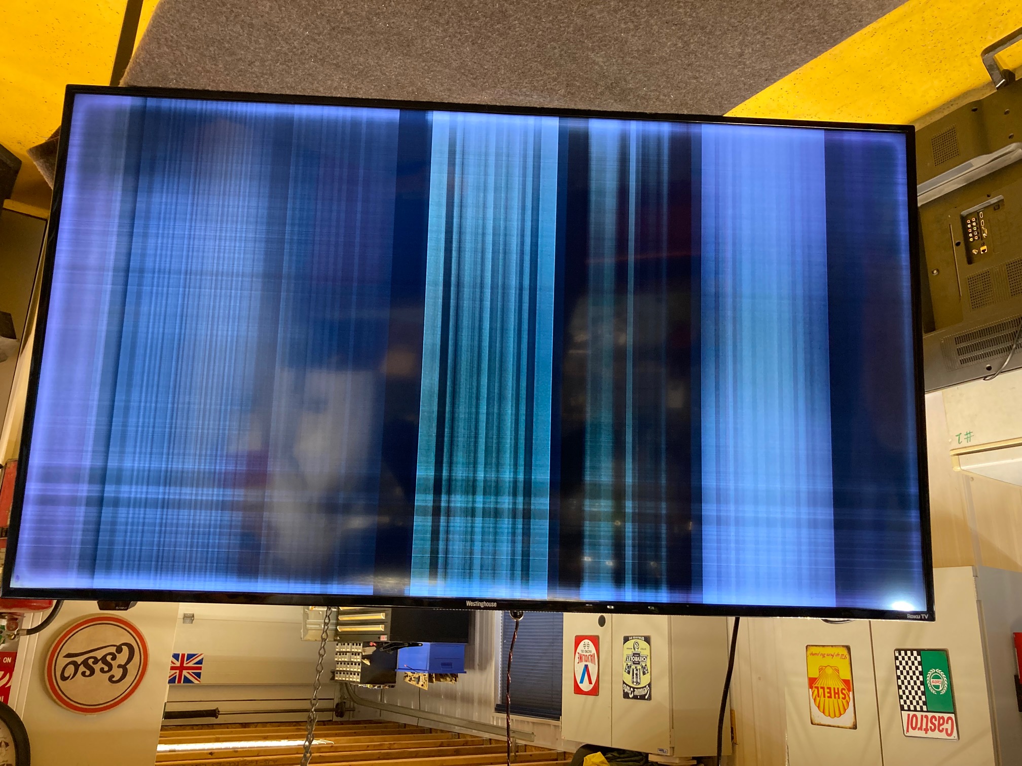

    westingtonhouse wr58uc4139 picture problem
    westingtonhouse wr58uc4139 picture problem.Kinda looks like a t-con issue or main board.Anyone wish to weigh in.Got 12v on t-con and microfuse is good.The unit is only 7 month old or so.Actually found problem kinda took of left side cable to screen and now got half logo so its a shorted display.

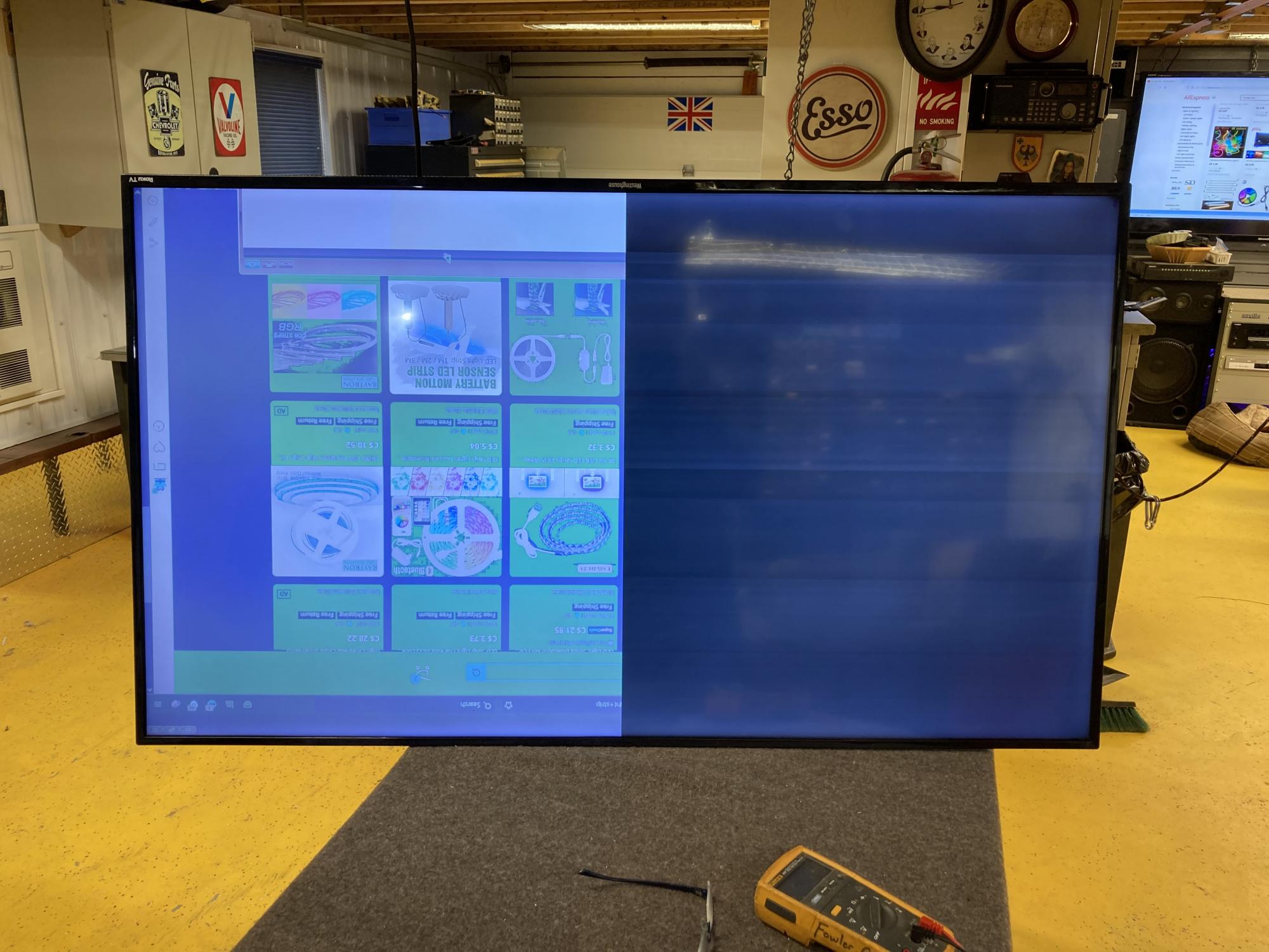

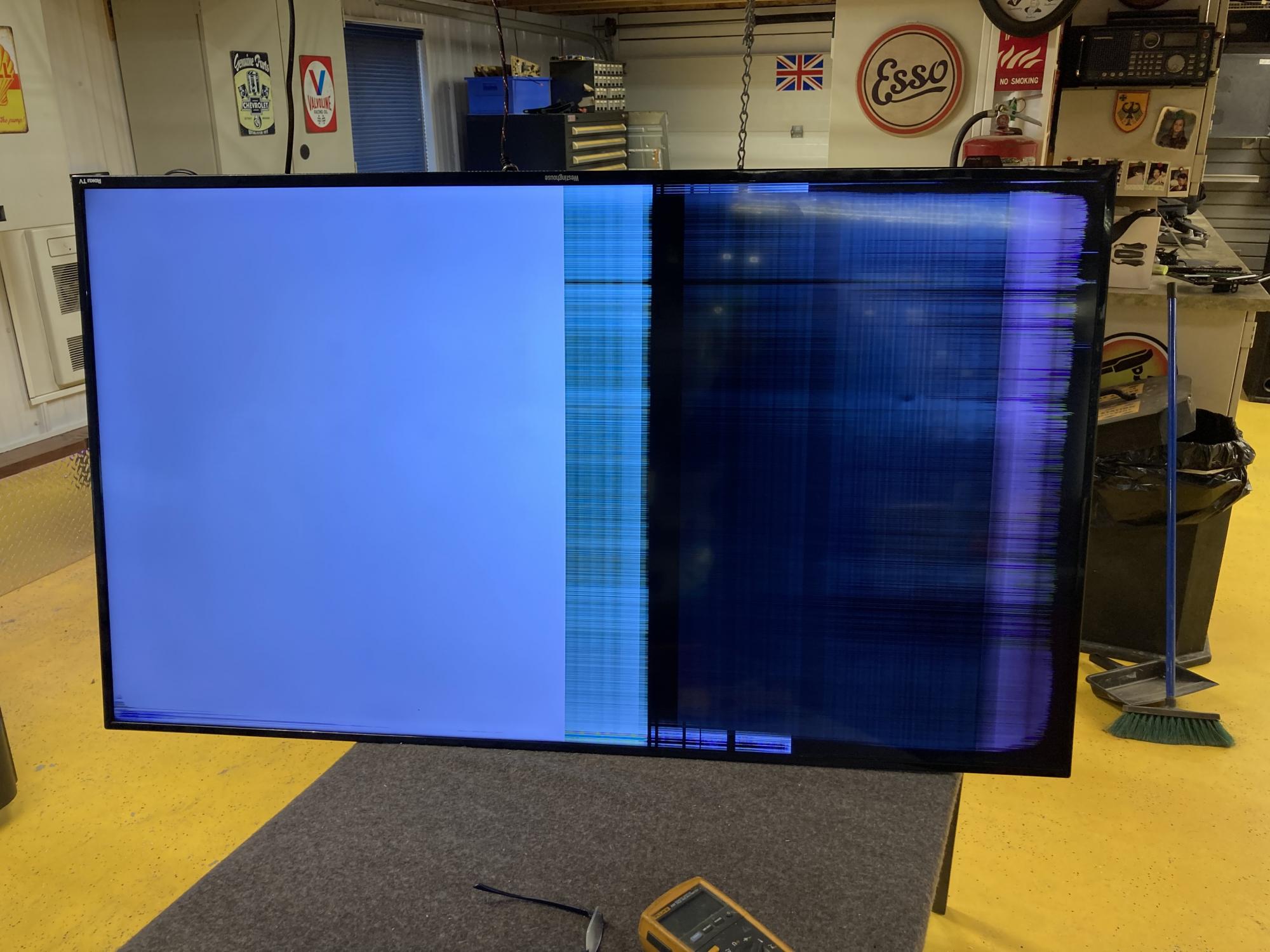

    Re: westingtonhouse wr58uc4139 picture problem
    Pics with both sides on and than left and right removed.
